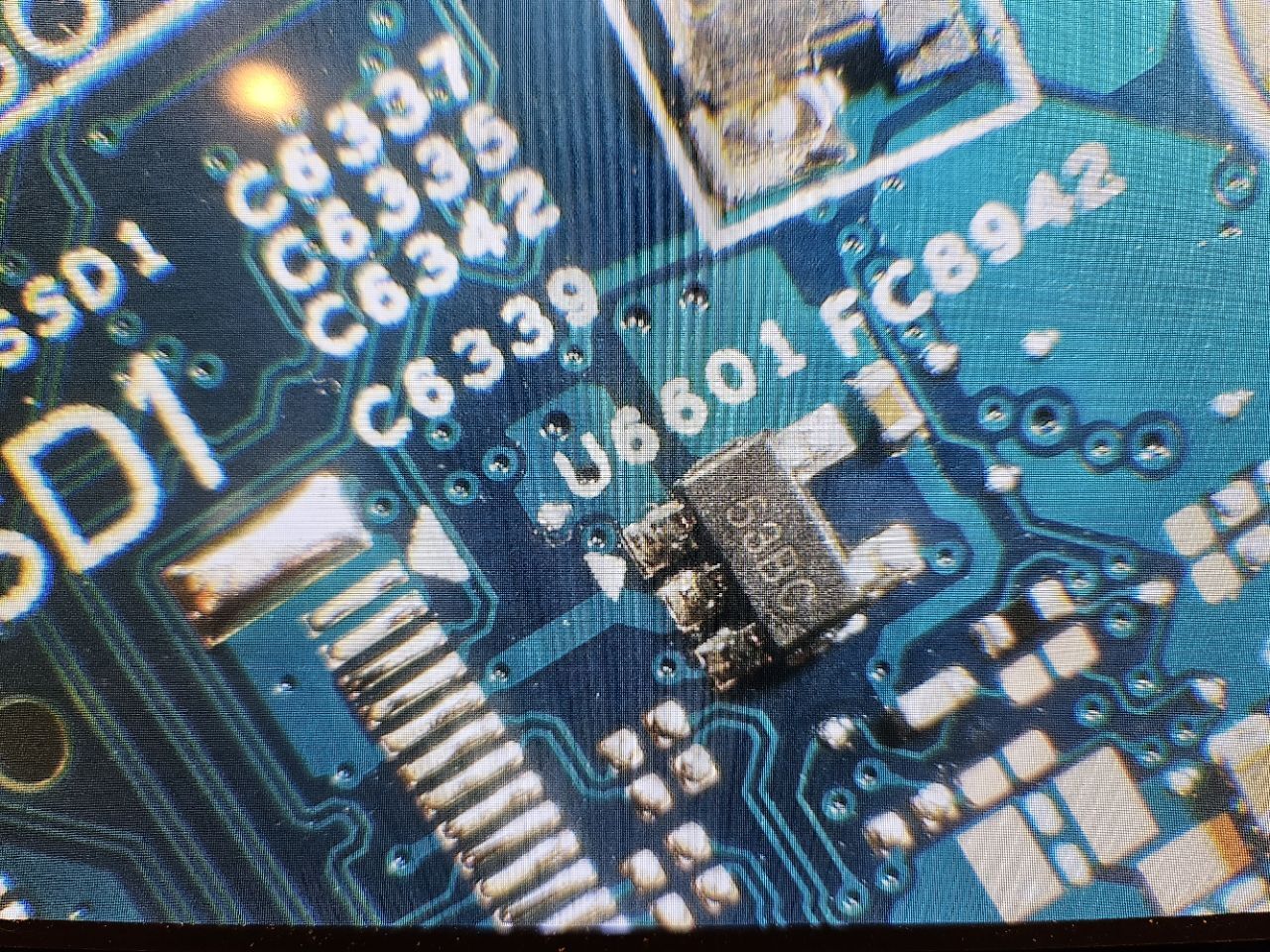

    Hello, I have this Inspiron 7706 that is not starting. It flashes 5 white/3 amber combination indicating "Power rail failure".
    I found this shorted component U6601 on the motherboard with markings "53BC". Accoring to the schematics it's SY6288DAAC-GP.
    They are available in China which means a 3 week wait.
    My question is this: is there an equivalent I can get quicker which will do the job? Thanks.

    https://www.mouser.com/ProductDetail...YLYEVLQw%3D%3D

      Awesome. I will get on with it.
