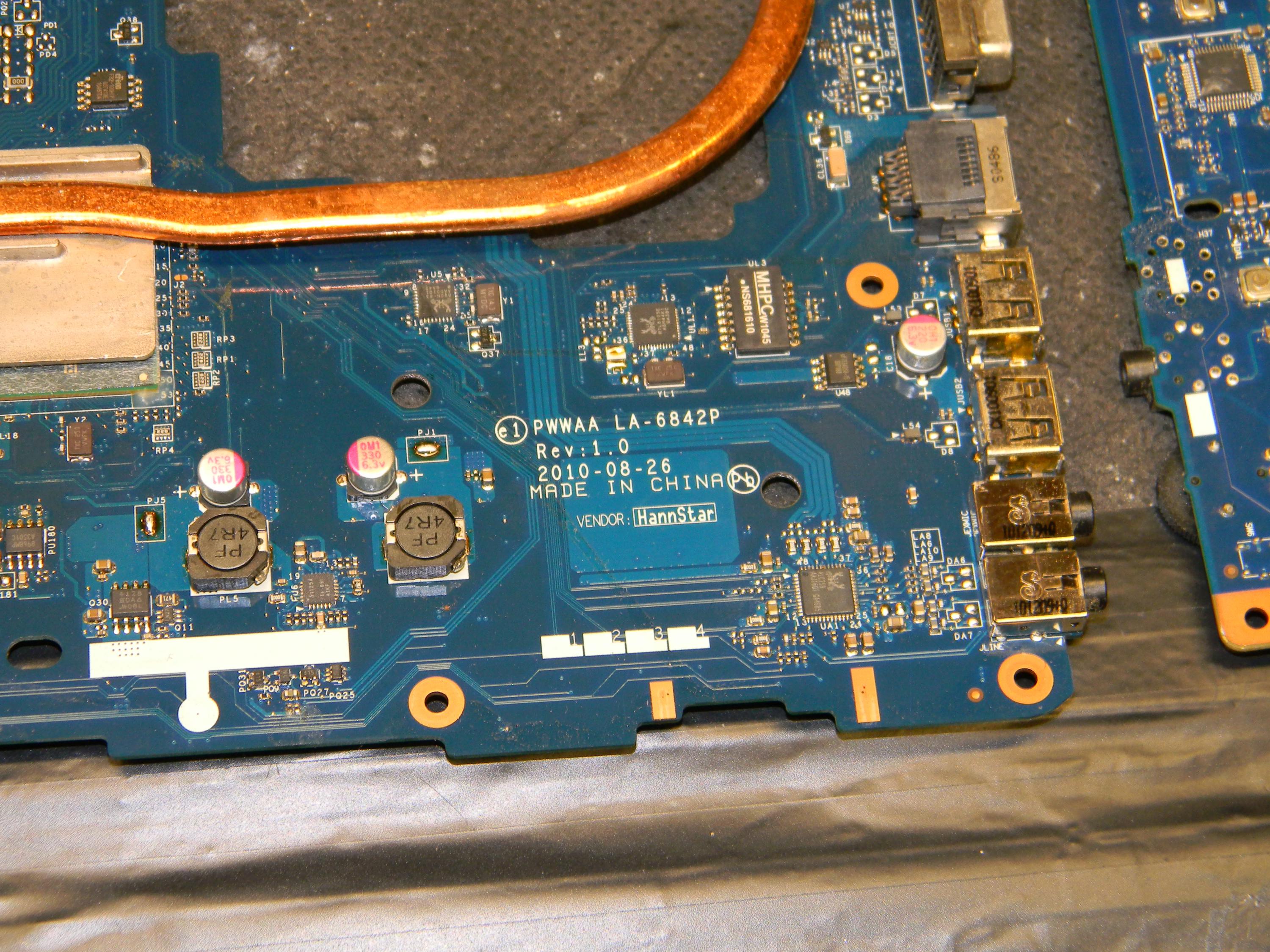

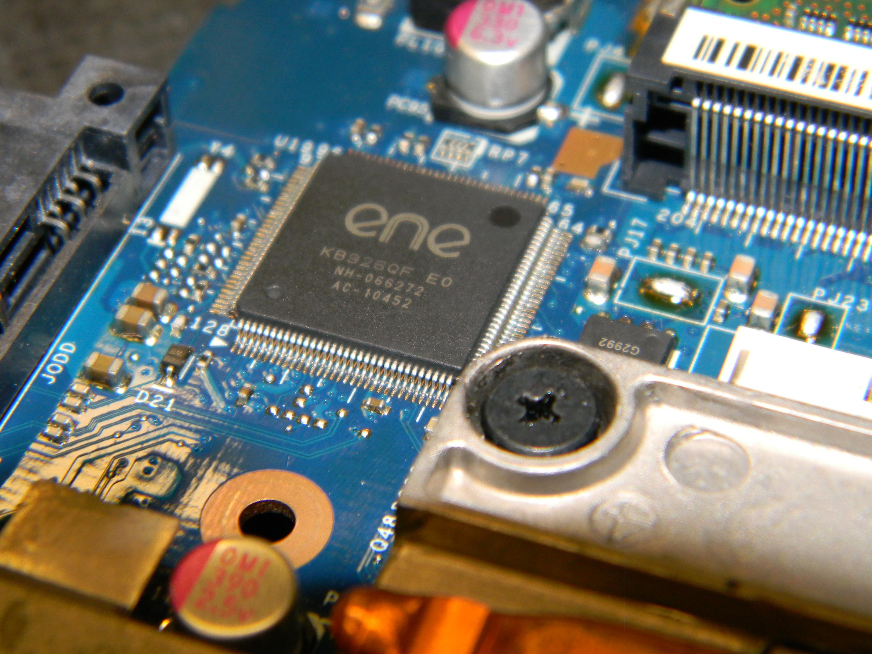

    i got a c660 la-6842p with no power.
    i got 1.8v on power button and kb926qf e0 its super hot, the mobo its not powering up.

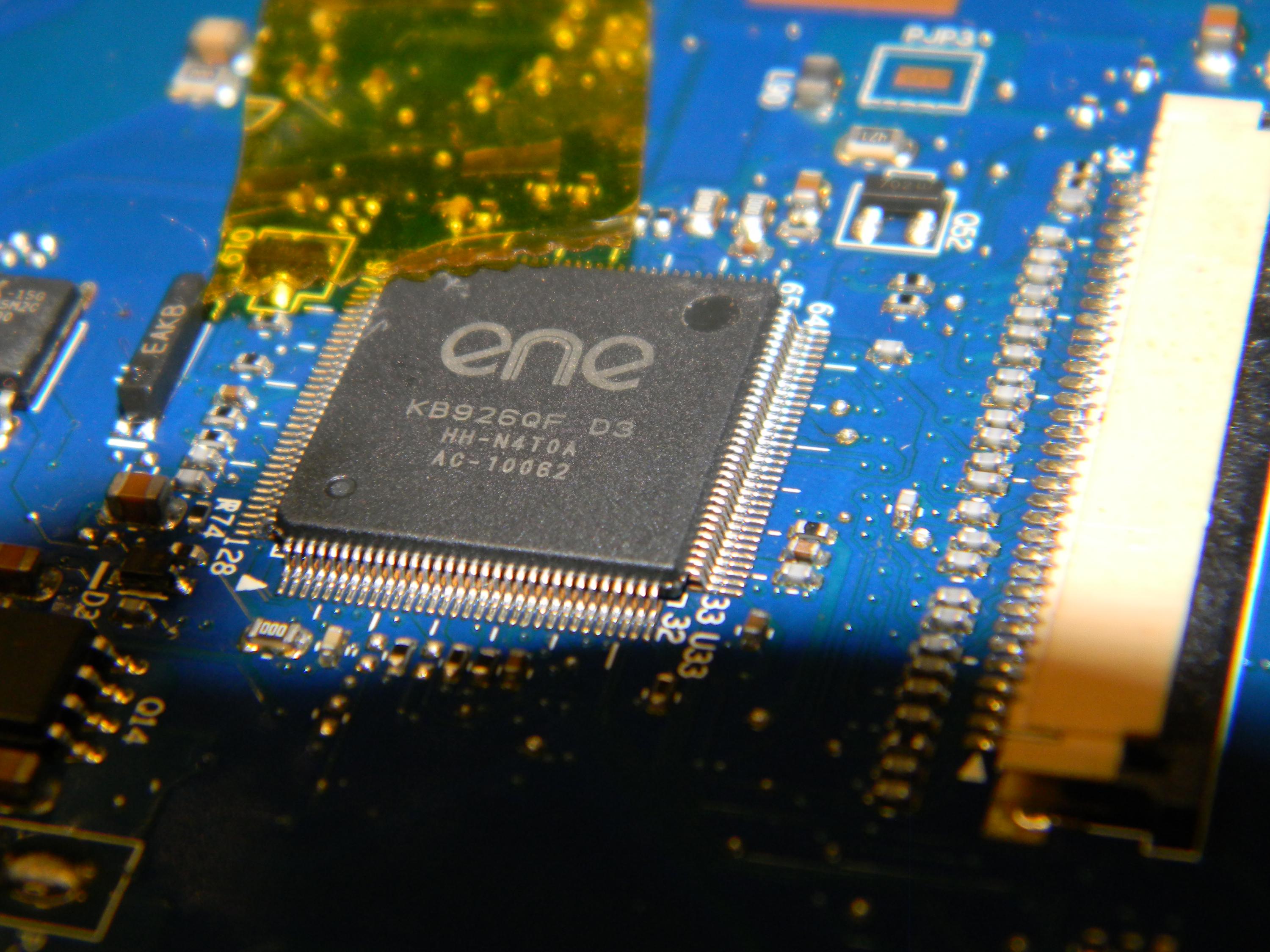

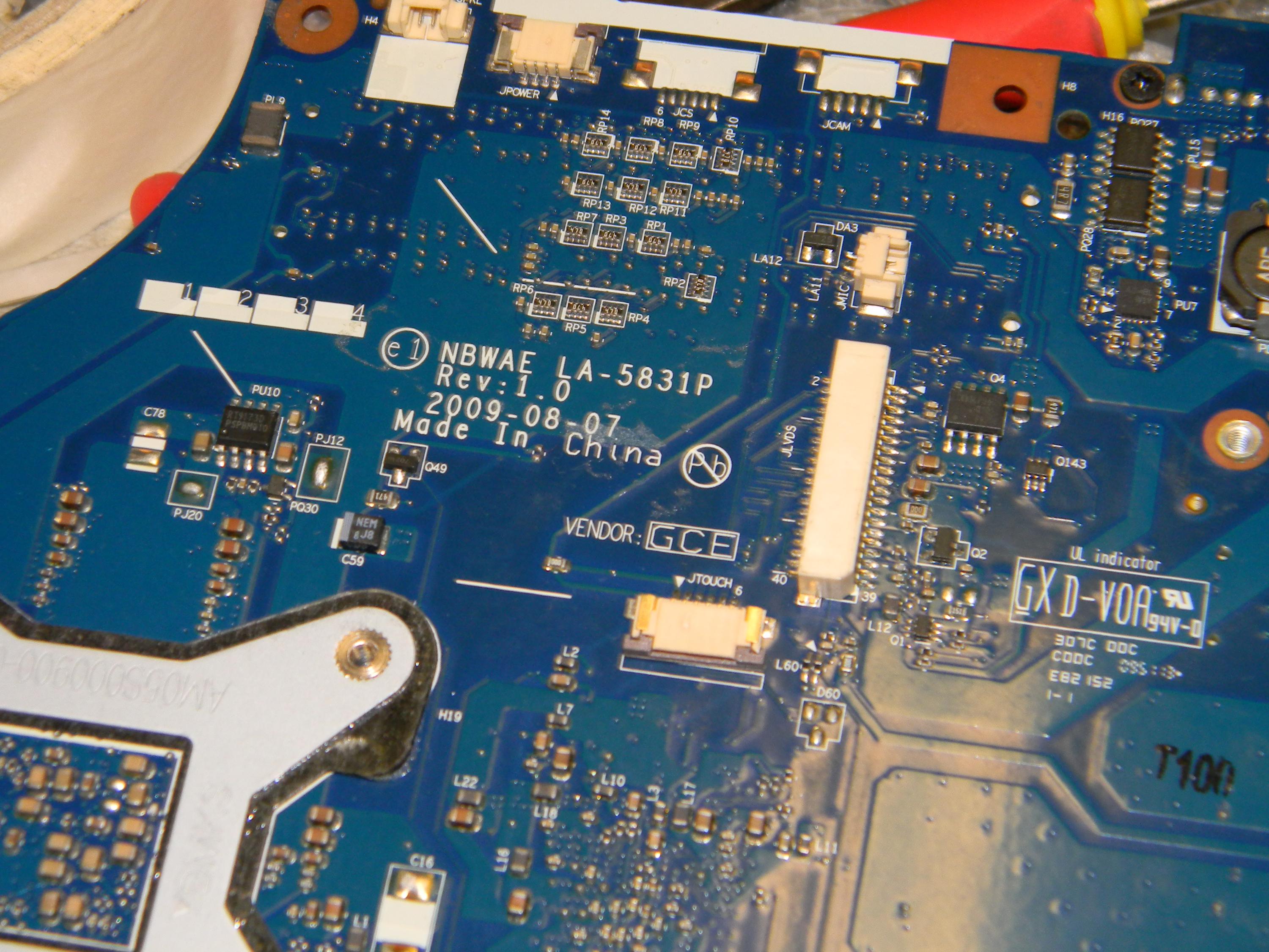

    i got a spare board la-5831p with kb926qf d3 , can i swap them?
    this board had video problems , i saw flux near the chipset.
    i will swap the kb but will it burn in to flames ?

    Re: toshiba c660-1nc KB swap
    its alive
    now 2 fets its heating up
    got no display

            u can swap only the number kb926qf must be same and the mosfet heating is not related to bios its a head wear problem
