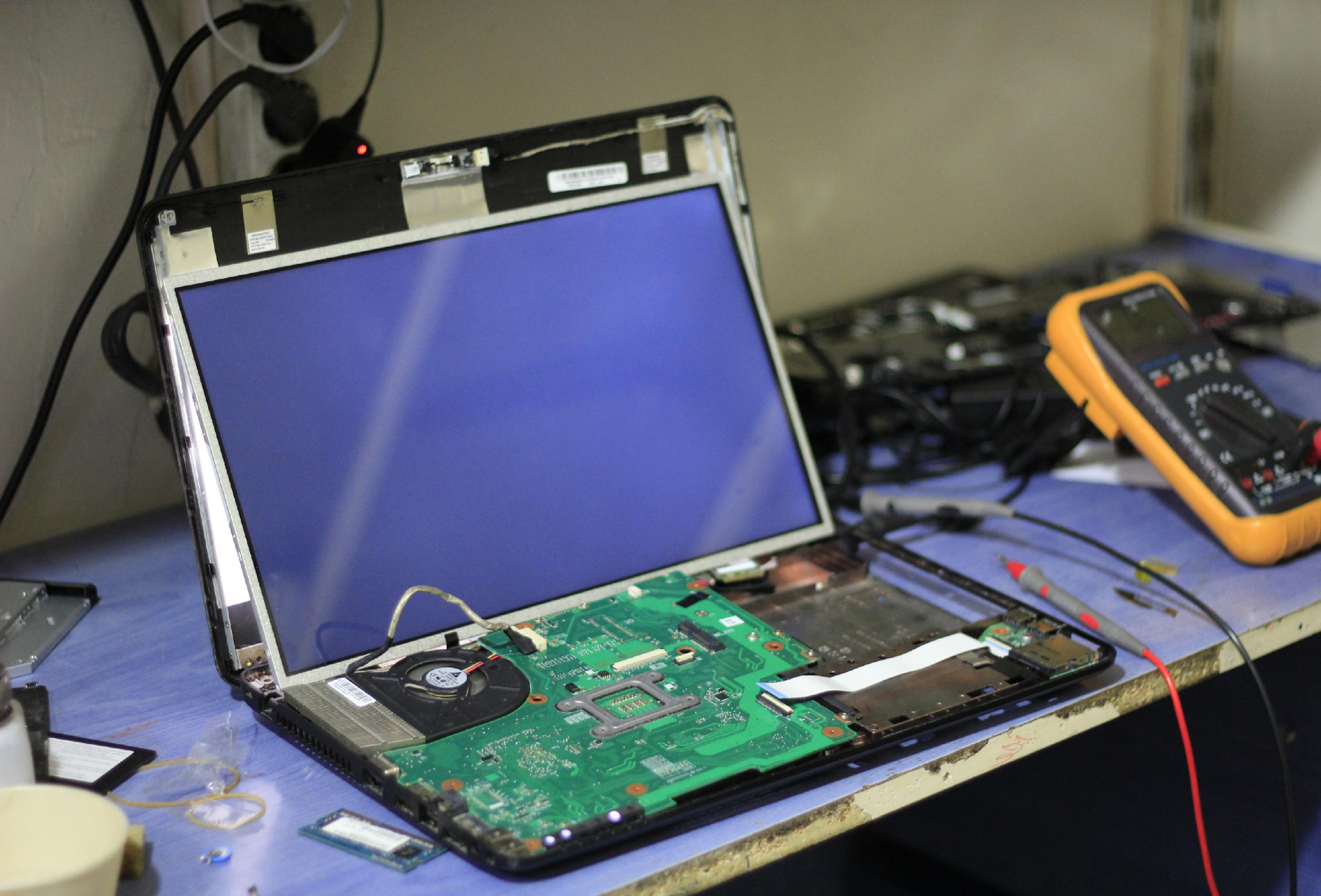

toshiba satellite L650 white screen
  • asliyucegsm
    • Jun 2011
    • 347
    • Turkiye
    my friends

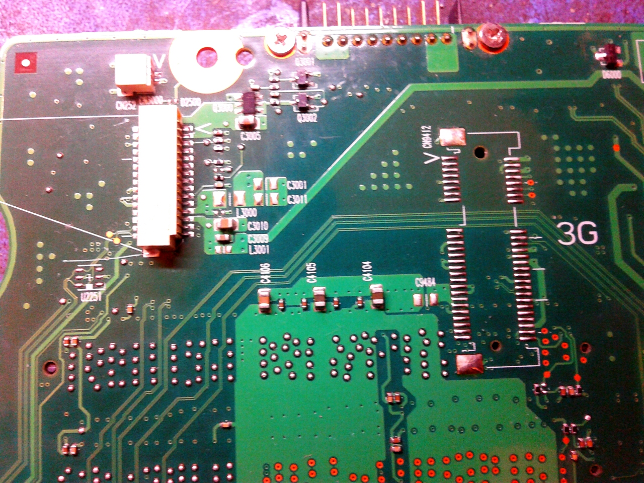

    display connector
    +3 v
    +5 v
    +18v ok

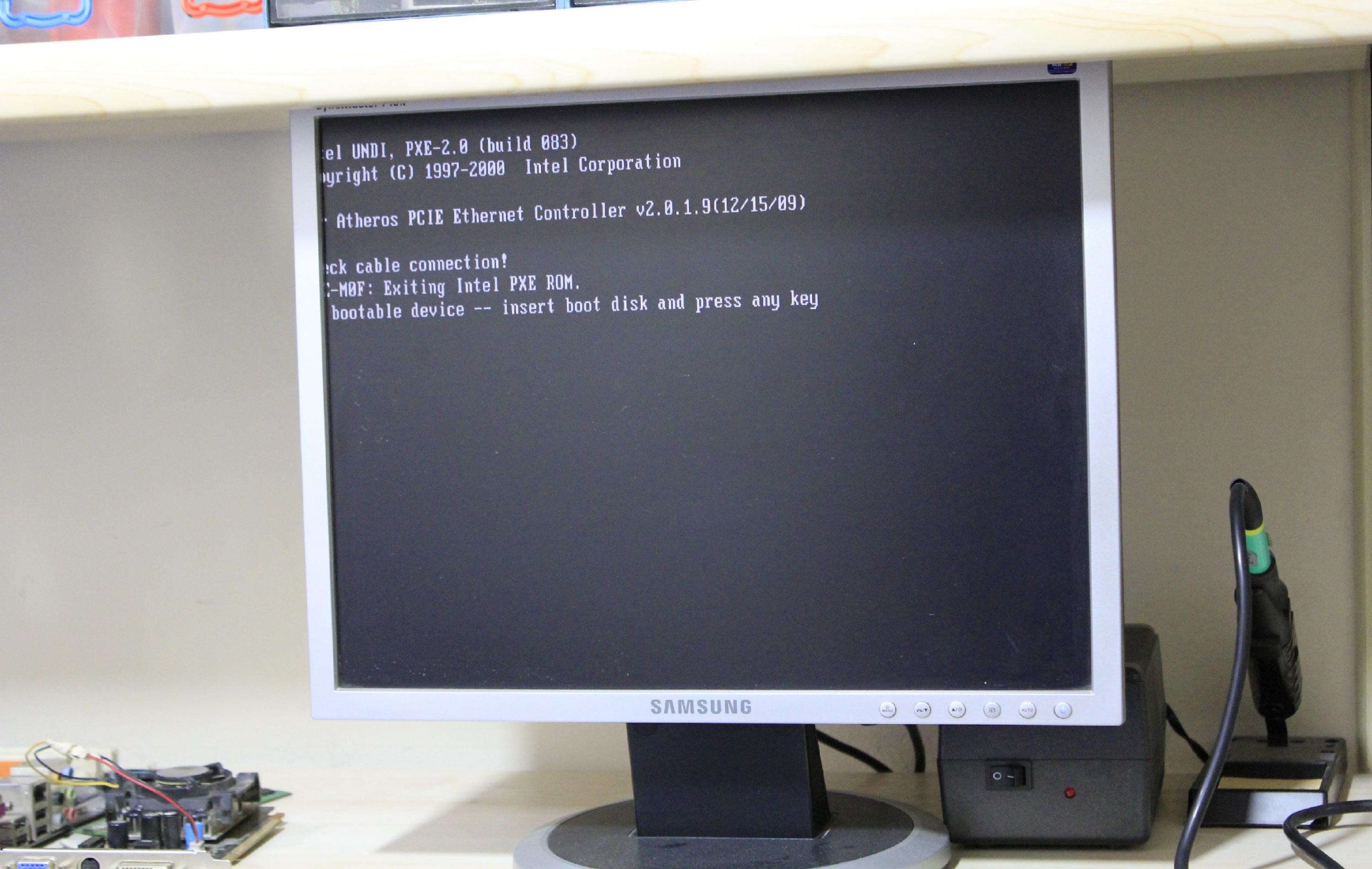

    have an external display image
    schematic help
    How do I fix it my friend
    thanks
  • dj_ricoh
    • Jan 2013
    • 2073
    • uk
    Re: toshiba satellite L650 white screen
    i have 2 samsung notebook that makes a white screen from the cable.
    try first to change the cable.
    do you have a broken screen? try that to
    • trebo
      • 514
      • Wales, UK
      if its a lcd screen, then check the fuse on the screen panel
      bad fuse on screen will give you a white screen
      • asliyucegsm
        • Jun 2011
        • 347
        • Turkiye
        friends
        tested the new screen
        • masud
          • Jul 2011
          • 317
          • Bangladesh
          if there is token check it
          • innocentforeign
            innocentforeign
            • Jun 2013
            • 172
            • KSA
            if you have external display then problem in cable kindly change the lcd cable
