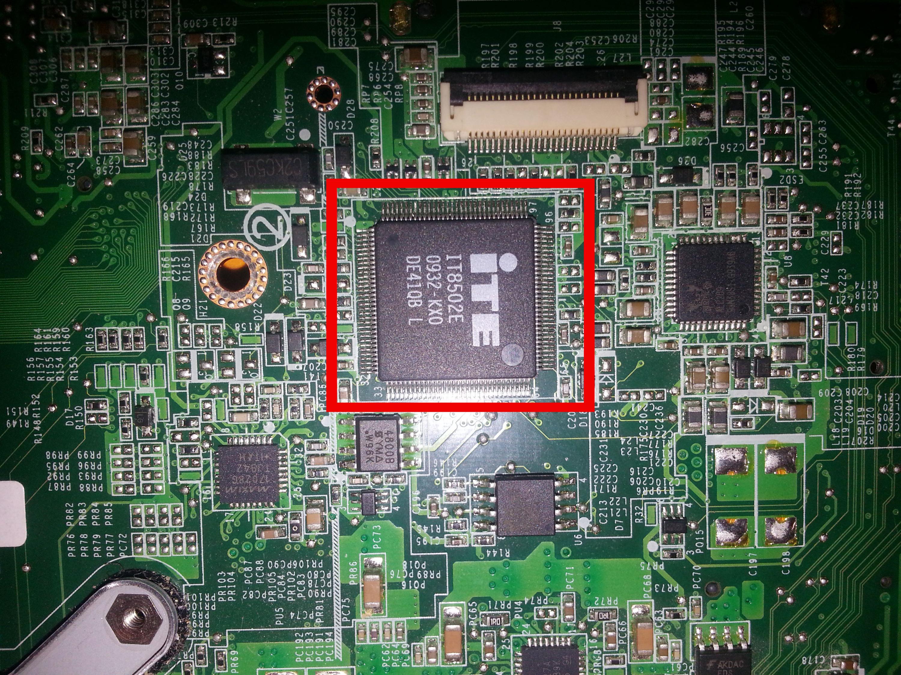

    i got a dell 1564 when powr on LCD Flashes red, green, blue, white,color for about 2 seconds each, continues as long as it is powered. check new lcd new vga cable hdd ram but problem still same . when i plug charger chipset ic it8502e (U7) heatup full you can see below attached schematic ... some time power coming some time not
    I will appreciate if anyone can help me
    thank you

    you may have gpu bga problem, but i would start flashing bios first and replace EC "ite8502e". Then a litle bit heat on gpu to see any difference..

      Re: dell inspiron 1564 lcd flashes difrent colors
      thanks a lot sir for reply
      i do this as you say and inform you

        thank you sir spidey for help I am so happy after change ic it8502e and reflow PCH laptop working good
