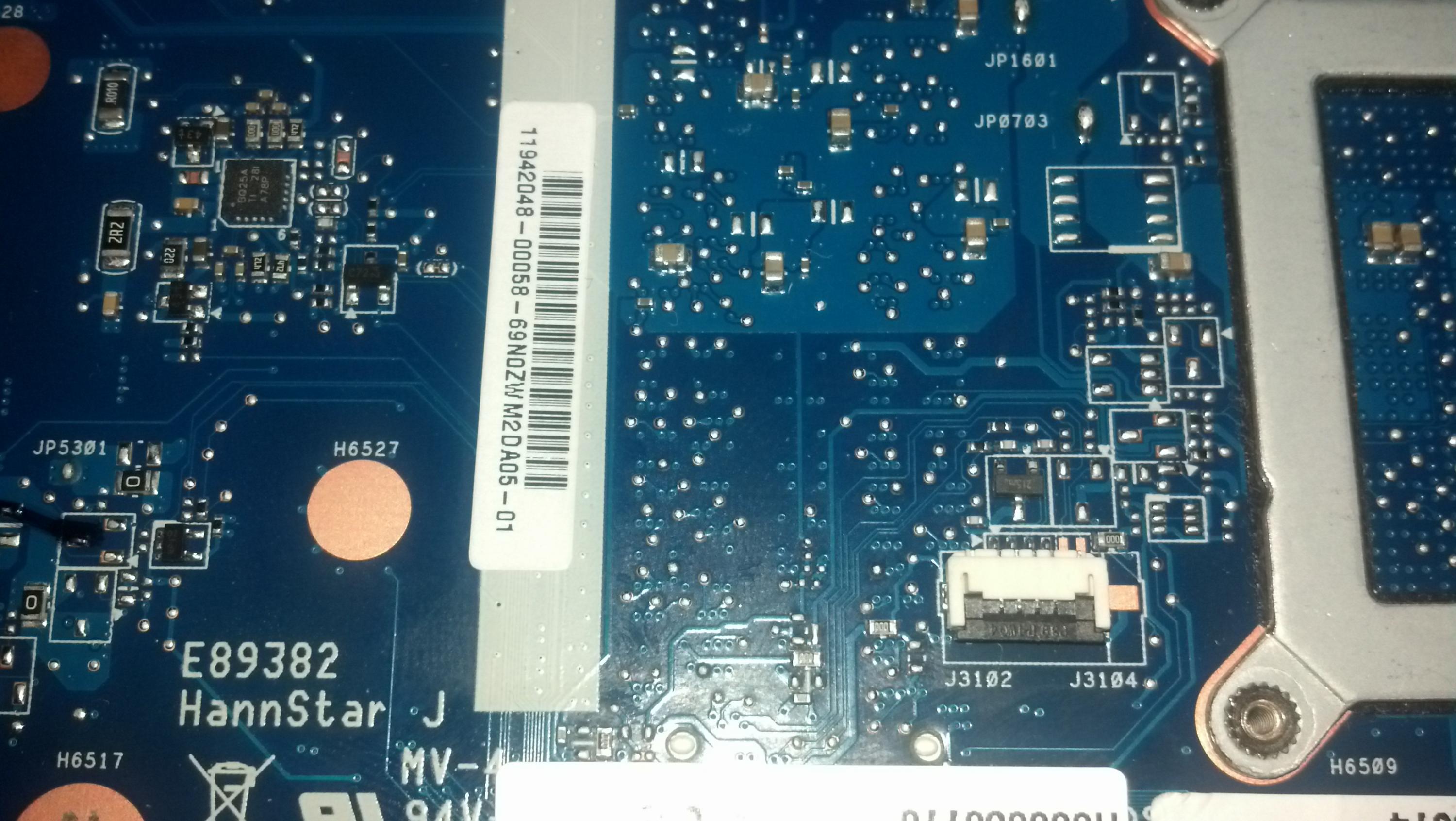

    Toshiba c855 - Hannstar E89382

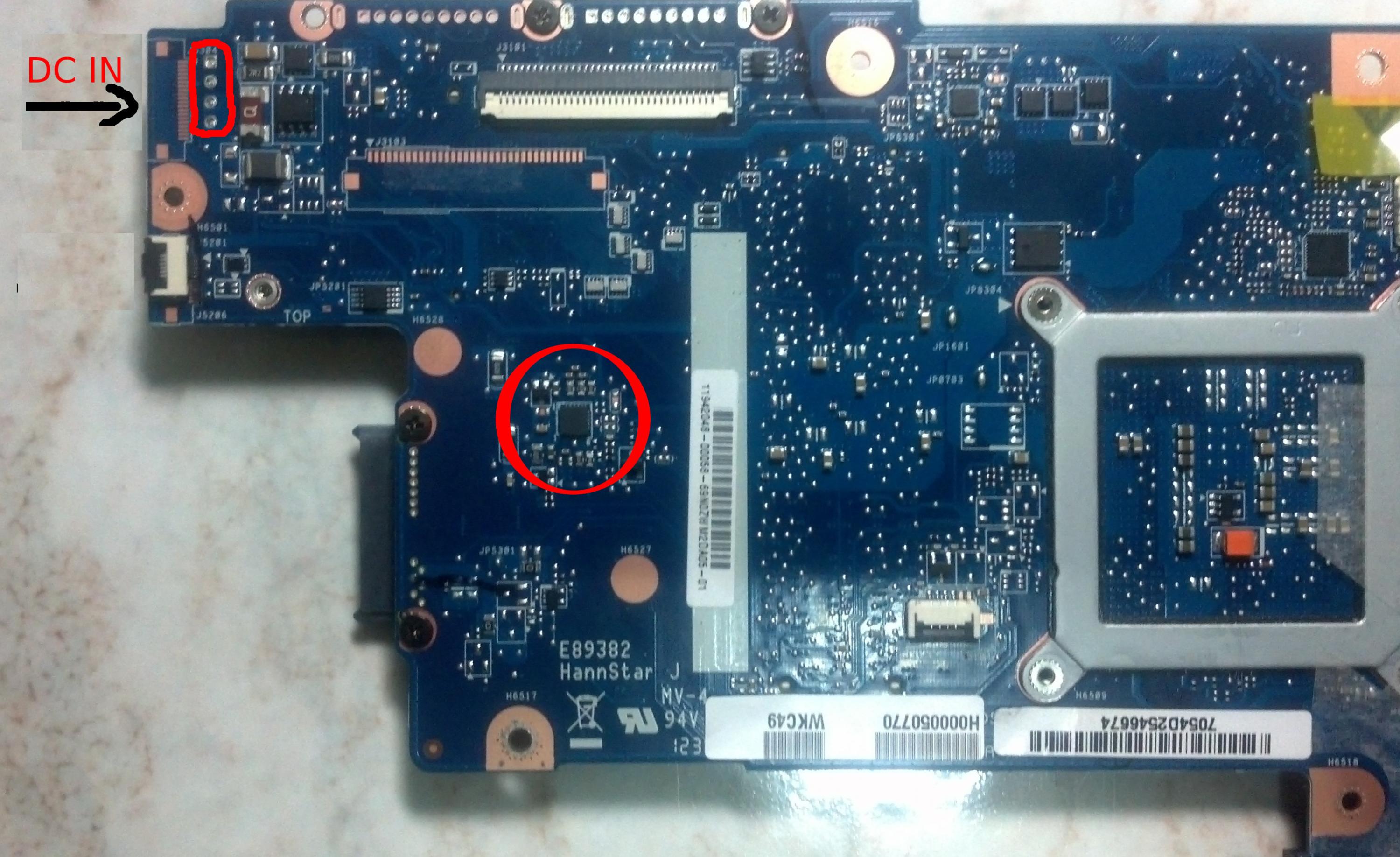

    I've a Toshiba c855 with Hannstar E89382 J MV-4 94-0. Due a jack repair the polarity has been inverted so the lapotop, when there's no battery plugged, doesn't turn on, dead, no led blinks, no fan. With battery plugged the charge circuit works and charge led is on, the laptop starts but the screen doesn't turn on and the cpu fan doesn't work. I've find this service manual It's right? Someone have some suggestions? Thank you very much for attention and excuse me for my bad English.

    Re: Toshiba c855 - Hannstar E89382
    Hi, I don't think problem is due to reverse polarity, in page 38 we can see that this circuit is protected for this kind of issues.
    Check voltage at both sides of diode PD14, you should obtain 19 volts, if not, there are two coils that could be open. (PL2 and PL3)
    Why are you asking if the schematic is the right one?. In the photos seems to be that it is right.
      When i've remounted the laptop, it started and worked for 2-3 hours without recharge the battery even if on windows status bar the plug-in icon was in ac mode. When i've pulled in and out the ac power cable few times the laptop stops. I've checked voltage up to the charge controller and the 19v its ok.
            Hi sparker1, i've read your thread and i've upgraded the bios to 6.60 version but nothing. When i insert the battery all the leds are on and the icon on windows bar shows the charge state on. I've found another laptop similar to my model and i've charged the battery. When i'm remounted the battery on own laptop i've seen that it works fine but not charge.
            So i can say it's an issue on charger circuit. I've a doubt about the schematics because i don't found the same name and type of device on motherboard. Maybe i'm not so practise!
            In the evening i would reopen the laptop to follow Francisco's suggestions.

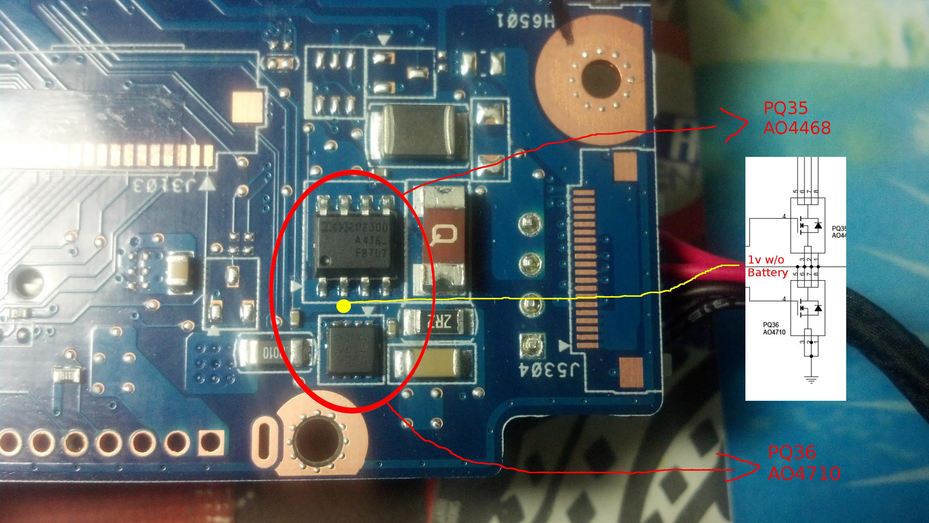

                    You should find PL4 (also mosfet PQ35, PQ36) equivalent in your MB. (near the battery connector) . From there, try to locate the chip than control the charge circuit , and look for its data-sheet over the Internet, then study it and try to find out all the information you can.
                    I know it's very difficult, but you can post your results, and ask for help.

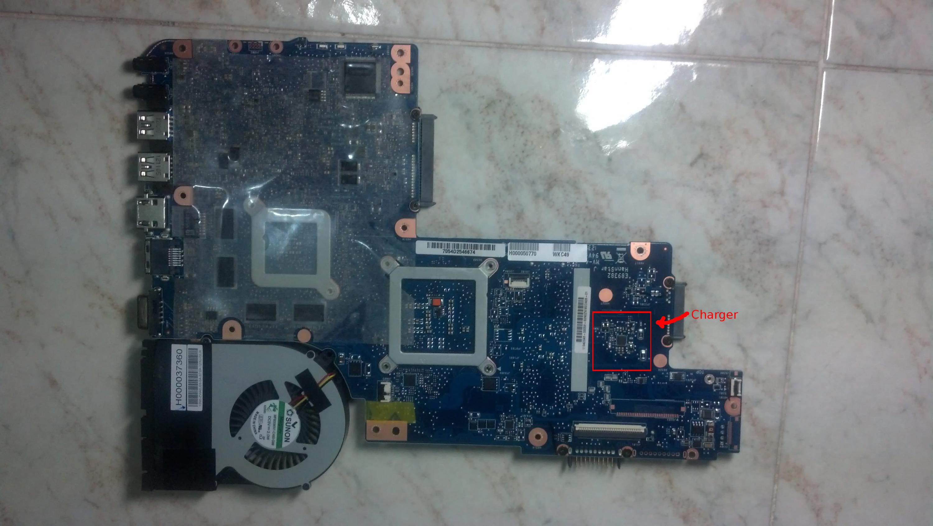

                      I've identified the charger section and i've found my component, it's a BQ25A. I've read datasheet, it's a 1-4 Cell Li+ Battery SMBus Charge Controller with N-Channel Power MOSFET Selector and Advanced Circuit Protection. Moreover, i've test all components in the section, there is only one zener that i'm not sure. Whit diode test i've continuity in bias and in reverse bias (value readed more higher).
                      Someone has to suggest some test before i change the BQ25A?

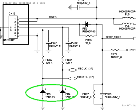

                        Check pin 8 and 9 (SDA,SCL) voltage, as I said before, this signals communicates with internal battery smart chip.
                        There is some protection diodes connected to this signals, near the battery connector, and could be in bad state.

                          I've found 1v without battery and 3,25v with battery half charged. I've checked continuity between battery connection and SDA and SCL pin, it's ok but there's not diodes and i've continuity in all tester tips position, bias and reverse bias. I've checked PQ35 and PQ36 without battery and there is 1v, too. I think there is some bad component on line that supplies power directly the motherboard because when i put the battery status led is on, when i put off and insert only the cable all leds are off and the all circuits look dead.

                            The diodes I've mentioned, are PD4 and PD5, but if you have 3,25v, then I think it's OK.
                            SDA and SCL signals, are the same as MBDATA-MBCLK and goes to EC chip, U21 (WPCE775).
                            I think U21, is the one that controls the circuit for charging the battery, but if BQ25A is bad, the battery won't charge, and won't report battery status.
