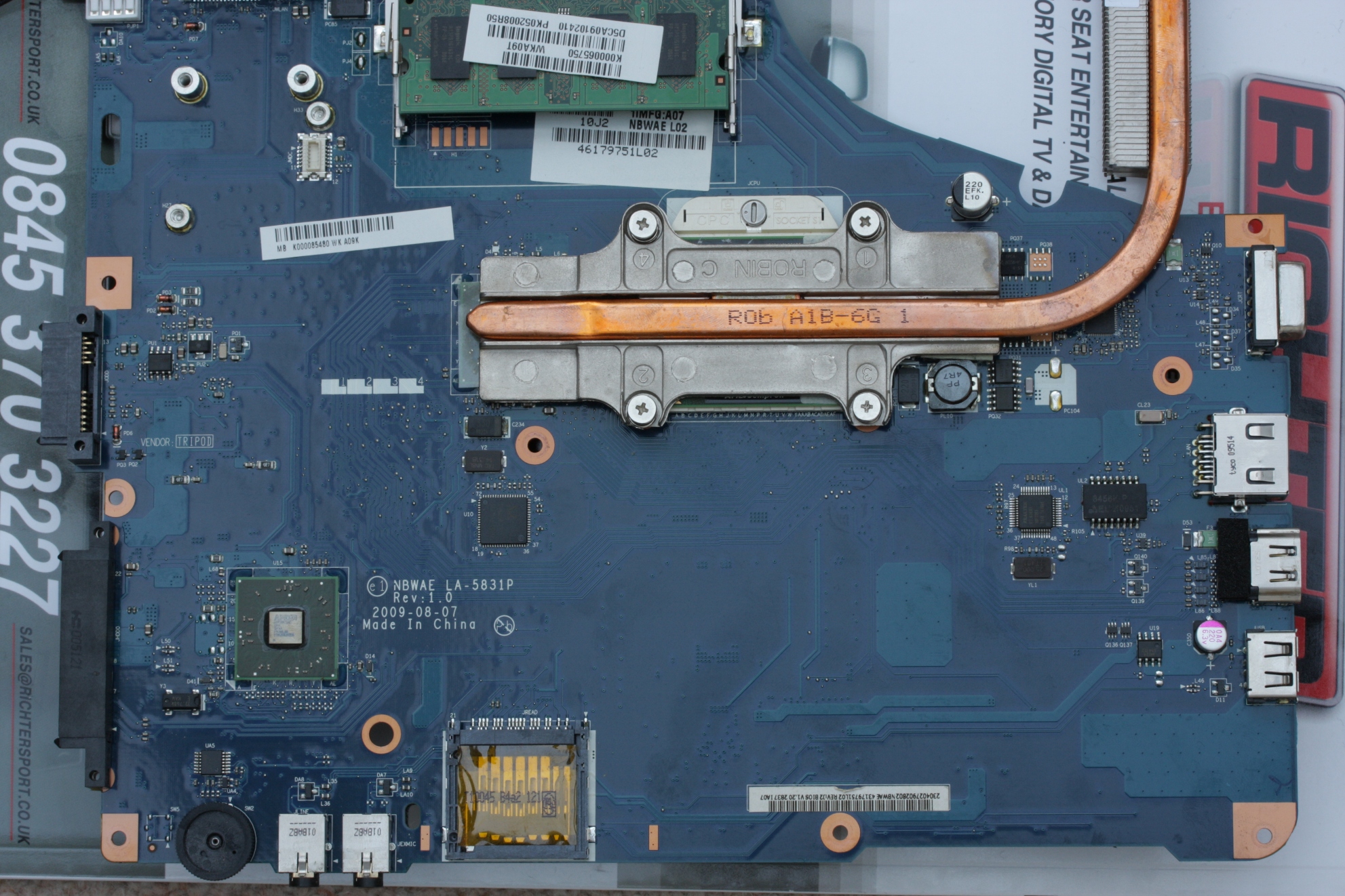

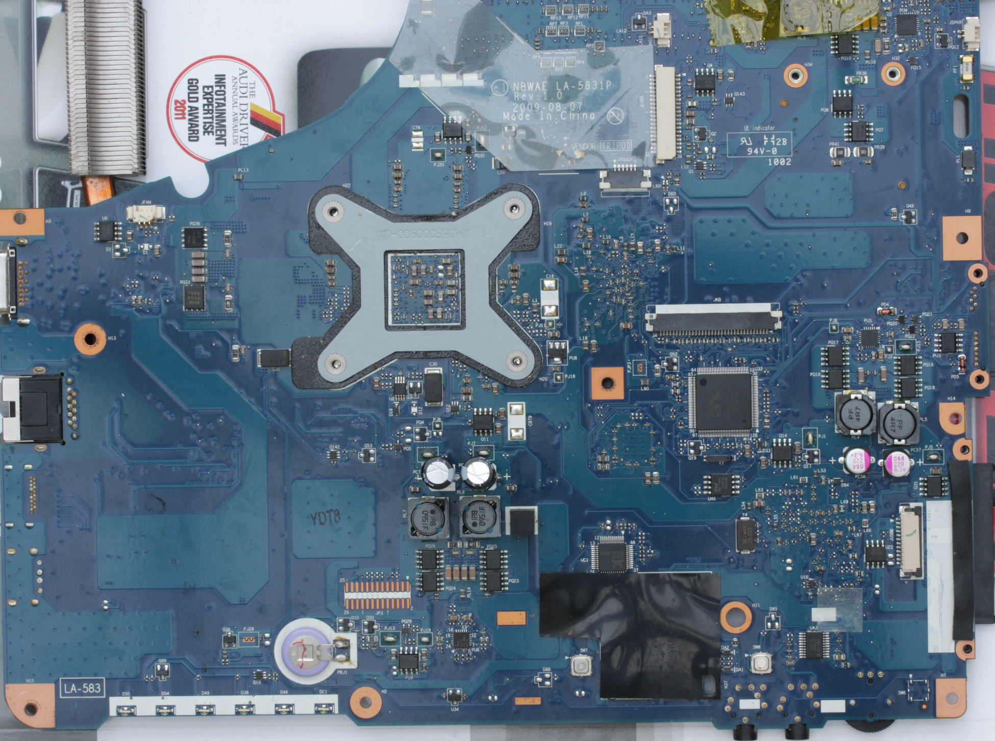

    Item: Toshiba Satellite Pro L450-12x laptop
    Fault: Nothing is displayed on the screen or via an external monitor through VGA cable
    Background: The laptop has over heated several times and on one occasion it has shut down completely.
    Initial investigation: Tested on battery only and AC (with and without battery) connected and found power led lights green, battery and AC connected green. I press the on button and the fan starts up at a high speed for around 3 secs and then goes off. There is no disc activity light, but I can hear and feel it working - I have tested the hard drive in another machine and it worked fine so I'll rule that out. After about 2 minutes the fan will spin up again for 3 secs and then off again.
    Whilst taking the fan out I found a nice lining of dust, dirt and lint which had blocked the air flow almost completely - definitely a cause for the over heating.
    I have tested DC voltage across the following caps:
    PC71 - 1.23V
    PC73 - 0V
    PC56 - 3.3V
    PC57 - 5.1V
    PC103 - 19.5V
    Caps PC71 & PC73 (OA4's 220uf 6.3v) wouldn't read in circuit. I took these two out and found high esr values. I didn't have any SMD caps so to test I replaced temporarily with rubycon ZL's - unfortunately this has not fixed the issue.
    Any advice greatly appreciated as I am not sure what to test next.

    Maybe dead graphics chip?

      I did wonder whether it could be that. I ve downloaded the motherboard schematics so I'll attach it here when I get home.... now attached.
