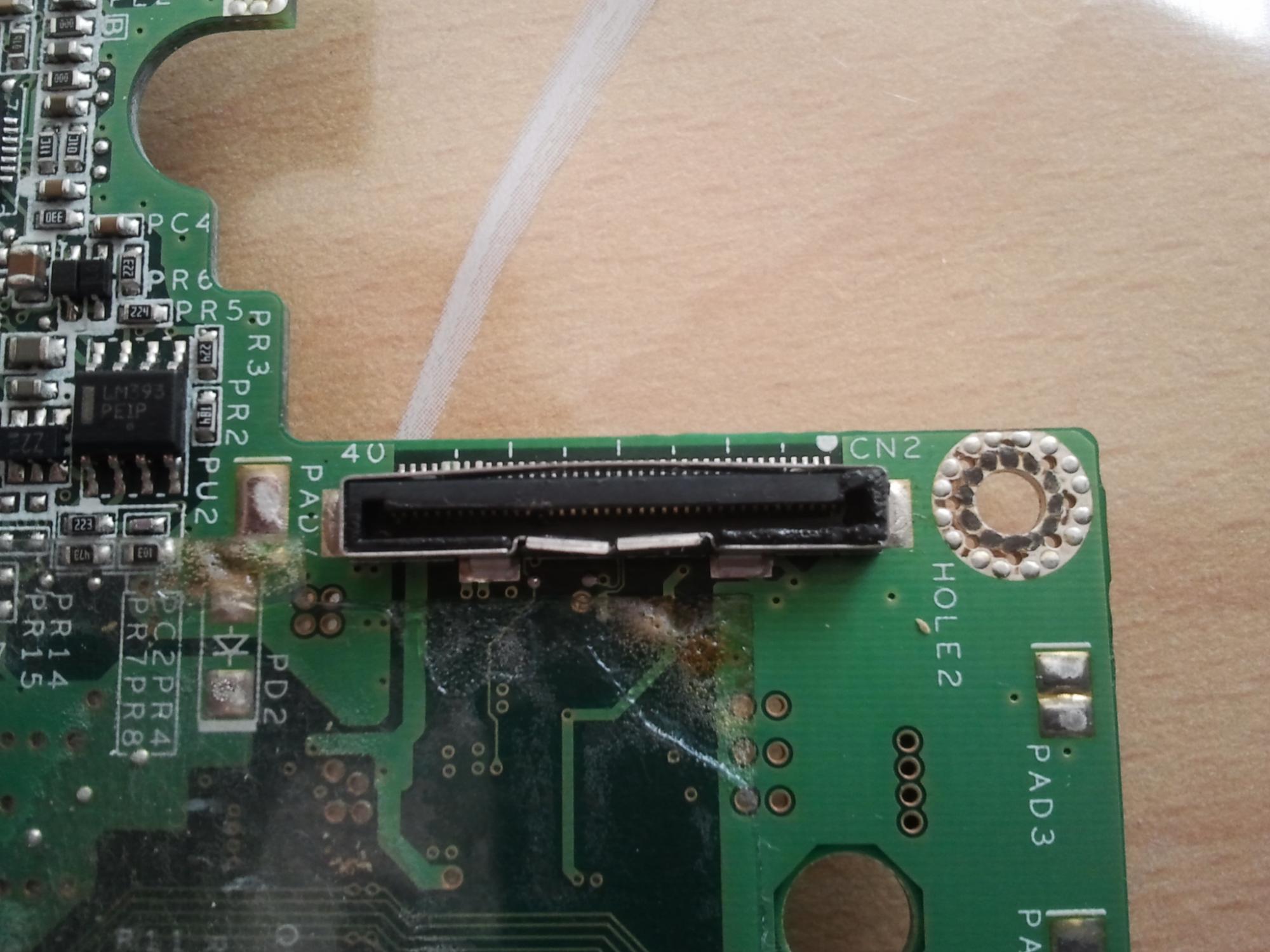

    Acer 1640
    Hi, everybody can someone help me how to desolder this screen socket on an acer 1640, i've tried by heat gun but the plastic inside was started melting.where can i buy this sort of socket.thanks in advance

    Re: Acer 1640
    To remove you can try Chip Quik, video can found here http://www.youtube.com/watch?v=FTQqjggeklo

      Re: Acer 1640
      give a good quantity of past to the pins of the socket.
      put hotgun under the socket (opposite to the board). it will be easily removed.

        Re: Acer 1640
        Thanks man for reply!!!
