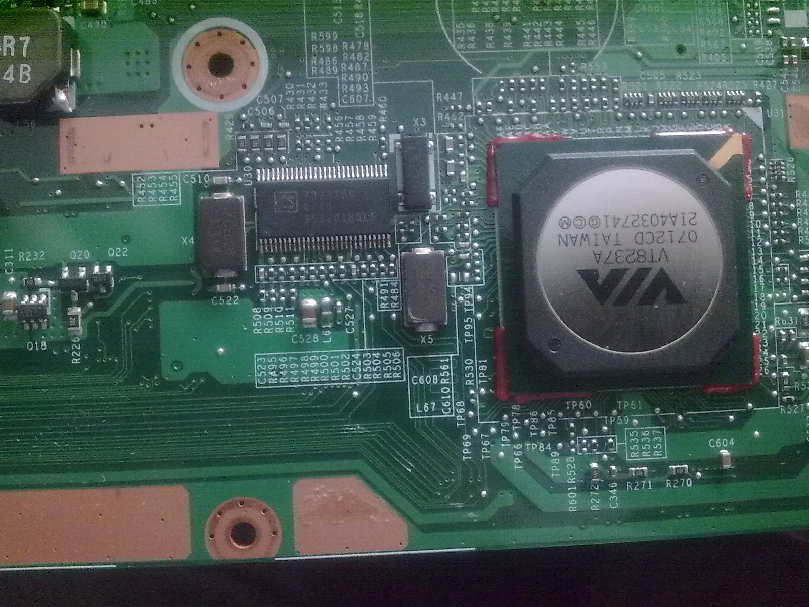

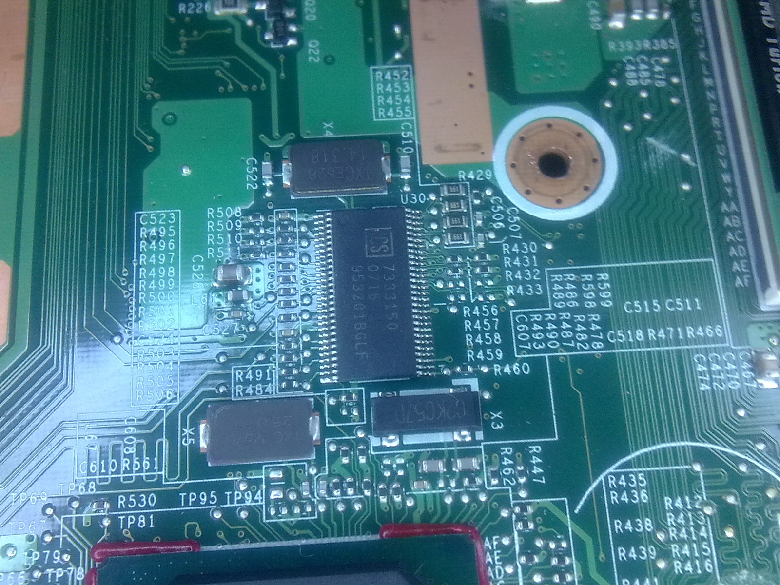

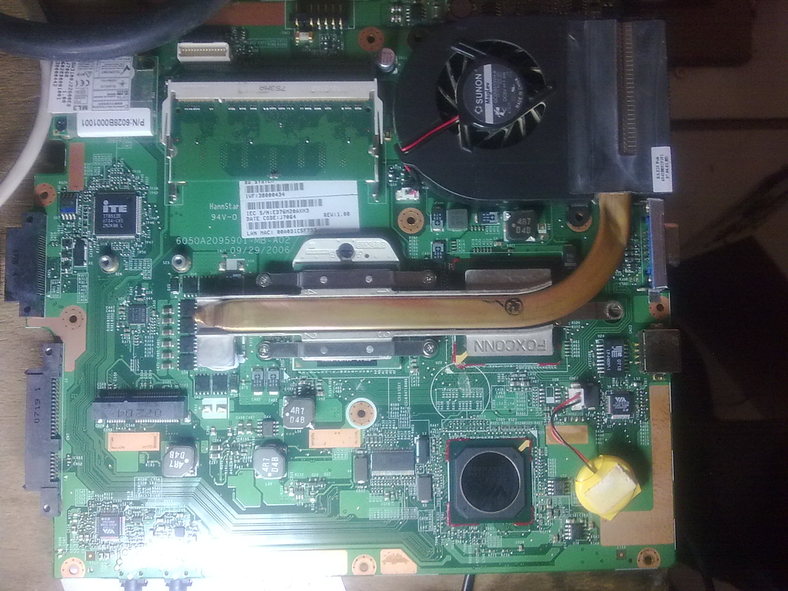

    i have attached pics of this laptop mobo, it gets on detect hdd and charging ok only display not comming on lcd or external.One ics near Via Chipdset named ICS 7333150 this ic getting heatup. plz tell me whta to do next while no bad i cap arround this ic

    Well this problem in AMILO Pro Laptop could be two things,first remove Cmos bat and waiting 1 minute (remove battery and charger firts), put Cmos bat,battery and charger again,turn on, wainting five minutes (on),turn off (in button power and turn on.
    If the problem keeps the only solution is replace de BGA GPU VIA VN896.
