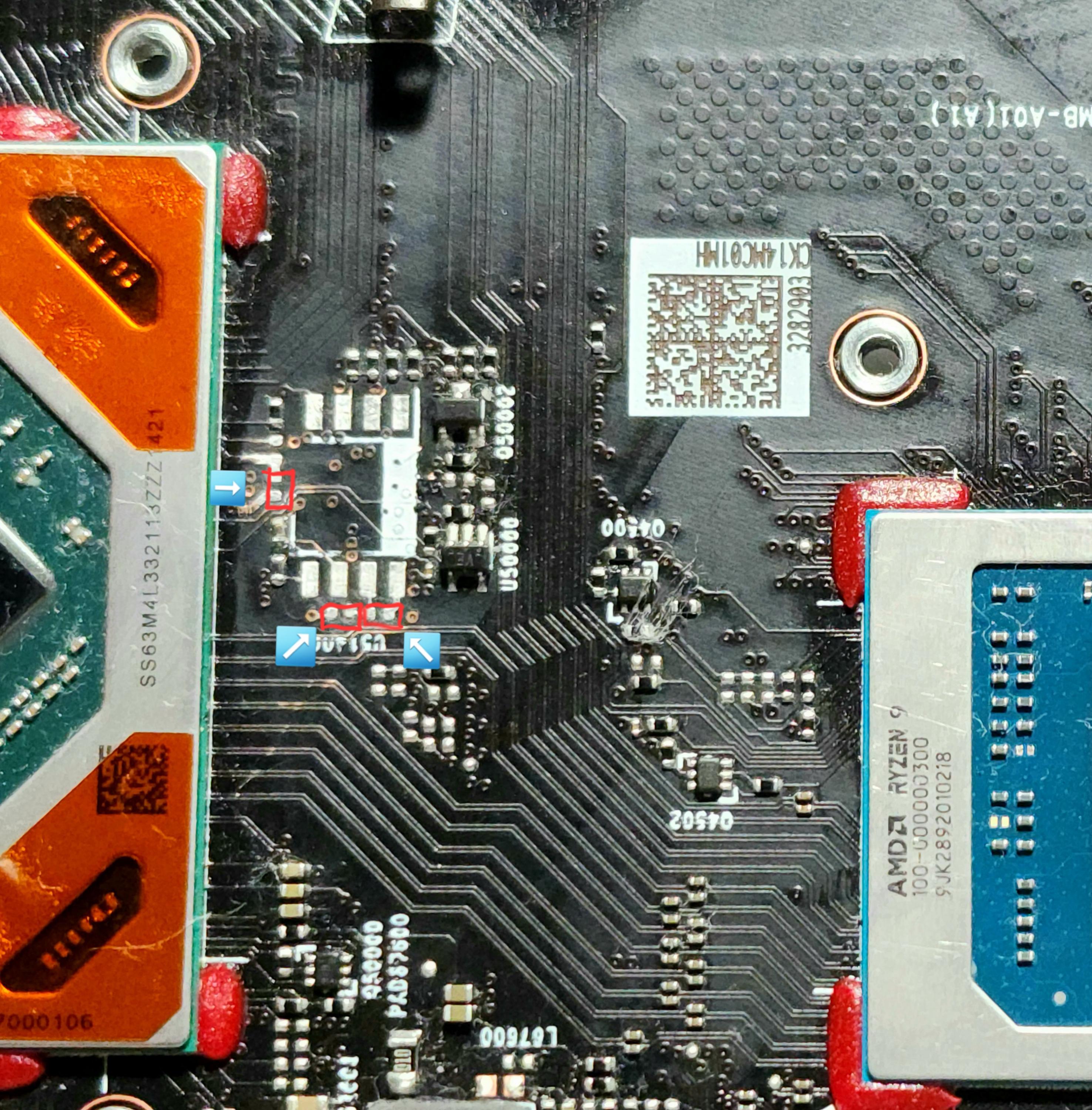

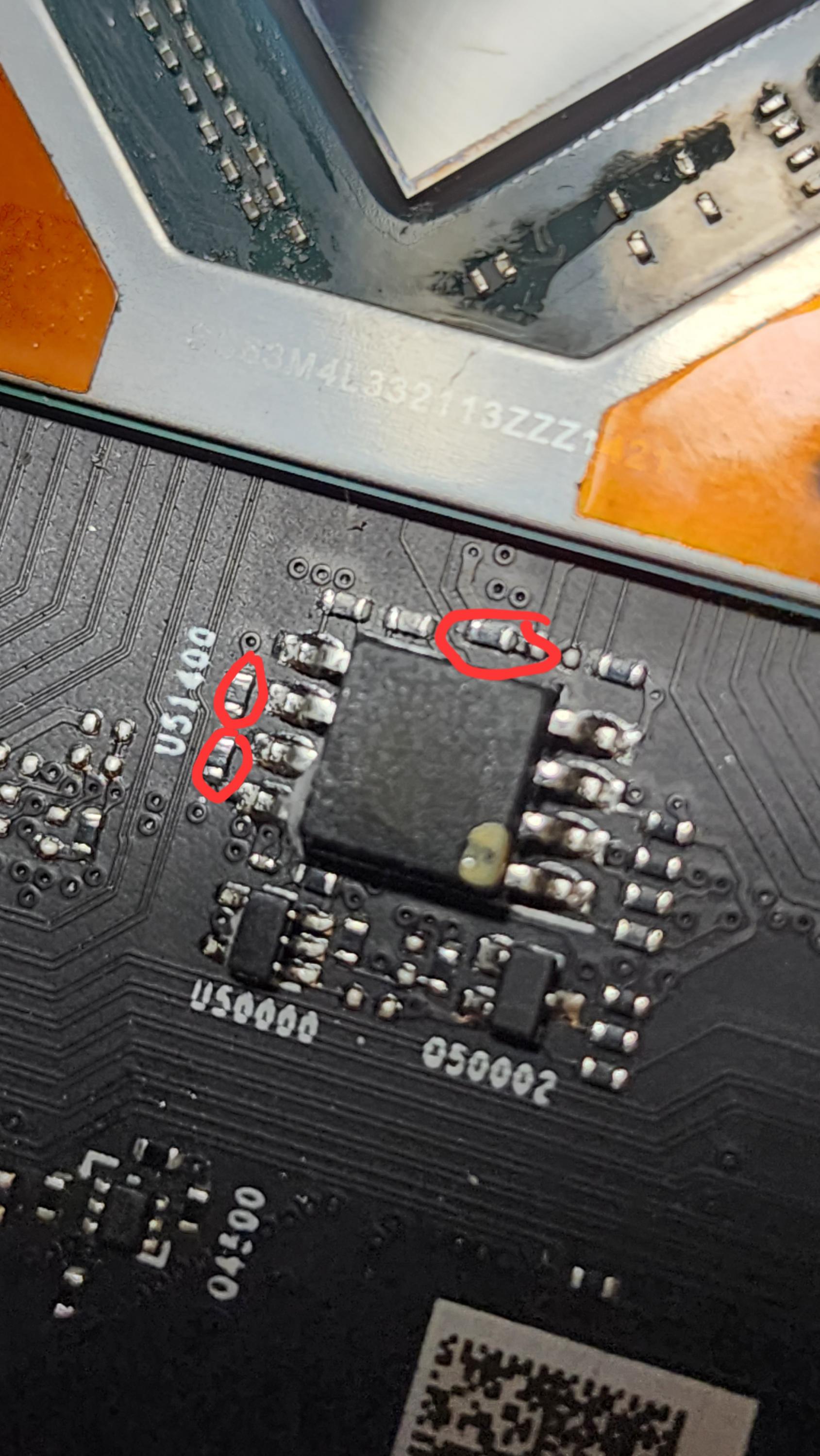

    Hi guys. I picked up a free laptop from my brother after he bought it desktop to replaced his laptop. It wouldn't boot but it does turn on. I figured it need a bios flash.
    I didn't do my research be hand and removed the Vbios instead of the wson8 chip near the cpu. When I removed the Vbios a few of the resistors near it came loose and I got lost.
    As of now there isn't a schematic or boardview of G713-6050A3254002 motherboard. The closest thing I did find was the g533QS motherboard. Almost identical except for the Vbios layout.
    The resister for pin 5&6 are the same the g553qs on my motherboard. Pin 7 & 8 and the one above pin 5 is the ones I can't figure. I tried cross referencing other AMD GPU schematic but they all use different value resistance compared to mine.
    If anyone have a g513qy board that is currently being repaired I'd greatly appreciate it if you measure the resistance value for me

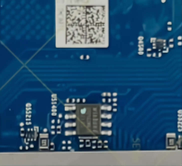

    Hi, did you solve the problem? I have the motherboard out and i can tell you the values. I do have the same problem, my laptop turns on few sec without image. i want to flash a new bios but i dont find this bios chip model in my programer softwere
