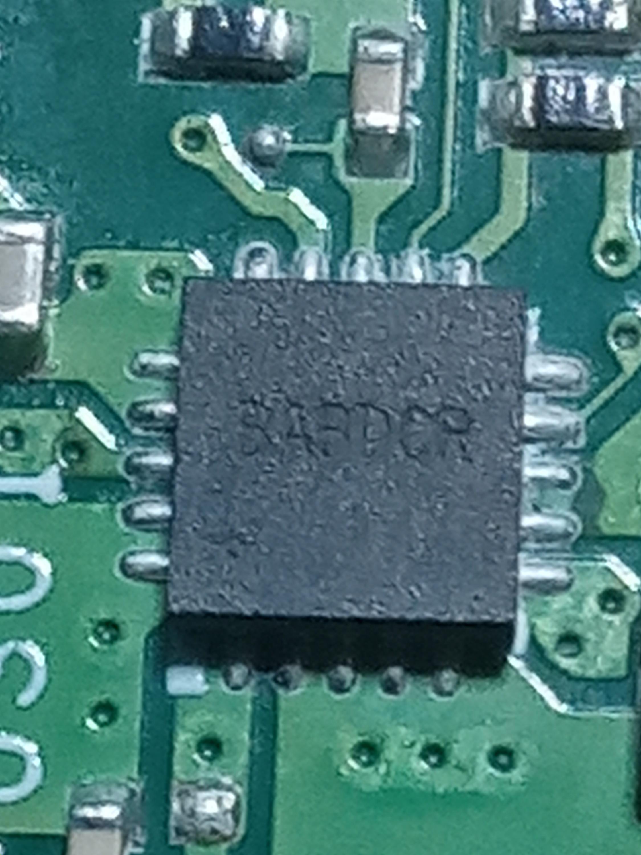

    i can't find anything what type of chip used to generate +3VALW, since schematic & boardview not contain info about the chip.
    hoping someone could recognize the chip or the equivalent i can use, i used schematic & boardview from https://www.badcaps.net/forum/showth...light=la-l141p
    is it normal to have 100-120 ohm resistance to gnd on +3VALW line?
    picture of the chip (PU301) attached. Thank's
    Board number: GH4UZ LA-L141P Rev: 1B
    • 21209
    Re: Acer Swift 3 Component Identification
    Silergy - https://www.badcaps.net/forum/showthread.php?t=90619
      thank's man
      you were indeed "super moderator"
