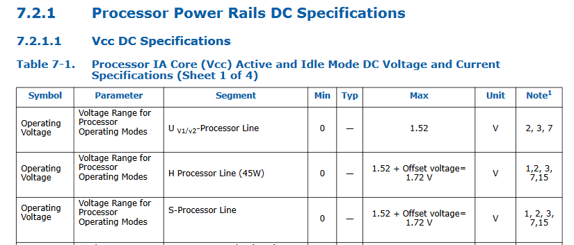

    The board doesn't boot when the power button is pressed. The charger LED comes on when it is plugged in and when the power button is pressed, the main voltages are present on the board, the fan spins and the power LED comes on, but there's nothing on the screen (neither the built in one nor the HDMI out) and the keyboard doesn't light up.
    The first and possibly only thing concerning now is VCCIN for the CPU. After the board has been powered on for 30-60 seconds, the CPU heats up quite a lot, and the two output regulators(? not sure that's what they are) get *very* hot, to the point where I can't touch them for more than a second or two. I measured 1.8V at the power supply output for the CPU and (I'm not sure this is relevant) I measure around 80ohms from VCCIN to ground. I had a dig through Intel's datasheet for 10th gen CPUs, and, if I'm understanding it correctly, the voltage should not exceed 1.52V.
    Where I've measured is the output of the two things in green boxes at the top in this photo from another post about this motherboard on this forum (the bottom green box for the DRAM measures the correct 1.2V).
    Does this mean that the CPU has been waaaaay overvolted and is now toast? I've found one other case of this motherboard with this issue online but the poster didn't update with what the problem ended up being.
    Edit: Attached screenshot from the datasheet. It's from Intel doc number: 615211-008

    Re: HP Pavilion 14-ce3514sa G7AL-2G DAG7ALMB8C0 REV: C diagnostics
    Incorrect datasheet. Core i5-1035G1 is from Ice Lake family and that has FIVR.
    • mcplslg123
      • Jun 2015
      • 7262
      • india
      1.8V at Vcore is correct for 10th/11th gen cpu.Absolutely sure.

        Ah, well that's good news! Thank you both
