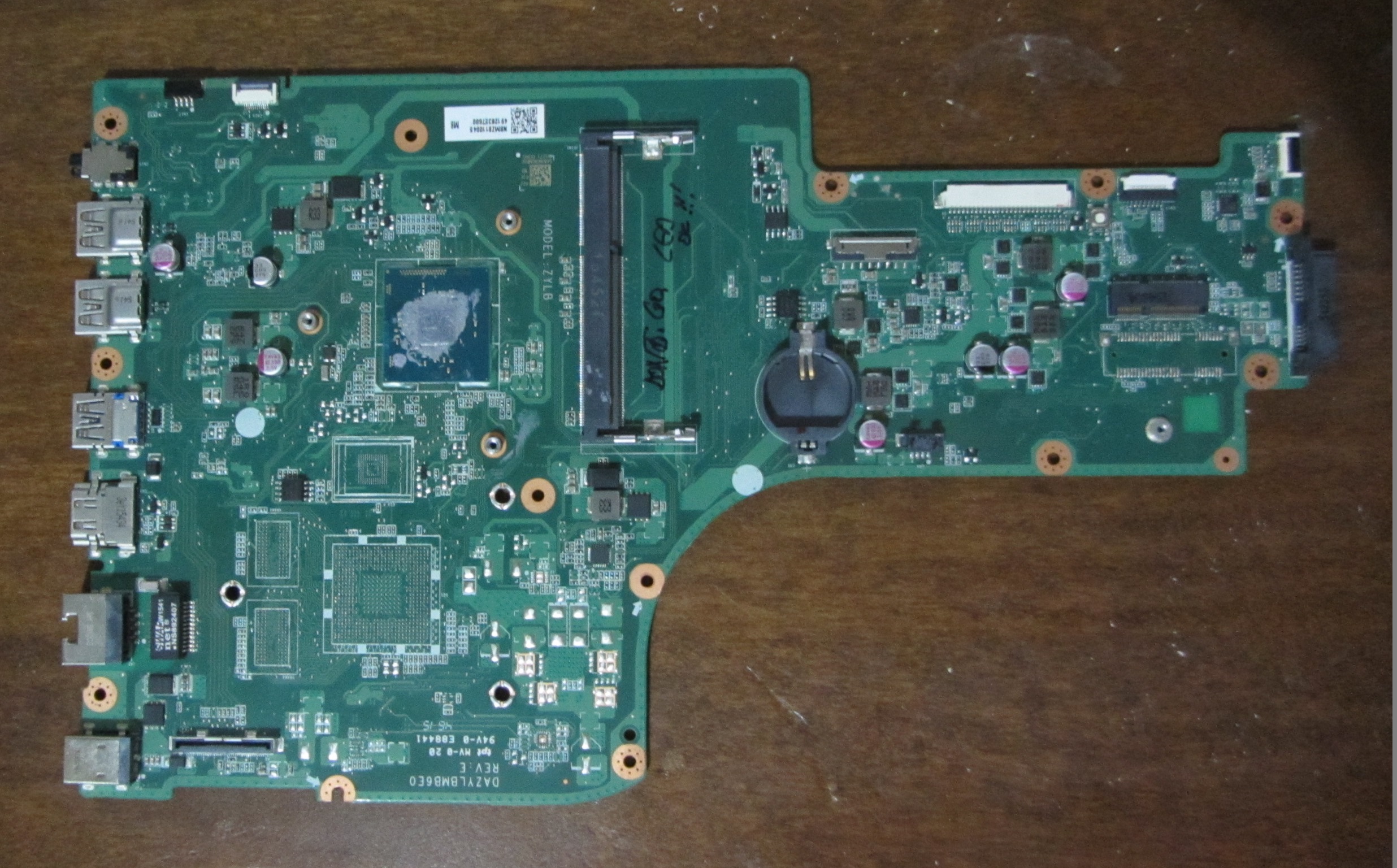

    Hello Guys,
    I have to reflect the bios of acer aspire ES1-731, motherboard DAZYLBMB6E0 REV:E.
    Can you tell me where the bios chip is located? Thank you

    Re: Acer Aspire ES1-731 ..where is the bios chip located?
    One is near GPU,other one near cmos battery socket.
      is it possible to reflash both with the same bin file?
        You need to look for the code on bios chip to determine the size of the chips. Usually one will be main bios and the other may be EC or TBTrom. the file for both will be different.
          Thanks!You have been very kind.
