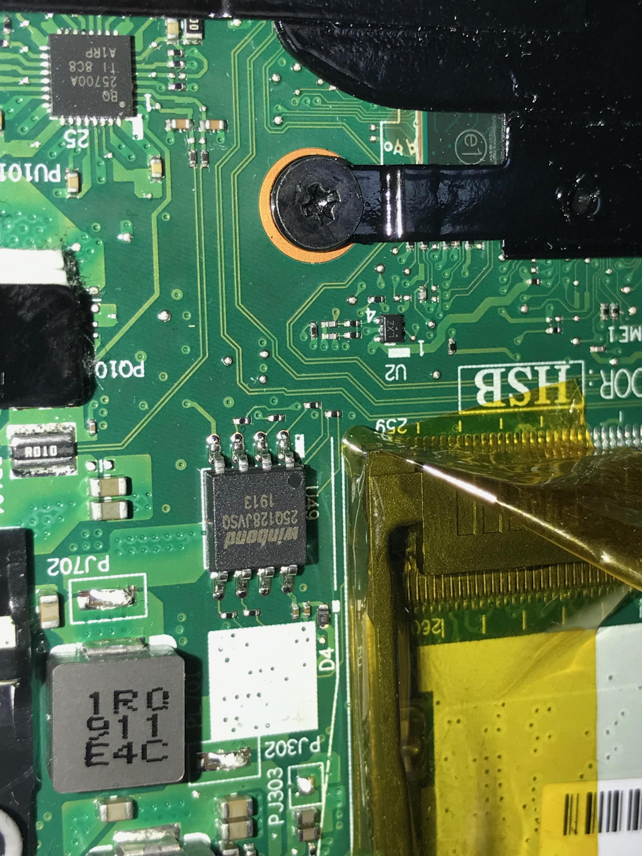

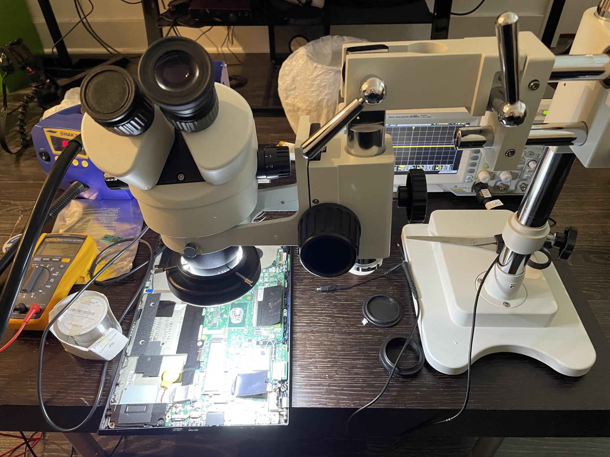

    I'm trying to remove the Intel ME from the bios firmware. I have a black CH341A that I modded to correctly drive 3.3v to the chip instead of the default 5.0v. I was able to connect the soic-8 alligator clips to the W25Q128JV (U49) and successfully dump the bios, run me_cleaner, re-flash the bios with the updated firmware. However, now it seems that I bricked it completely. I press the power button and nothing happens. Blank screen. The power button does not blink 3 times, it does not play musical sounds, nothing. I then re-flashed the original firmware, and same thing. I checked the voltage on U49 VCC and it's at 1.6v, which is weird since it should be 3.3v. I ended up removing the bios chip, and then if I plug in the power, at least the power button flashes 3 lights. I then checked the voltage on the vcc pin, and it is now at 3.3v. So at least I know it's being powered. Note that I removed the ssd, ram, and battery so I can isolate the problem. Any ideas? Please help! Thanks.

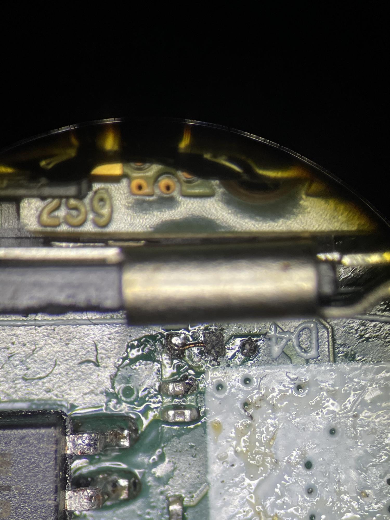

      I figured out the vcc on the bios chip is 1.6v because of the voltage drop across the diode.
      3.3v ---> diode ---> 1.6v @ vcc
      Guess this is normal then?

        nope, bios chipset is powered with 3.3V, check diode or bios chipset is burned. I have a recent photo of bios chipset from T480s, check if you didn't damage any component around bios chipset. It happens often when you use clamps to read/write bios chipset.

          Thanks for the tip! I checked the diode and and it was damaged.
          I temporarily replaced it with a copper wire and vcc now shows ~3.4v.

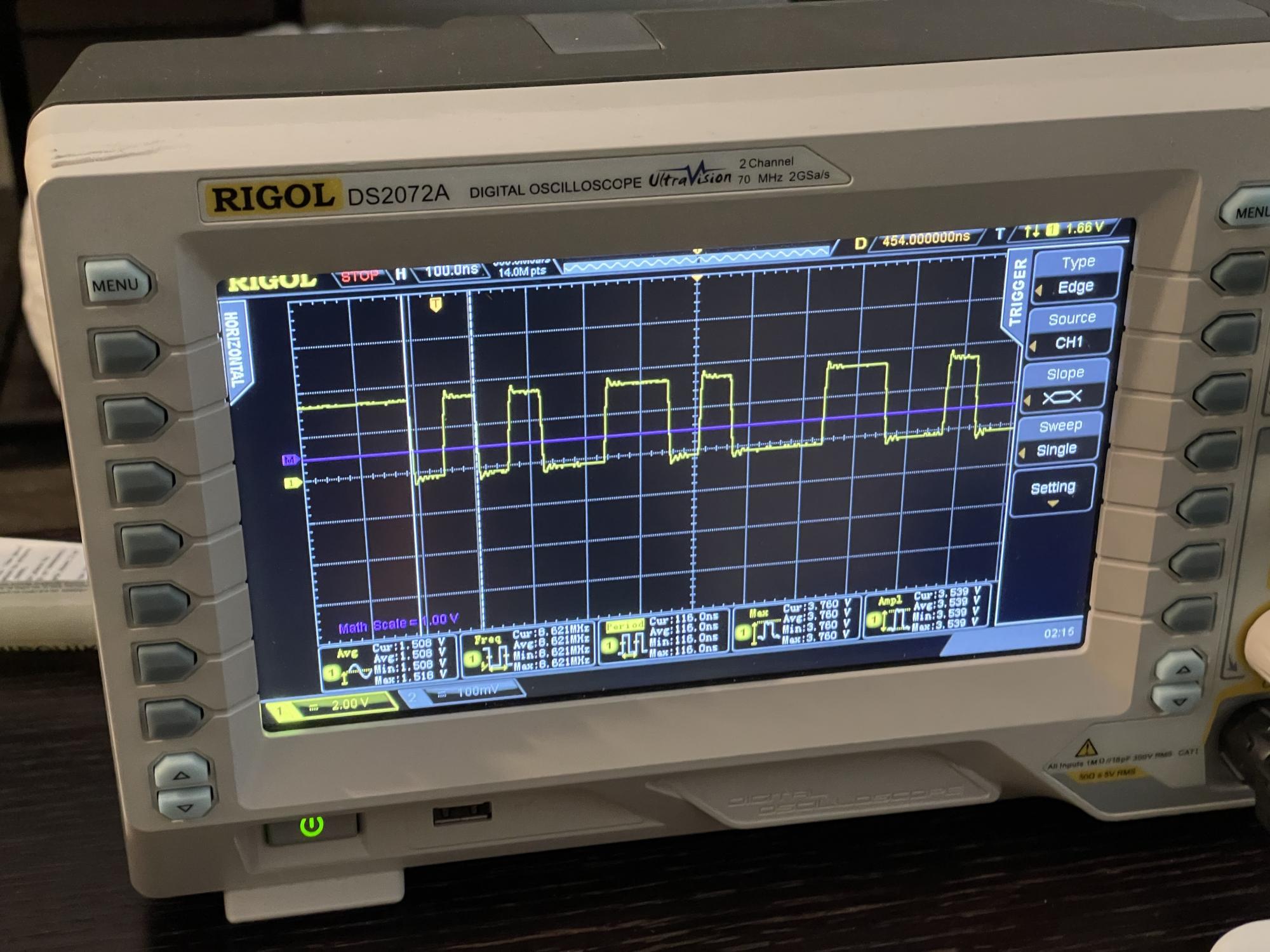

          I used an oscilloscope to probe DO and I can verify it's getting read out!
          The keyboard lights up now and the power button blinks 3 times, but it's still not booting.
          I tried re-flashing the original firmware dump and it still just blinks 3 times.
          Any ideas what I should try next?

            that means you didn't read content of bios chipset properly or you didn't solder well chipset but most probably you failed to read chipset with CH341A, that's why masters of this forum recommend to read chipset 3-4 times and compare the dumps to see if they are the same. Try bios from the link if your motherboard is NM-B471 REV 1.0 T480s (type 20L7, 20L8) and if it works write your DMI with Lenovo Maintenance utility. And put back a good diode, it has the role to protect bios chipset.

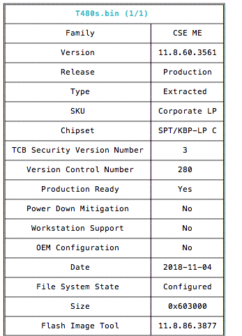

              Re: bricked lenovo t480s - need help!
              I flashed the firmware you linked to and it posts now.
              The firmware however doesn't have the ME cleaned so I ran me_cleaner on it, re-flashed it, verified it twice but now I get musical tones error 0001

                    "want to break another laptop"...what the hell are you talking about?
                    For your information, when I dumped the bios, it did it twice, diffed the binaries and they matched. Pretty sure that is sufficient to convince anyone that it is a valid dump.
                    I'm pretty sure I said the wire was temporary so I can verify that the flash chip was working correctly. Do you understand English my guy?
                    Look at the images. The firmware you linked to doesn't have the HAP bit set, but the modified firmware that I ran through me_cleaner *does* have it set. Want to explain that.."master"?
                    this is me_cleaner btw: https://github.com/corna/me_cleaner
                    I don't know how much you know about "ME cleaned" but since opening with MEAnalyzer and shows you "Configured" and not "initialized" it means it's a CLEAN ME firmware. So my supposition that you failed to read bios chipset was correct. Next time when you want to break another laptop consider READING BIOS guides, methods, resources and tools made by master piernov, it will help you to understand what a BIOS is and what it wants from you. Telling me "The firmware however doesn't have the ME cleaned" made me understand you don't have a clue of what you are doing: 1st you failed to read bios, 2nd you succeded to burn diode and replaced with a strap, 3rd I pointed you a working bios yet you "succeeded" to break it. No offence but you better start knitting instead "repairing" laptops ...
                    https://www.badcaps.net/forum/showth...t=phoenix+bios

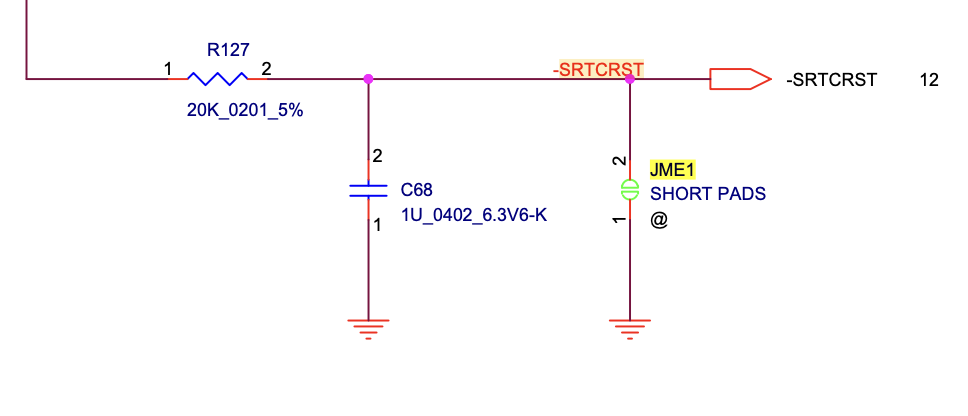

                                if you bridge it, it shorts SRTCRST to GND..guess you think you're pretty funny huh

                                  good, so you have schematics of motherboard! and what does SRTCRST want from you? 2 tries left ...

                                    it's not something want to do:
                                    For ICH9/ICH10/IntelĀ® 5 Series Chipset and IntelĀ® 3400 Series Chipset, SRTCRST# is used to reset portions of the Intel Management Engine (Intel ME) and should not be connected to a jumper or button on the platform. The only time this signal gets asserted (driven low in combination with RTCRST#) should be when the coin cell battery is removed or not installed and the platform is in the G3 state. Pulling this signal low independently (without RTCRST # also being driven low) may cause the platform to enter an indeterminate state. Similar to RTCRST#, it is imperative that SRTCRST# not be pulled low in the S0 to S5 states

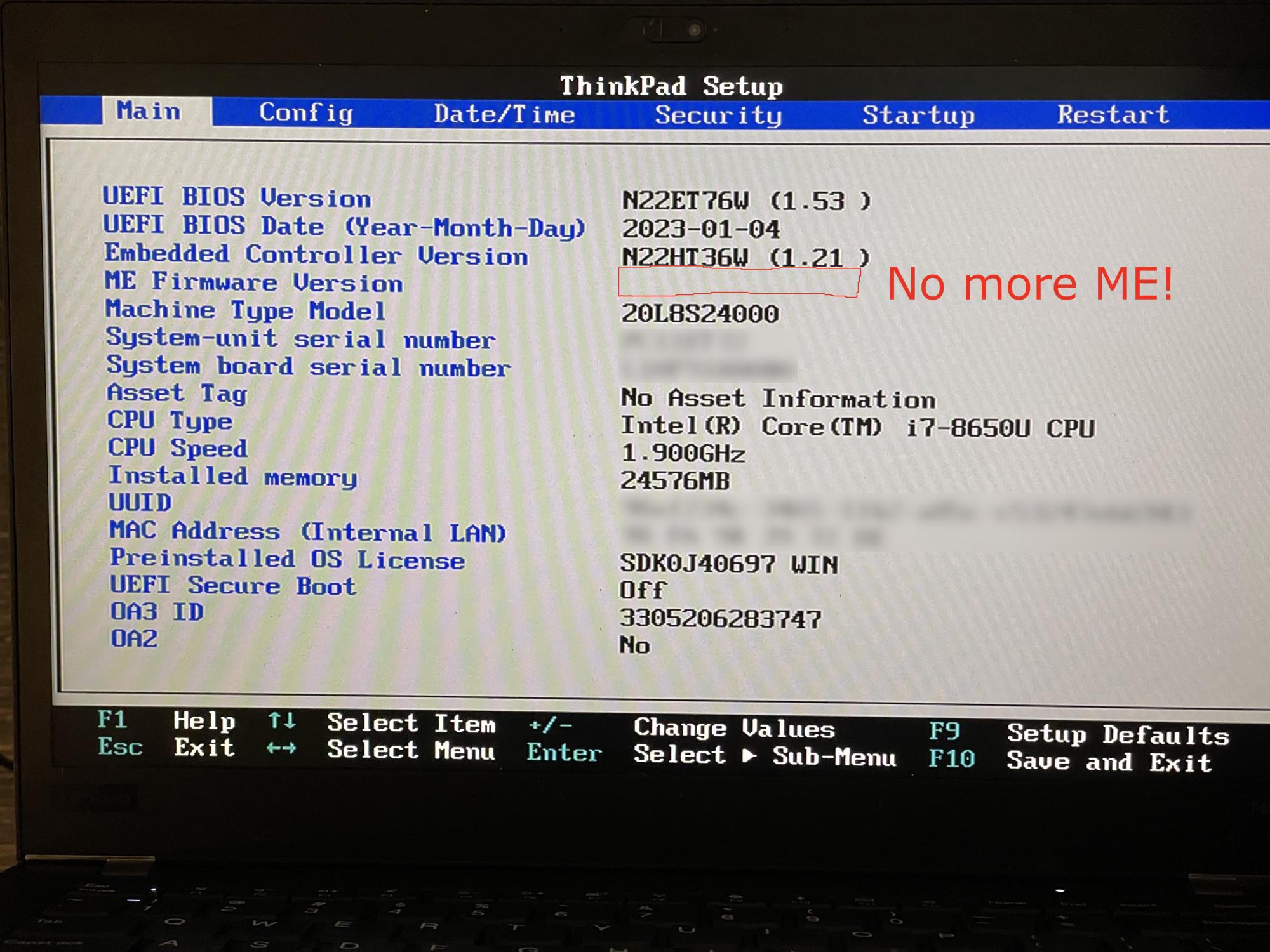

                                        I got it to work. I successfully disabled the Intel Management Engine.
                                        I want to share my findings just in case anyone runs into the same issues as me.

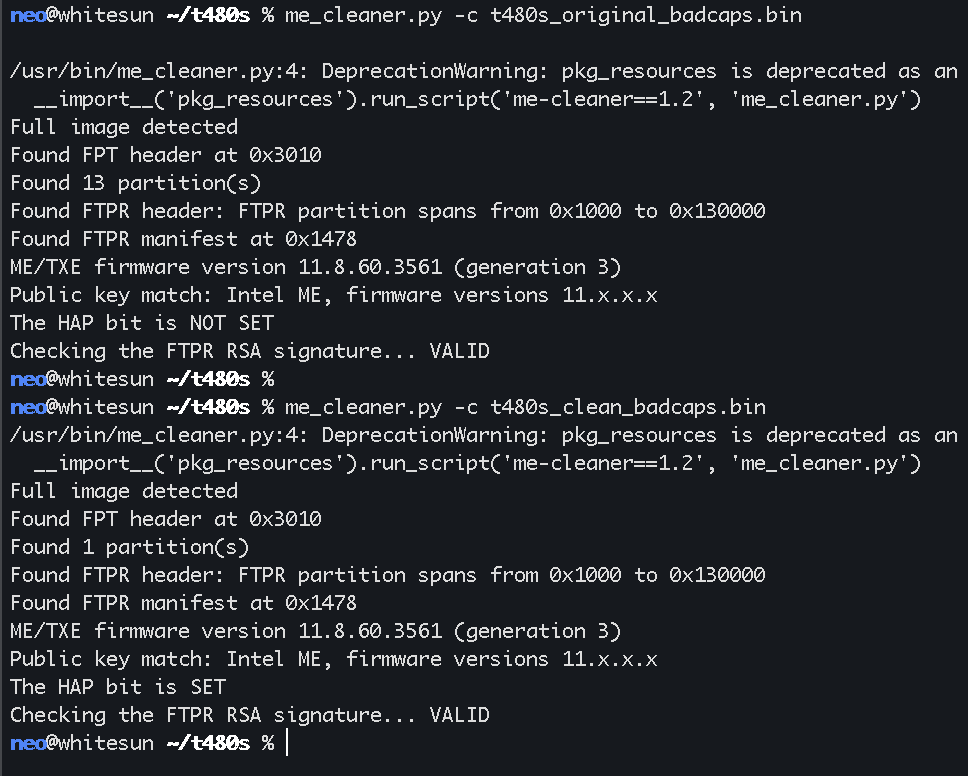

                                        Originally I ran me_cleaner.py like this:
                                        me_cleaner.py -S -O t480s_clean_badcaps.bin t480s_original_badcaps.bin
                                        The original bios firmware has 13 partitions. This removes too many partitions and will brick it.
                                        Based on this blog post from Purism, they recommend to set the HAP bit, but also whitelist the MFS partition and remove the rest, because it is required to correctly initialize the cpu. I tried this, but still had issues booting, so I chose to just set the HAP bit and neutralize the ME as recommended here.
                                        So I ran me_cleaner a second time:
                                        me_cleaner.py -s -O t480s_clean_badcaps.bin t480s_original_badcaps.bin
                                        The output:
                                        Setting the HAP bit in PCHSTRP0 to disable Intel ME...
                                        Checking the FTPR RSA signature... VALID
                                        Done! Good luck!
                                        I then re-flashed the bios and it works now!
