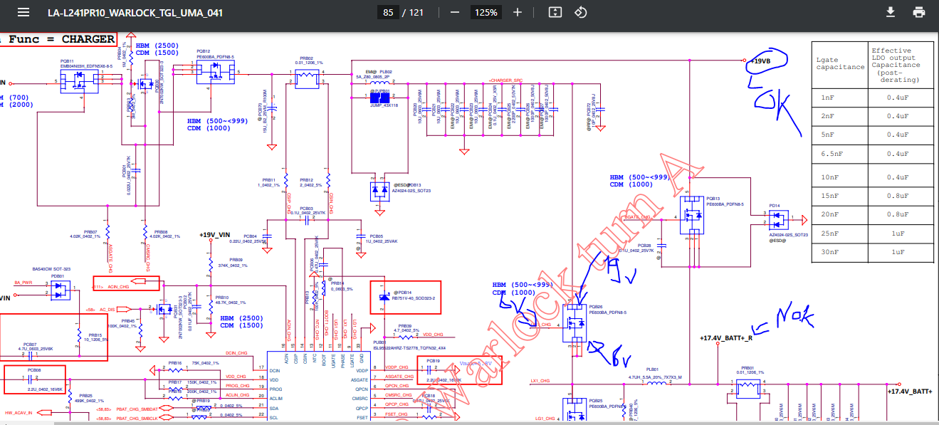

    Hi, Can you help me on the LAPTAOP Dell Inspiron 15-3511 with motherboard GDM50-LA-L241p, it lights up very well with charger but does not charge the battery, the charging light flashes orange, if you put a new battery the pc turns on, but even with a new battery the pc does not charge the battery.
    I'm not very good at schematics, but I believe that pub01 has a problem, it does not deliver a strong enough voltage on the gate (UG1_CHG: 6v) of the mosfet PQ026
    I did not find any shorts or resistance dead, the ISL95869HRTZ is well powered at 19v.
    Do you advise me to change it? I don't have the intensil ISL95522AHRZ chip, but I have an intenseil 95859A, 88748H, 9538H chip, would it be compatible please?
    PQ26 :
    PIN 5 : 19V stable
    PIN 4 : 6v
    PIN 123 : 6v
    battery plugged in : 9V stable but too weak
    95859A (PUB01) : DCIN 19v stable

    It is often caused by a internal shorted DC-IN Mosfet, which is pretty easy and fast to rule out. In your case PQB11 and PQB12

          Yes mode diode 400 and OL and and both are at 19v, I checked all the mosfets, they are all good in diode mode.
          Do you know how UG1_CHG is delivered? I think the problem comes from there

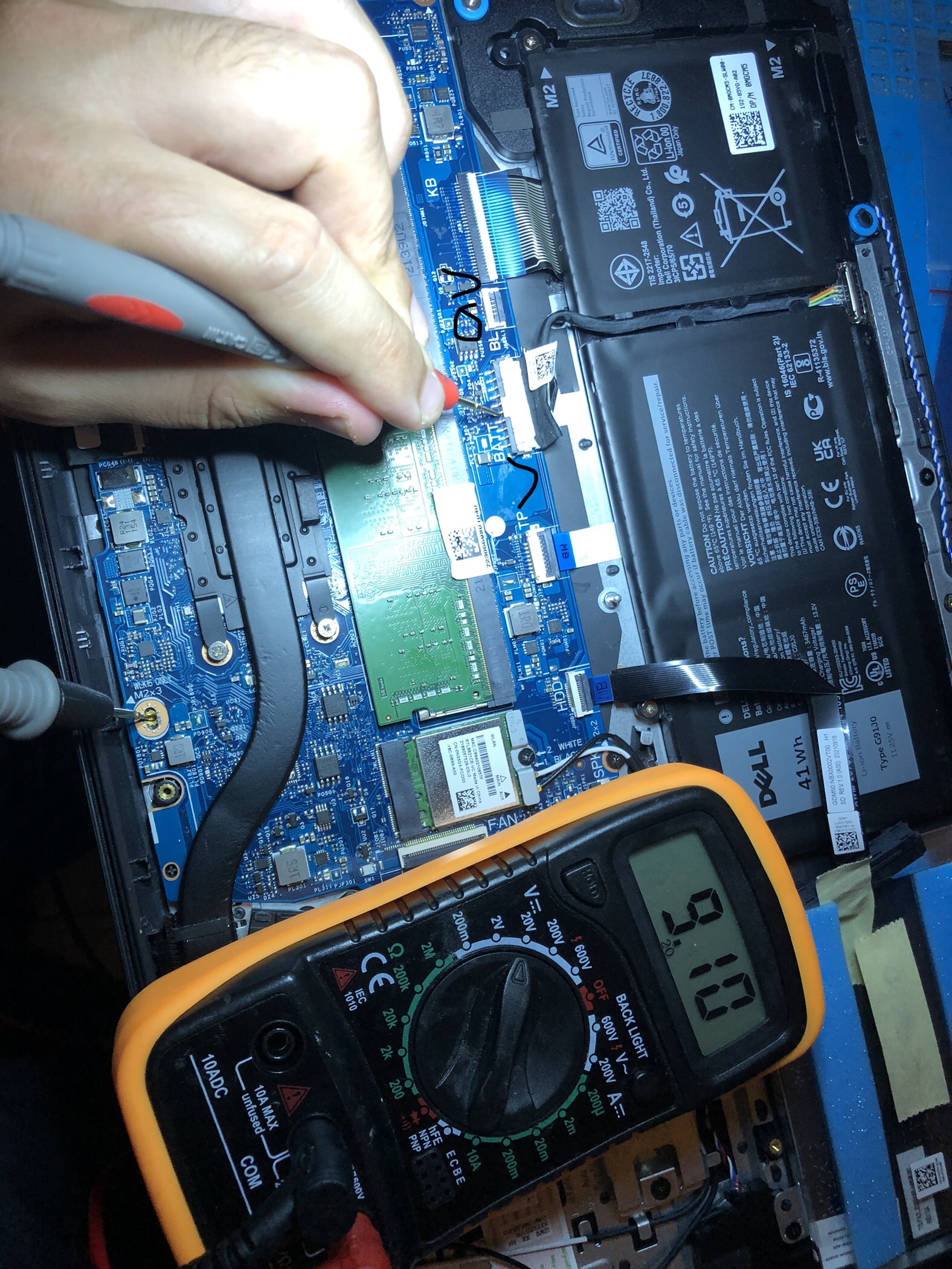

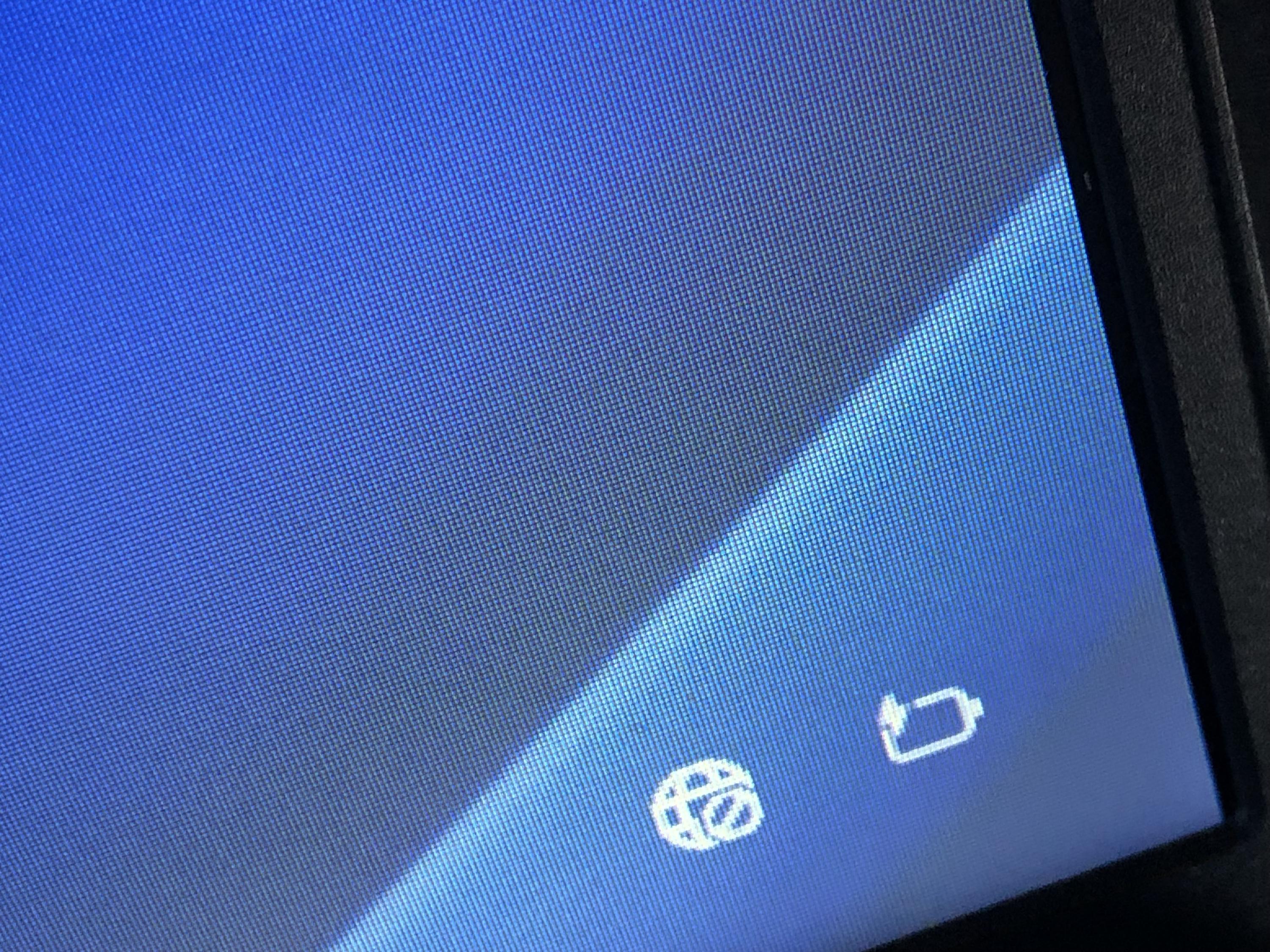

              YES windows shows it is loading
              PIN 123 : 9V25
              PIN 4 : 3V5
              PIN 5 : 9V18
              PIN 6 : 0V
              PIN 789 AND 10 : GND
              +3VALWP : 3V
              +5VALWP : 5V
              +3VALW_EC : 3V38

                      Re: Dell Inspiron 15-3511 NO charge battery
                      Pin5 of battery connector is SMBUS DATA and it cant be 9V under any circumstance. Should be stable 3.3V. findout why its showing 9V.

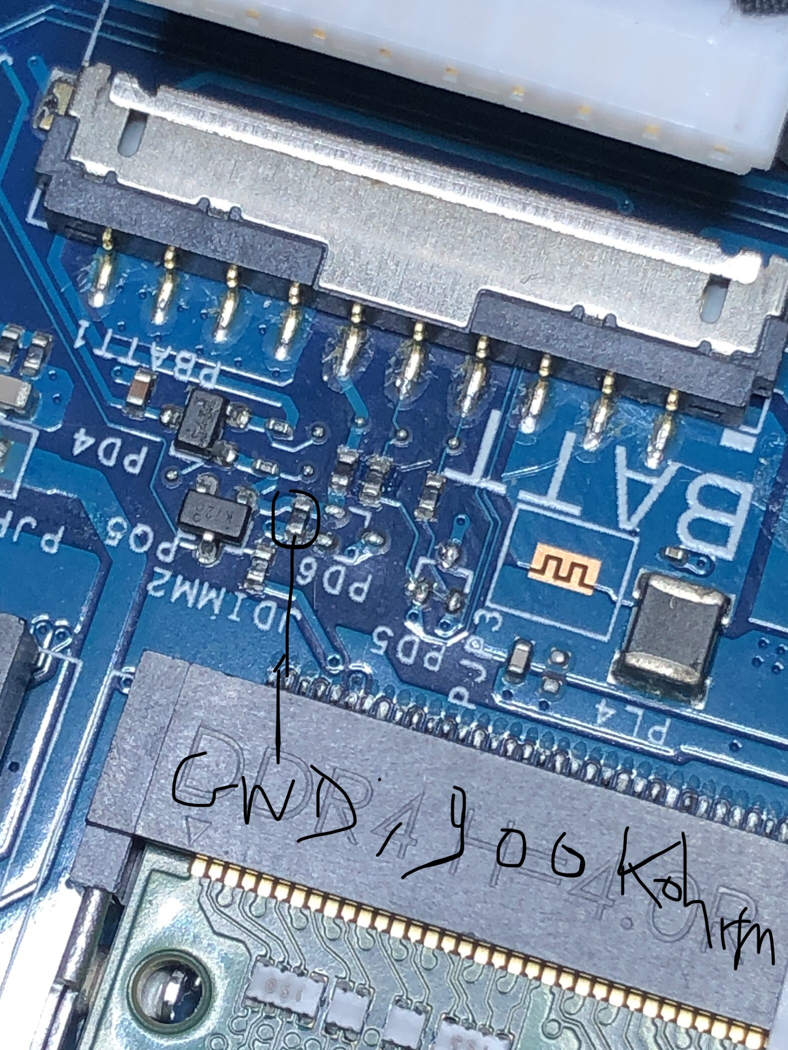

                        I can't find anything on pin 5, +3VALW_EC measures 3V3 and it is stable so I don't understand why DAT_SMB doesn't have it
                        This resistor connected to pin 6 is connected to GND, and measures 900Kohms, is this normal? maybe it's a pair of shorts that burnt out the resistance? I don't know if it's PR39,
