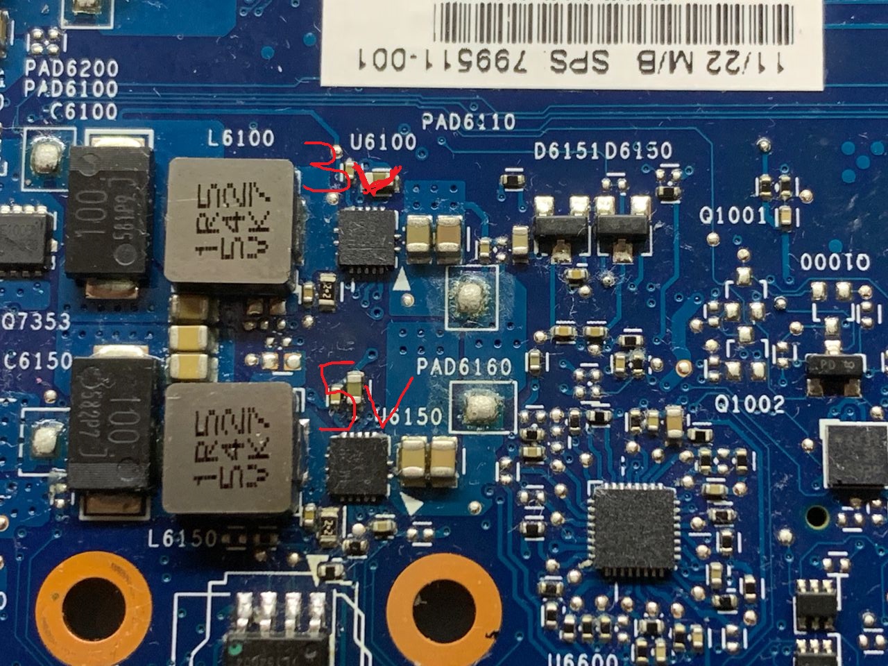

DC-DC coverter,aka load switch, is very likely bad. Its a14 pin IC with 7 pins on each side. Replace them one by one and see if the problem goes away.There can be 2-3 such load switches. -
Re: hp elitebook 840 g2 fan always running
do you mean this ic sir?...L6100 3valwp / L6150 5valwpComment
Load-Switch!
If you have no idea what it is and how to search for a internal(!) shorted component, then share link to schematics, boardview or simply high quality pics of your board, please.Comment

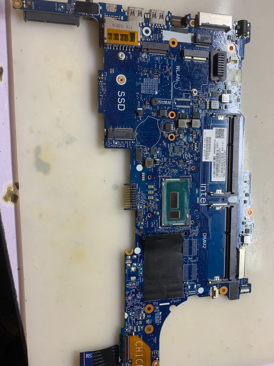

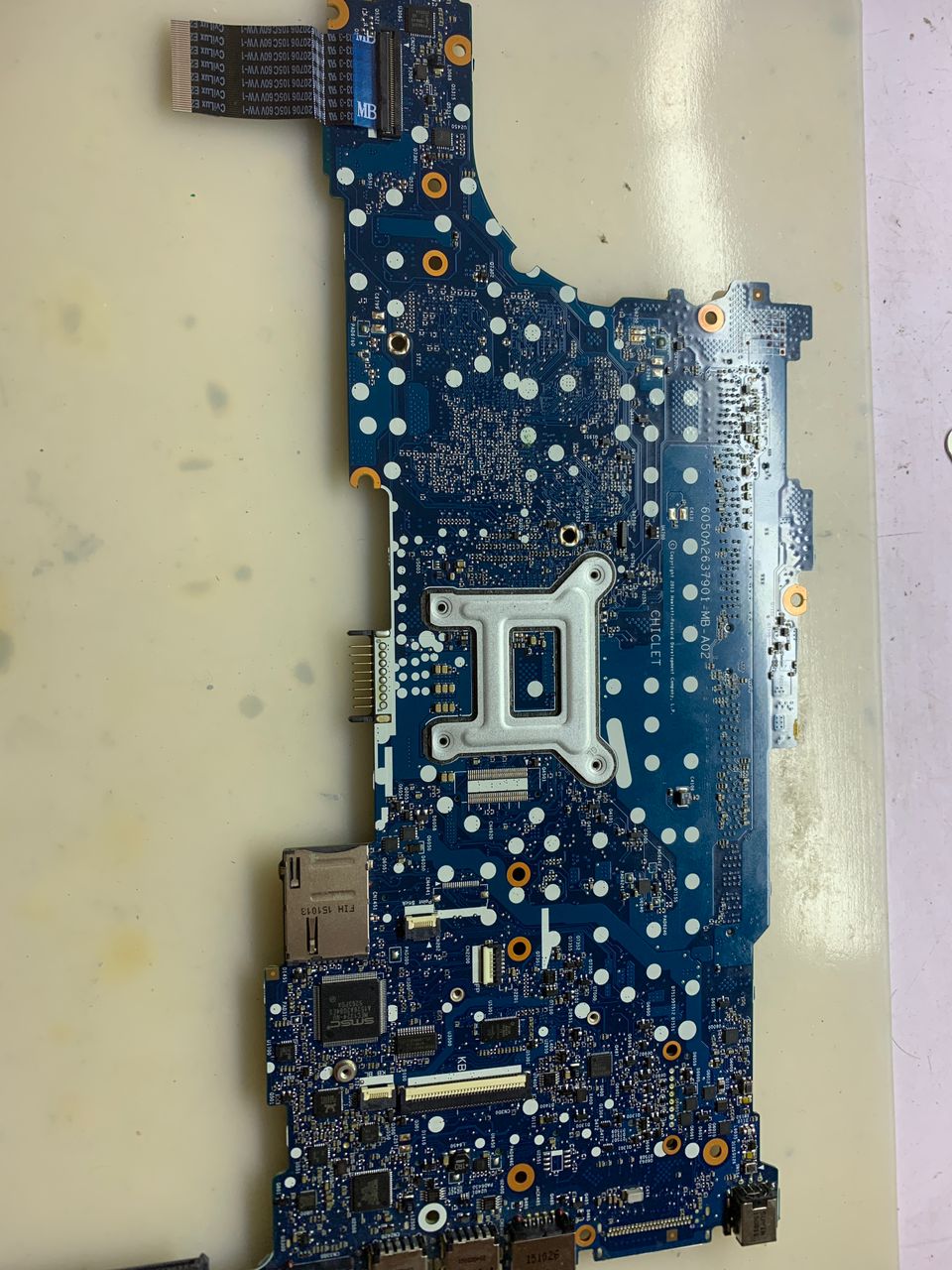

this is the schematic...only found COMET instead of CHICLET
Q7100 for example if it exists by any chanceComment
Each transistor has more than one pin. If you write "q7100 got 5v" we don't know which pin exactly do you mean. So, always specify the pin number, otherwise the measurement is pointless and says nothing to us.
Transistors Q7100, Q7050 pin count:
So, please measure the voltages to ground on pins 1, 3, 4 of transistor Q7100 when the machine is turned off.Comment
