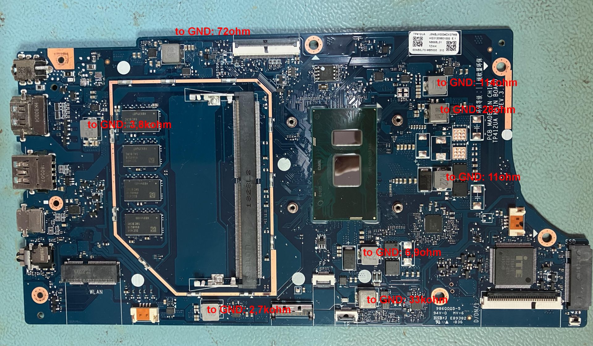

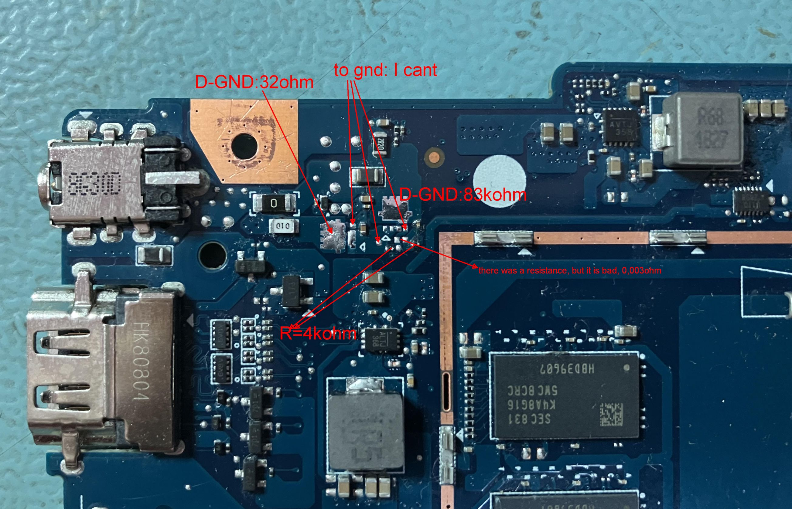

    I would like to ask for help to repair this motherboard. Its shorted. No boardview and schematic. One of the 7466 fet and a resistor (marked in pic) must be faulty. I made some measurements and drew them on the pictures. Thank you for your help!

    When I wrote 'to gnd: I'cant' , the multimeter showed nothing.
      What was the reason you have removed the 2 DC in mosfet ? ( 2nd pic) The readings for the coils are ok sector show always Low resistance
        I measured a short circuit on it. I took them down and looked at them one by one. One is open-close, seems good. The other is shorted.
          Those are in N channel Mosfet what was the reading you got S D G both fets ? The resistor you have a point out is connected to Gate side of one of the Fets
            I didn't write it down when it was on the board. On the left side the resistance was very low. On the right side, the value was much higher.
            now
            S-D: 0.7ohm
            G-S: 274kohm
            G.D: 274kohm
              now
              S-D: 0.7ohm
              G-S: 274kohm
              G.D: 274kohm
              Replace the N Fet and replace the resistor with 4k
                I couldn't find an exact one, just something similar. The original is 7466. Could AON7534 be good instead? The original is AON7466. Could AON7534 be good instead? A few values are lower than the original. And a AON7400A. Here is a Vgs is lower.
                  Yes, this transistor is a suitable replacement. You can use it.

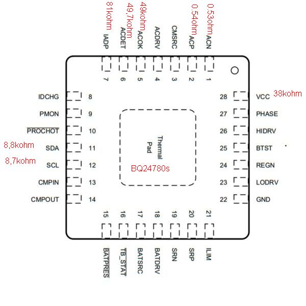

                    Such low readings at ACN and ACP means a shorted main power rail in addition. Likely a capacitor

                      Thanks for the help of those who tried to help. I also found the capacitor that needed to be replaced. I have attached a picture. The laptop works again
