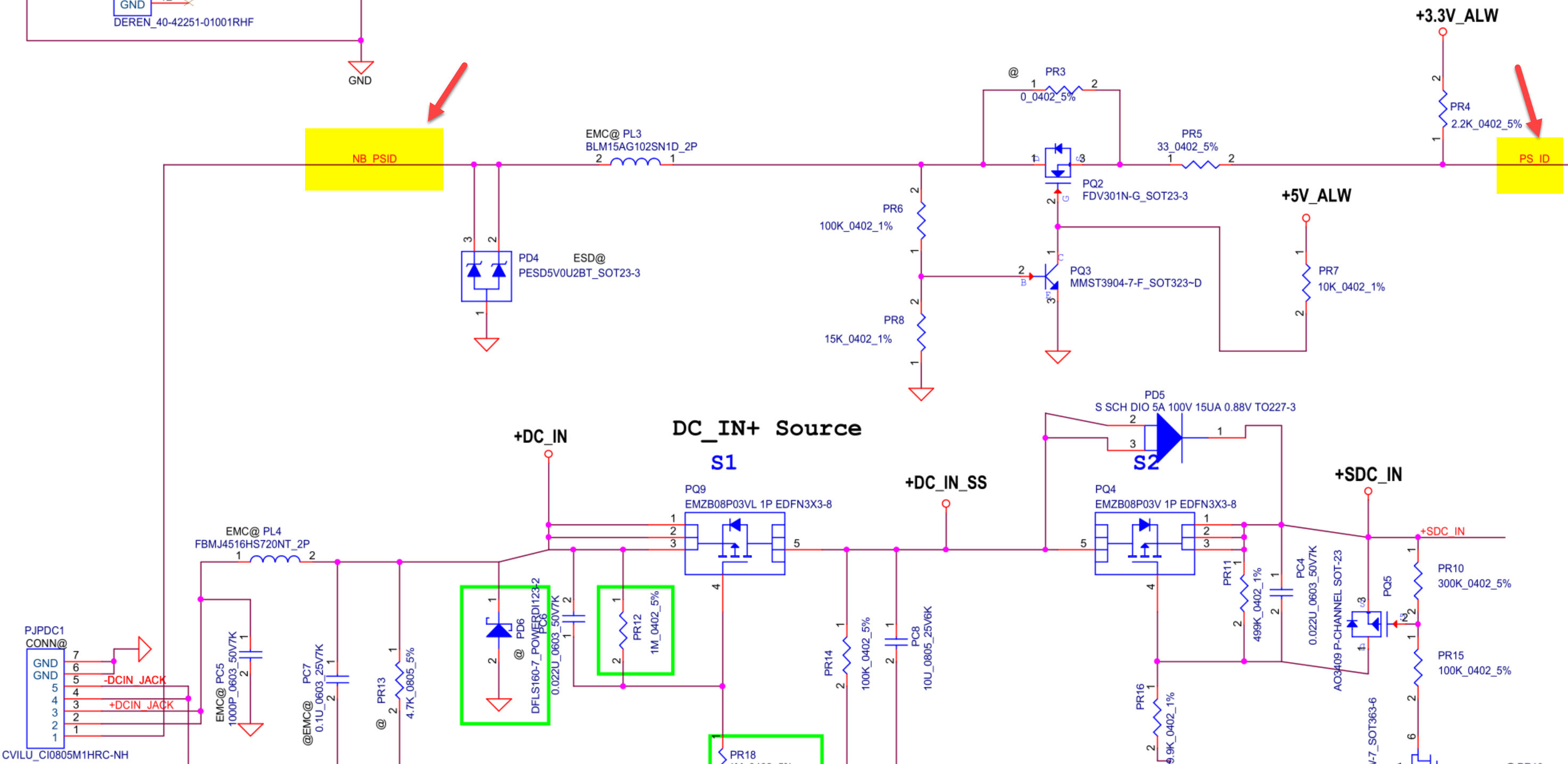

                      Review the power up sequence chart on sheet # 46 in the schematics. Need to review the first one where the voltage is absent that will halt the boot process.
                      Update:
                      Just read your last post. Are you using the barrel style power adapter? What are the specs? Is it the exact and recommended power adapter for this model?
                      Dell power adapters (as documented many times in this forum) use a single wire communication to determine if the power adapter is worthy enough to power these pigs of laptops.
                      Carefully measure the voltage to ground of the following points of interest:
                      NB_PSID @ PL3
                      PS_ID @ PR4
                      If the adapter ID mechanism is broken (quite common) - then the laptop will not boot as it believes the power adapter is wimpy and incapable of being used.

                        THANKS FOR THE INFORMATIONS.PSID IS OKEY 3.3
                        STILL I FEEL BIOS ISSUE YOU CAN REPAIR MY BIOS
                        BECOUSE NOW I HAVE SIX MORE PIECES SAME ISSUE
