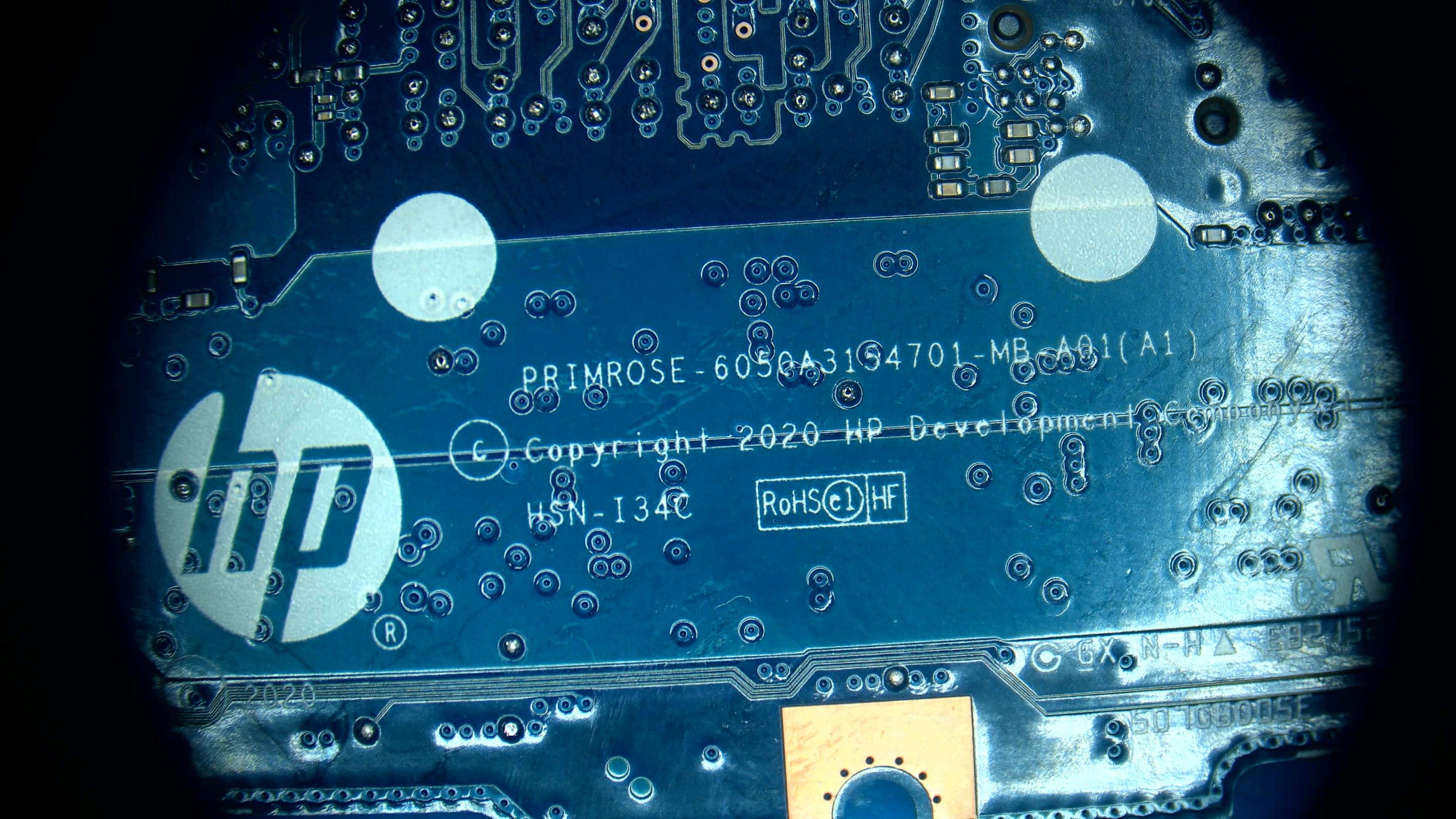

    Hi, everyone.
    I need help on this one, please.
    Liquid-damaged motherboard.

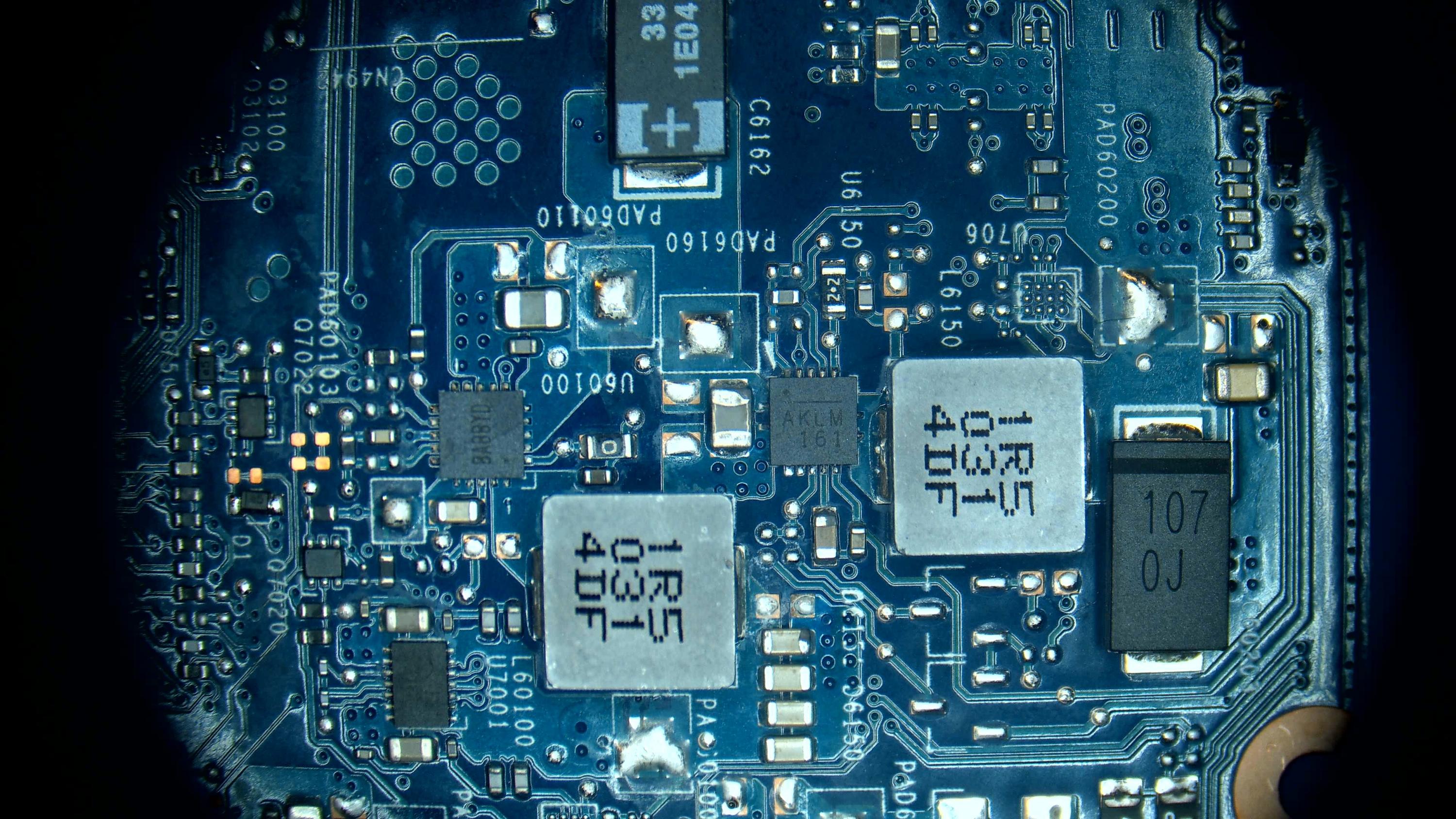

    After reflowing the corroded areas and doing U.S cleaning it still won't turn on and there is no light on the charger.
    The problem is that I can't find schematics. 3.3V LDO is up, but not the 5V LDO. The IC that created the 5V line is AKLM 161 and I can't find a datasheet for this IC.
    Thanks All.

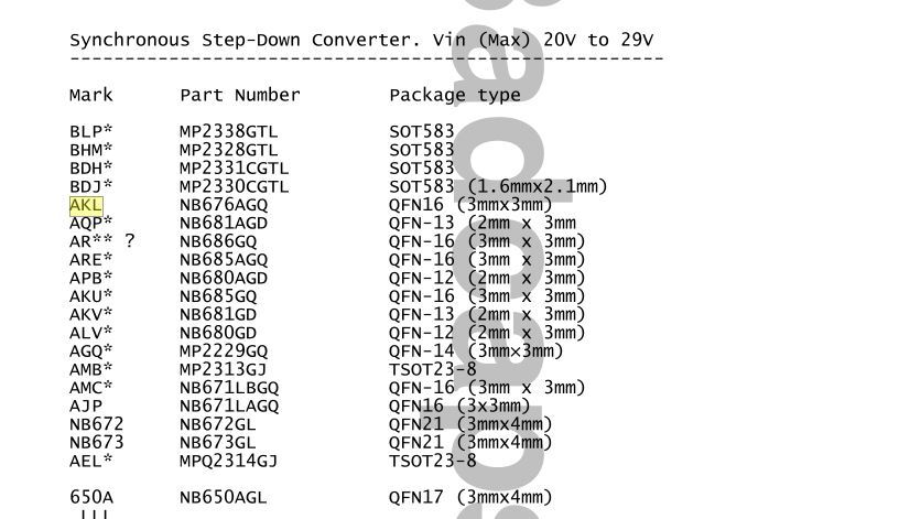

    https://www.badcaps.net/forum/showpo...85&postcount=3
    You`ll find AKL in the "Marking List April 2022.pdf" attached to that post.

        hi sir..i dint find marking list april 2022.pdf on that post...im looking for AKLM ic part number
          • 20833
          Its there if you search. There`s no * after the AKL ,its a small mistake
