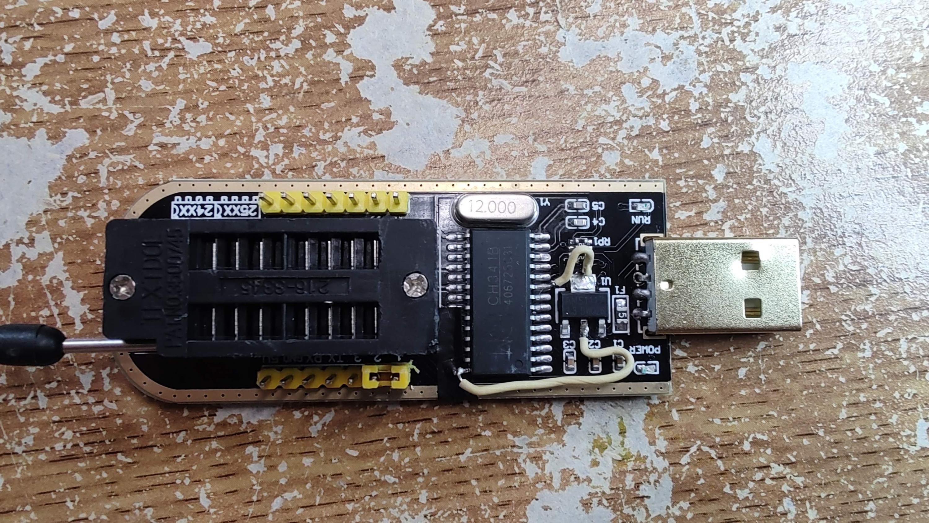

                I follow the description.
                I did the mod on the programmer /image attached/
                And I followed this link what was in your link /01/:
                https://winraid.level1techs.com/t/gu...rammer/32948/2
                version 1.29 chineese application not working to me, it drop me error when verify reach 50%
                So I downloaded 1.34 version, it is worked.
                And I downloaded the russian version too, and that is worked too,
                This is the russian version link /02/: https://www.youtube.com/watch?v=J8-Sh7DjiXw
                So I copied more than 5 times.
                Now I have to
                - erase the bios (part3 link/01/)
                - after Blank
                - after "If the “Chip Main Memory are blank” message appear, you can continue with the next step. Press “Open” button and find your new bios file:"
                What is my new bios file?
                Where should I get it?
