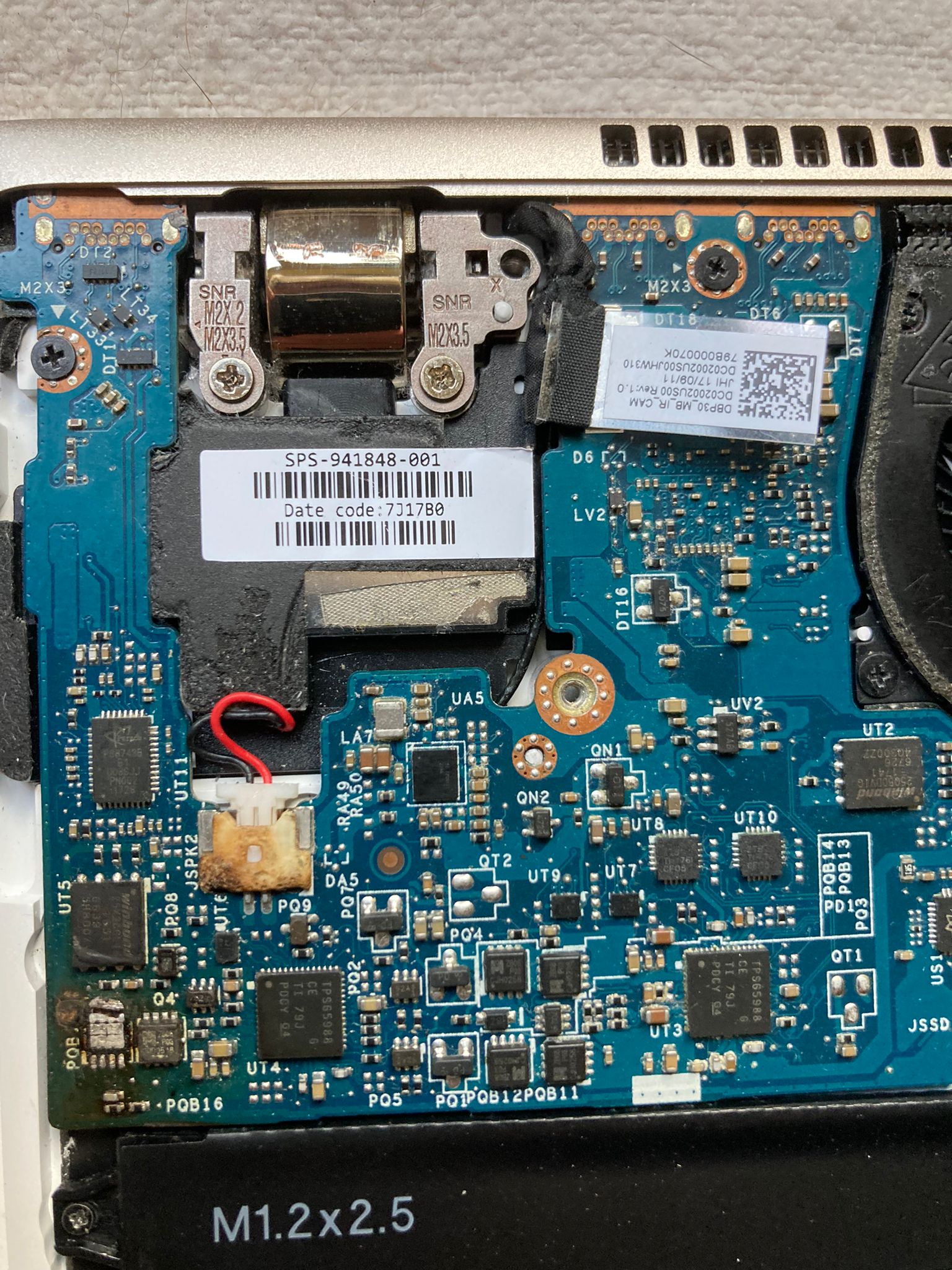

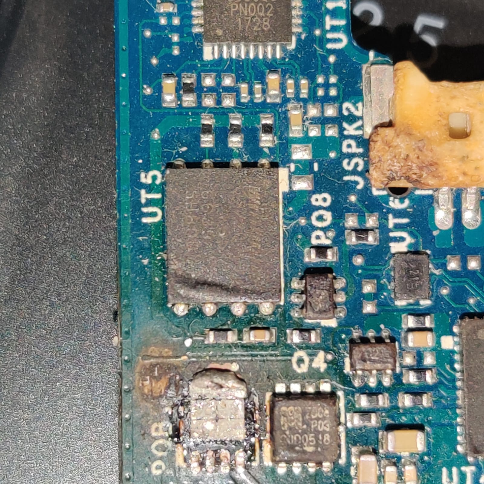

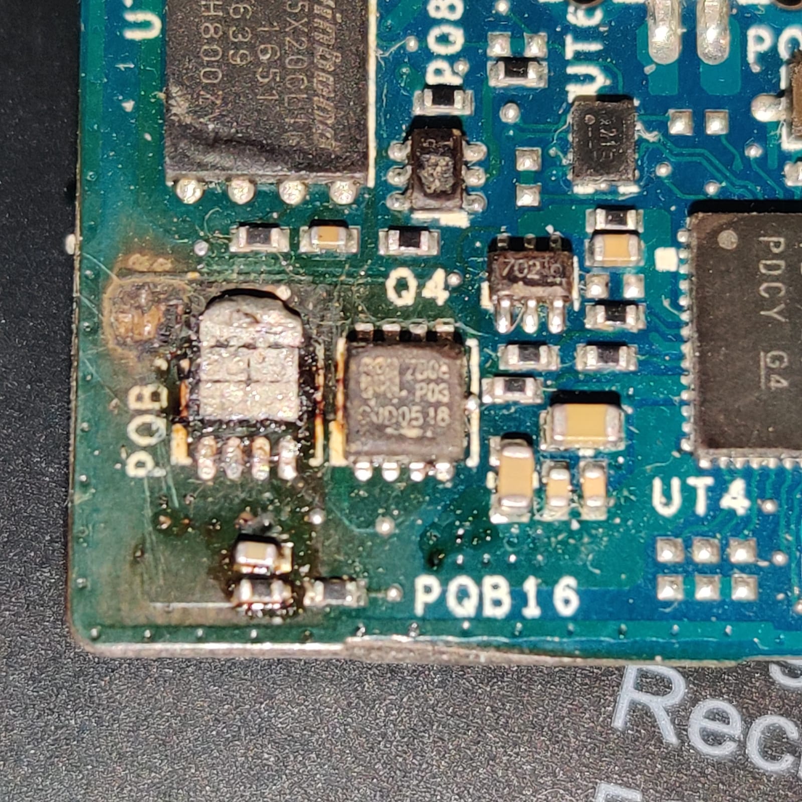

    Good day Boys and Girls,
    I have a broken Spectre and I need some advice. After opening up the laptop it turned out some chip was exploded/damaged and I see some melted plastic near the connector of the speaker.
    Can someone please provide me with some information about what chip it is, and if more is missing on the left part? I can't find any board view files online and I would love to repair it

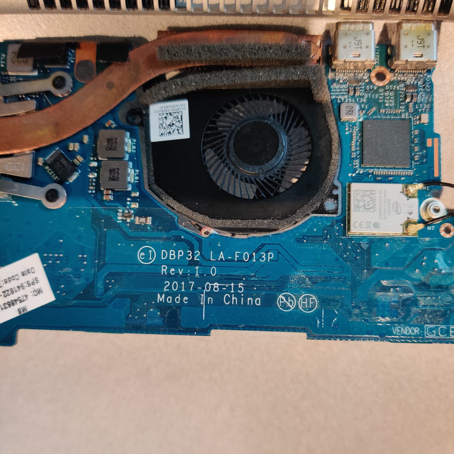

    Specifications:
    Type: HP Spectre - 13-af030nd
    Motherboard: DBP32 LA-F013P Rev:1.0 2017-08-15
    I hope someone can assist me.

    A clear picture of the whole board with pointing out where this area is located would have helped a lot and also would have saved us some time.
    However, after some research I assume these two mosfets are related to switch the VBUS voltage from one of the USB-C Ports to the charging controller.
    There are two more USB-C Ports. If they have the same set of mosfets at the load then you might be lucky. Area looks pretty burned though and might need some "dremel action".

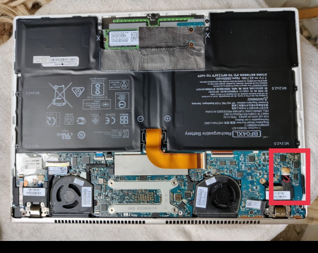

      Re: HP Spectre 13-af030nd repair help
      Thanks sephire for your time and help. I will continue my search for some schematics and have a thorough look If I can find another pair of MOSFETs for the other USB ports.
      If someone in the mean time finds anything please let me know. If I find it I will post it here and keep you guys updated.
      For future reference attached the picture of the Mobo.

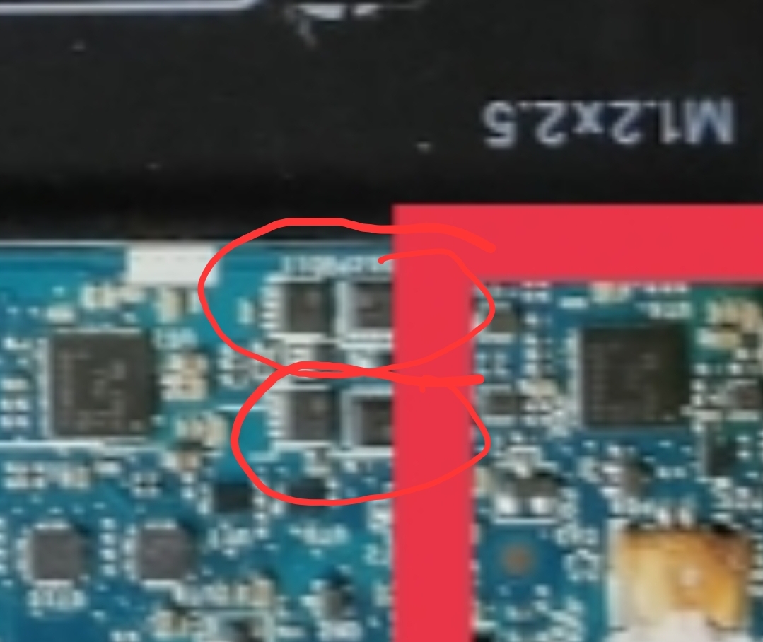

        Here, this looks fitting
          Yeah that looks much like it now I only need to figure out if something else is missing.
