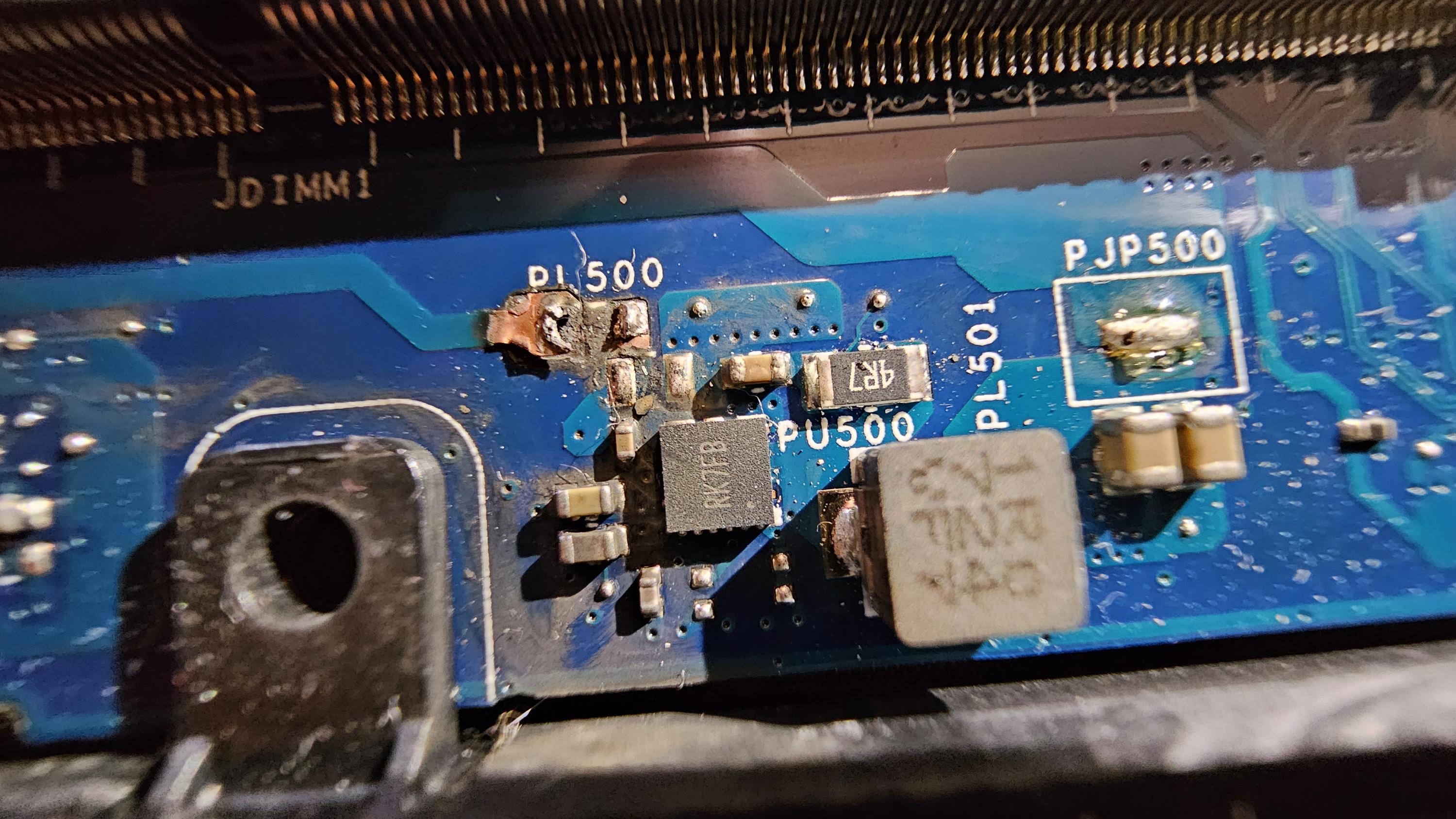

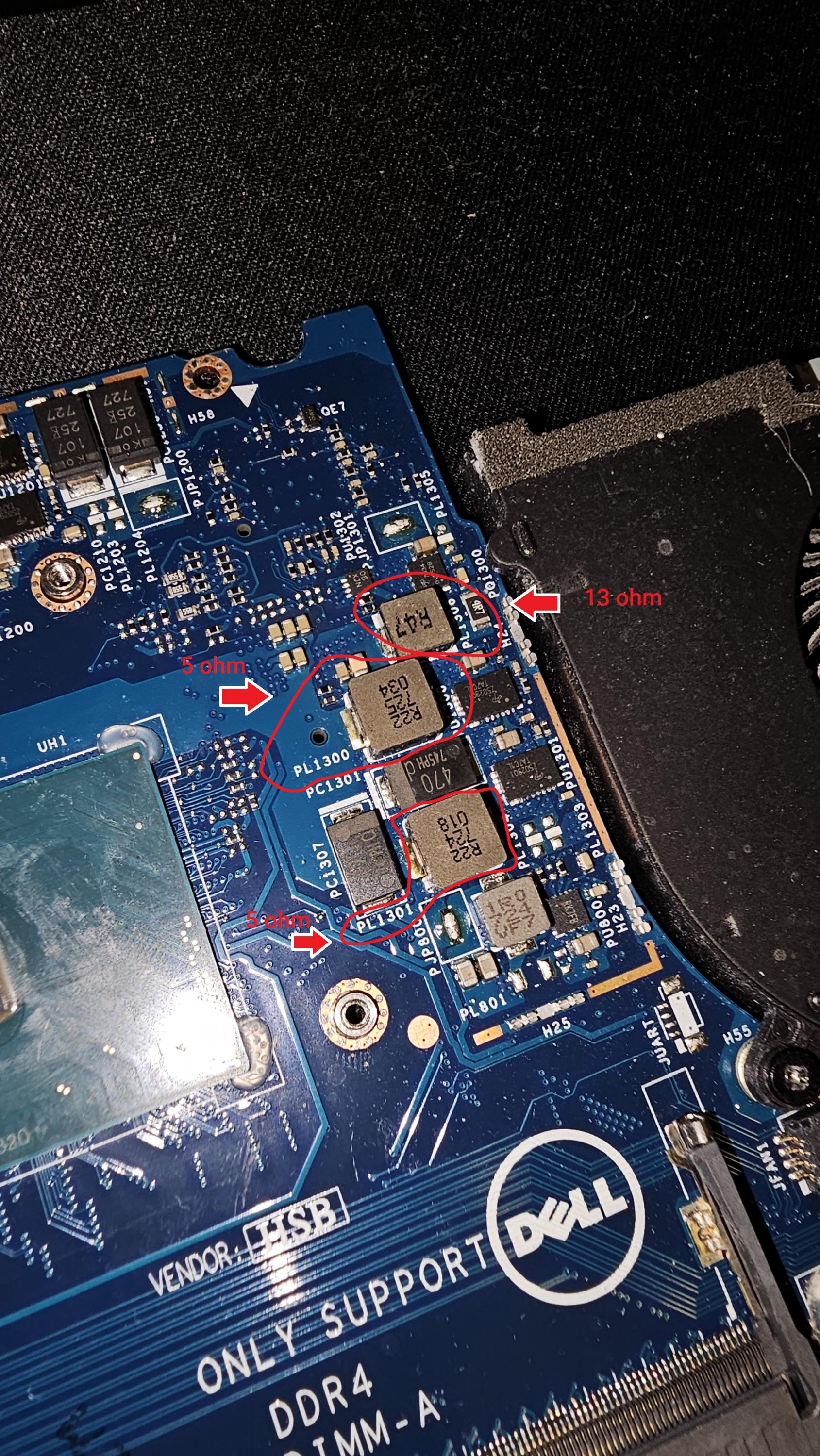

    Hello everyone .
    A couple days ago my trusty laptop decided to die. I've the habit of sleeping with the laptop by my side with a movie.
    That particular night I woke up, closed the laptop, removed the charger and got back to sleep.
    The morning after, when I tried to power it on, it only gave me some orange blinks. Nothing on screen.
    I unscrewed the backplate and immediately notice a blown component "PL500", which should be a power inductor.
    While I was checking for voltages, (Main power rail and 3.3 were present) I tried to check with my finger if something was getting warm. The gpu was heating up along with a big coil above vram.
    Then I removed the charger to flip the board upside down, and when I replugged it, another inductor "PL900" blow under my very own eyes, which also caused damage to the IC close to it "PU900".
    Do you have any idea what might have caused it?
    Kinda scared to plug the charger again now

    Re: Dell xps 9560 doing fireworks
    OMG. Remove all power. Meter in resistance mode.
    Measure the resistance to ground of each and every inductor. Looking for a low resistance reading = shorted component on that power rail leg.
    The pics look like there is horse manure on the board. Consider to use IPA and a cotton swap to clean it up to make it nice and shine.

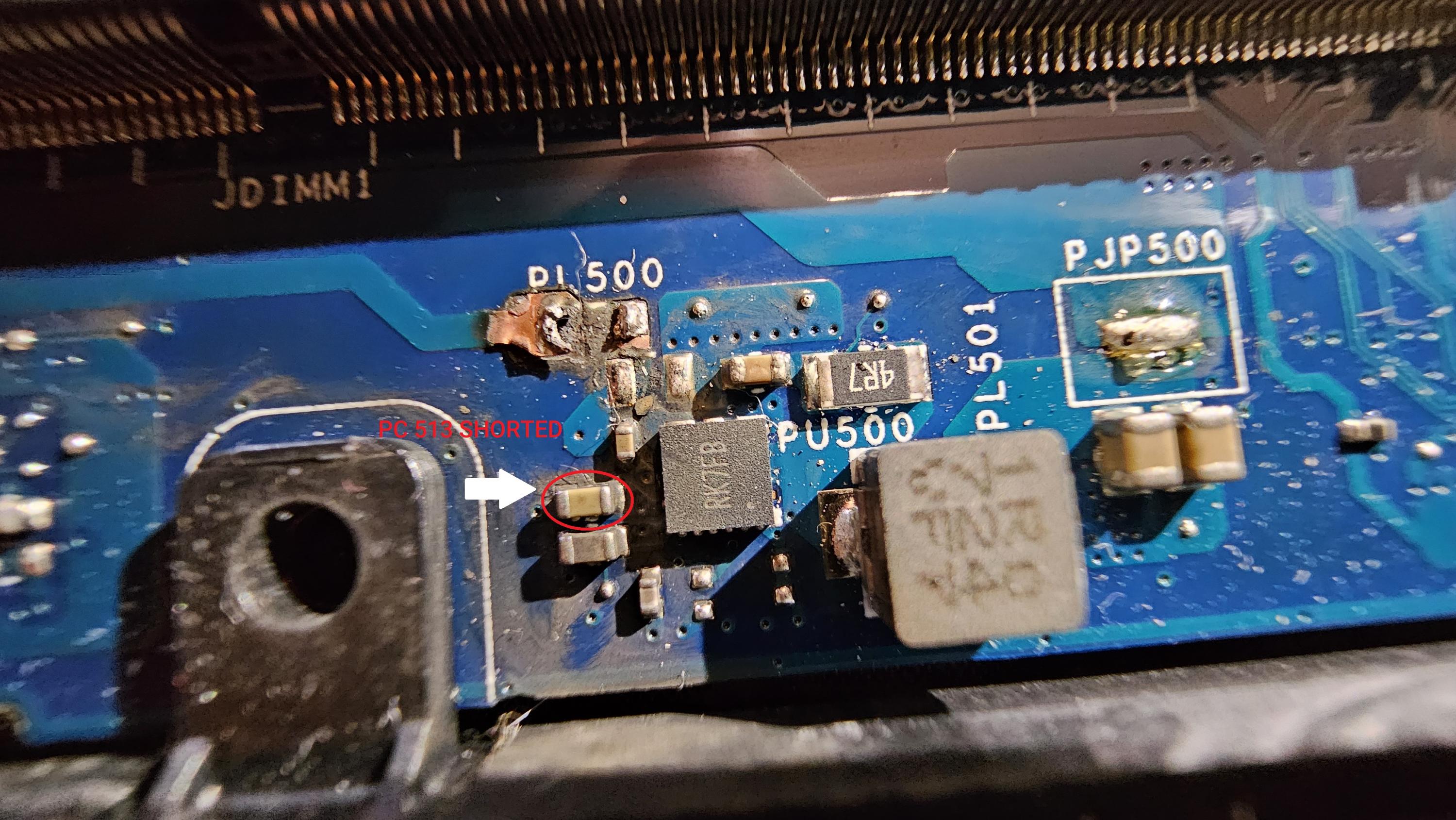

        First of all, thank you for reaching out.
        Yesterday I checked the inductors and some capacitors.
        Here's what I've found:
        The big inductor "PL501" is not shorted (80 ohms), the capacitor PC513 is shorted though.
        Then I measured the coils near the CPU, which beeped but measured above 1 ohm.
        Lastly, "PL 901" and its capacitors are completely shorted; it should be the 1v power supply for the gpu, but i'm not sure.
          Cut PJP500, measure resistance on both sides.
              Good, now cut PJP900, check resistance on PL901. If it stays at 1 ohm, feel free to remove PU900 and recheck resistances on shorted caps and PL901. Do it carefully, try to not damage board.
              Then remove PU500, after that check again PC513. If short is still there, it means that we got short circuit on 3VALW.. IF there will be kOhms, we can go further.

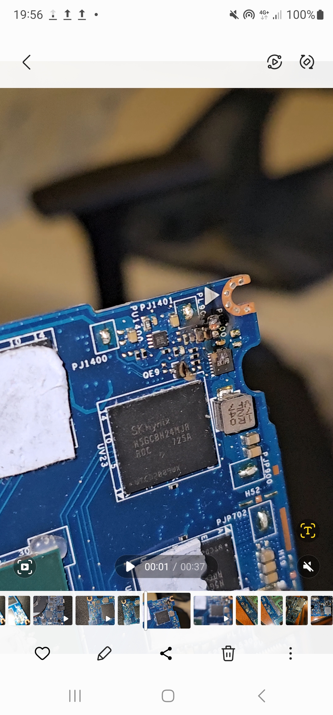

                Here I am.
                Removed PU900 with hot air (since it was damaged as shown in the pic) and took measurements again.
                PL901 = 208 k ohms
                PL501 measures 255 ohms
                pc 512 420 k ohms
                pc 513 5000 k ohms

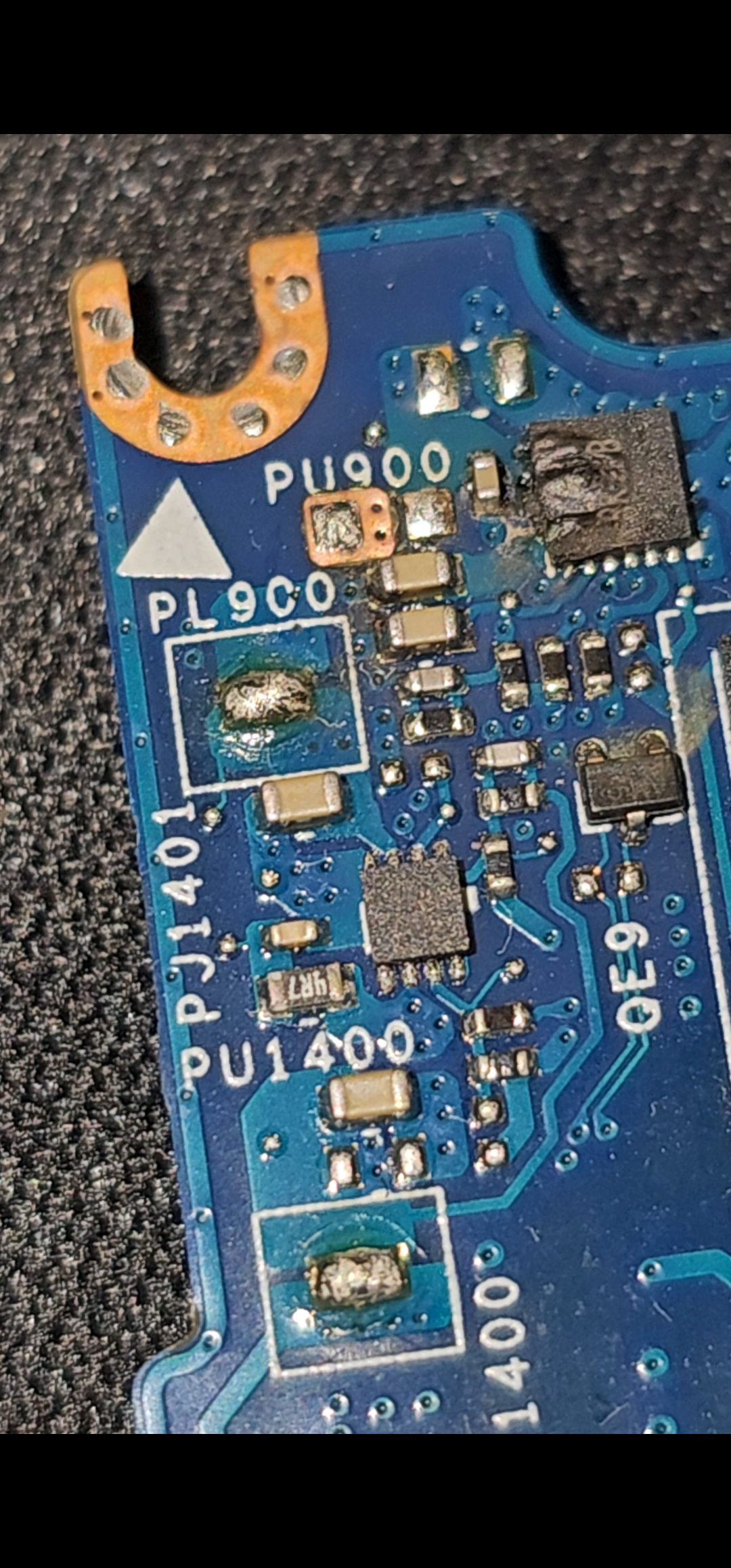

                  Now, I guess, its time to clear the motherboard and restore traces, especially around PU500. Also, it seems that the resistor marked 4R7 need to be replaced.

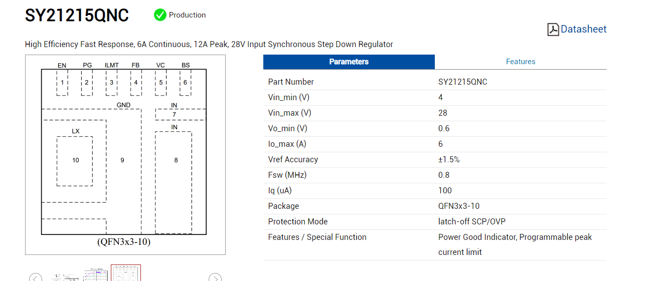

                    Yesterday I checked also PU400 and the capacitors nearby, because it's the power supply that outputs 3valw and 5valw. Everything seems okay there, nothing shorted to ground.
                    How would you restore the the trace? I have bought the blown inductor (PL500), wouldn't it work if I soldered it on top of the existing pads?
                    Tuen I have to buy the chip for PU900, which is the SYX196DQNC Qfn 10, also used for PU500.
                      Update, I found the SYX196DQNC on aliexpress.
                      Should I desolder the 4.7ohm resistor to check if it's working?
                        Hey! First of all clear all the soot, cuz it is conductive, then you can extend any burned trace with wire, pay attention to suggest possible current flow and consider proper diameter of the wire.
                        About resistor: just measure it in ohmmeter mode, but it looks already damaged so could be tens of ohms now.
                          Already cleaned the board with isopropyl alcohol. The copper is not completely ripped from the board on PL500, so maybe I could be fine just with soldering the inductor on top of that.
                          I measured the resistor and it measures exactly 4.7ohms, so it's fine luckily.

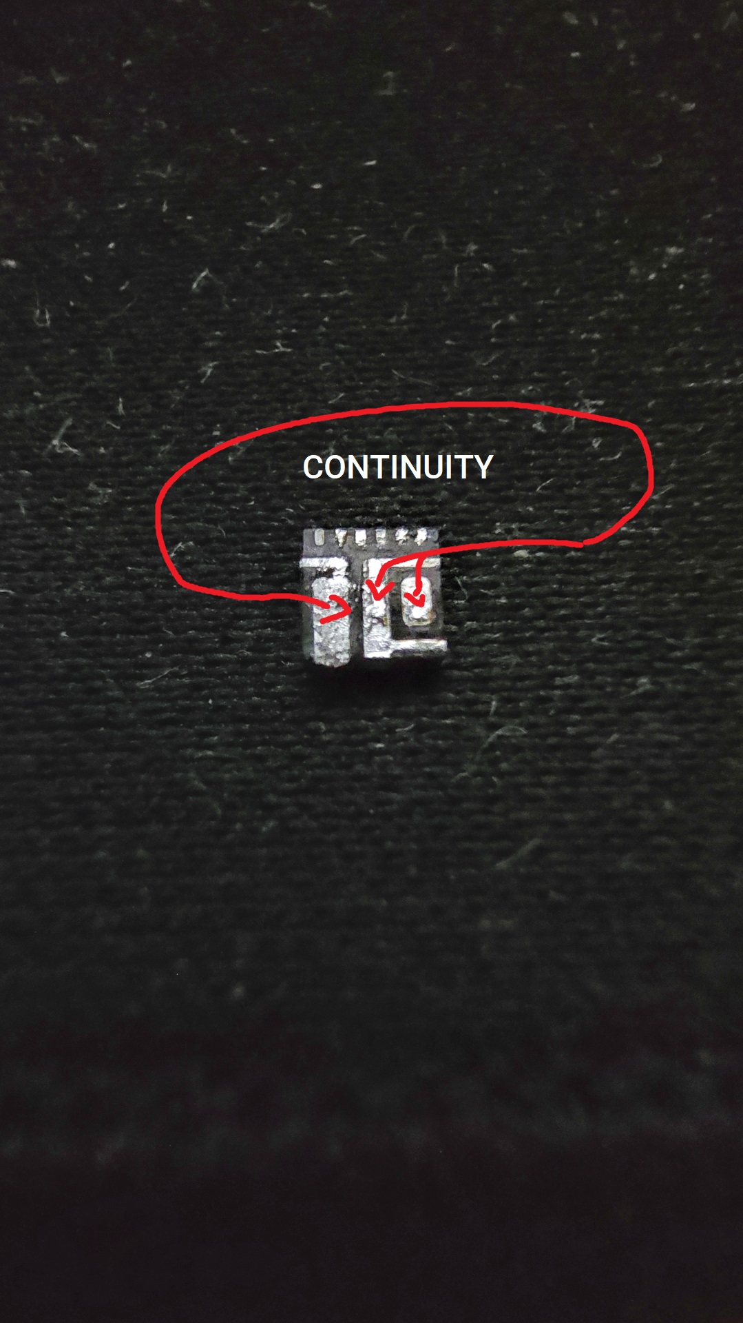

                          Edit: I also measured PU900 and with the help of a schematic I measured it; correct me if I'm wrong but the pads I highlighted shouldn't be connected.
                          The schematic isn't exactly the model SYX196DQNC, I believe it's a new model of the same chip but it should work the same.
                            PU900 definitely fried...

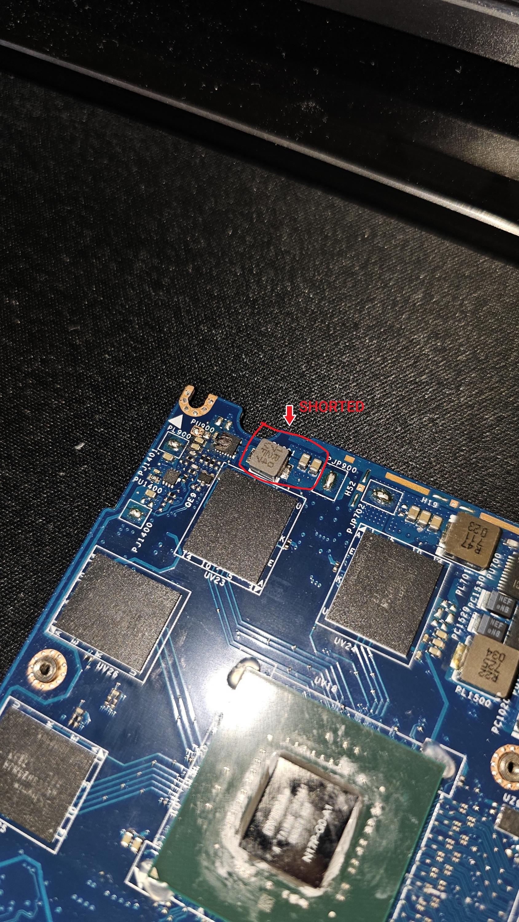

                              Yeah. I don't really know what might be the fault though. I ordered the IC's, and already have the power inductors PL500 and 900 ready to be soldered.
                              I'm worried once I solder the components back on the board it's going to go kabooom again .
                              PU500 is the ic that generate the 1valw. PU900 generates 1vs_gfx ( what does "vs" mean? ).
