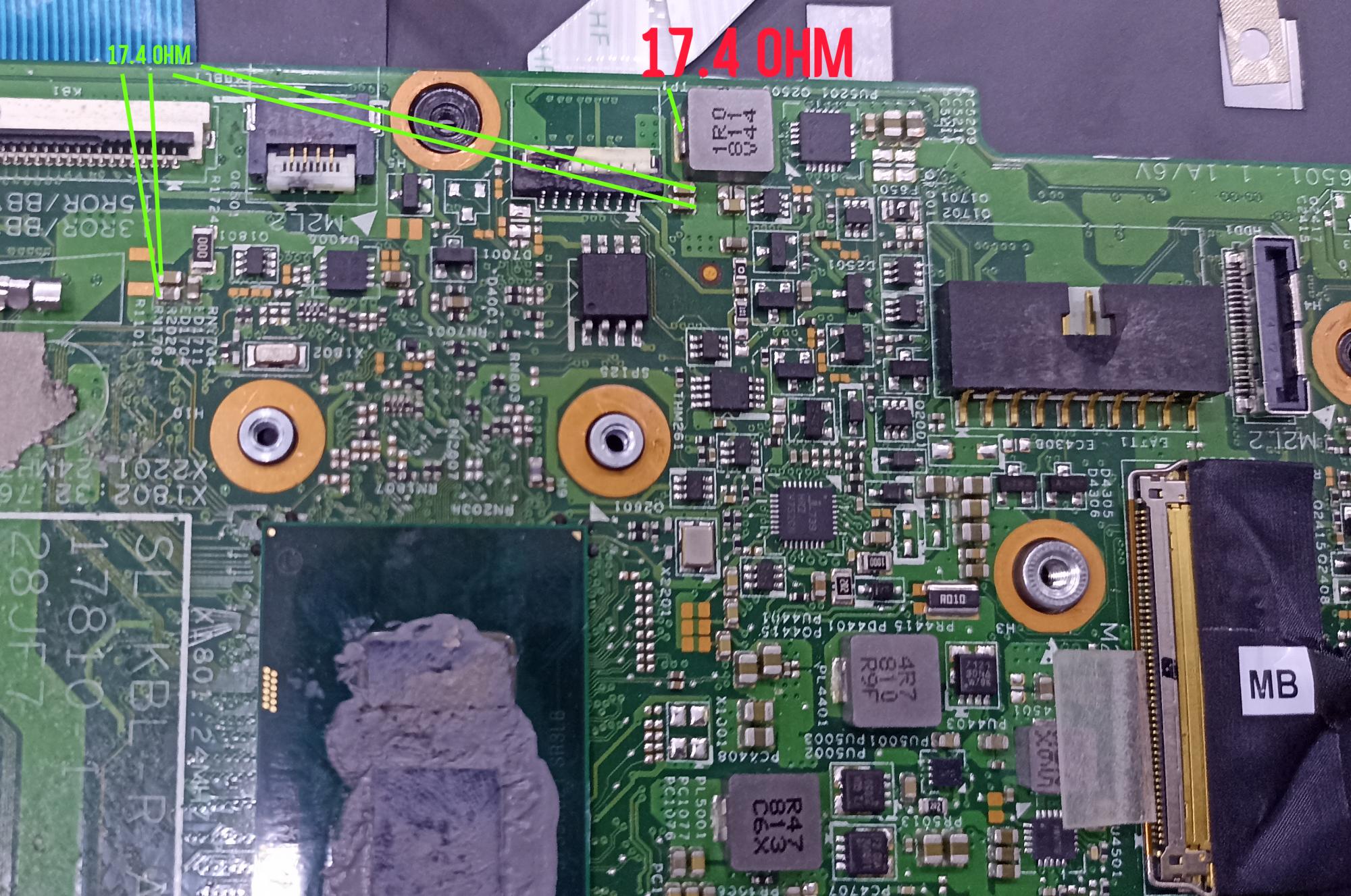

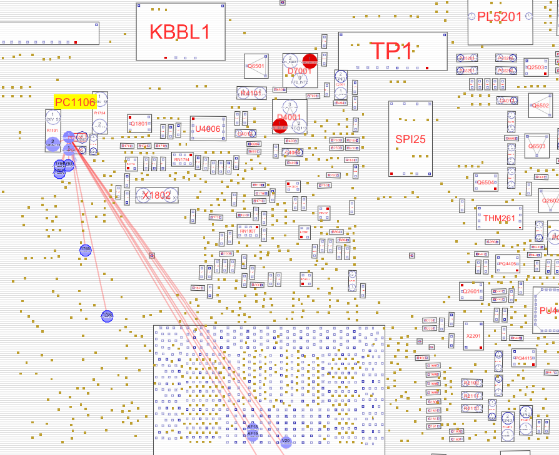

    hi again fellas
    today on the table, i have an Inspiron 13
    it's just dead
    the main pwr rail is present.
    attached images for some measurements.
    the caps pointed are shorted to GND so as the PL coil pointed
    so guys, what do you think?

        This 1D0V_S5 power rail is available after the appearance of 3V_5V_POK signal from PWR_3D3V(pu4501) and PWR_5V(PU4502)
        The resistance of the 1D0V_PWR power rail in your case is not really low, it can still work with that stat. Usually the resistance of the 1D0V_PWR power rail is in the range of 30--> 80 Ohm.

          If the PWR_1D0V_EN signal has appeared you can think of replacing the PU5201

            Have the 3.3V rails supplying the PCH still a healthy resistance to GND?
              Hey there Sephir0th nice seeing you here sir.
              the 3.3v PL to PCH have 12 kohms
              The 5v PL to PCH is 64 khom
