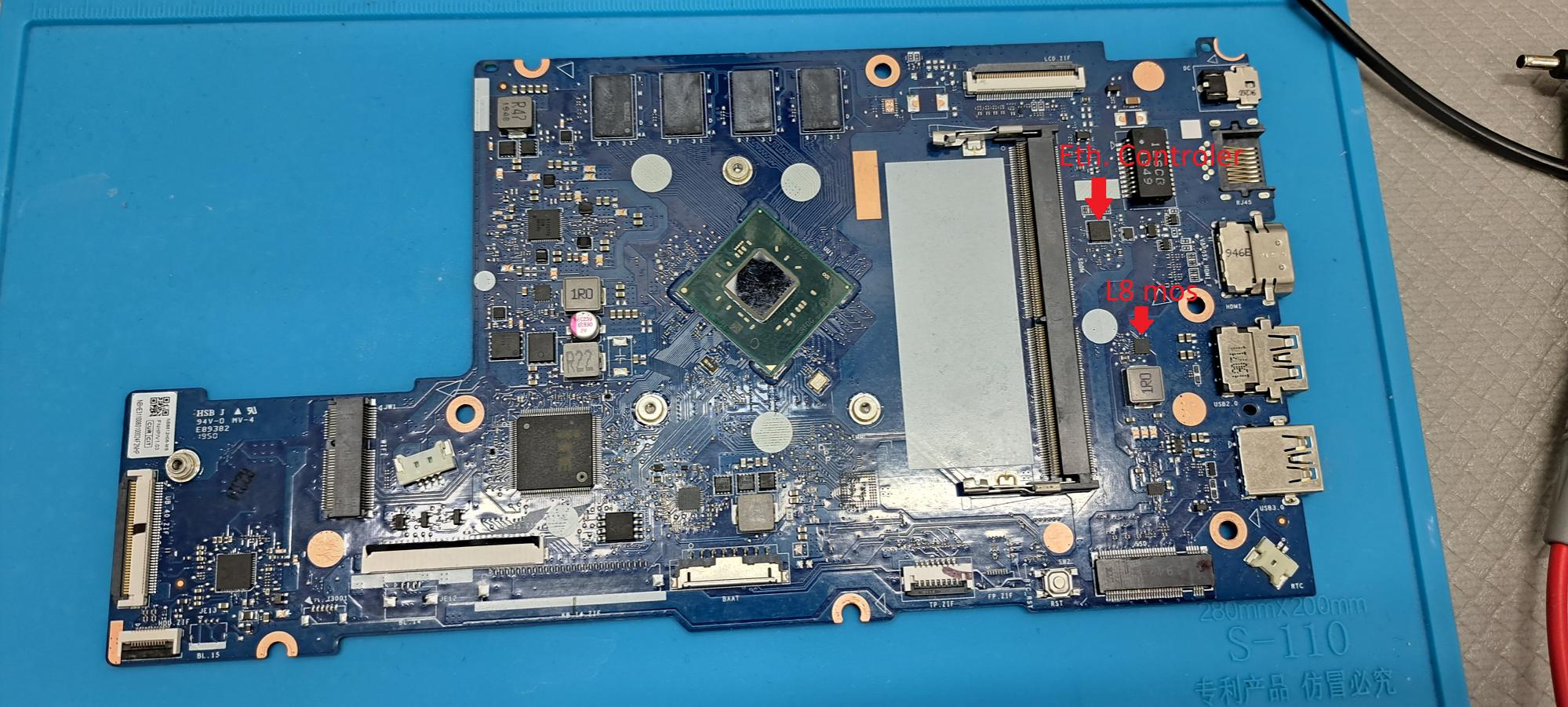

    Any help would be aprreciated on the following (Apollogises for any language related mistakes).
    As the title states I have a Aspire a315-34 with a NB8609_PCB_MB_V4 board. The laptop does not powers on. I have 5V present on L1 and 3.3V on L2. When I plug in the charger, I see, with the thermal camera, that L8 mosfet rises temperature, cools down and then the ethernet controler glows.
    Any suggestions on how to proceed would be helpful.

    Remove all power. Meter in resistance mode. Check the resistance to ground of L8.

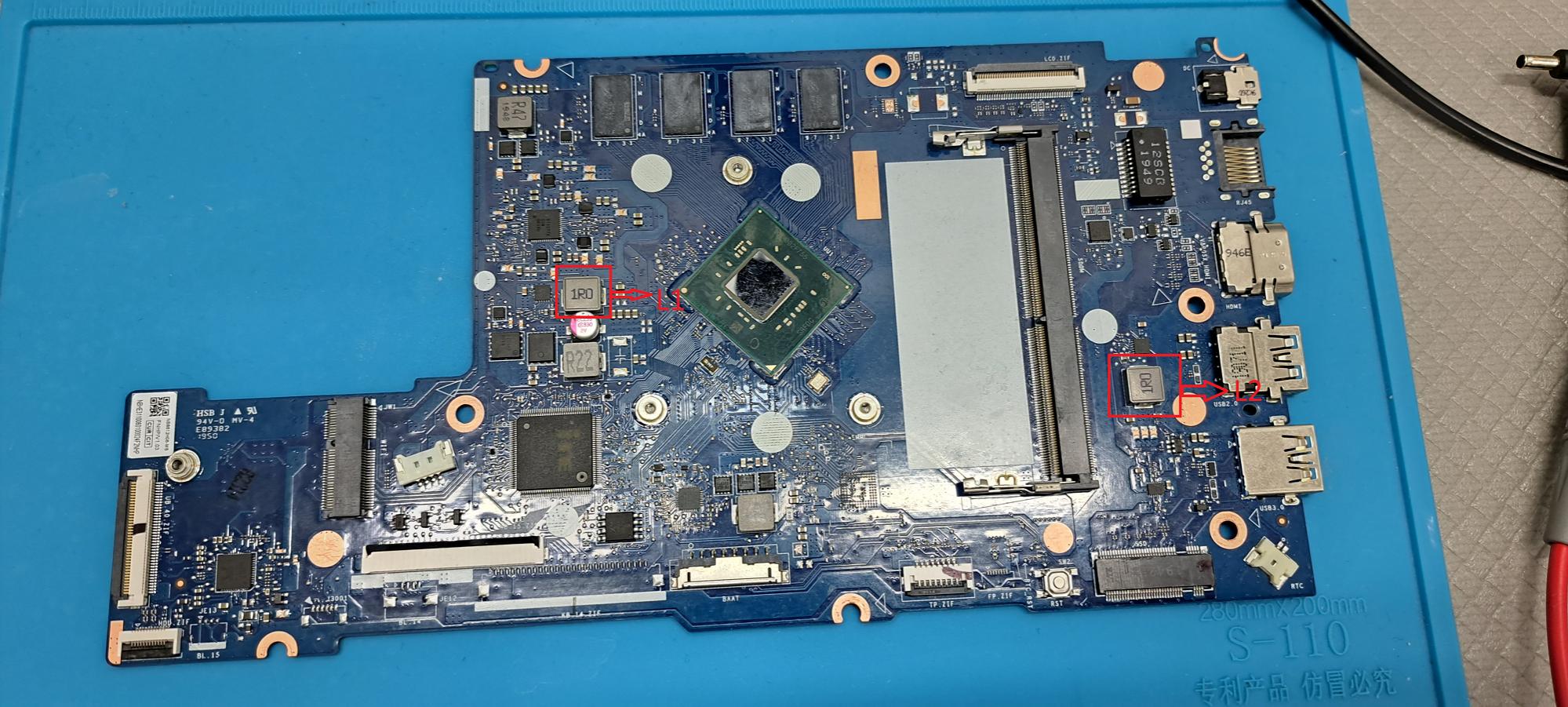

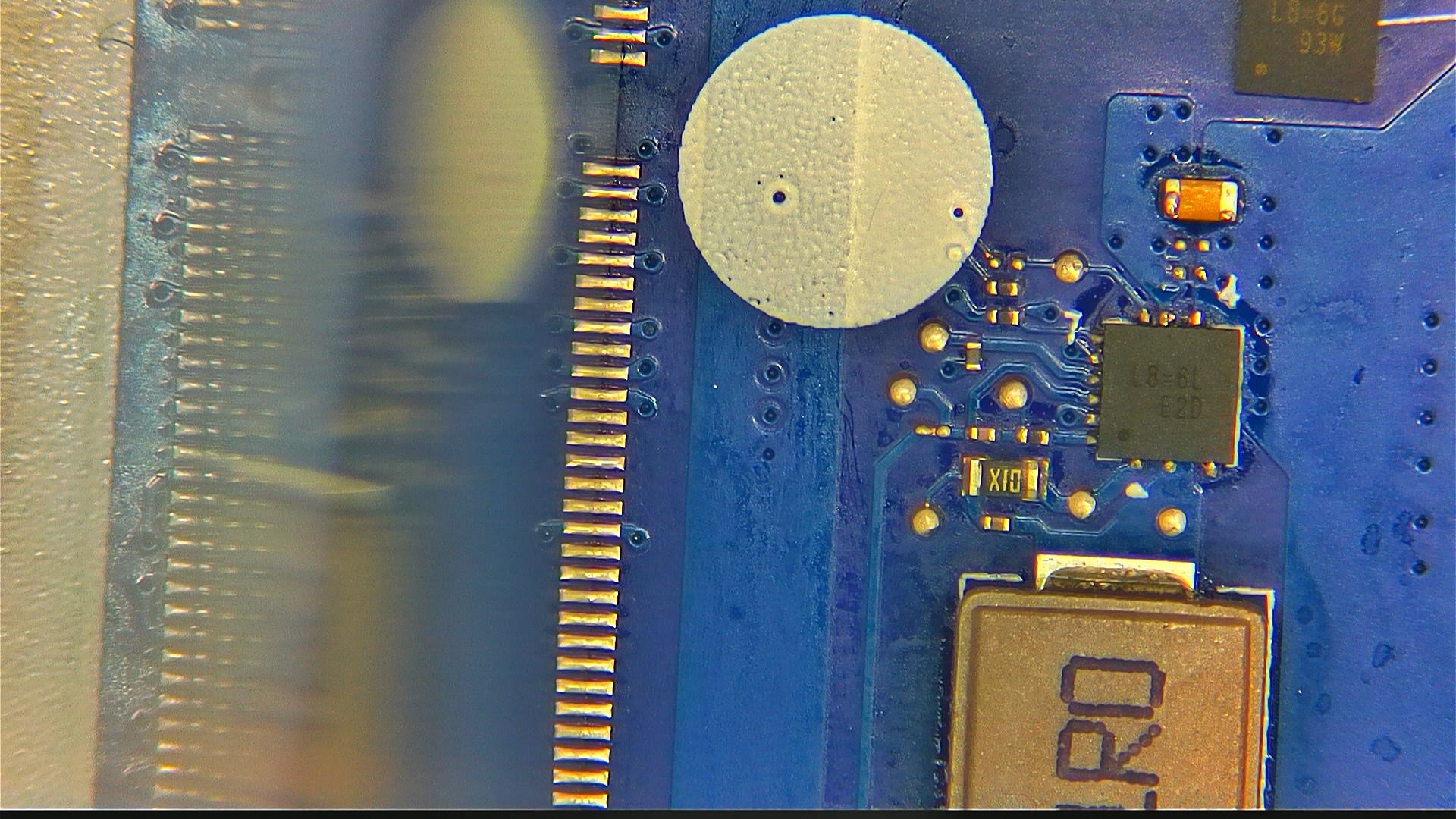

            Post the topside markings of the mosfet that is heating up so we can locate the same in the schematic.

                mon2 photo attached

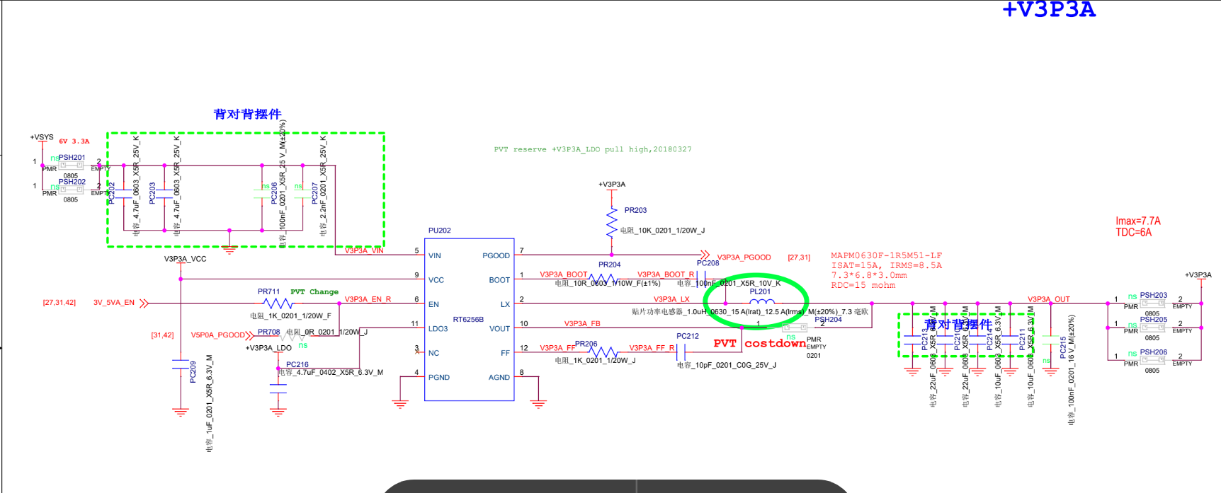

                    The part that is heating up is not a mosfet but the actual switching regulator IC @ PU202. The output inductor is @ PL201 and is nearby the same part.
                    This leg of the circuit is supposed to output 3v3 (+V3P3A) and this resistance is low for this voltage.
                    This low resistance could be linked to a defective capacitor or perhaps even the main CPU.

                                  Carefully, measure the voltage to ground of pin # 6 = EN (for enable) on PU202.
                                  We want to know if this power rail is being enabled or not as it heats up.
                                  Also, what is the voltage to ground at
                                  a) Vout = PL201 inductor ?
                                  b) V3P3A_VCC = pin # 9 (Vcc) of PU202 = power rail for this switching regulator
                                  • menderland
                                    • May 2023
                                    • 10
                                    • Greece
                                    Re: Acer A315-34-P1SQ Huaqin NB8609 Rose GL NB8609 MB Fault
                                    EN Voltage:3.250V(pin #6)
                                    PL201:3.271 V
                                    VCC:3.256 V
