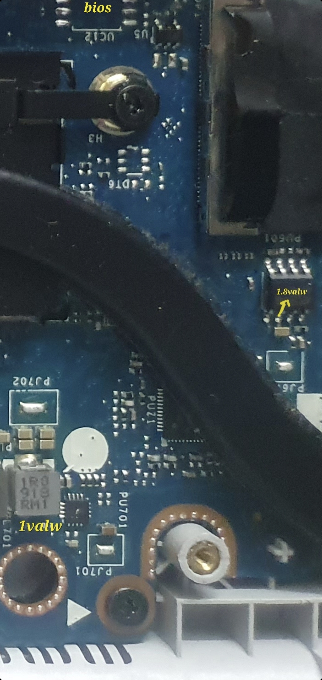

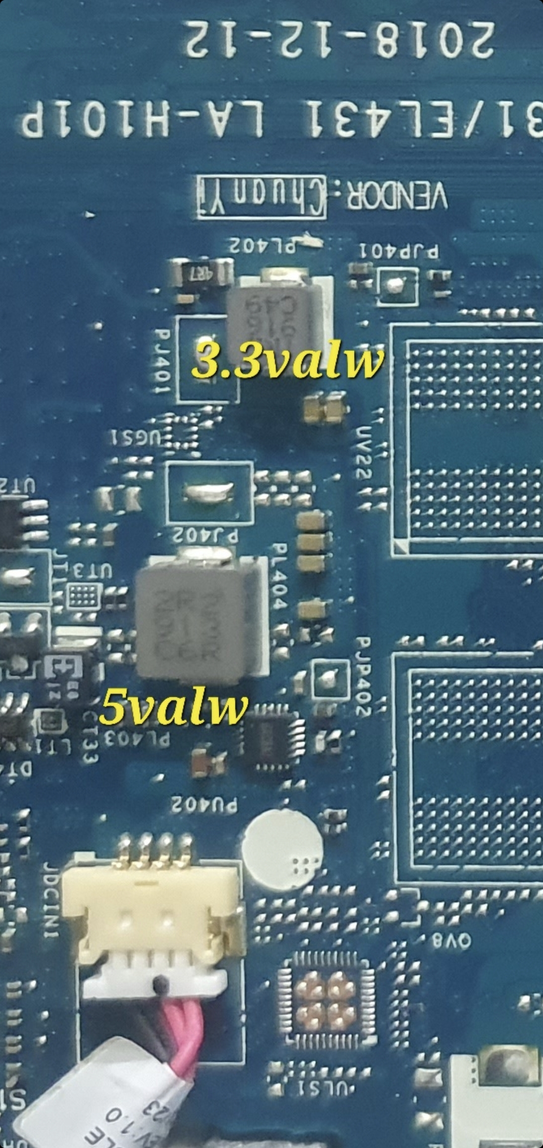

    I have this laptop, battery charge led ok,when press start button led goes ON for second and goes OFF
    Bios change not resolved problem
    I have ALW voltage 5v,3v3,1v05 and 1v8
    Any tips?

    Remove all power / no battery. Check the resistance to ground of each and every coil = local power rail on the logic board. Checking for low resistance readings.

      VCC_GT = 4R6
      VCC_CORE = 3R0
      VCC_SA = 16R
      1V2 = 129R
      Also connector in always voltage present and 1v3 present,for RAM I think,but no vcc core and vcc gt/sa
      Will see, enable signal to pwm ic same for all 3 rails
      Tnx

        Re: Lenovo s340-15-iwl
        I go reverse from cpu core coil, no enable signal from rt3602 ic,but also rt3602 has all vcc but no enable signal VR_ON from kb9022q super IO chip
        Not know what condition should be IO chip to send this enable signal
