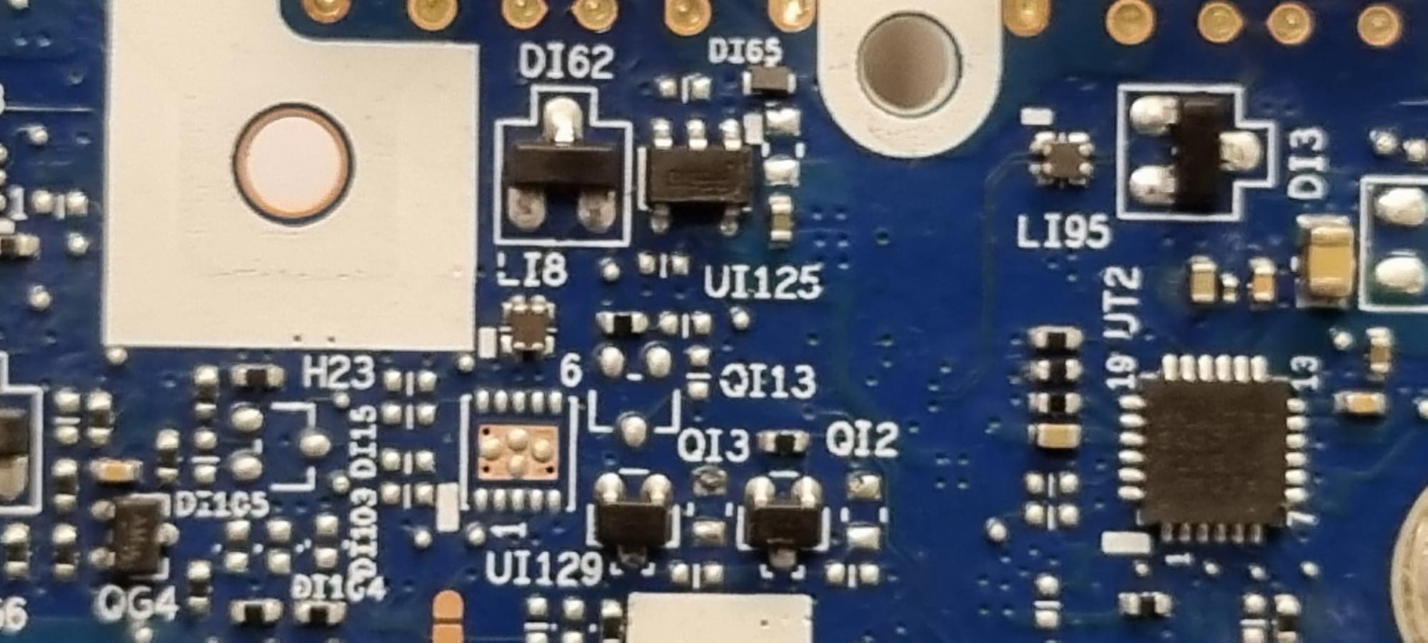

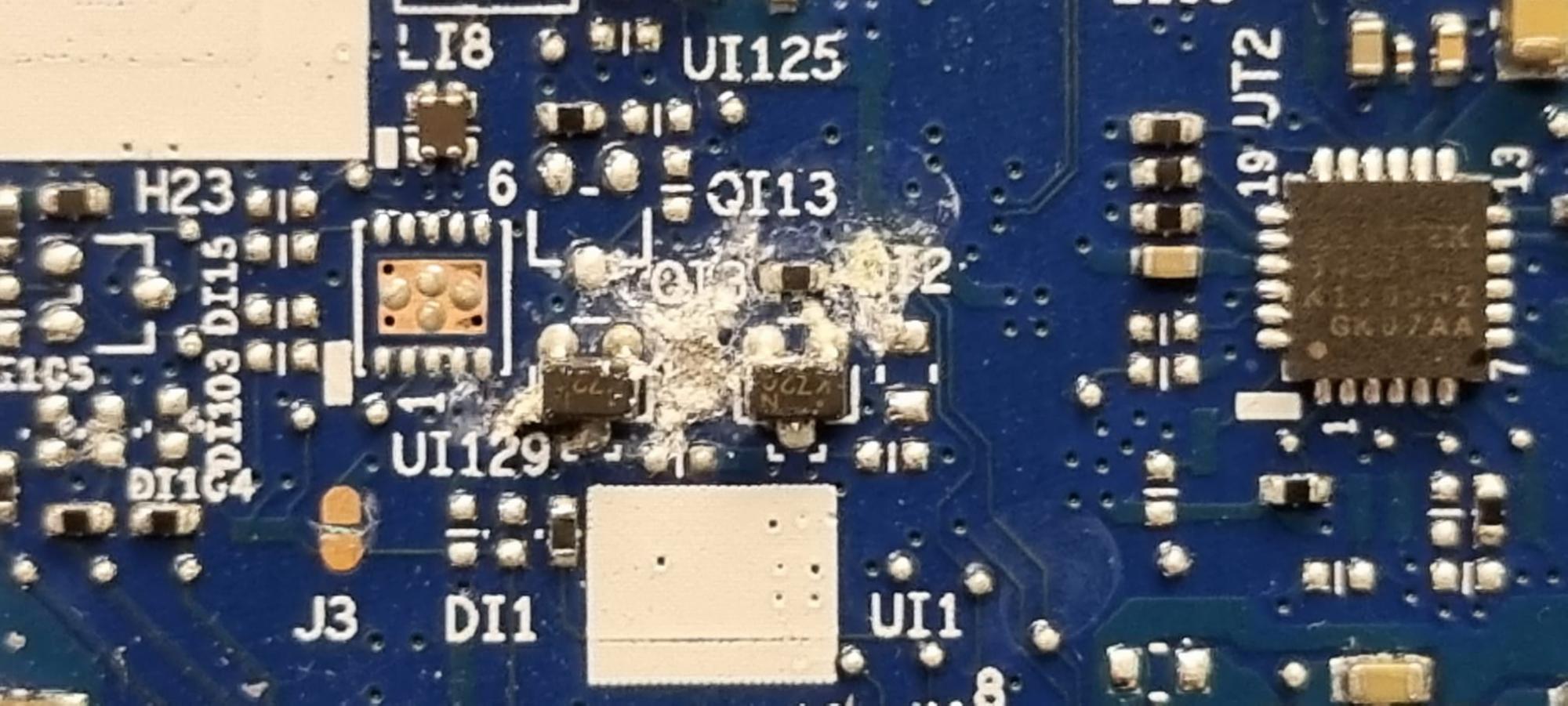

    Hi
    A small amount of water spilled on this laptop keyboard. only two diodes i think got a little bit corrosion. Schematics
    after flashing a bios by programmer the laptop turns on only when i connect the charger. (When got to windows i flashed latest bios.)
    after i shut down the laptop it will not turn on by power button nor by charger connected. only when i disconnect the battery and the 3V coin cell battery it will power on when connecting the charger.
    3v present on the power button.
    Can you help me understand this and how to continue inspection ?
    attached the corrosion part photos.

        Re: Lenovo Legion 5 15IMH05 power issue
        Check RTC section.
          Hi thanks, can you please elaborate ?
          I did measure resistance on rtc batt connector and saw no short.
          also when batt is connected i can see the 3 volt on pin #1 on PD201
          Also, measured PD201 in diode mode and the diode is fine
            Rtcrst#
            srtcrst#
