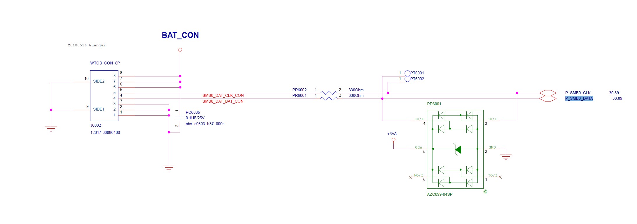

                          • mon2
                            • Dec 2019
                            • 14664
                            Re: Asus UX534FT No ALW voltages
                            Hey! Finally watched the last episode of Fauda. Doron, what a ham!! Always leaving enough room to have another season. Love it.
                            SCL is 0.38v
                            Too low. Remove the battery. Does this SCL voltage return to normal ~3v ?
                            If not, locate the ESD diodes that should be nearby the battery connector. It will need to removed.

                              • koby058
                                • Jan 2017
                                • 387
                                • israel
                                Mon2 i am happy you enjoying Fauda so much
                                SCL still low without batt. when you say diode do you mean PD6001? if yes it is not soldered on this board
                                resistance of PR6002 is 330 ohms
                                resistance of SCL line to GND is 640 ohms
                                mcplslg123, this is a new EC chip i bought from SHUMS.
                                what do you think guys ?

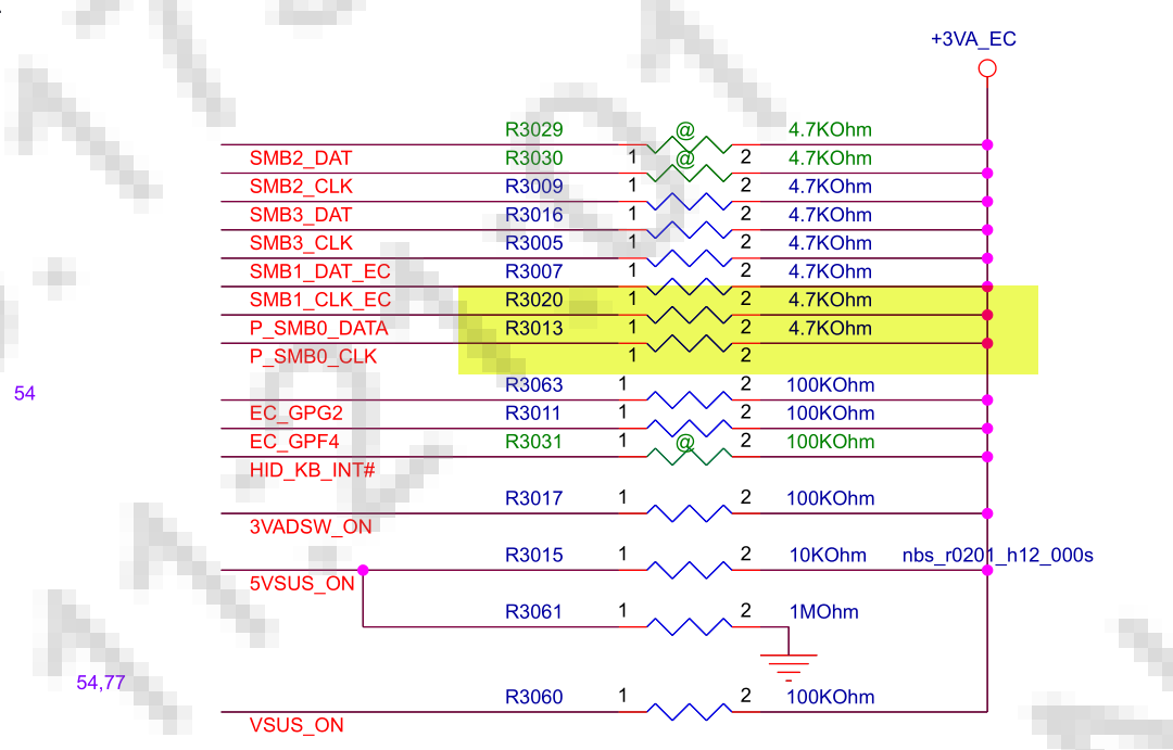

                                • mon2
                                  • Dec 2019
                                  • 14664
                                  Locate the required pull up resistors for these SCL and SDA pins. Being an open drain interface, there must be a pull up resistor on each pin to create the soft high state.
                                  Once found, check the voltage to ground on each side of this pull up resistor.
                                  Then remove all power and confirm the resistance of this resistor. Often the recommended pull up resistance is 2k2 but can be any value upto 10k (from our testing on some designs). Either way, it must not be missing.

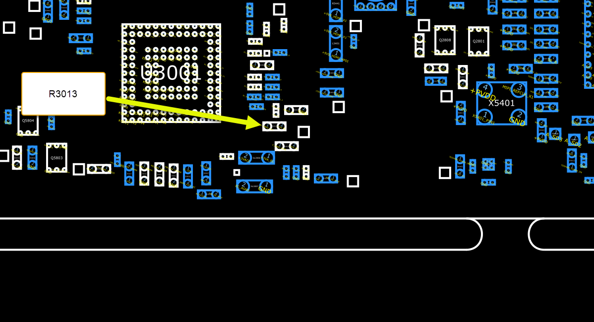

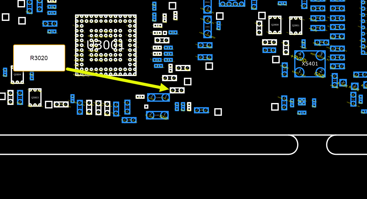

                                    • mon2
                                      • Dec 2019
                                      • 14664
                                      I do not have the exact schematic for this logic board but found a similar one.
                                      Review R3013 and R3020. Confirm they are present and check their voltage to ground on each pin.
                                      • koby058
                                        • Jan 2017
                                        • 387
                                        • israel
                                        Hi
                                        On R3013, there is 3.3n on the right side and 0.46 on the left side
                                        resistance on resistor is 4.5K ohms.
                                        right side to Ground 5.2k ohms
                                        left side to groung 800K ohms
