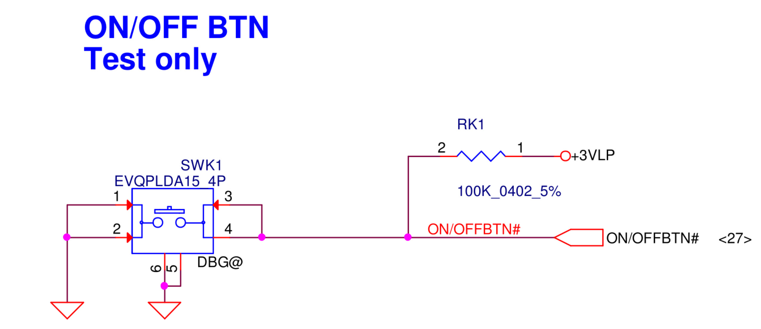

    So i opened the laptop, found schematics and tried turning it on by shorting pins on the connector and it won't turn on, i have 3.3V on keyboard pin and i short it to ground,3.3V goes down , but laptop doesn't turn on...

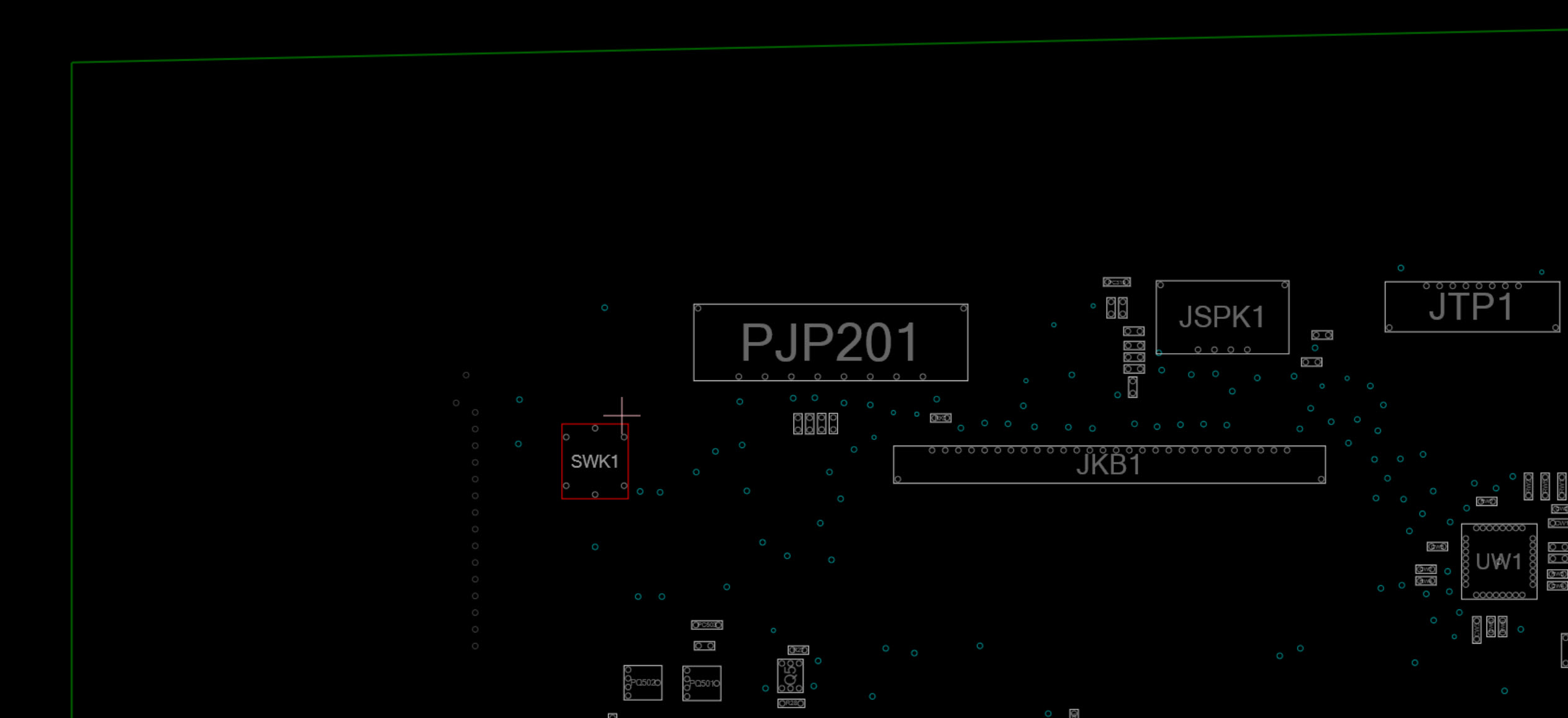

    Have you tried the SWK1 pads / switch?

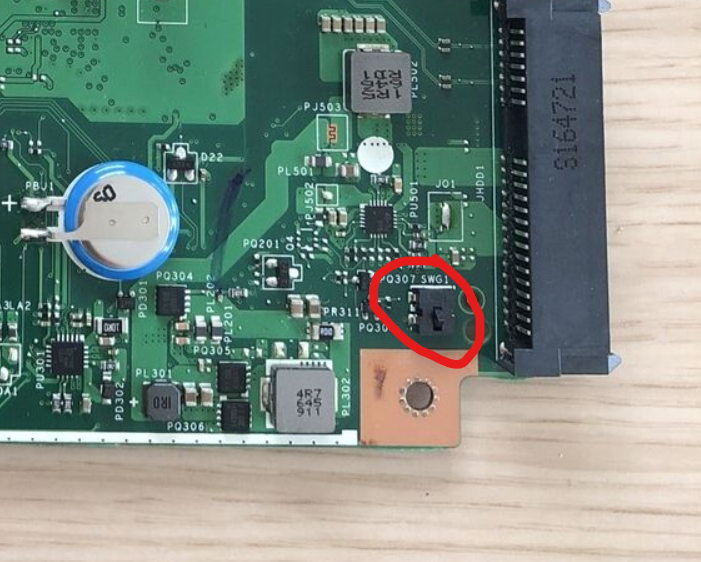

            These ACER boards are known for their hidden switches preventing the board from turning on. With some luck you have simply to press this button in addition to turn the board on.
