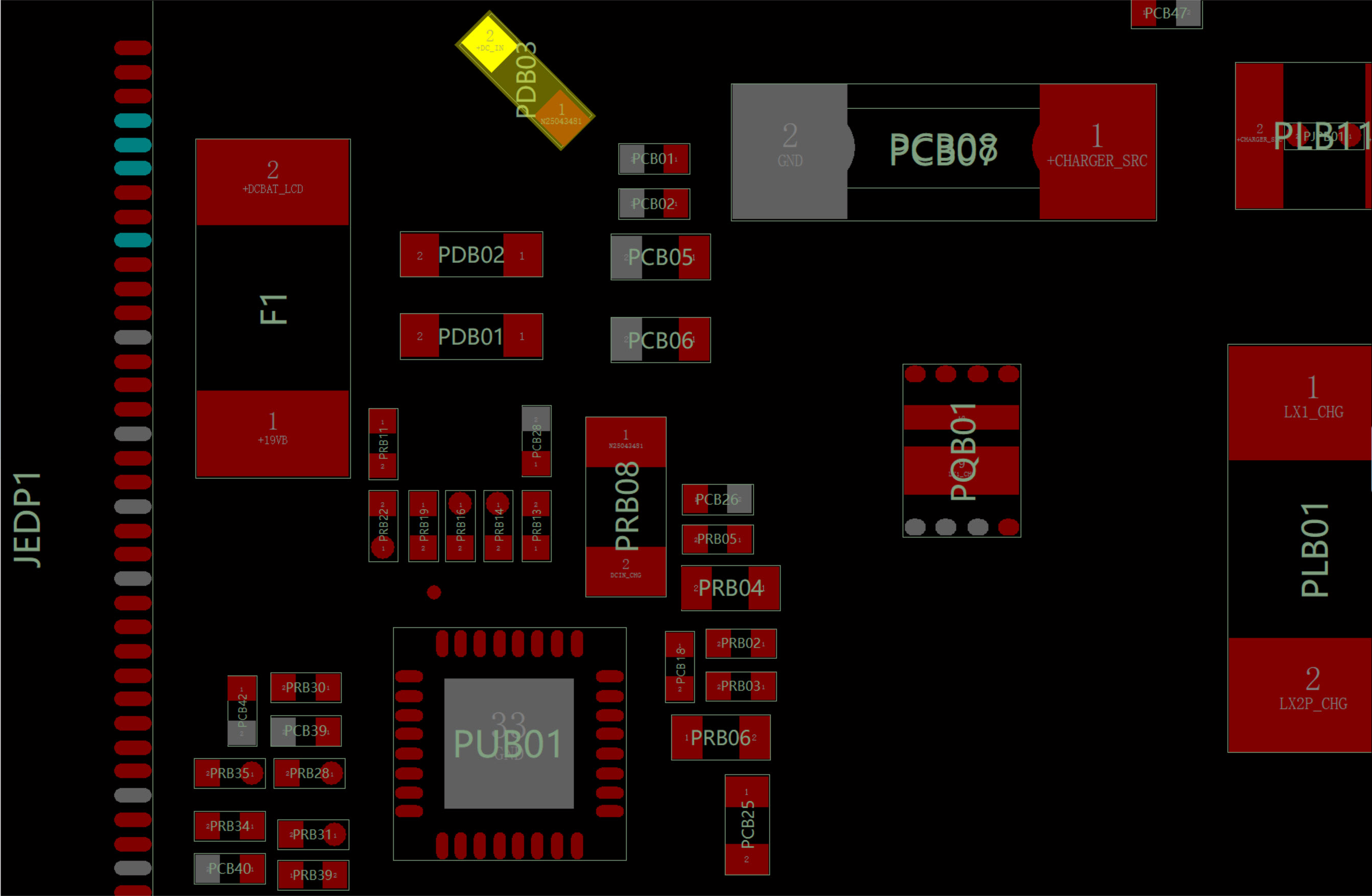

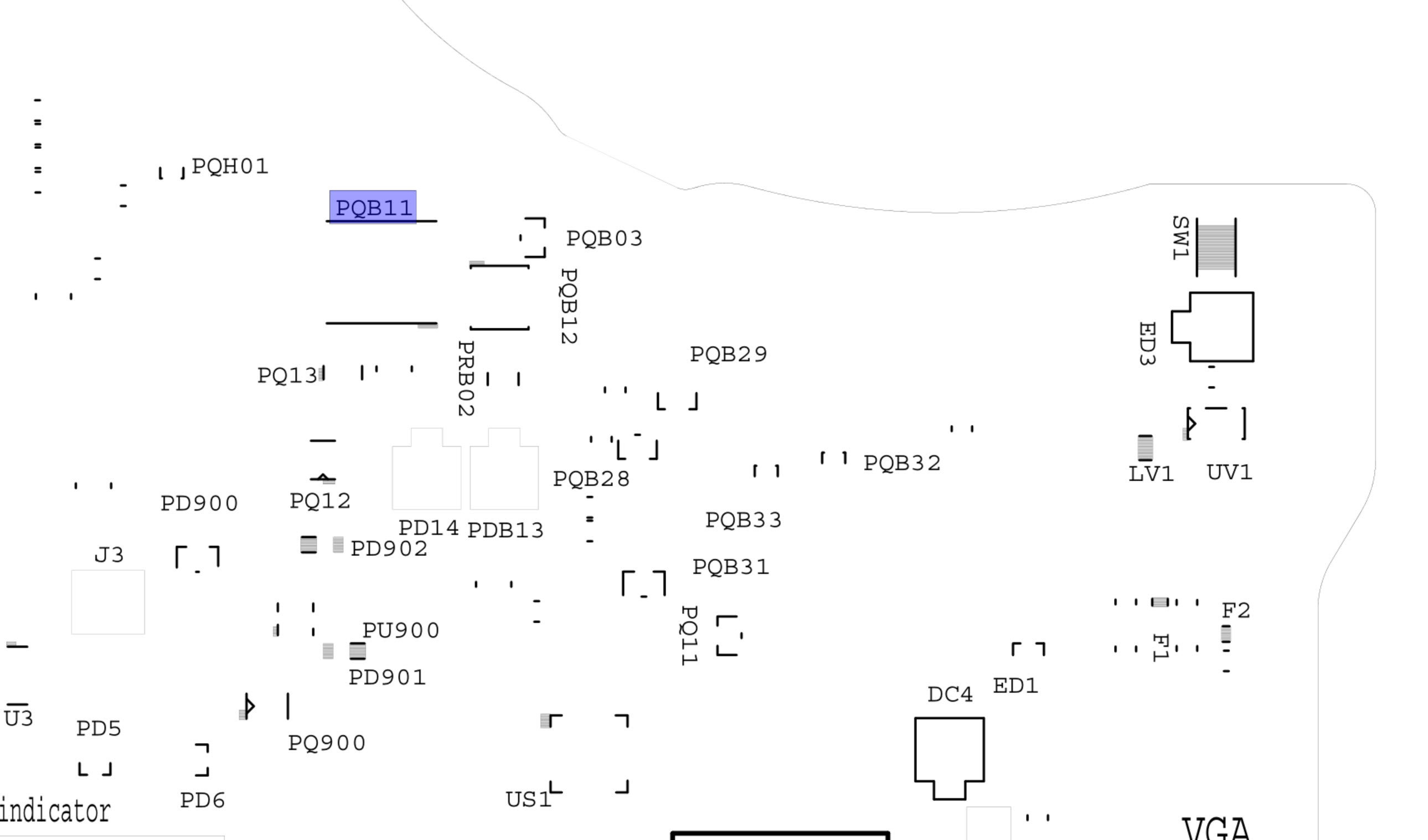

      • mon2
        • Dec 2019
        • 14659
        Re: DELL INSPIRON 5593 FDI45 la-j091p no power on
        Measure the voltage to ground on each pin of the dual diode at PDB01.
        Also at each pin of the DCin mosfet at PQB11.
        Source (1-2-3)
        Gate (4)
        Drain (5-6-7-8)

          • mon2
            • Dec 2019
            • 14659
            See attached. Found this (if it is correct) by searching for '5593'.

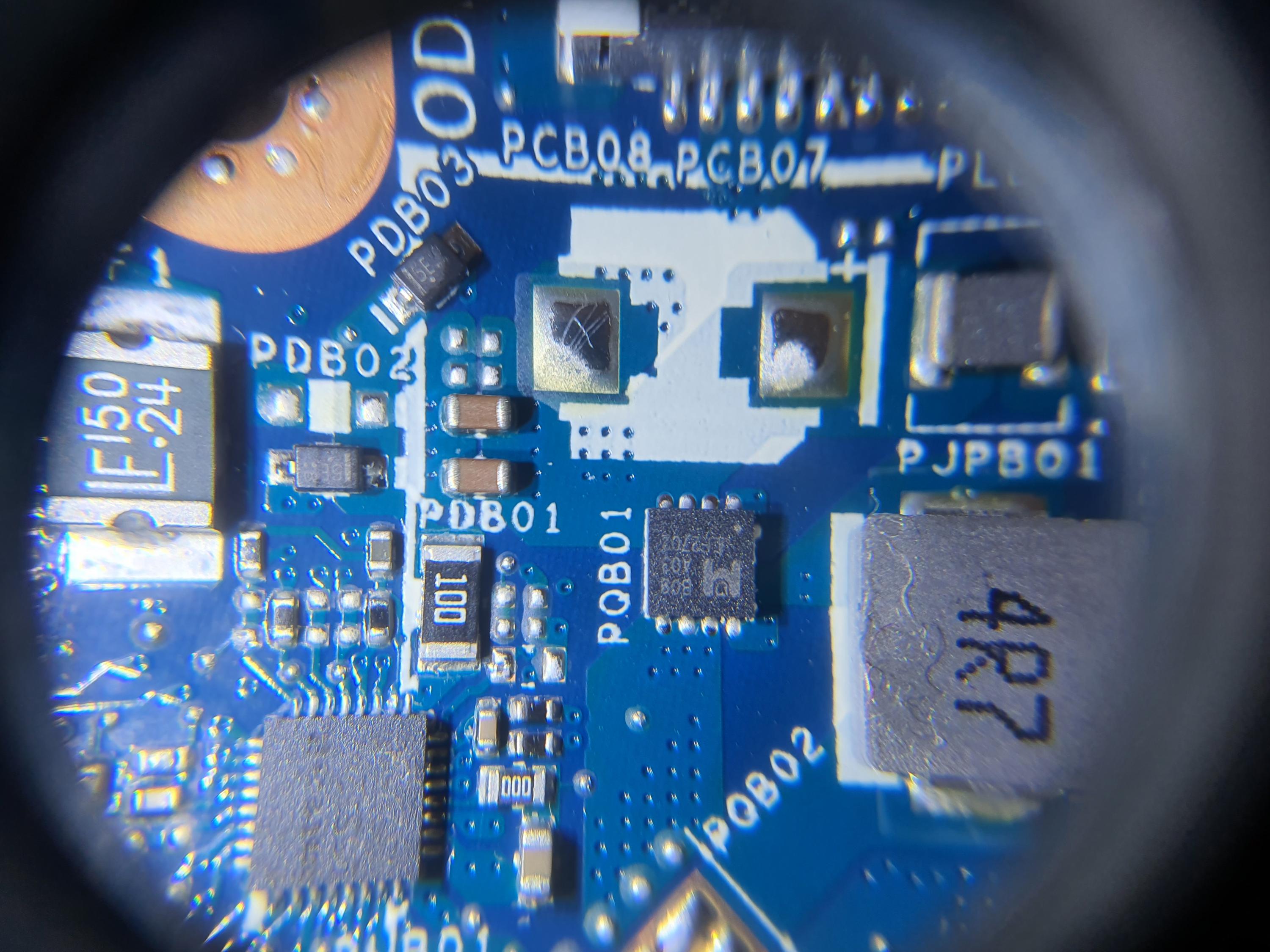

            • koby058
              • Jan 2017
              • 387
              • israel
              Found this diode butbit is a single diode
              Do you think this is it?

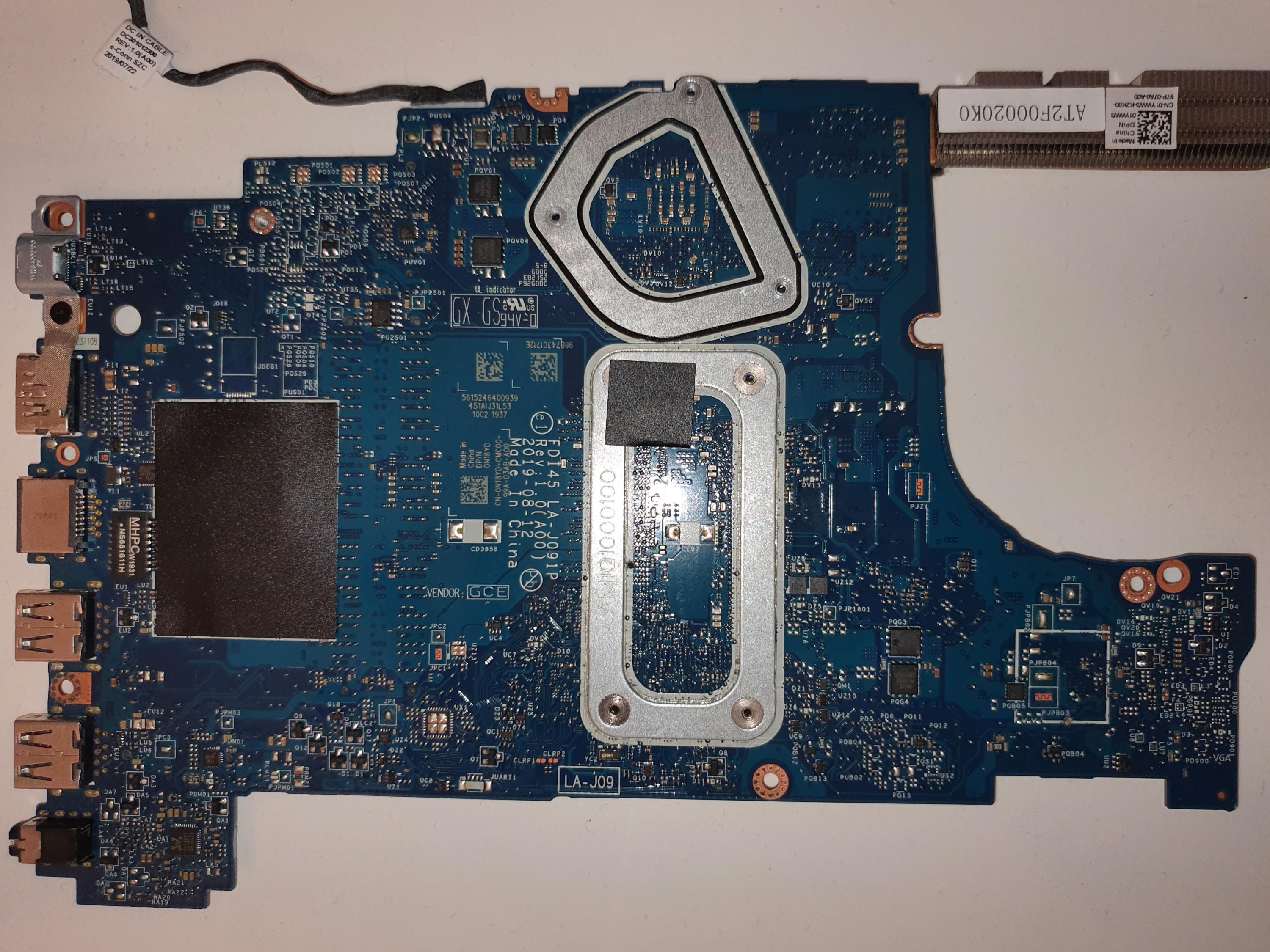

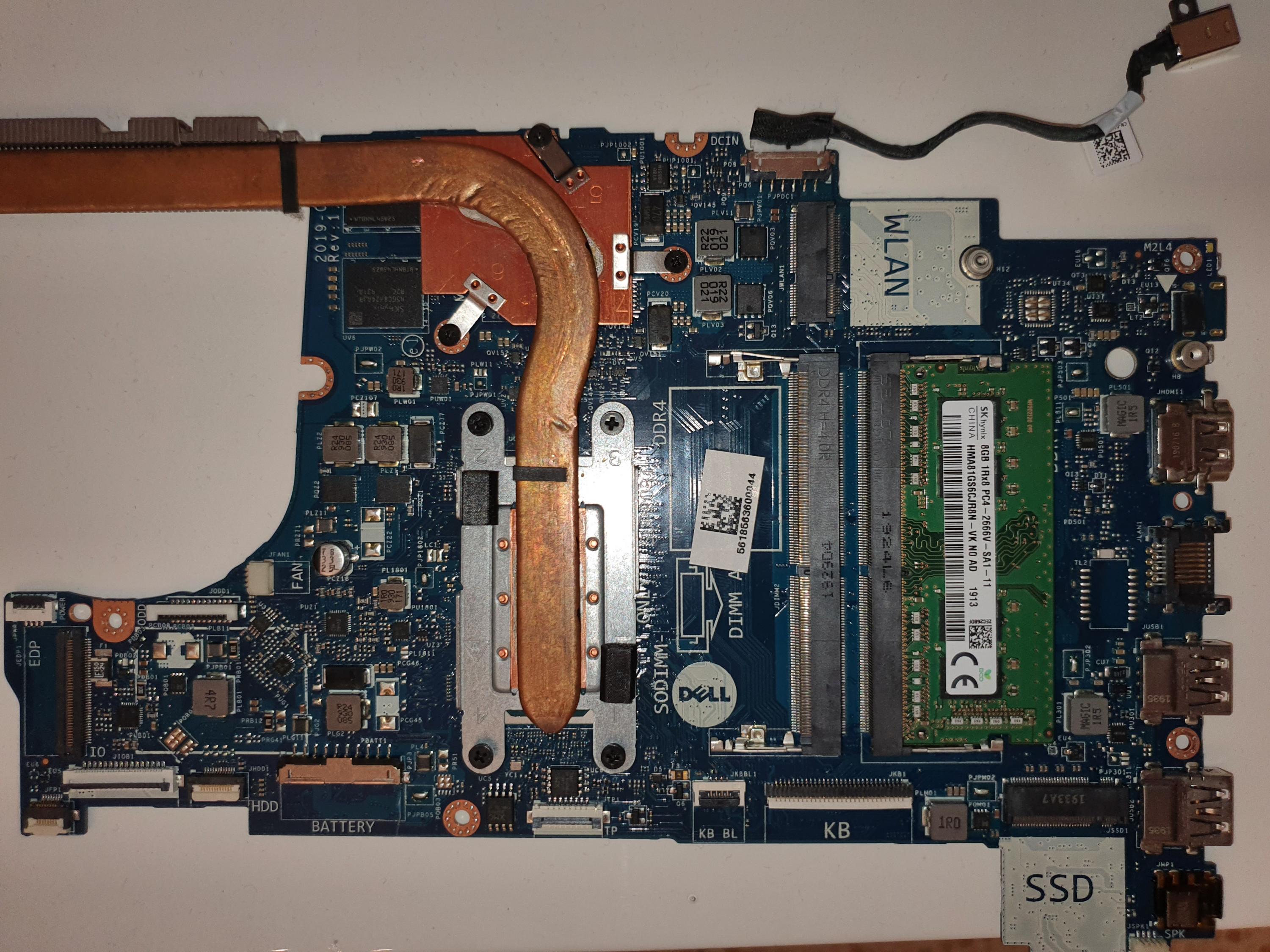

                • koby058
                  • Jan 2017
                  • 387
                  • israel
                  I was talking about the double diode
                  Here is the board pics with the best light i have

                    • koby058
                      • Jan 2017
                      • 387
                      • israel
                      Source (1-2-3)
                      Gate (4)
                      Drain (5-6-7-8)
                      I think we have a confusion.
                      Here you ask me to measure voltage on the dual diode, and i called it double diode. but i cannot find such dual diode
                      instead i have found a single diode on PDB01. as visible in picture on post #7.
