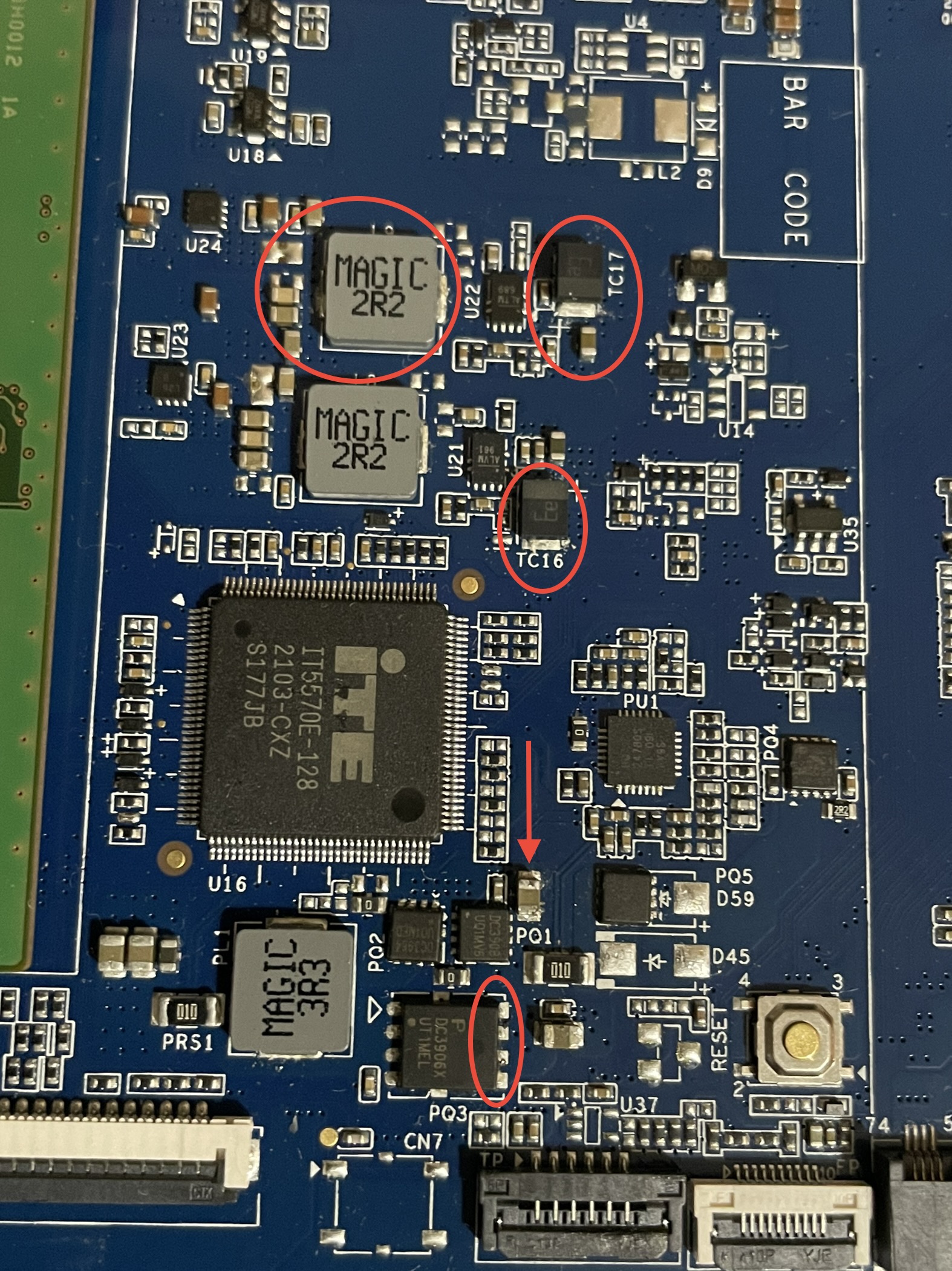

    I have this laptop that is not charging at all.

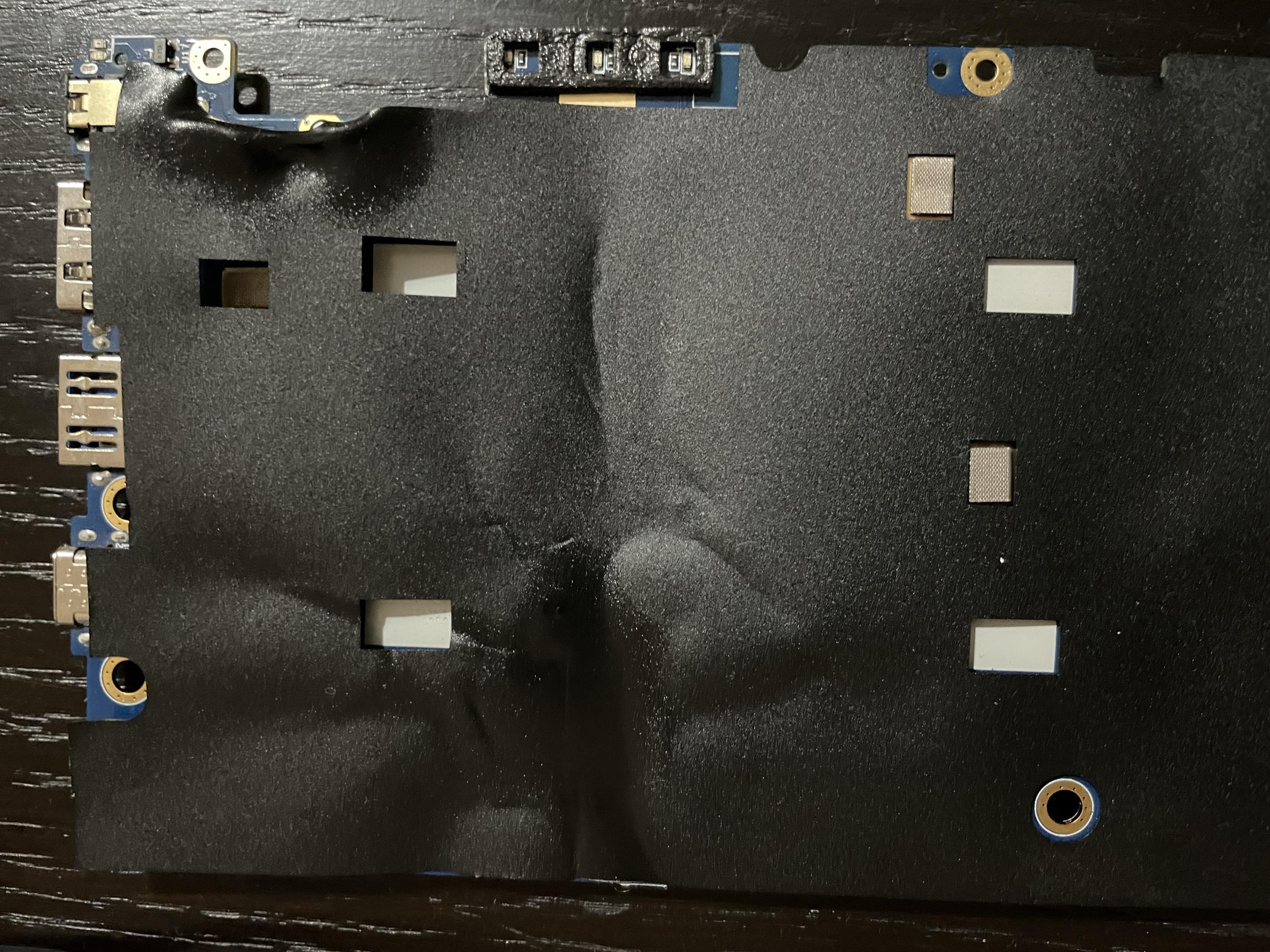

    Removing the MB I first noticed the PET film insulator at the back is thermal shrinked seemingly coming from the battery circuit and heavily distorted behind the 2nd DC-in mosfet Q25 (MDV3604).
    The battery itself is drained to 0, with one cell being a little bulgy. I guess the battery died and the circuit tried to push amperes in it?
    Anyway with a 19.5V adapter (not original) hooked I have 19V on drain of the 2nd DC-in mosfet.
    I have a short to ground on inductor L9, TC17, TC16 and several caps around.
    The cap pointed with a red arrow almost fell off when probed as the solder probably melted from the short (still the cap out of circuit is not shorted)
    A small solder ball on the drain of PQ5 (MDV3604).
    Charging Controller PU1 is BQ24780S
    Now, I read the sticky for laptop battery charging circuit troubleshooting, but I would appreciate if there was a point out as to how to find the short. If I am to hook up a 1V, should I input it on the drain of PQ5? (right next to it there's a pad of cathode D45)

    Re: dynabook Satellite Pro c50-h-W10 power issue
    Where you measure a low resistance to ground yet the rail should be a higher voltage than 1 volt is a candidate for voltage injection. Need to be sure to keep the voltage low at 1 volt or lower to start. Higher current is ok.
    We use 0v8 at 30A for injection which nukes out the shorted part.
    The key point is to ideally prevent the CPU from getting hit with a high voltage injection, in case there is a high side mosfet that is leaky.
        Wrong direction. TC16/17 are part of Vcore circuit and its supposed to be high current,low resistance rail. Set your meter to ohms mode and then put black probe to GND and red probe on postive side of TC16/17. What is the exact reading?(Meter should be set to 200 Ohms). Dont inject voltage here as you may kill the cpu.
          Positive or negative started with 1 Ohm and after checking over some more, dropped to 0,6 Ohm

            Anywhere I measured in this rail, I had 1 Ohm resistance to ground. As some time passed the resistance measurements were dropping up to 0,6 Ohm

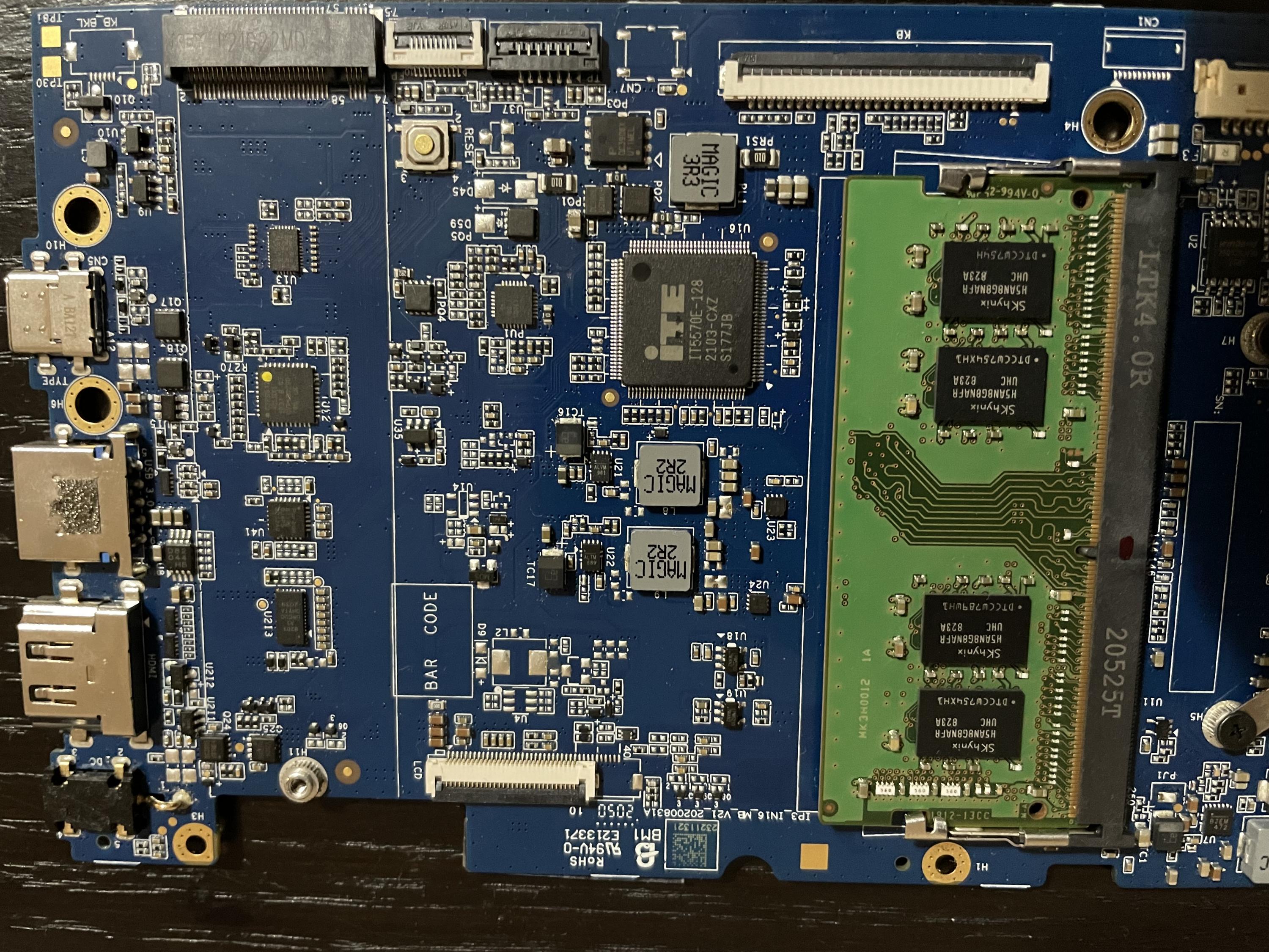

                    I want to give another shot on this laptop.
                    Here are some more information:
                    TC1, TC11, TC14, TC13, TC16, TC17 are all shorted rails. 0Ω) i lifted them 1 by 1 and they all test fine out of circuit.
                    Then removed some components like in photo attached but still have the same result.
                    After L9 removal at least the short to ground disappears on the left pin.
                    • Sraros
                      • Jan 2017
                      • 223
                      • Greece
                      Some additional information that may help
                      L9 is the 5V rail
                      L8 the 3.3 rail
                      PL1 the battery charging rail, 8V
                      on PQ5 I have 19V coming from the right side
                      • Sraros
                        • Jan 2017
                        • 223
                        • Greece
                        Finally found the short at U22 QFN reading ALTM689.
                        I ordered the part as NB679 as I found it from another post here. So waiting for it and hopefully it comes back to life…
