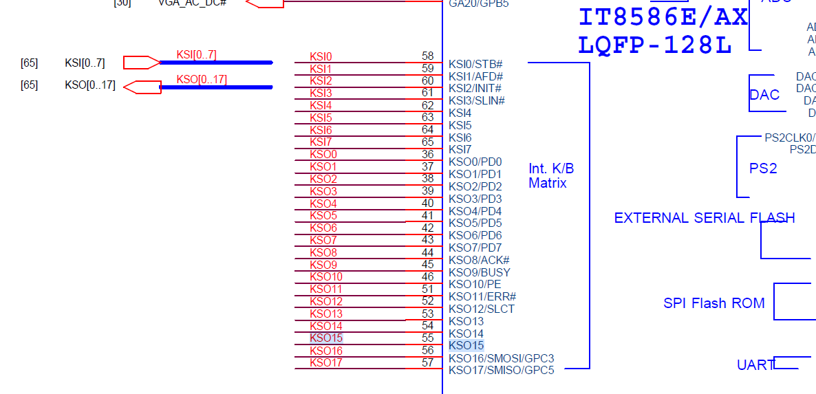

    Hi, I have a Notebook that have a keyboard problem.
    Some principal keys not corresponding.
    Example:
    key Esc on keyboard -- > is a space
    key Space on keyboard -- >is Enter
    key up arrow on keyboard --> is a down arrow
    I change the keyboard and the problem is the same.
    With a USB keyboard all keys work fine.
    It can be keyboard Matrix circuit problem...

    What is the laptop model number and motherboard part number. If there is a schematic available post a link to it.
    • Inforgalaxie
      • Apr 2023
      • 37
      • Portugal
      Re: Keyboard Problems
      Lenovo Thinkpad L460
      Board: BL460 NM-A651
      2015-10-26
      REV 1.0
      Schematic -> https://www.badcaps.net/forum/showthread.php?t=85725

          Confirm there is no damage or lifted pads on the actual keyboard connector @ JKB1. Confirm the solder joints are solid and without corrosion. Clean with IPA (alcohol) to be sure.
          Assuming the keyboards being tested are compatible with the logic board, check that each GPIO pin used for the keyboard scan function are not damaged.
          Remove all power. Meter in DIODE mode.
          Red meter probe, yes red to ground.
          Black meter probe to the pin to test.
          Test each KSxx pin in diode mode and post each measurement.
          Suggest to test this group of pins without your keyboard connected and then again, with the keyboard connected.

            Multimeter in Diode Mode
            Red meter probe on ground and Black to te PIN
            Measurement without Keyboard:
            PIN1- 720
            PIN2 - 720
            PIN3 - 720
            PIN4 - 706
            PIN5 - 720
            PIN6 - 719
            PIN7 - 709
            PIN8 - 709
            PIN10 - 709
            PIN11 - 705
            PIN12 - 718
            PIN13 - 704
            PIN14 - 704
            PIN15 - 708
            PIN16 - 706
            PIN17 - 706
            PIN18 - 706
            PIN19 - 708
            PIN20 - 709
            PIN21 - 709
            PIN22 - 709
            PIN23 - 709
            PIN24 - 709
            PIN25 - 635
            PIN26 - 527
            PIN27 - 530
            PIN28 - 532
            PIN29 - 578
            PIN30 - 0
            PIN31 - 706
            PIN32 - 709
            With Keyboard connected the Measurement is the same.

              what you think? Need Programming the IT8586E ?

                  For example If i go to the BIOS setup the arrows keys not corresponding. If i click right Arrow on Keyboard It corresponding Go down in BIOS setup. Sรณ its the EC SIO Controller problem..

                    Programming EC its a solution what you think?
