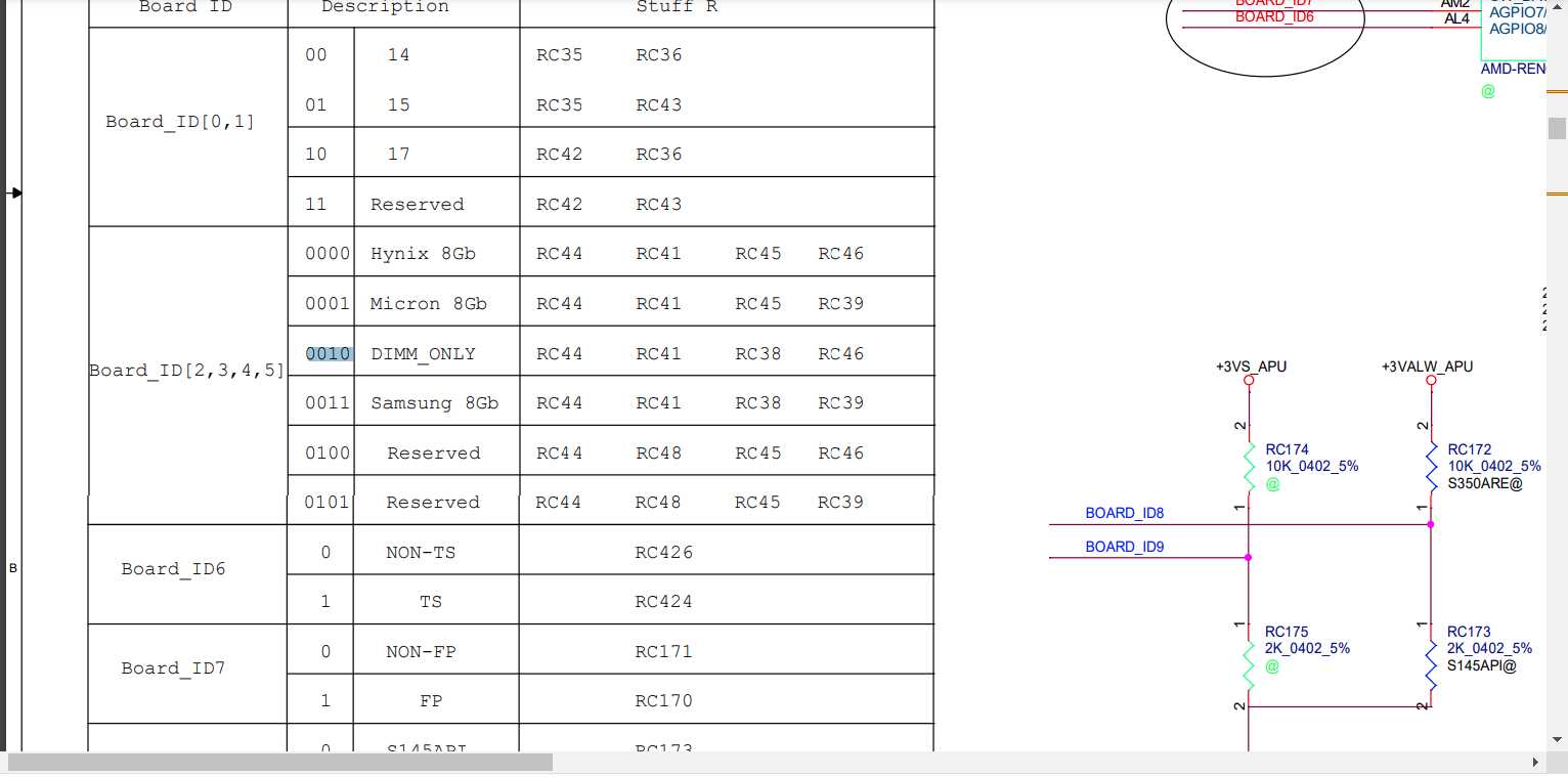

    please can some one tell me how to disable built in ram in this motherboard?
    MOD EDIT: Link to schematic -> https://www.badcaps.net/forum/showthread.php?p=1240594

      Onboard ram can be disabled easily via Board_ID - DIMM_ONLY 0010 configuration.
      Page 7 at the linked schematic.

        how to disable please? you said 0010
        can you guide us? what resistor needs to be removed or moved?
        detailed info please

          It depends on the installed RAM manufacturer as you can see in the schematic.

            combination 0010 dont work with this board NM-C861 bacuse schematic in attach have 8Gb onboard RAM and this schematic is from S350 ARE mainboard
            Have anybody correct schematic NM-C861 GS451&GS551&GS751 with 4Gb onboard RAM ?
