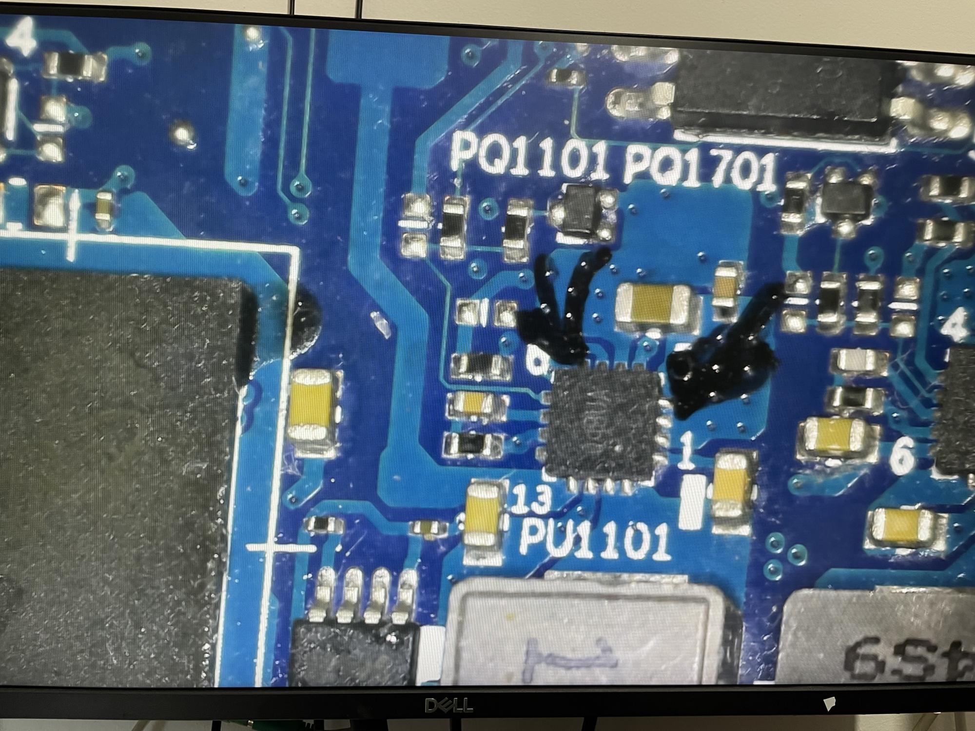

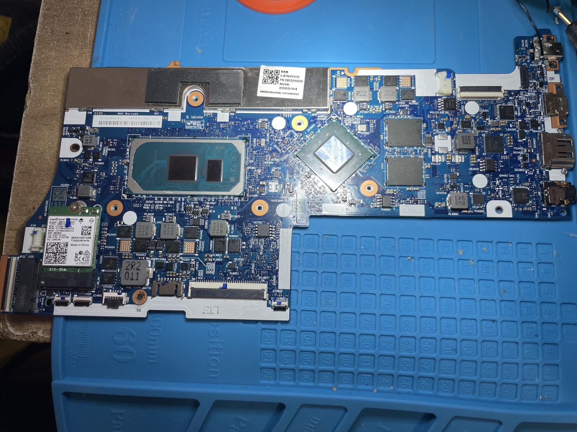

    Hi guys,
    Got this nice laptop in yesterday.

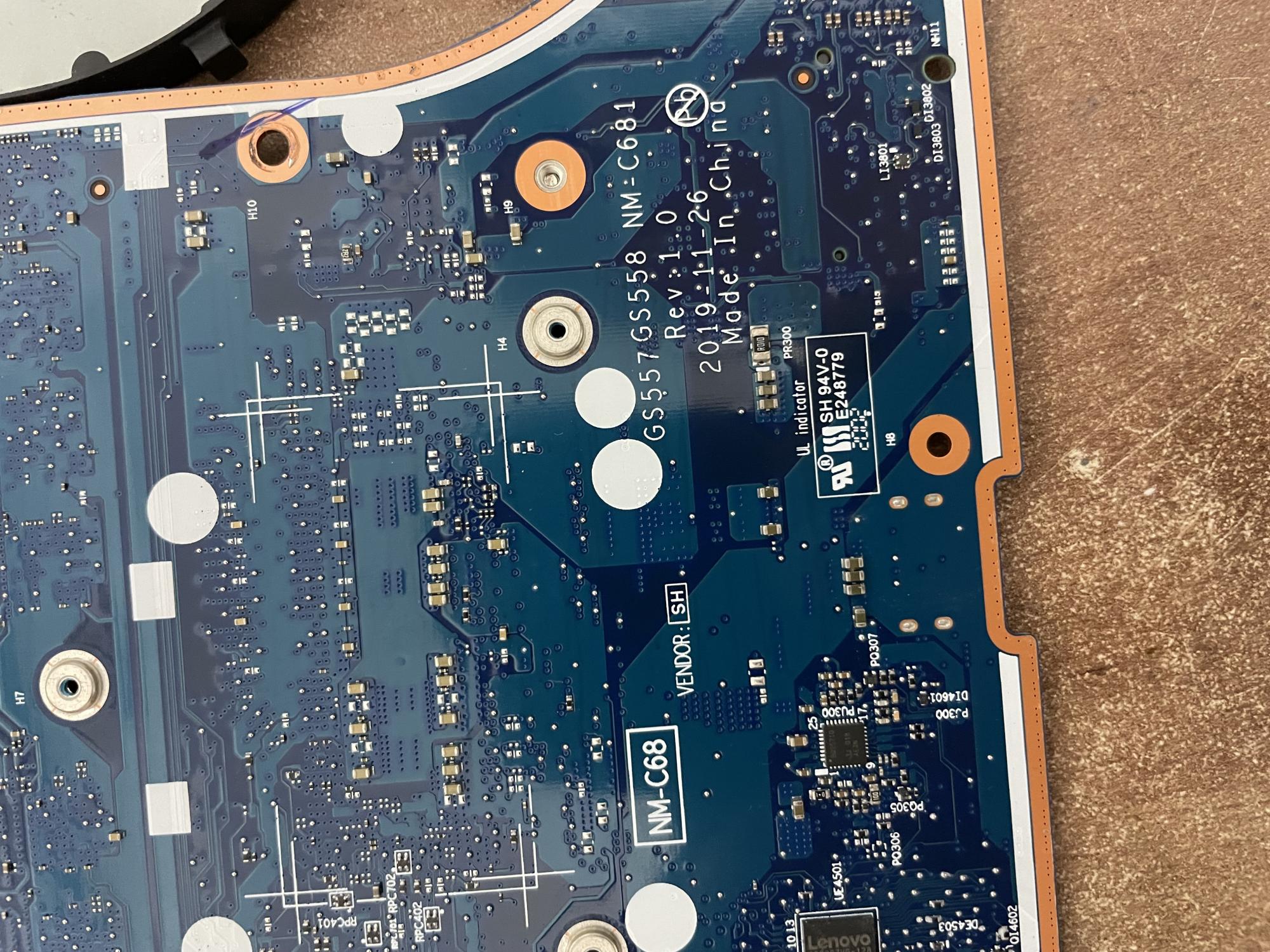

    MB: GS557GS558

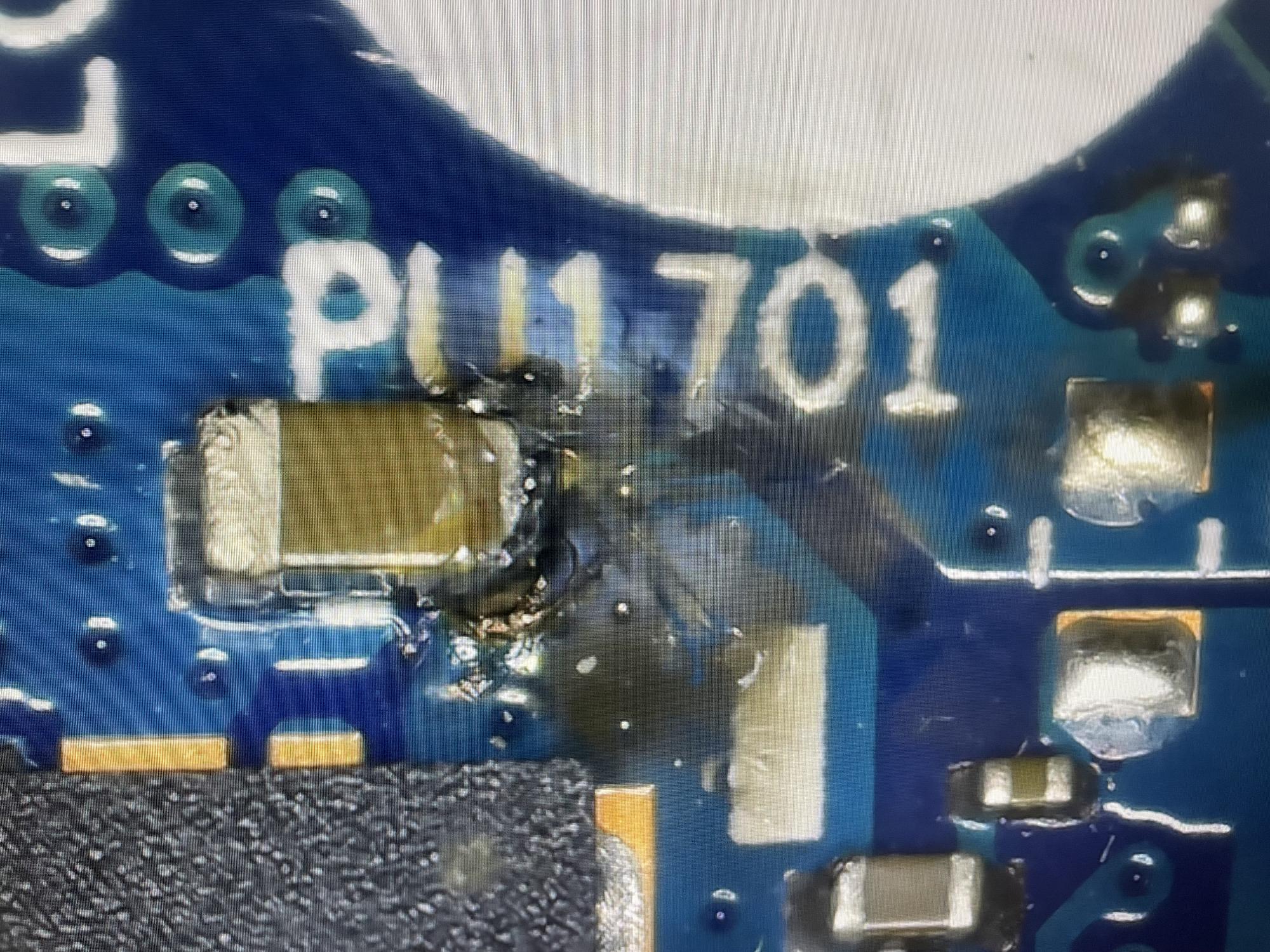

    Previous owner dropped a screw that shorted the MB.
    Removed faulty cap that got burned due to short.

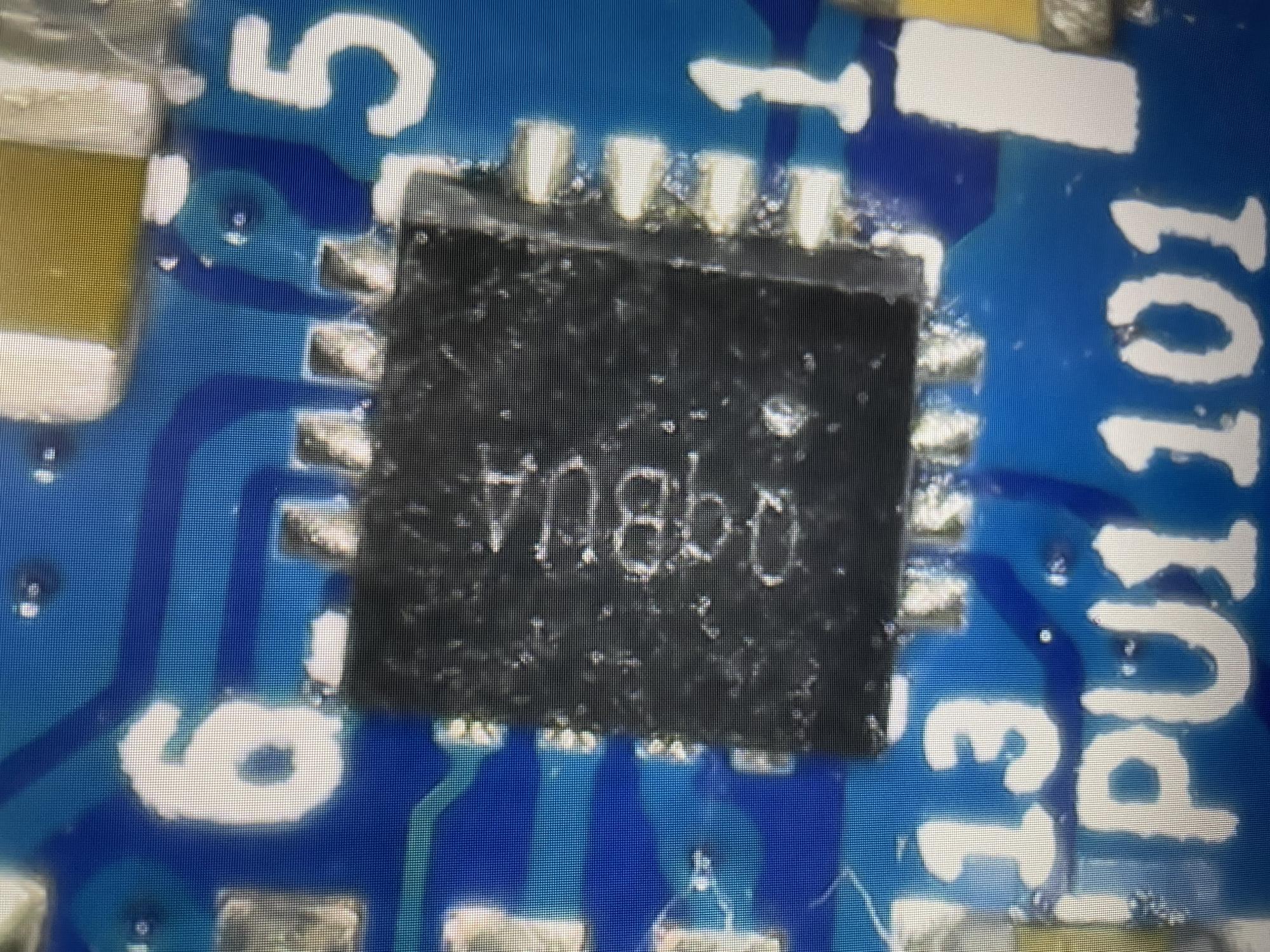

    Found burning hot ic
    QqBUA- no information about it in google.
    Any advice what is this IC?
    Would be a shame to scrap this board…

    Re: Lenovo ideapad 5 - identify shorted chip
    Silergy
    Qq*** SY8386BRHC - N/D (EL432 EL532 LA-H131P)

        The tail end of the above are the logic boards that use this part so you can study the schematic.
        As long as the part starts with Qq, you will be ok. The rest are usually datecode markings.

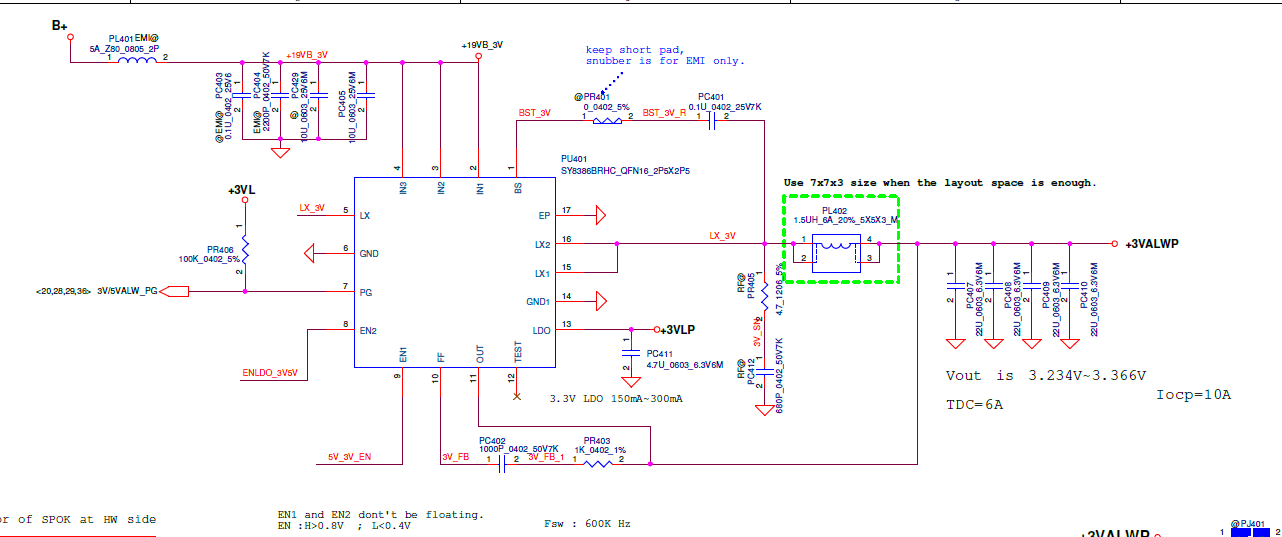

              Remove all power. Meter in resistance mode.
              Measure the resistance to ground of:
              Pin # 16 (LX2)
              Pin # 13 (LDO)
                  See attached.
                  1) Flux and remove PC414. Measure the resistance to ground again after removing this capacitor. No power during the resistance checks.
                  2) Flux and lift one leg (carefully) of the inductor @ PL402. Measure the resistance to ground again after removing this capacitor. No power during the resistance checks.
                  Which side of the circuit is with the low resistance after lifting the one leg of PL402?
                  3) Do you have an adjustable power supply that can support 1 volt?
                  4) Be sure that the replaced component is properly soldered. As a suggestion, flux and reflow the part well enough with low air pressure but spin the hot air tool in circles from the topside. Eventually, the solder will be in liquid form and allow for this component to swim onto the PCB pads and 'align like soldiers'. Louis, Alex and others have some great YT videos that demonstrate this process.
                        So it appears that you have 2 shorts linked to this regulator.
                        LDO rail is shorted.
                        Downstream switching regulator leg is shorted.
                        Be sure the QFN device is properly soldered, do check the resistance between the pins on this IC to confirm the LDO pin is not shorted with another.
                        After the above, consider to dial up 1 volt on your power supply.
                        Red probe of the power supply onto the LDO rail; black to ground. No other power sources should be applied.
                        Then monitor for which part heats up with this injection. Ok to increase the current but keep the voltage at 1 volt for now.
                        Same method can be used for the switching regulator leg where you have lifted the coil.
                        Hoping that a local capacitor heats up and is the root cause of the fault.
