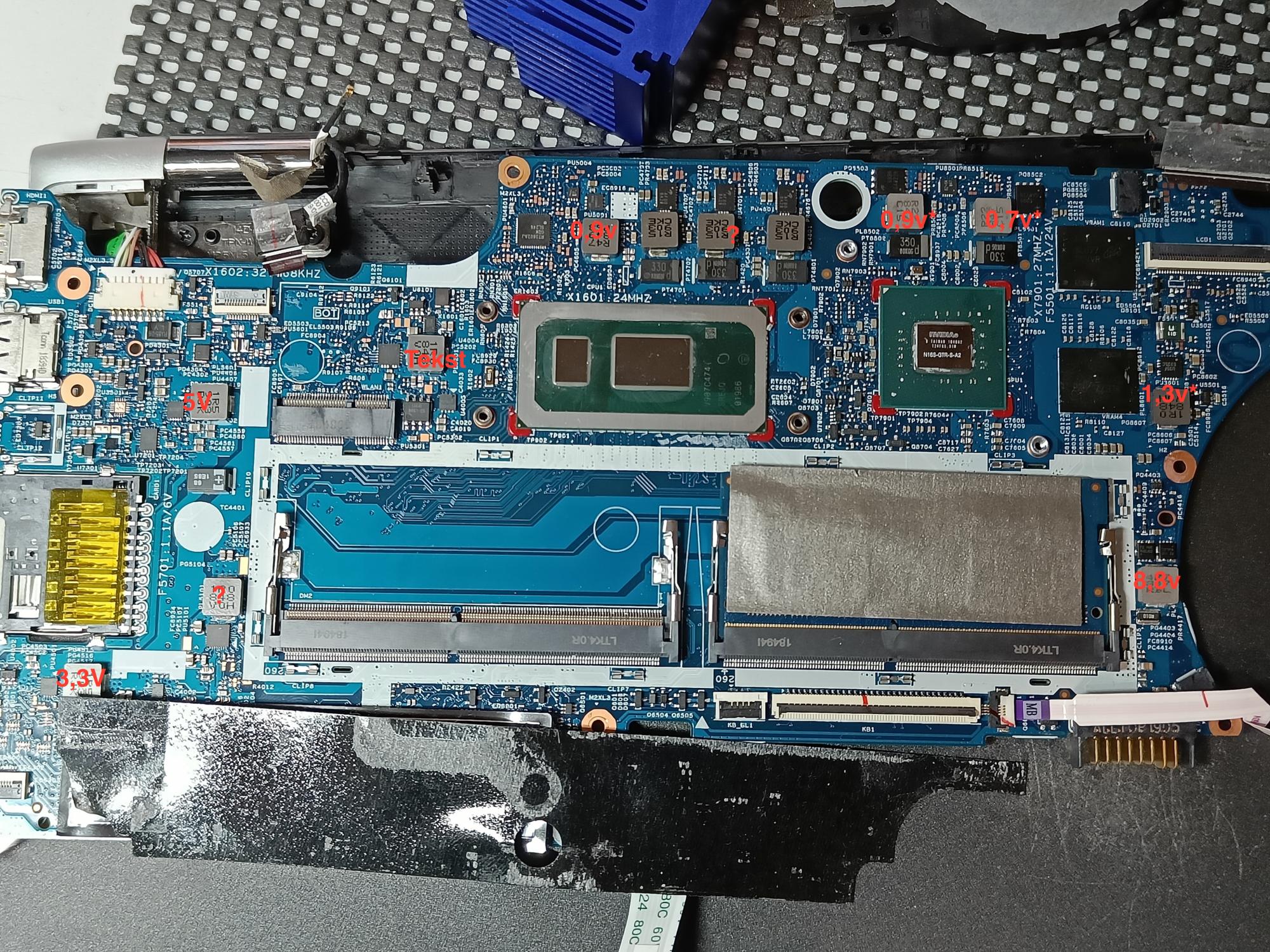

    HP Pavillion x360 convertible model:14-cd1023nb
    Mainboard: Chewbacca_14_WHL_DIS_2G
    On power connection, orange powerconneted led.
    I can measure the shown voltages.
    When pushing the power button, white power led for 3sec, the blinks every 3sec. At this 3sec pulse I can measure shortly the voltages shown with a *. These voltage with a * are not there if power button is not pressed.
    I can't understand when there is no cpu voltage, why the cpu is getting warm? warm enough to make the blue cooler bloc feel warm.
    Can't find any shorts.
