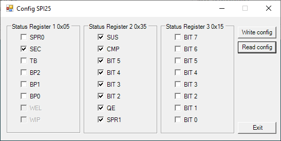

    Removed U6100 and confirmed the password was correctly removed. Restored the original EFI file and no improvement.
    U6100 program verifies correctly in the CH341A so I think the chip is ok.
    I had some difficulty with the chip reporting it was protected when trying to erase or write but it seems that was an issue with poor connection in the chip adapter. Not sure if the U6100 protection register values could possibly be the issue.

        The BIOS on these is supposed to have the QE bit set. I think there are others, would need to pull one off a board to double check. Depends on what software you are using as to how that is handled when reading/writing. I use a SVOD3 (and T56 as well) and the status registers are easily configured with them.

            Agree about the QE bit being set. I'm leaning towards some issue with the U6100 registers getting screwed up when being programmed due to fiddling with the unprotect feature. If someone knows the correct values, I will be happy to try to enter them and see what happens. I believe they are called SREGs in the CH341 application. I'm not sure but I think they are set to 0x4000H and 0xFFFFH

                I am still suspicious of the U6100 internal register values. The chip was able to be ID'd, read, erased, blank checked, written and verified while in the CH341 so I think the chip is ok. I don't see how U6101 could be the cause. However U6100 is right next to the U6100 so I had small piece of aluminum over it while using the hot air to limit its exposure to heat.
                Would getting a blank SPI chip and programming it with the original firmware that was saved before editing be worth a try?

                    Here the config registers for a PROM off a 820-4924 board using SVOD3. These are same for all the EEPROM's used by Apple for this vintage of boards. I don't know how to check these on a CH341 unfortunately.
                    If you try to power up the board without U6100 fitted, it will power cycle from S4. That will at least prove whether BIOS is attempted to be accessed.

                        The registers appeared to have those settings. However, just to be sure, I will remove the chip and put back in the CH341, erase it and start over again.
