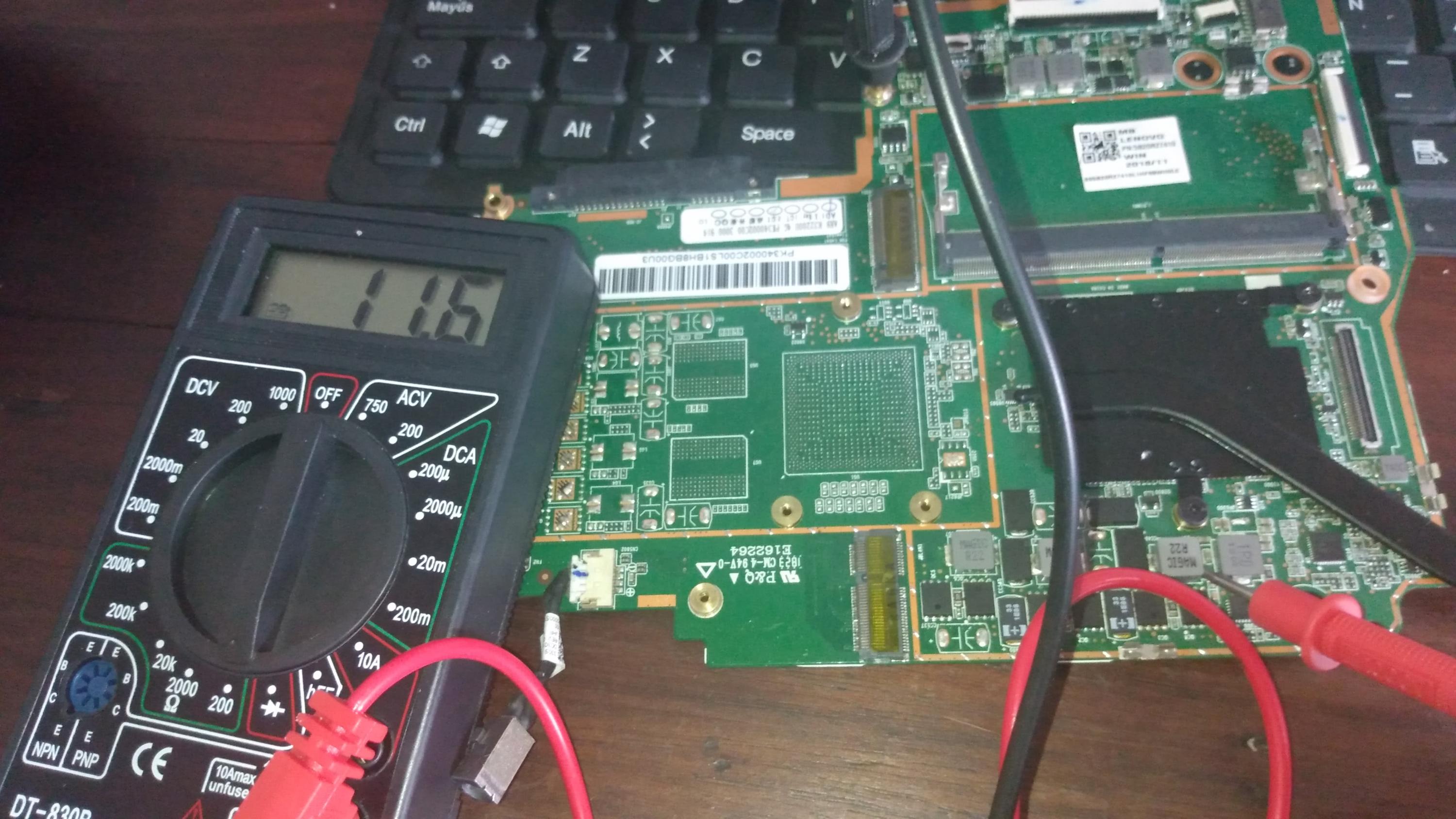

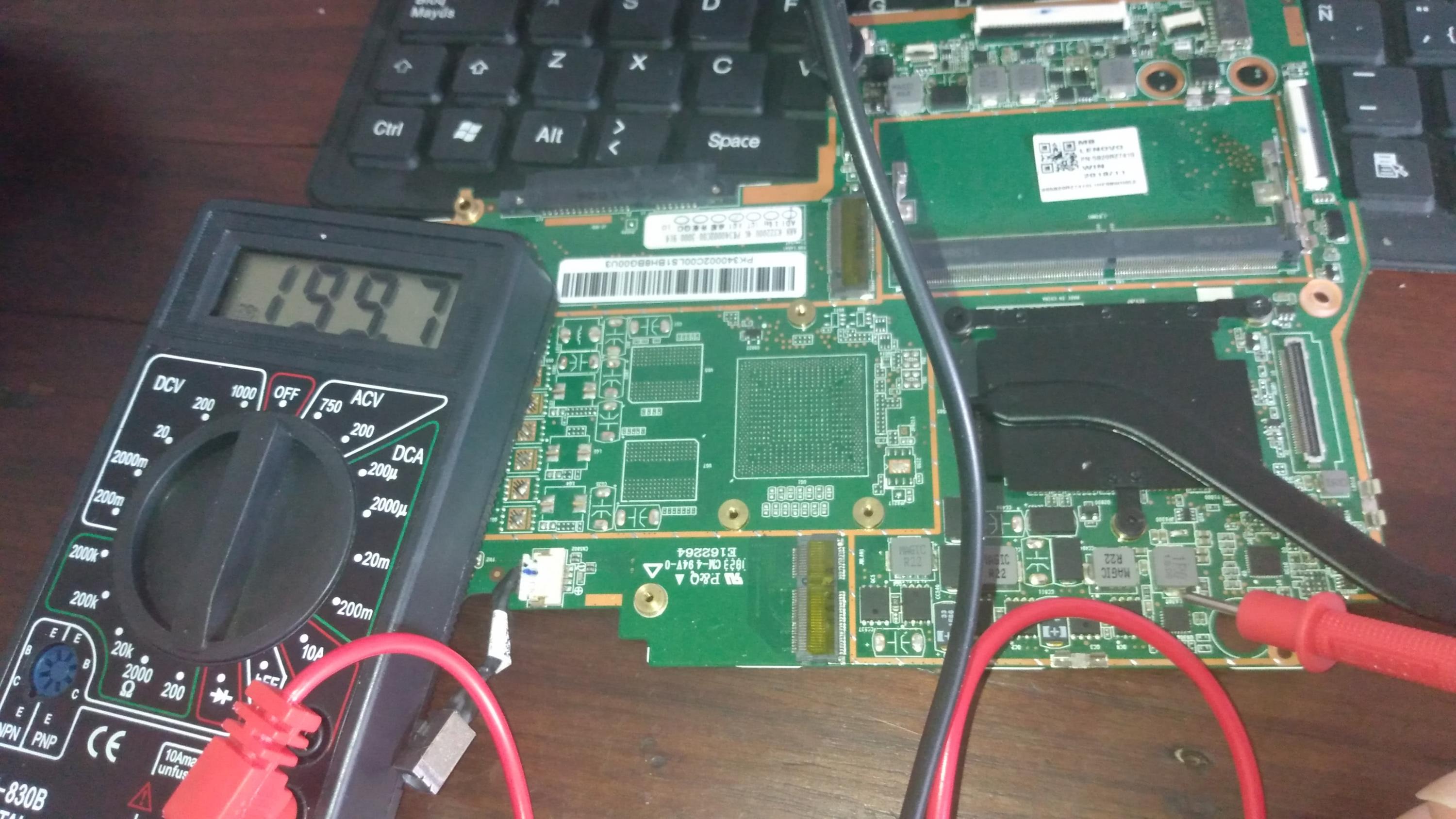

                I have checked every coil with both cables of the multimeter. COM and red are values depending on which side is touching the component.
                L6300: 86 com - red 197 (near to CPU)
                The following coils are near to the battery
                L6100: 50 com - red 192
                L5901 (this one showsa value but dissapear ) - L6002 - L6001: no value com - red

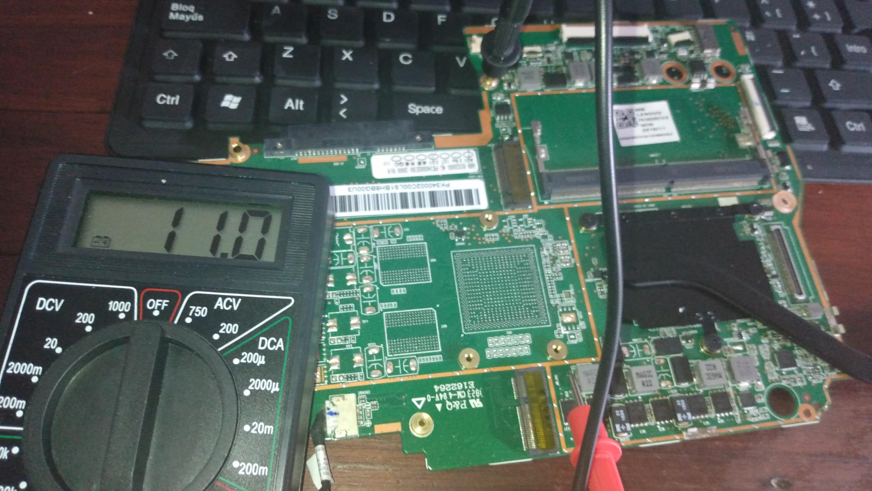

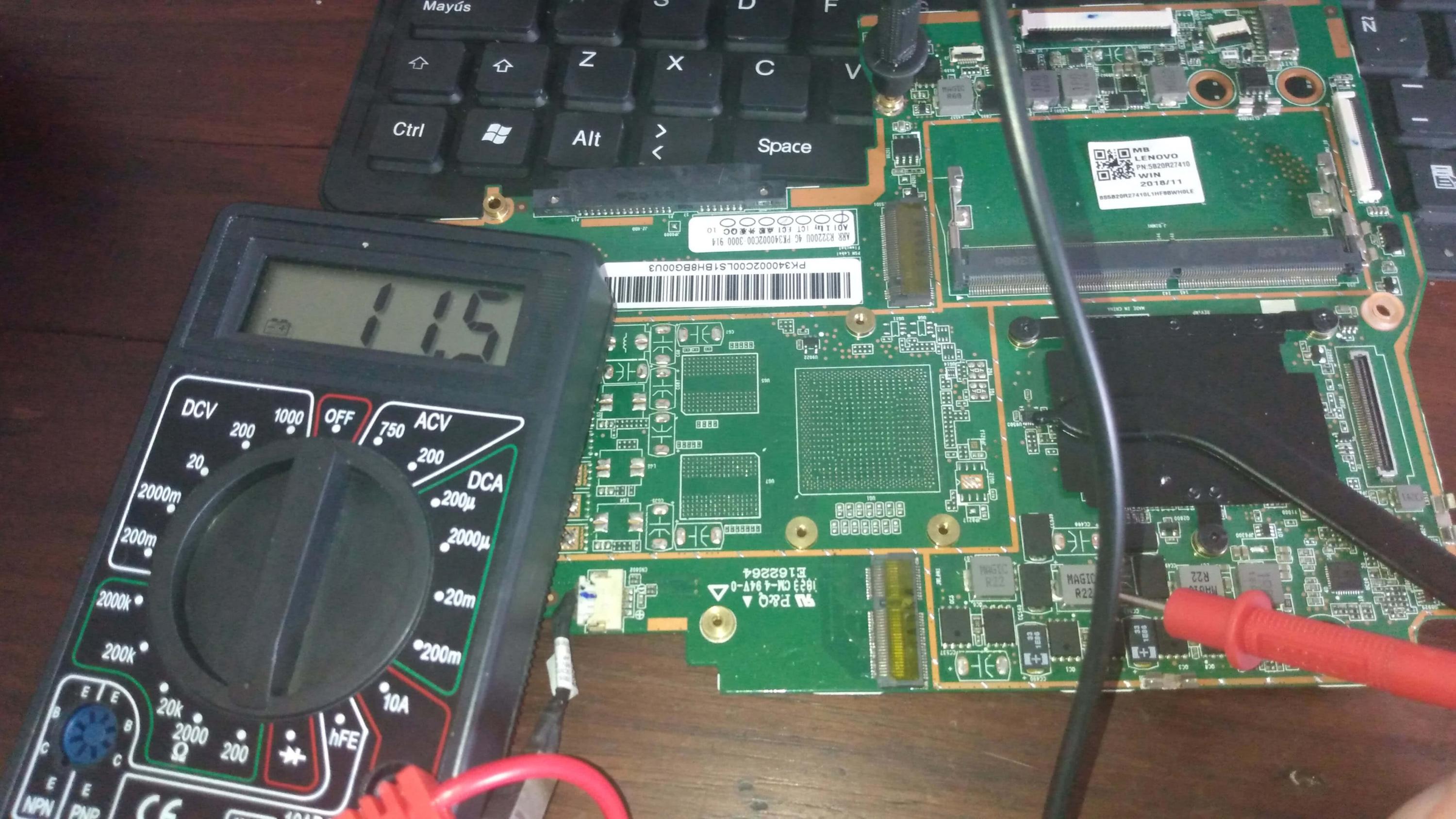

                  Re: Lenovo ideapad 330S ARR-15 high consumption reach 2.1A
                  I have measured the coils near to CPU , again and putting the references in my board, the previous references are from a boardview from similar model and doesnt match with my board
                  closer to CPU
                  L6300 189
                  LC7 10.7
                  LC6 10.7
                  LG7 10.4
                  far
                  Between baterry and RAM stick
                  Left side
                  L5901-L6001-L6002: 1
                  L4557:187
                    I could'nt understand your resistance measurements. Put black probe to GND and red probe to coil and set meter to 200 Ohms scale(if it doesnt show reading, increase it to 20K-200K).
                    Post the measurements with coil number mentioned. You are yet to mention the Motherboard marking.

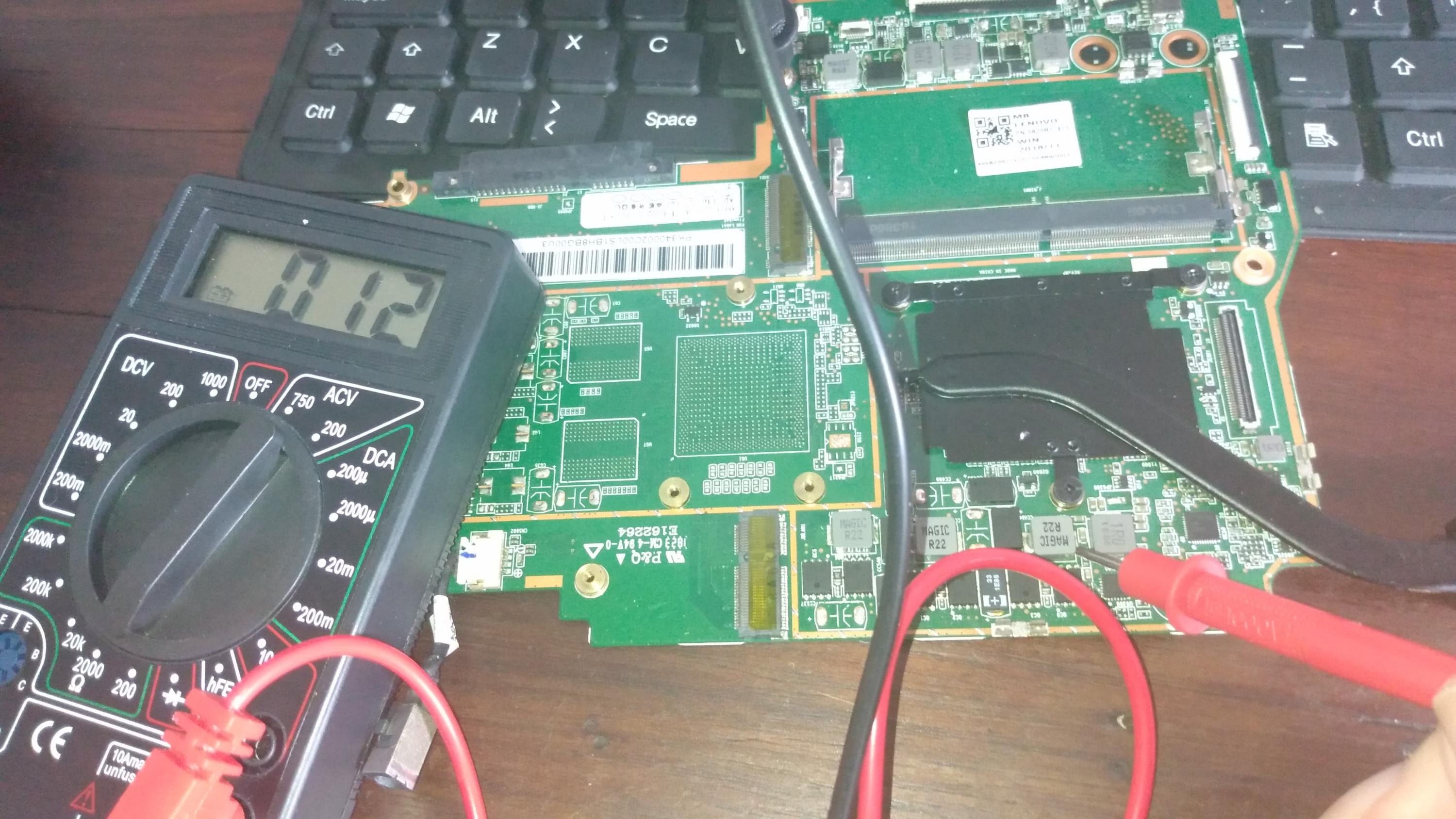

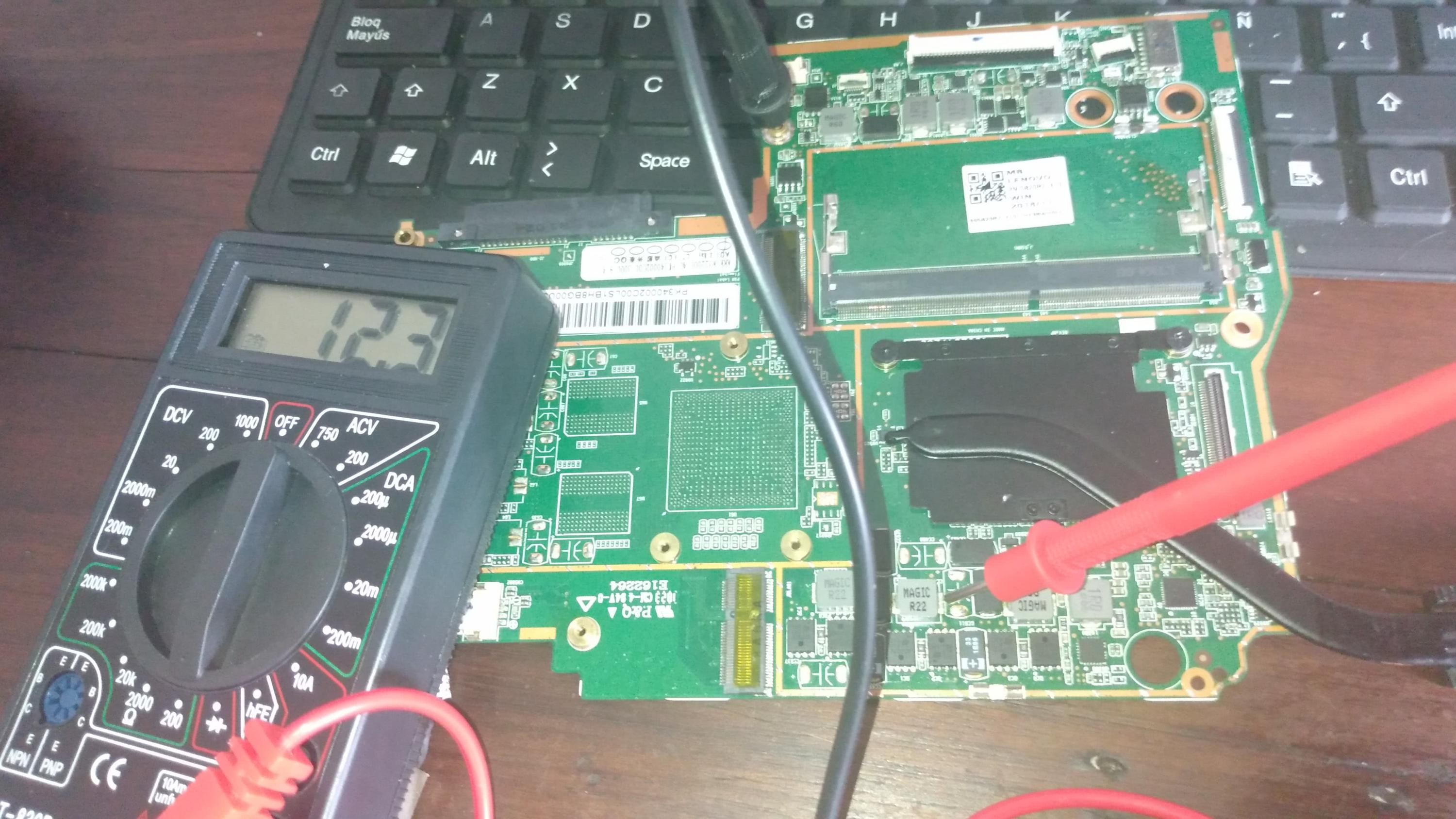

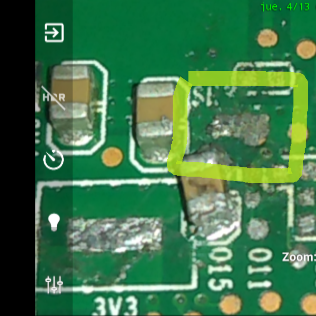

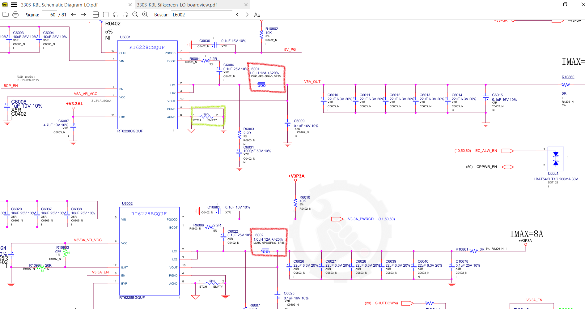

                          The motherboard marking could be P&Q 1823 cm-4 94V-0 E162264 . The schematic called by you, is very similar to my board.
                          The coil which is not showing any reading I have tried with every scale of my multimeter and doesn“t change the value in screen ( I have assured black cable in ground and red cable in the coil)
                          The green area is empty, but , when i was soldering the cap so near to this point, a drop of soldering joined PGND and AGND, the schematic marks a part SH3 but in this model the part is not soldered here from factory.
                          The red zones are the two coils you mentioned before, they are connected with the U6001 and U6002 components.
                          Something for highlight: with the charger connected (19v) , black cable in ground and i put the red cable in the place of SH3 (from factory is empty but schematic mark a component) this place makes a sparks , i did only 1 time. I finded it because was measuring voltages around the area.
                          Edit: PS The green square in image 1 and 2 are the FH3 area mentioned.
                          Last edited by Rhoemer89; 04-13-2023, 01:18 AM. Reason: Adding the aclaration of highlight in images
                            Confirm the resistance to GND on L6001/L6002 again. Resistance should be measured without power. L6001 stands for 5V and L6002 stands for 3V. Low resistance on either of these coil indicated problem. So just make sure your measuremnt is correct.

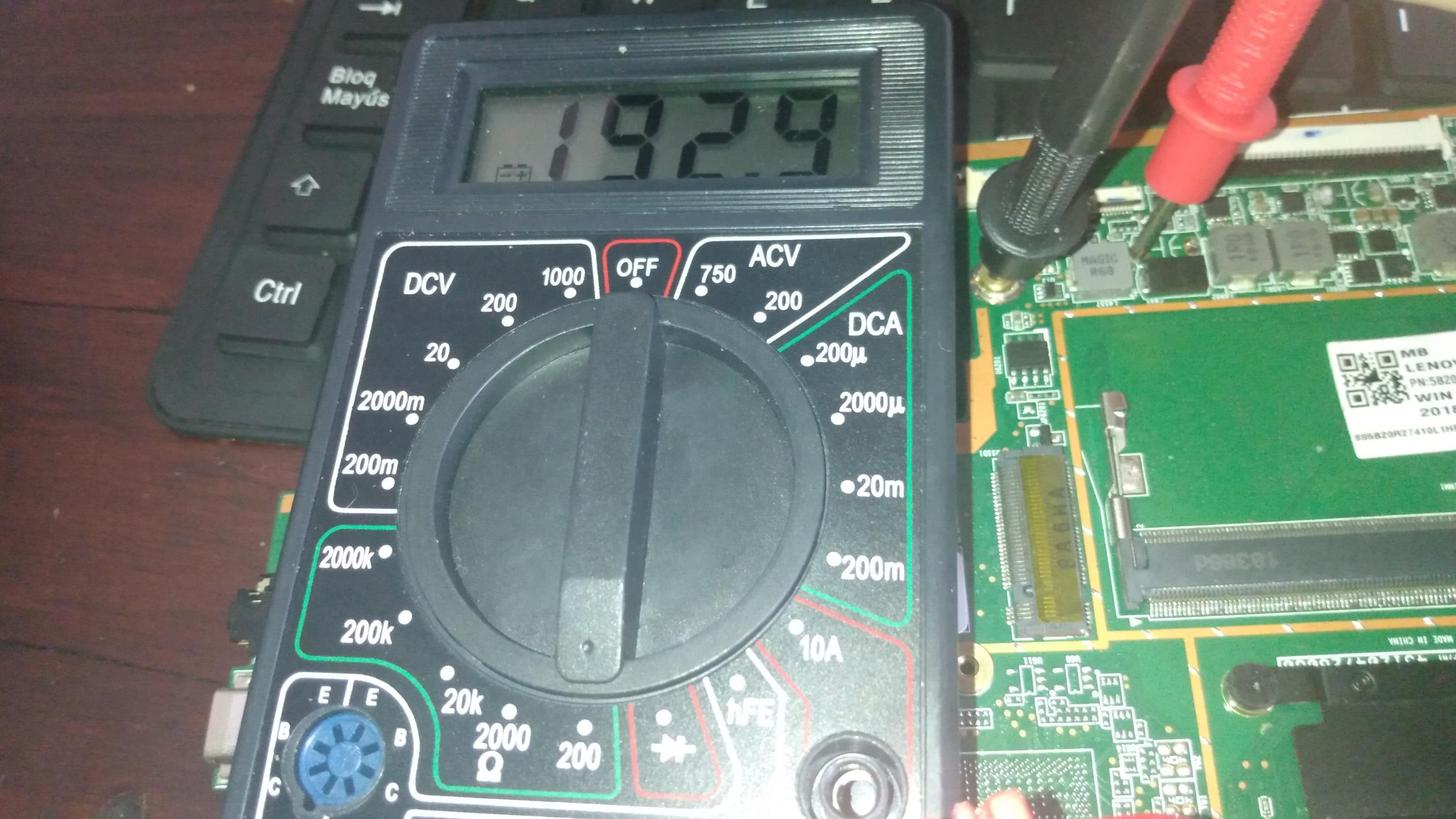

                              I have measured these coils again. These are the values

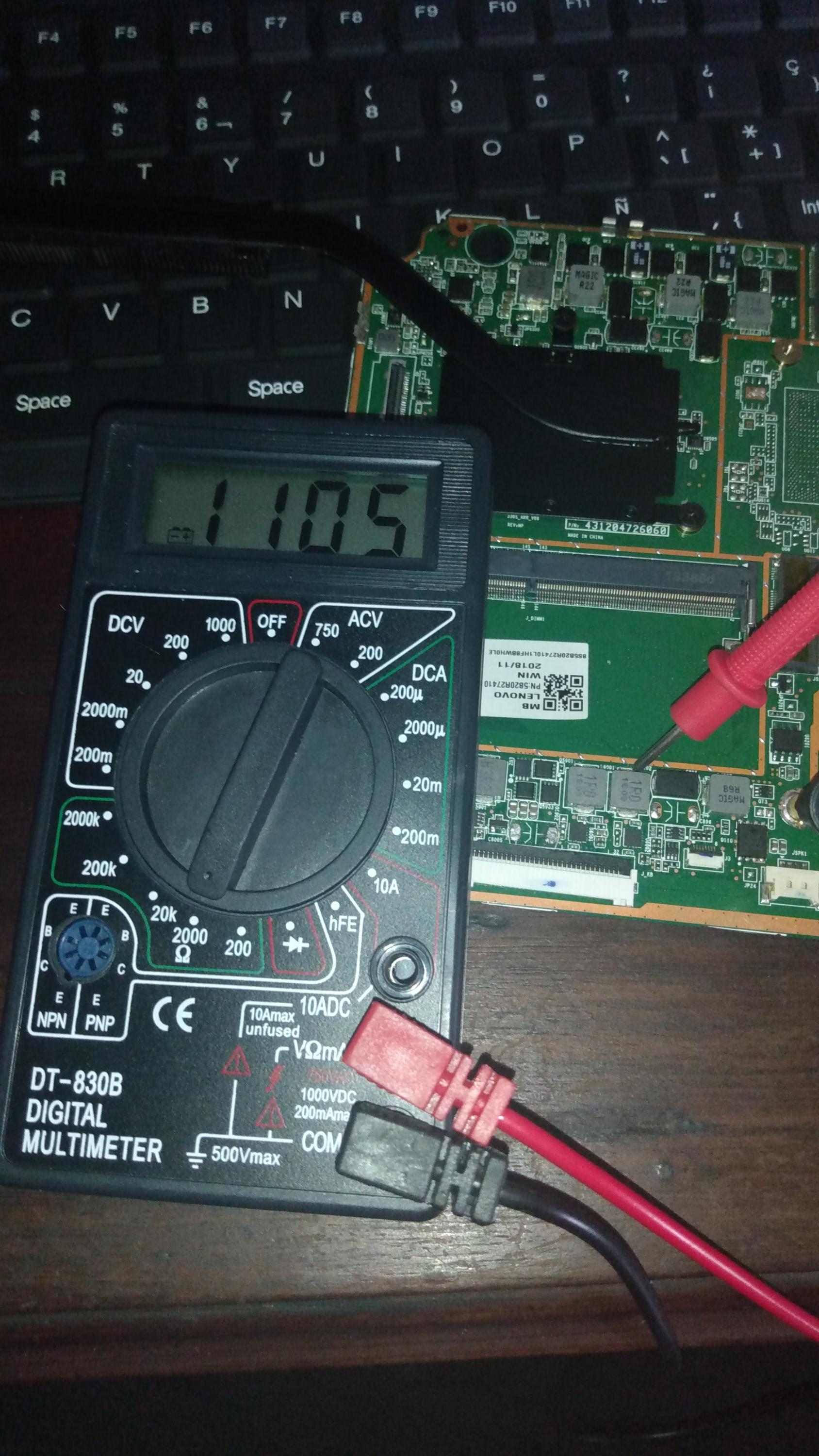

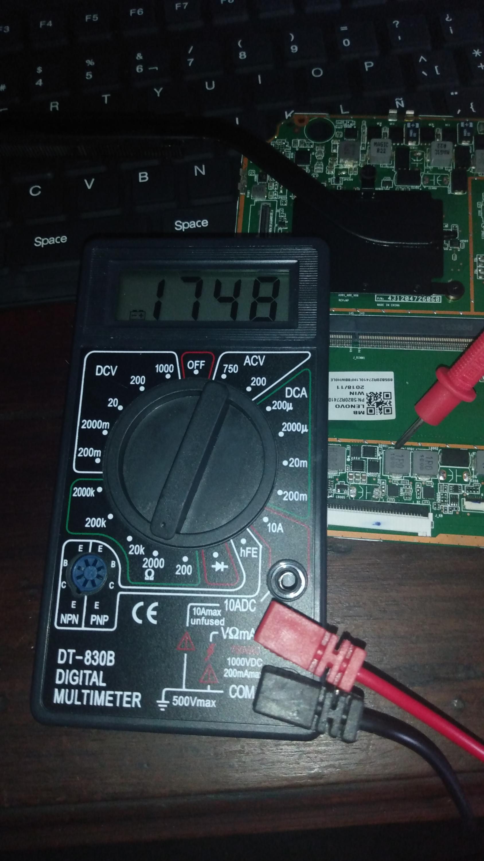

                                So one of the coils 1105 Ohms(1.1K) and the other 1748 ohms(1.7K). Please confirm these readings stands for which coil. In other words 1.1K stands for L6001 or L6002?
                                Remove both the coils from motherboard and then measure resistance to gnd on both the pads of each coil. Dont forget to mention coil number and pad pin number.
                                Btw, Do you have a dc power supply?

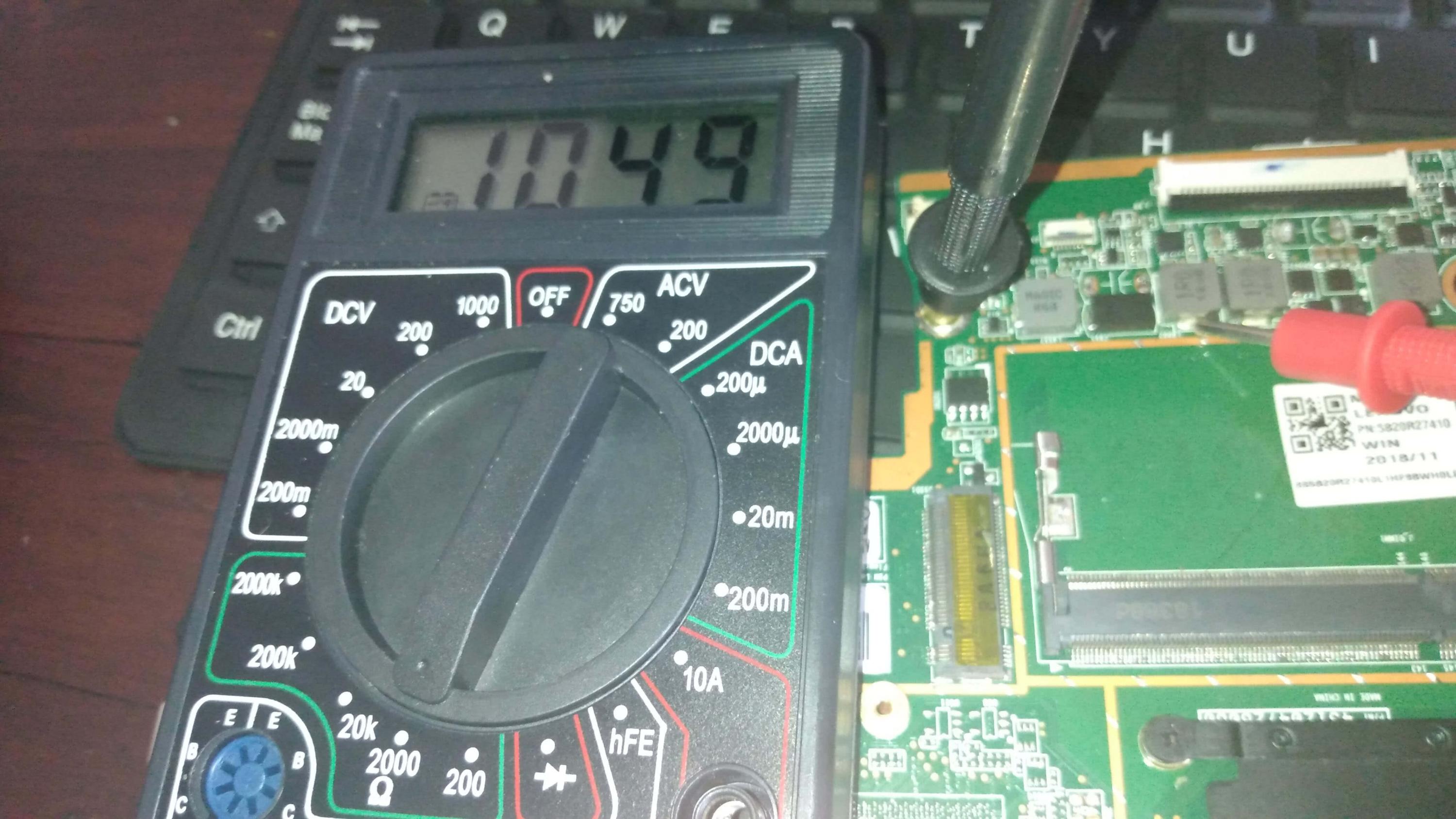

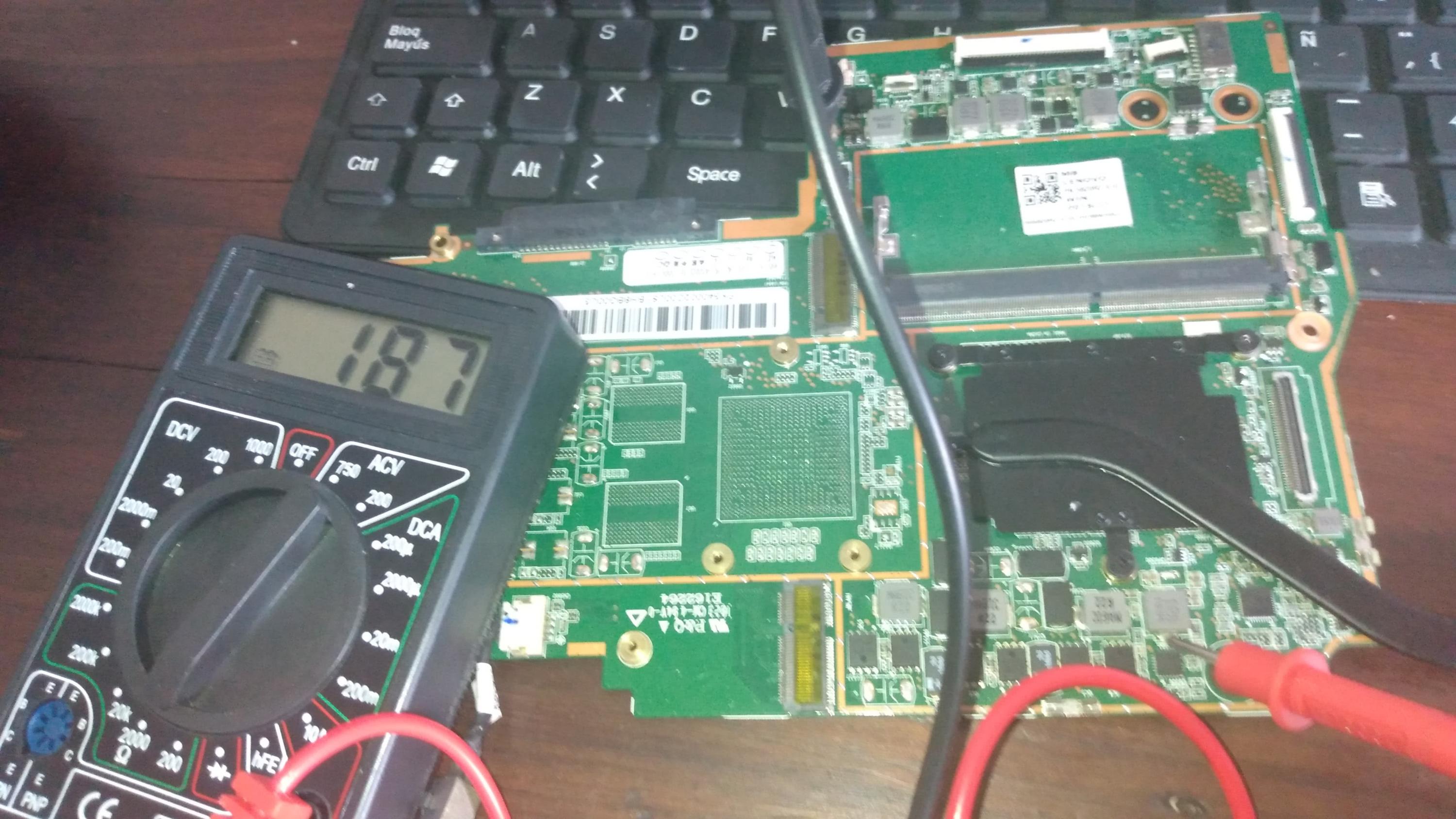

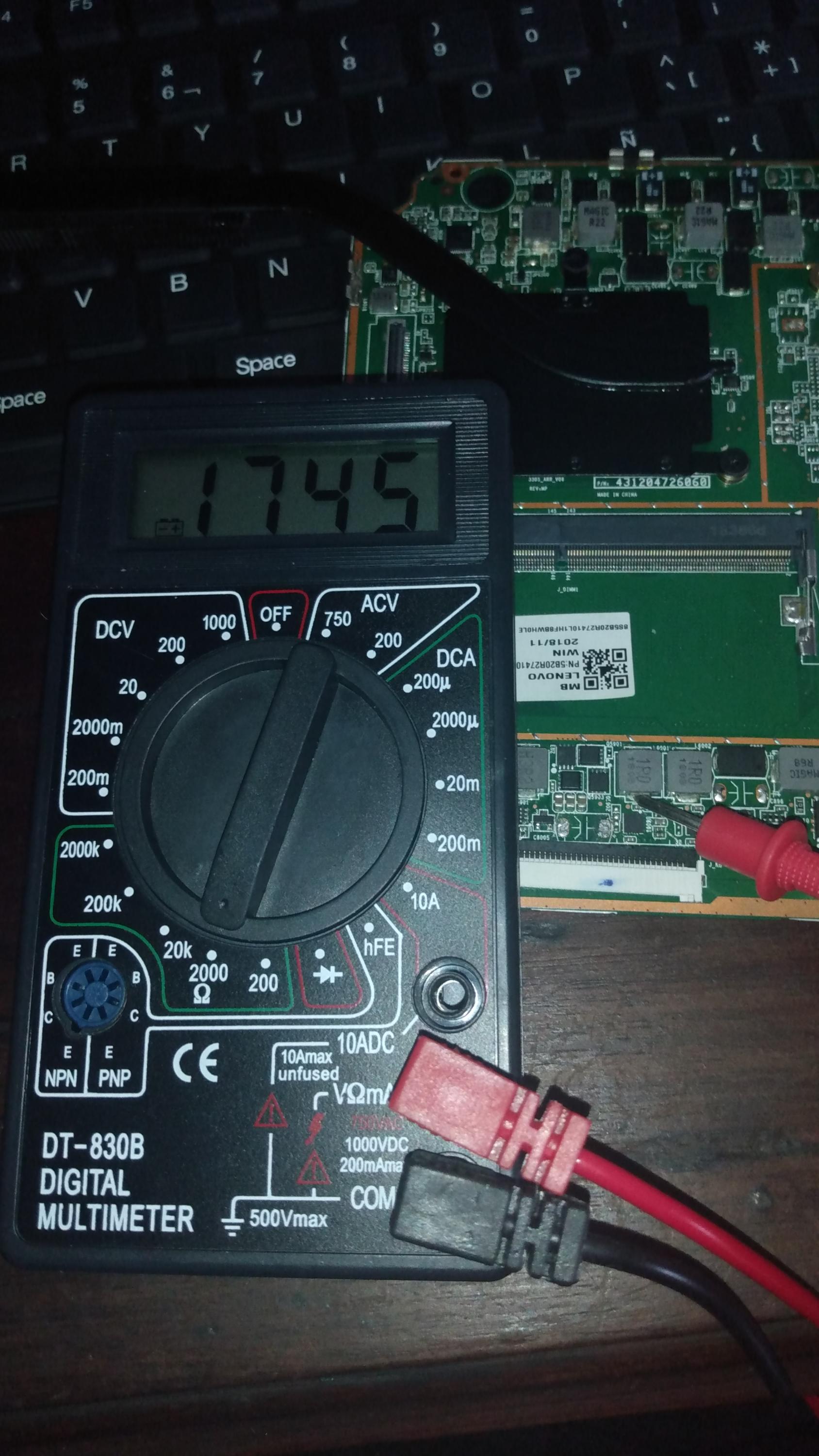

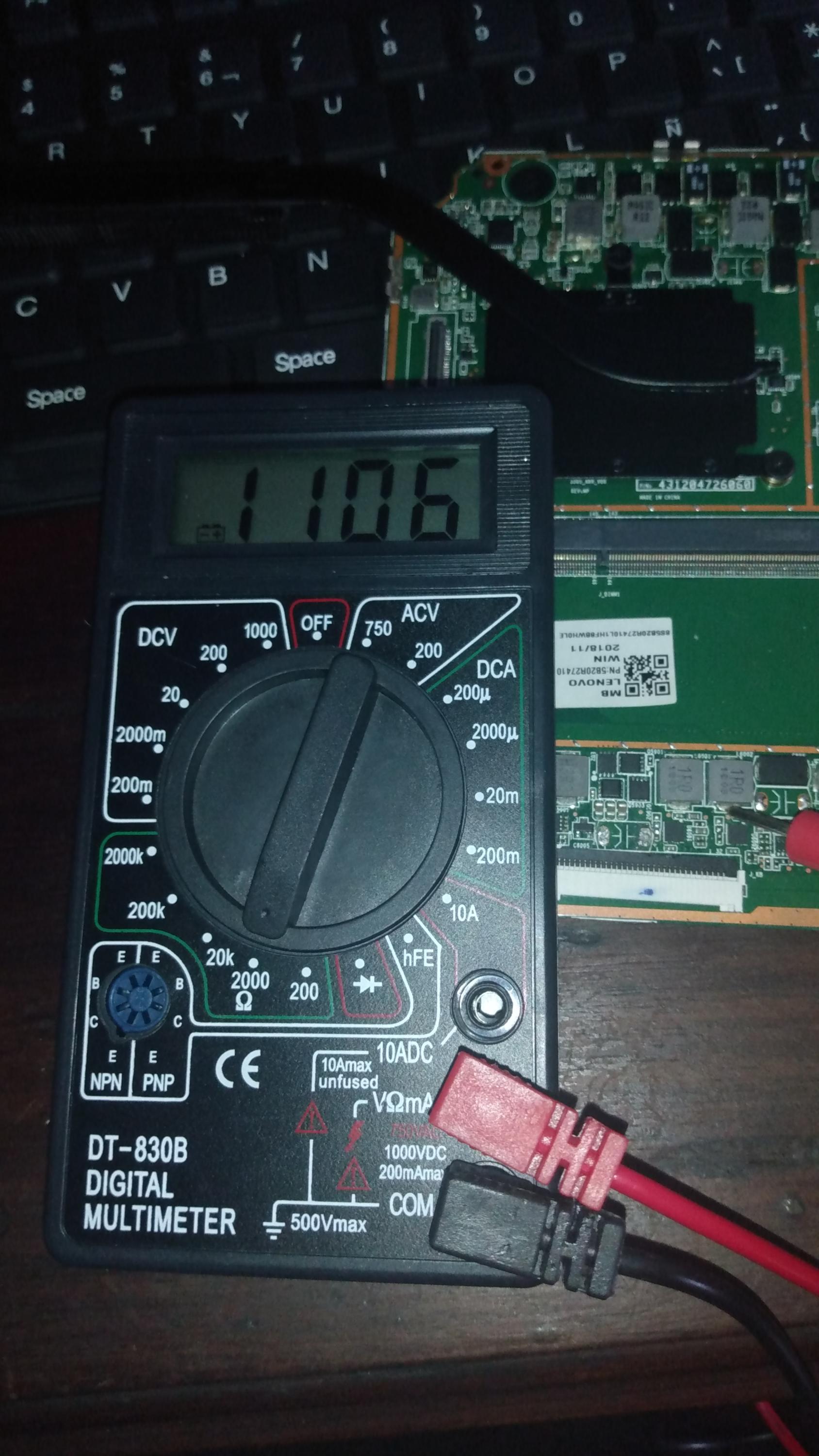

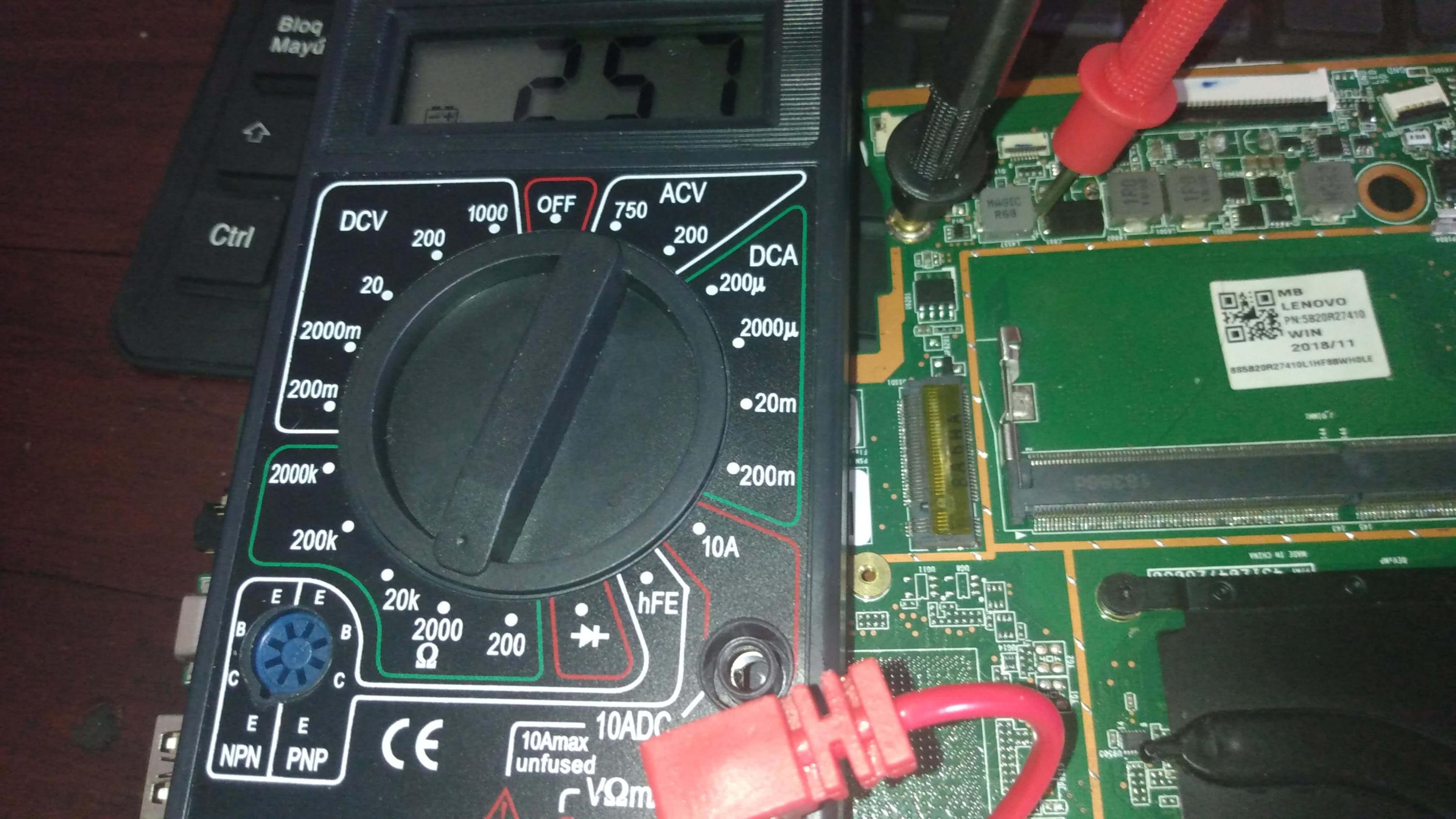

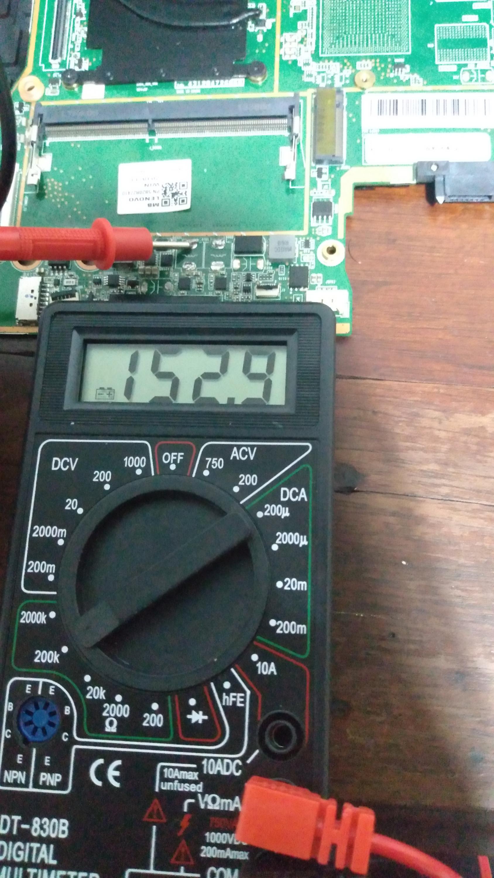

                                  L6002 = IMG_20230413_162640.jpg and IMG_20230413_162652.jpg = 1106 Ohms - 1105 Ohms
                                  L6001 = IMG_20230413_162705.jpg and IMG_20230413_162715.jpg = 1748 Ohms - 1745 Ohms
                                  These are the reading specified by references and pictures here. Let me remove the coils and update the info gathered

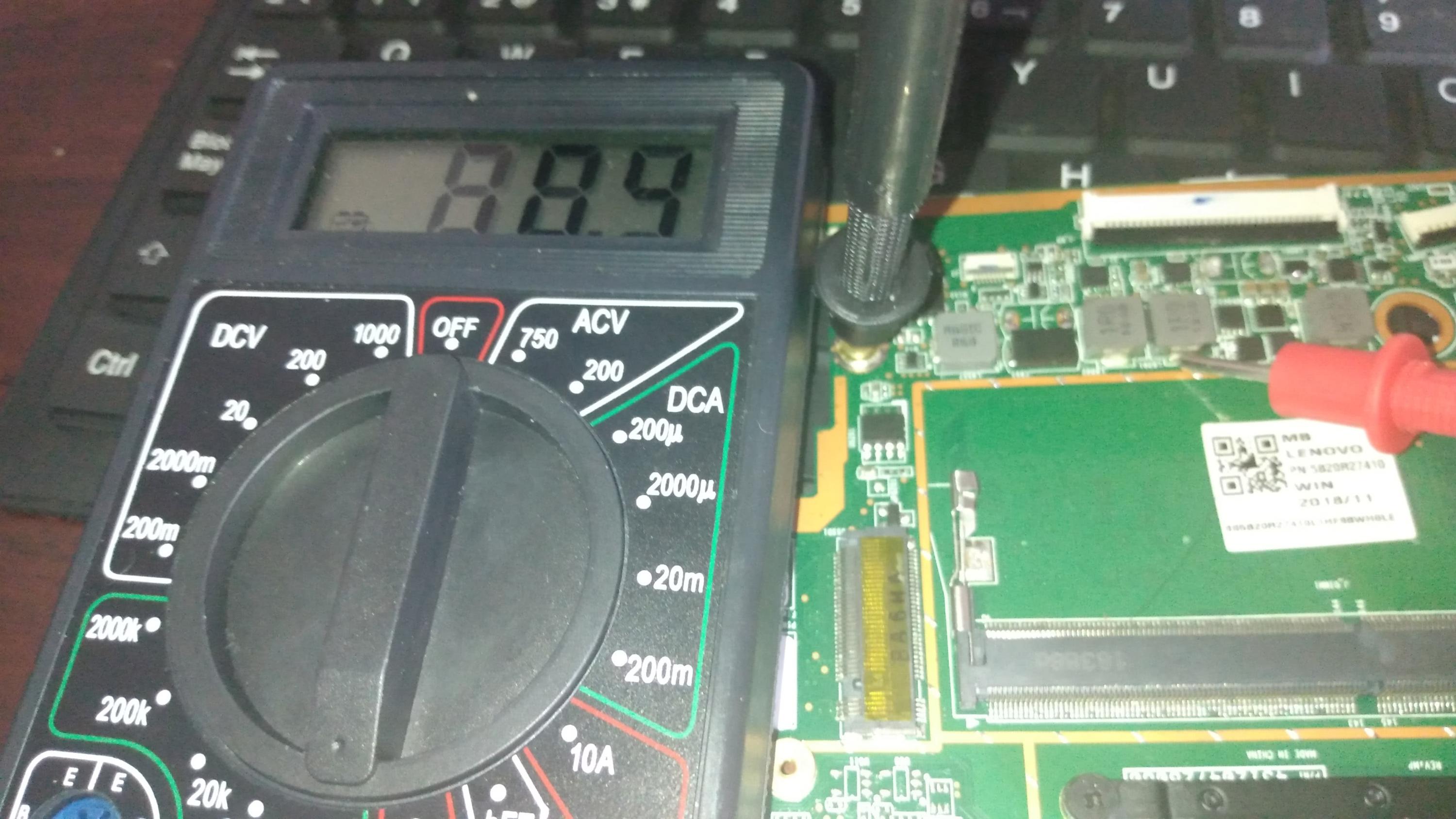

                                  • Rhoemer89
                                    • Apr 2023
                                    • 14
                                    • Colombia

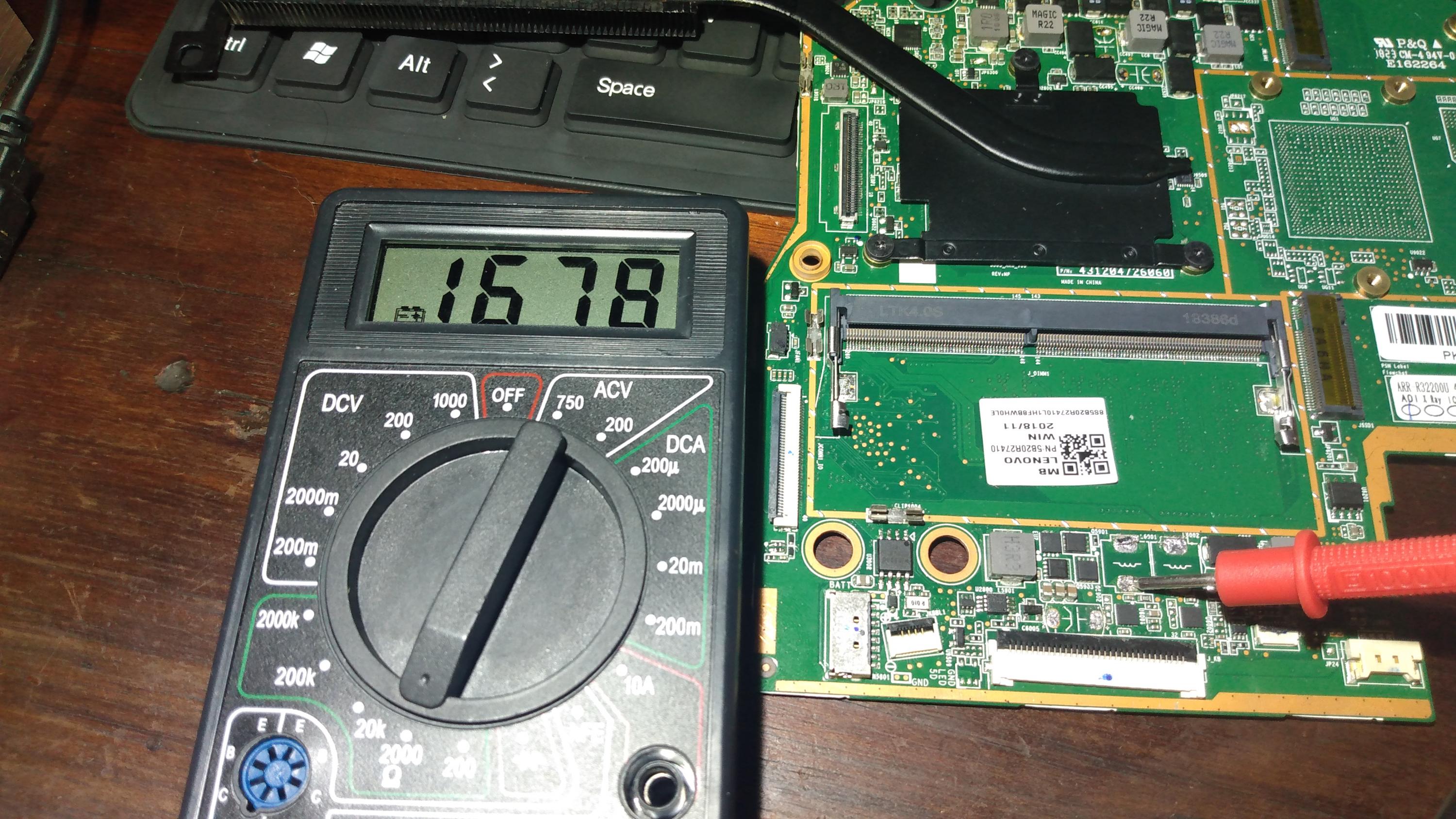

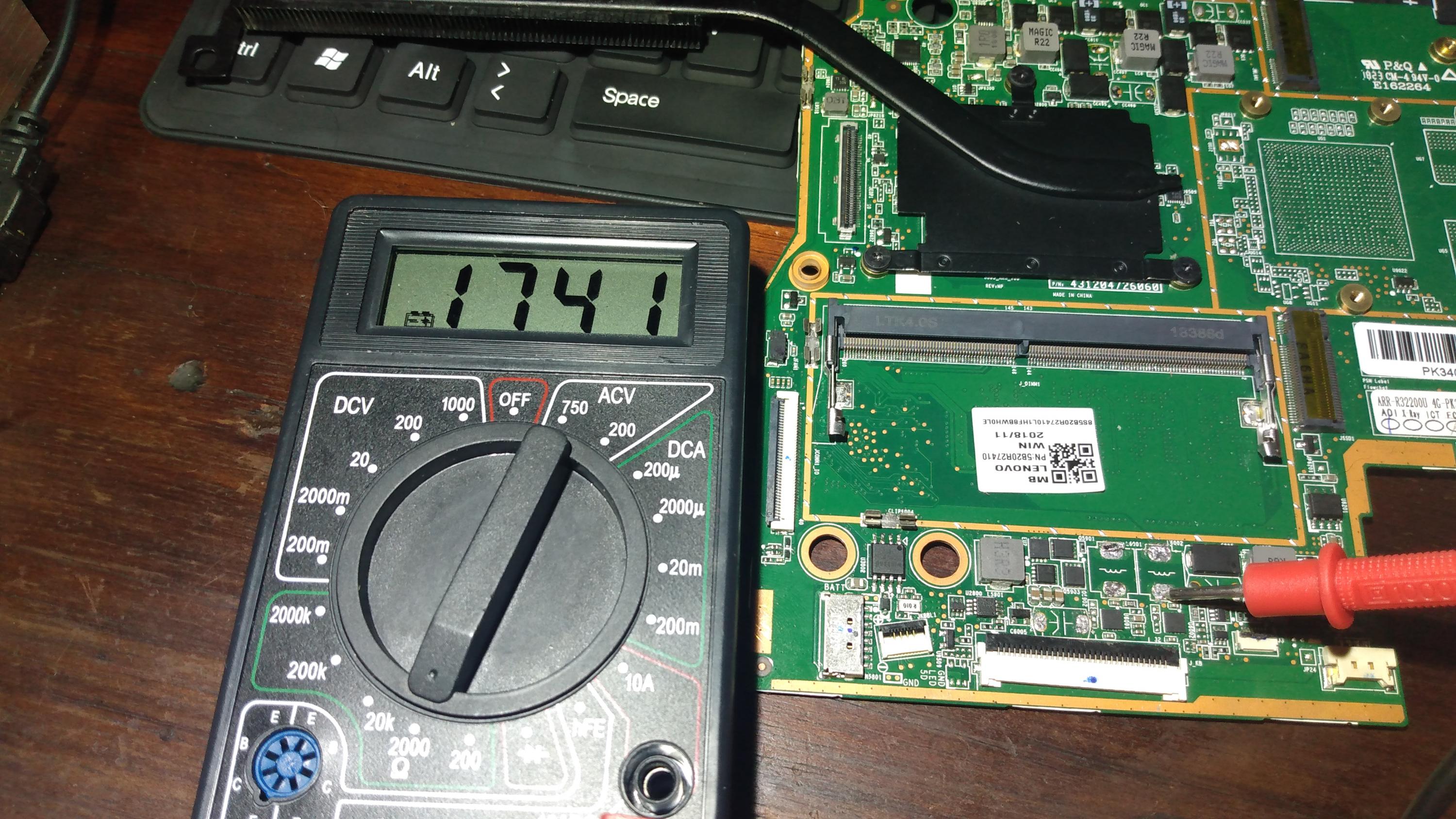

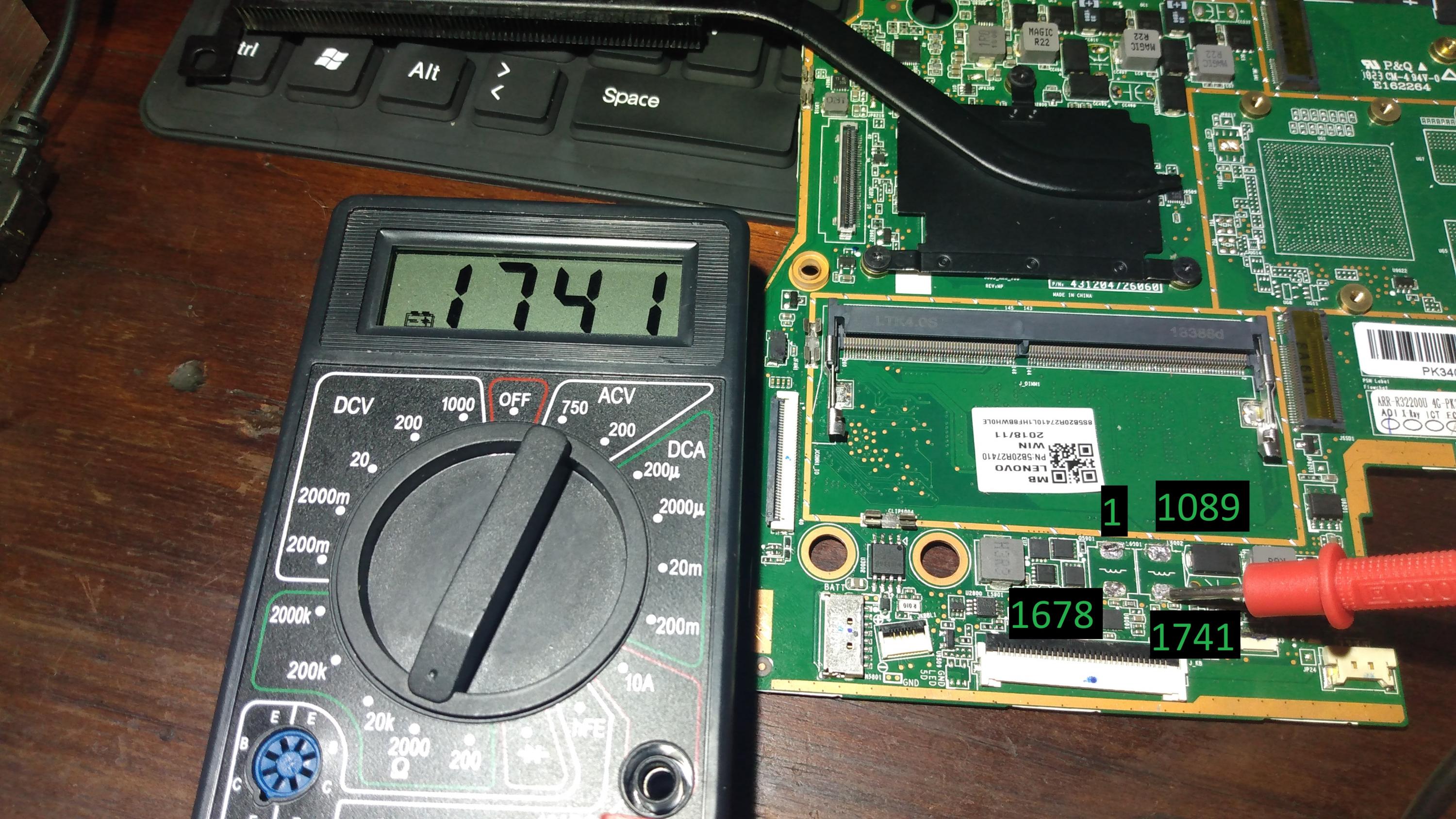

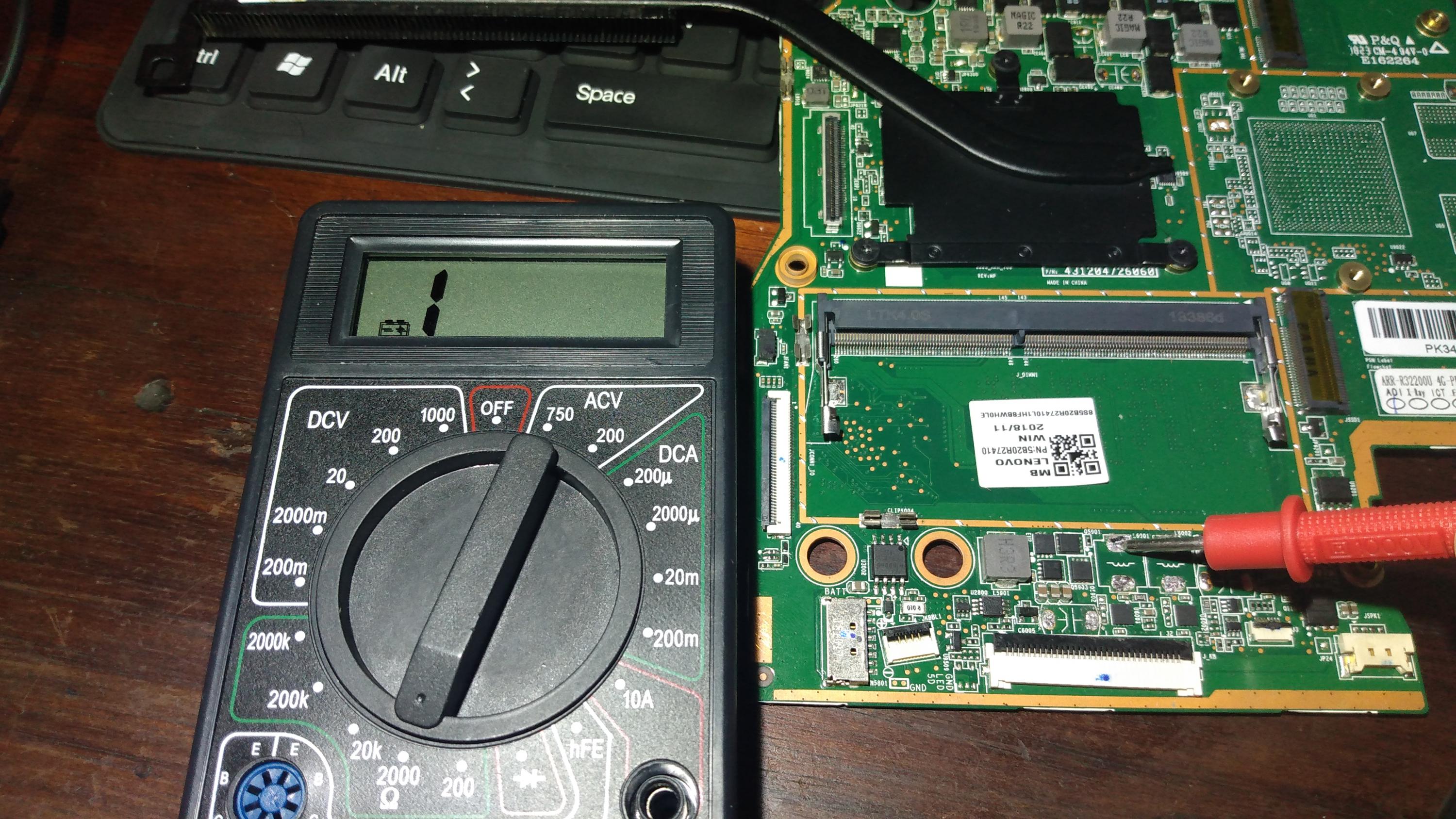

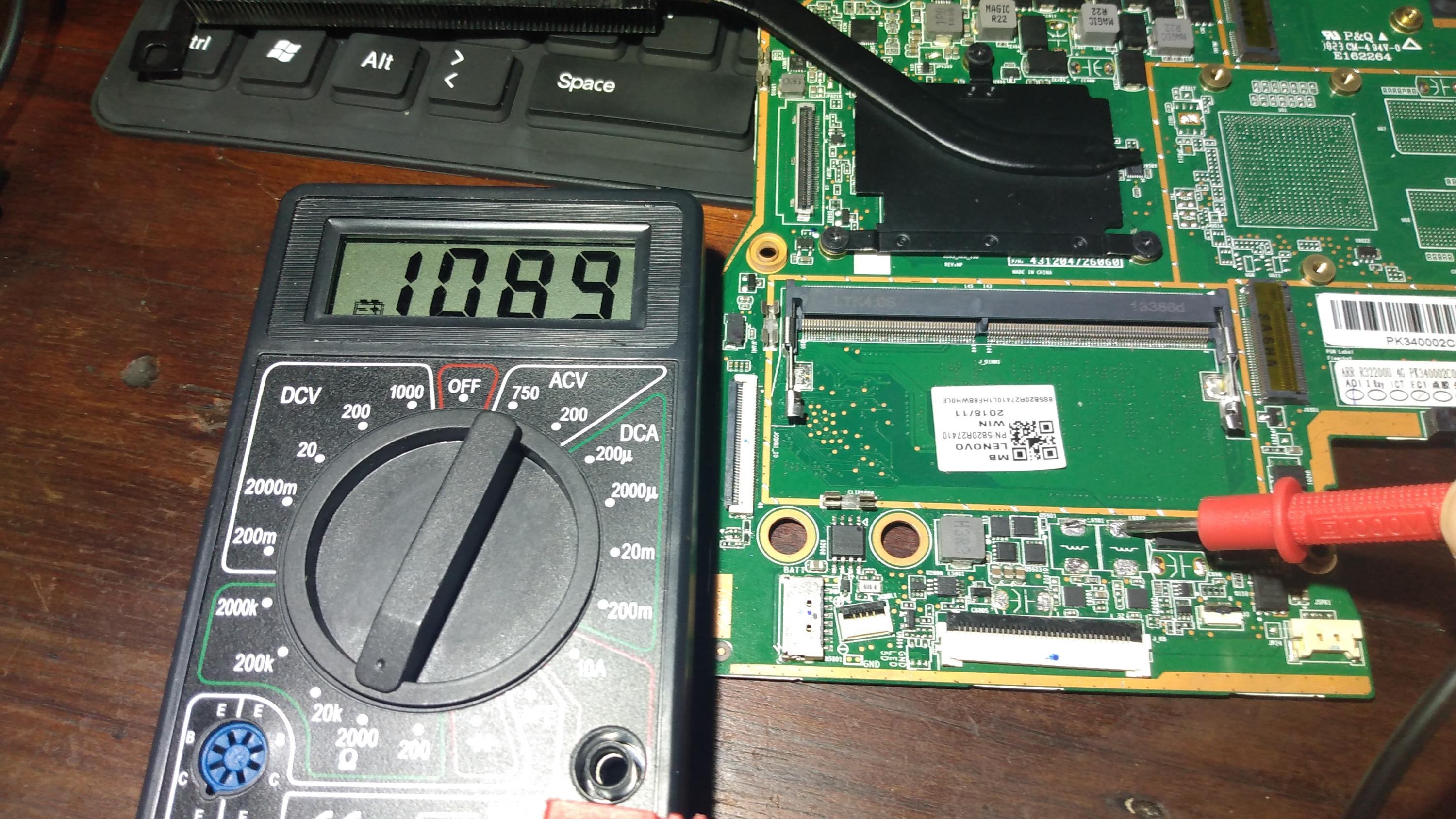

                                    I have measured resistance to ground on both the pads of each coil:
                                    L6002
                                    IMG_20230414_100542.jpg : 1741
                                    IMG_20230414_100550.jpg : 1089
                                    L6001
                                    IMG_20230414_100600.jpg : 1678
                                    IMG_20230414_100607.jpg : 1
                                    The general image shows the values for each joint

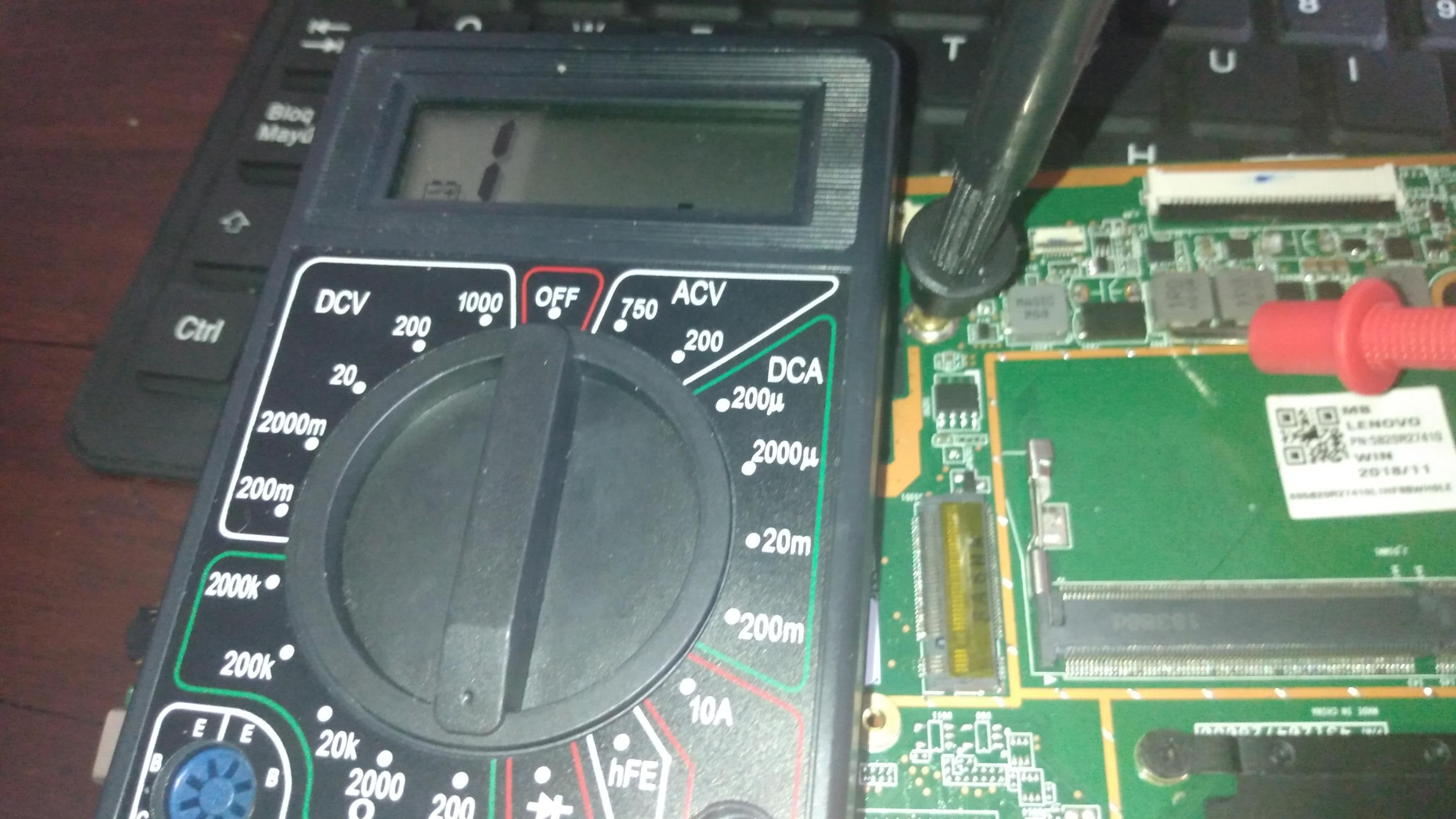

                                    • mcplslg123
                                      • Jun 2015
                                      • 7262
                                      • india
                                      L6001
                                      IMG_20230414_100607.jpg : 1 This may be 'coz value is out of limit set on DMM. Increase the DMM settings to 200K and measure again.
                                      The readings are puzzling. Going by your readings you have short on both producer and consumer side of L6002.
                                      Remove U6001 & U6002 from motherboard and check resistance to GND on L6001/L6002-both pads again. No power should be attached while U6001/U6002 is removed from motherboard.

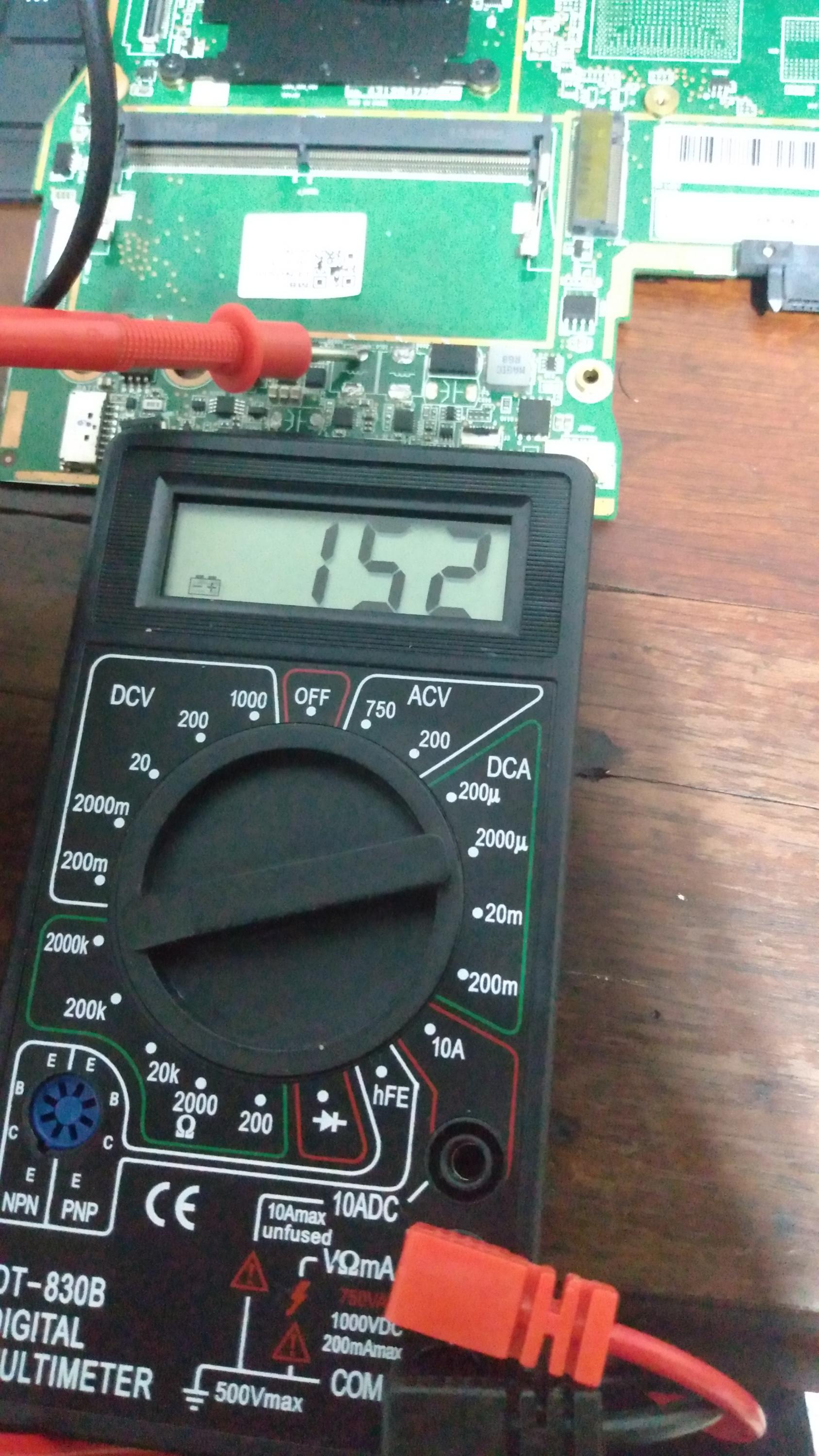

                                      • Rhoemer89
                                        • Apr 2023
                                        • 14
                                        • Colombia
                                        I have measured again the pad, for setting of 200K = 152.
                                        Pending: remove U6001 & U6002.
                                        Edit: I don“t have dc power supply.
                                        Last edited by Rhoemer89; 04-15-2023, 12:25 AM. Reason: Answering a previous question from the member
