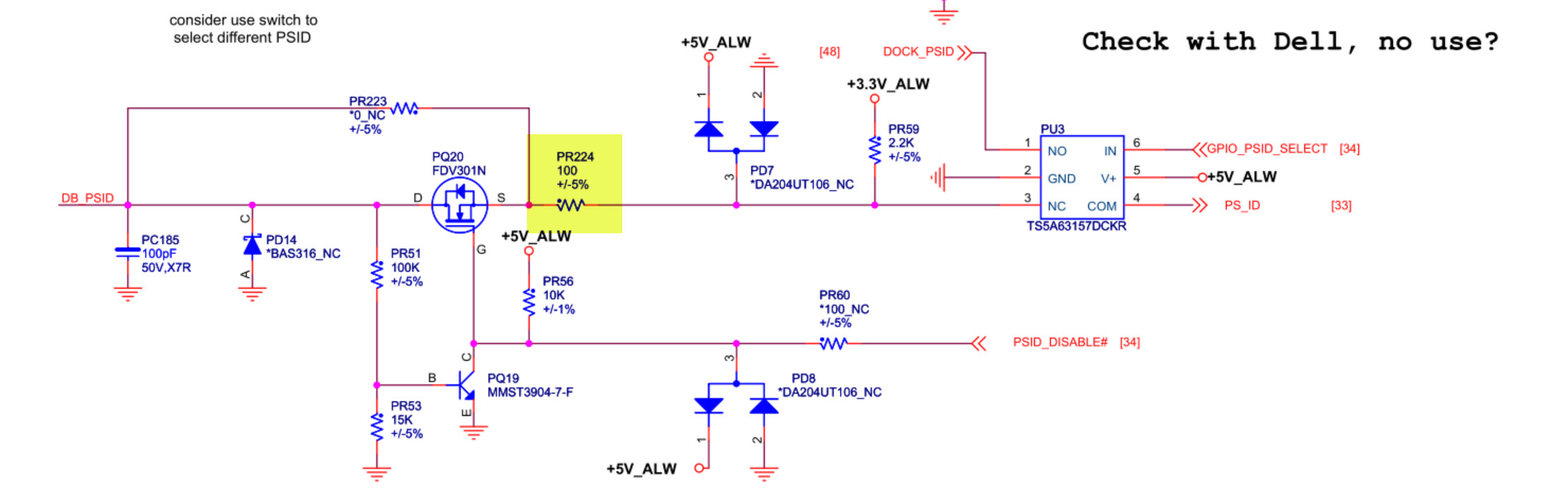

    hi
    there is a dell e5520 MB:10ELT15F001-A KRUG 15, that can not detect adapter wattage.
    in bios show unkown AC adapter.
    I checked DC jack to MB conection was ok.
    how can i bypass this error?
    thnks

        Check the PS_ID circuit.Test the voltage and resistance on PR224 both pins also DCIN_CBL_DET# -> R337

          pq20 <3.420v> PR224 <3.414v> pu3
          resistance on pr224 6.2 kohm
          voltage on DCIN_CBL_DET# =0v
          resistance on DCIN_CBL_DET# =0.4 ohm
          R337=3.3V AND other side 0v
            This is a bad reading for this component. It should be ~100 ohms. Replace this part or you can test with a short across this component. Better to place a low resistance resistor if available. Any value like 33 ohms to 390 ohms is ok.
            Then test again. Be sure that the resistance checks are without any power to the logic board and that you are checking the resistance with the meter probes across the part (not to ground).

                I short 2 pins of r224 with wire .
                but still same result.

                  Ok - the series resistor is ok.
                  What is the voltage to ground of the PSID pin at the DCin connector? This is referenced as pin #6 on CN1.
                  Carefully also measure the voltage to ground of each pin of PU3. This is the load switch that allows for the communication to pass through to / from the single wire ID device inside the Dell original adapters and the EC on your logic board.
                  This signal path is required to be working so that the ID of the adapter can be read by the logic board.

                    PSID(DCin) pin is 4.3V.
                    pu3 pins:
                    1=0.6v
                    2=0v
                    3=3.4v
                    4=3.4v
                    5=5.1v
                    6=0v
                      This is too high.
                      Carefully measure the voltage to ground of each pin of the mosfet @ PQ20.
                      Post the measurements.

                        PQ20:
                        pin1(S)=3.41v
                        pin2(G)=4.29v
                        pin3(D)=4.29v

                          PQ20 appears to be leaky as the GATE voltage is the same as the DRAIN voltage.
                          Flux and remove PQ20 mosfet. Then apply solder blob onto PR223 so that this solder blob will short the DRAIN & SOURCE pins.
                          Then measure the voltage to ground again of the PSID pin at the DCin connector.
                          It should be ~3v41 => same as the PSID voltage on the EC side of the circuit.

                            thank you very much
                            Now AC Adapter is =90W in bios.
                            But PSID voltage in DCin is 0.03v.
                            TNKS again for your time.
