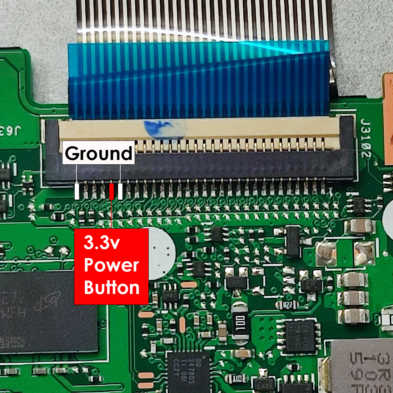

    It's an Asus L510MA-DB02 with E410MA R2.1 motherboard. Its turn on when I unplugged the battery, and plugged the charger. But can't turn on with keyboard power button. The rest keyboard buttons working. I'm trying to find the board view for this motherboard but can't find it.
    Please help me to find the power button path. Or if you have the diagram and schematic would be great.
    Thanks in advance..

    could be just a broken power button (bad traces). this is very common. try to power it on via tweezers on the kbc connector. most likely the signal is located on the left or right side of this connector. you can safely short every pin to ground, but measure them first. the pwr button signal mostly has 3.3 v.

        In case of asus, power button is uaually not on left or right of the KBD connector-it lies somewhere in the middle and is usually marked by ink on the connector itself.

          After measurements without schematic. I found the power pad on the KBC. Here i attached the image.
          The problems is on the keyboard it self. Although the other buttons work fine. But the power button is broken.

              pardon right or left area, i wasn't specific enough :p
