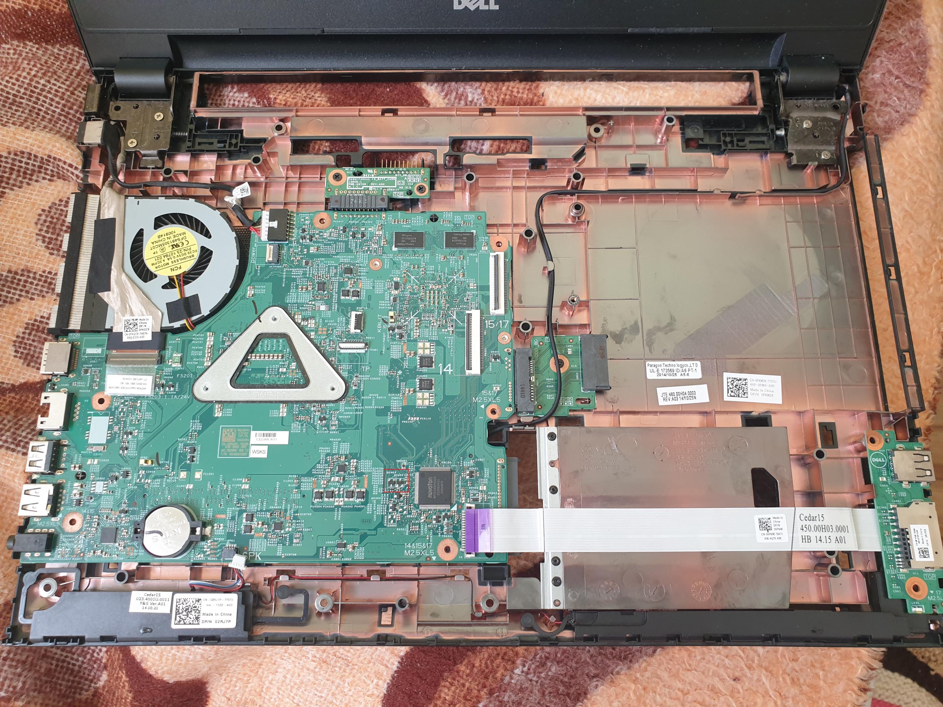

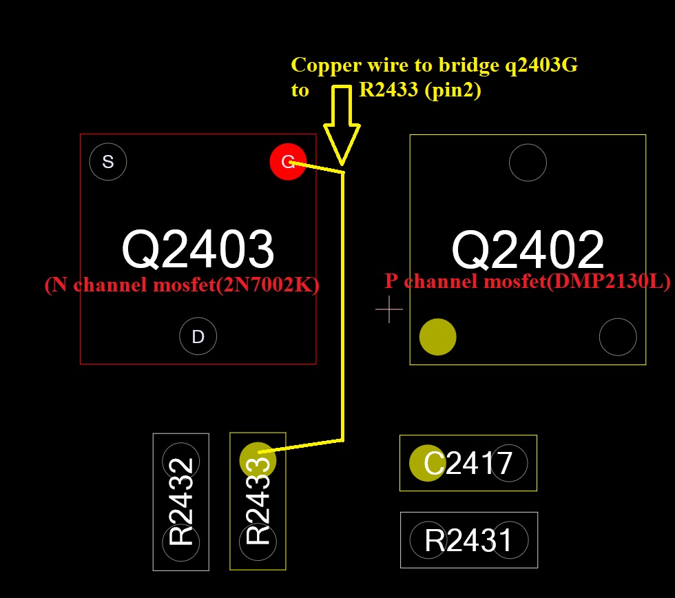

    Hello guys, I have issue with Dell Inspiron 3542 Laptop, motherboard name "CEDAR_INTEL_MB 13269-1 PWB FX3MC REV A00"
    On power button it came on then fans were spinning but no image.
    After my work laptop isn't doing anything, no light coming on, when I press power button
    I checked voltage on charging port it has 19.5 volts
    I saw video on youtube and tried to bridge with wire mosfets on image, it gave me picture but soon it stopped working
    after I decided to soldier another mosfets and I was getting deeper and deeper in mud the more I worked on motherboard.
    Is this thing repairable or not?
    Padding for mosfet is gone now
    I don't have knowledge to diagnose what is wrong unfortunately, but I'm willing to do everything if someone would give me aid, I would be very thankful :3

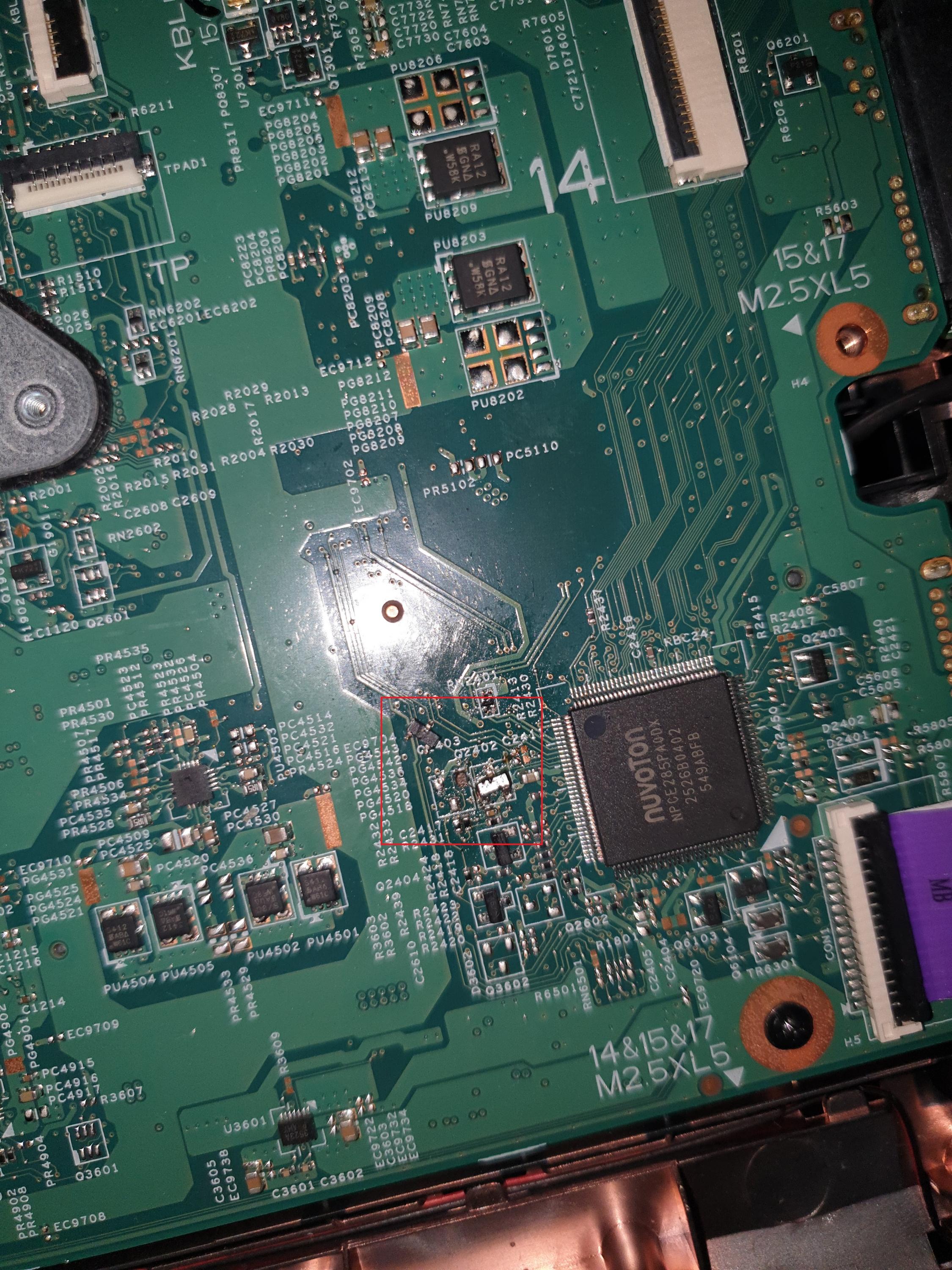

    Q2402/2403 is PSL logic and often fails on this motherboard. Search for boardview in this forum.its posted here. You can easily connect a wire from Gate of Q2403 to PR2433,pin2. It'll be clear to you once you open the boardview.
    Q2403 is N channel mosfet(2N7002K)
    Q2402 is P channel mosfet(DMP2130L)
    Usually Q2402 fails and you can remove Q3004 from this board and place it at Q2402.
    Carry out these steps and hopefully it can be fixed. have some patience and practice some YOGA before doing the job as you seems to be stressed.

    Re: Dell inspiron 3542 laptop not powering up
    Thank you so much for trying to help me!
    So if I understood you correctly, it should be like this?
    In my board view its called "R2433", I have one more question, when I removed the original mosfets I replaced them with same size from my old dead gpu, I didn't know that mosfets can be different types, should I order new mosfets both of them and replace with fresh ones? And I can leave Q3004 intact that way
    I am very confused why laptop doesn't even turn on lamp on when I try to power it, before it gave some signs of life, now nothing, I just hope I didn't bridge something too badly and that I didn't burn chipset or something,
    Before I do anything I just wanted to hear your confirmation first, I uploaded the picture below

      We need to complete these steps first and only after that we can make further checks. You have understood correctly. Q2402-You can remove Q3004 and place it at its place. Q2403 is n channel and is available plenty on scrap boards. If you have some scrap boards, then look for mosfets maked K72/S72 and if you get one, just replace it. Else ,you need to order it.
      PS: Yes ,its R2433 and not PR2433

        I was searching online, I found:
        "Q2403 is N channel mosfet(2N7002K)"
        https://www.belielektronik.rs/2N7002-TRANZISTOR
        This one I cannot find:
        So if I unsolder it from Q3004 and put it on Q2402
        will motherboard still be functional? Mainly because Q3004 will be empty

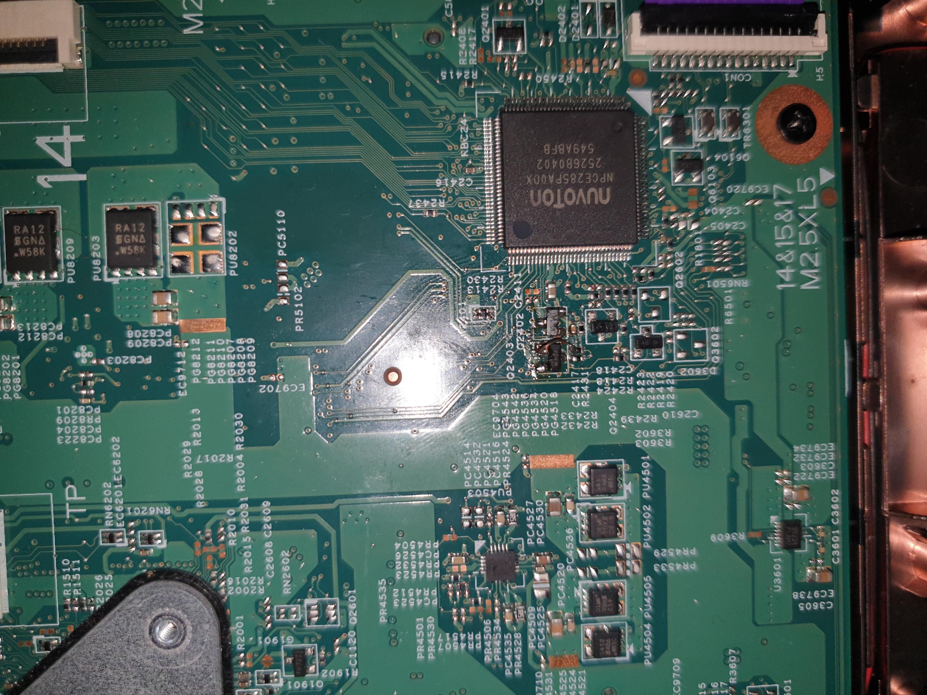

              I soldered Q2402 from Q3004
              And soldered new 2N7002K and made a wire from Q2403 to R2433

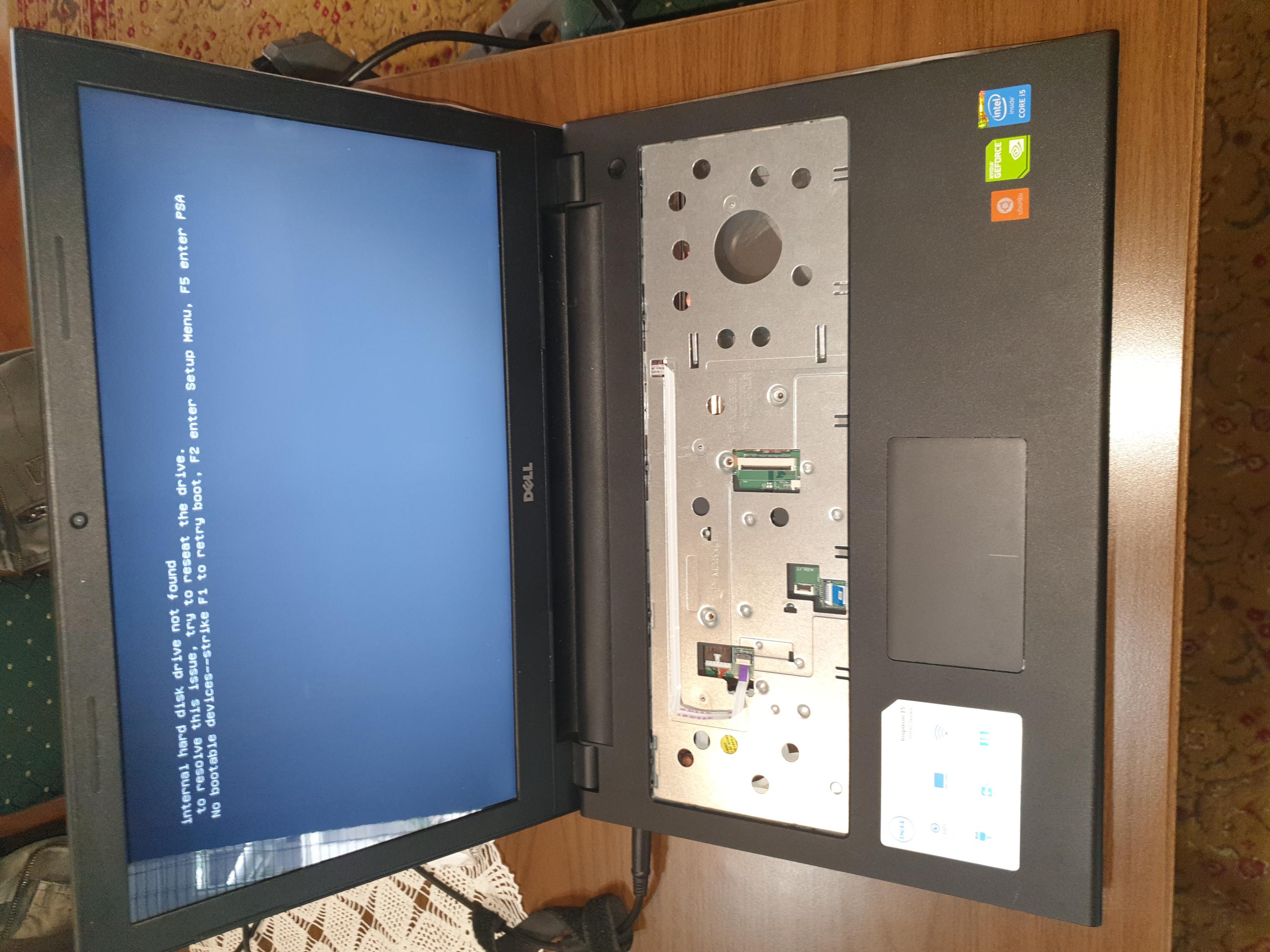

              Laptop came on, I kept it on like 5-10 minutes it stayed on, but I noticed laptop lamp was not on, before I assemble everything back together, I tried to turn off/on laptop 1 more time and now it has Light ON then it Dims and it goes off, no screen again. But at least its making some signs of life like before. Now I'm at start again basically, it was quite hard to solder these, I did it one by one and took pauses in between

                This again is a common problem on this platform. Measure voltage on all pins of LIDSW1.Its located near hdmi port.Pin2-3 should be 3.3V,pin1 should be zero. If its not so,then remove LIDSW1 and measure pin2-3 again.
                This problem can be solved-so have patience.

                            U5201 pin1 is ENable for this to output any volatge on pin3-so the anable must be there always. Pin1 is connected to D5201.So measure voltage on all pins of D5201. This may turn out to be KBC fault. Have you examined the board for corrossion under microscope/magnifying glass?
                            • Omron
                              • Mar 2023
                              • 49
                              • Serbia

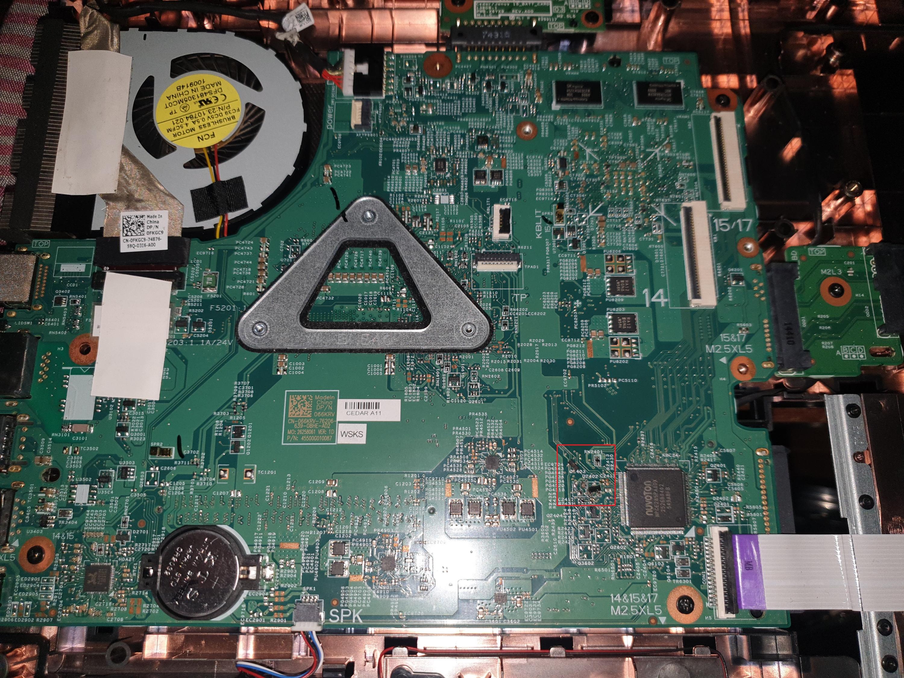

                              U5201 Pin1,2,3 = 0v
                              I don't see any signs of corrosion, laptop never left my home it was always in my room, I can brush board with isopropyl alcohol if that would help something;
                              I put my finger around the board to check for heating when I plug in charger, CPU and GPU chip was getting hot, they work, we are missing 3.3v Line I would say, what can cause 3.3v line to be missing?

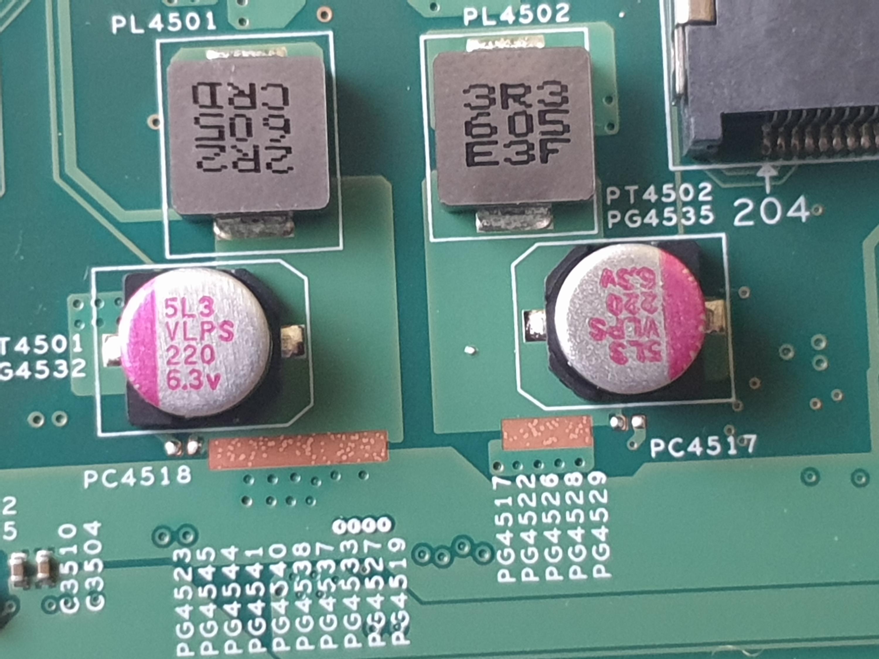

                                Replace PT4501/PT4502 caps by 330 uF tantalum caps.

                                  Also check when you have no voltage on D5201 pins, is there 3.3V available on PL4502 coil.

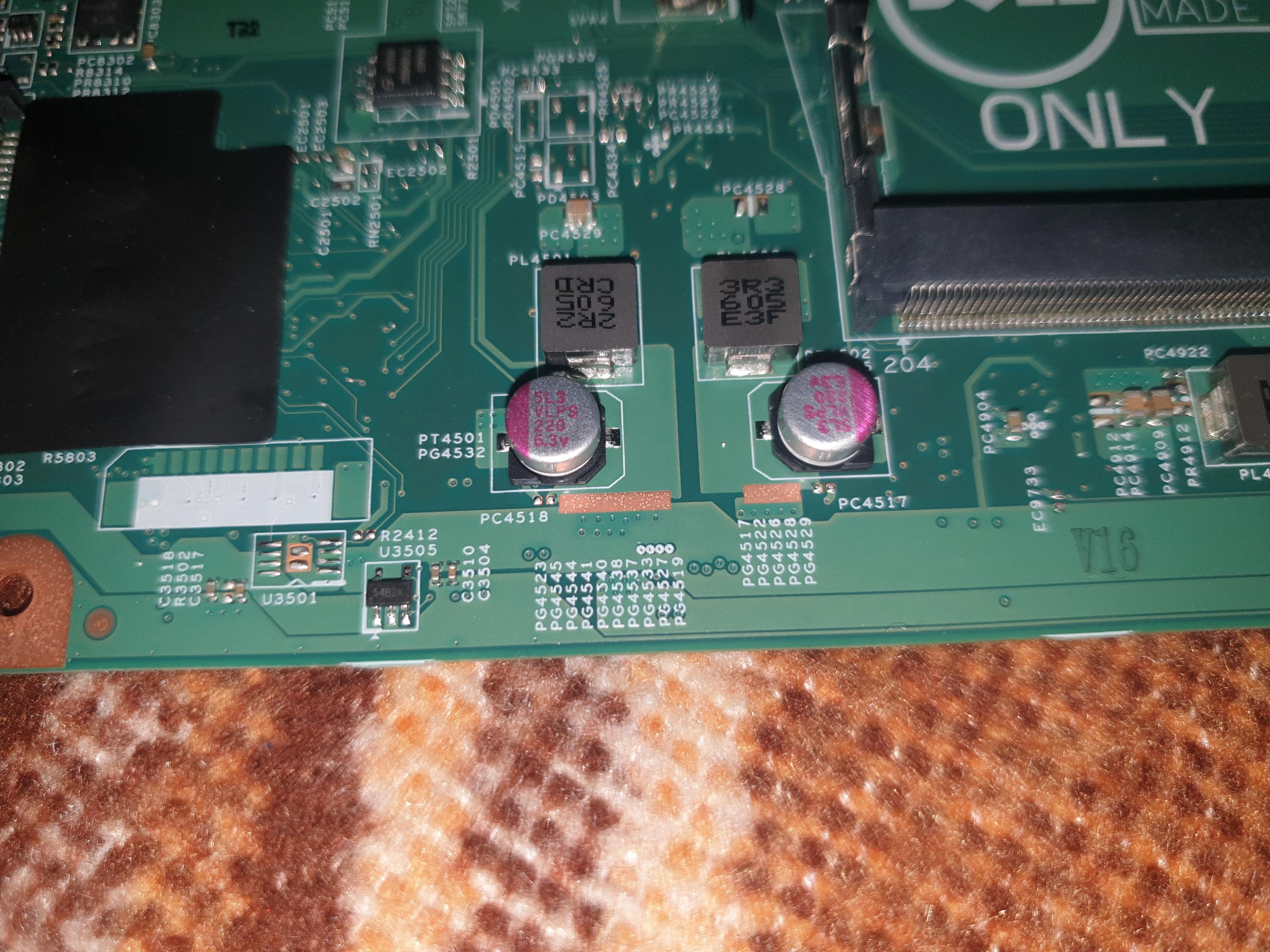

                                    I have voltage on PL4502 Coil, 3.4~ volts on both pins. When no voltage on D5201.
                                    I measured PL4501 it was 5.2V~ (took the freedom while I was there)
                                    I also measured PT4501 capacitor = 5.2volts
                                    PT4502 capacitor = 3.42 volts
                                    Visually inspecting capacitors they don`t look like they have bulge, but of course they might not hold capacitive as they should.
                                      I'm sorry but no voltage on D5201 indicates SOC failure(PCH Part). EDP_VDD_EN comes directly from SOC and if it is coming up intermittently,thats a PCH fault. So end of road perhaps for you as you may not have necessary skills/tools to replace the SOC. You can ask others for opinion.
                                      PS: Just gave up on lenovo LA-E541P with exact same fault-intermittent display. When no display LCDVDD/PCH_ENVDD/ENBKL/BKOFF# are missing. There are no components in between PCH and JEDP1(except for LCDVDD) as all components are marked@. So its SOC fault. I've faced such SOC fault on many occassions but usually on 8th gen onwards. All the basics like LIDSW#/LCDVDD requirements were thoroughly checked before my conclusion.
