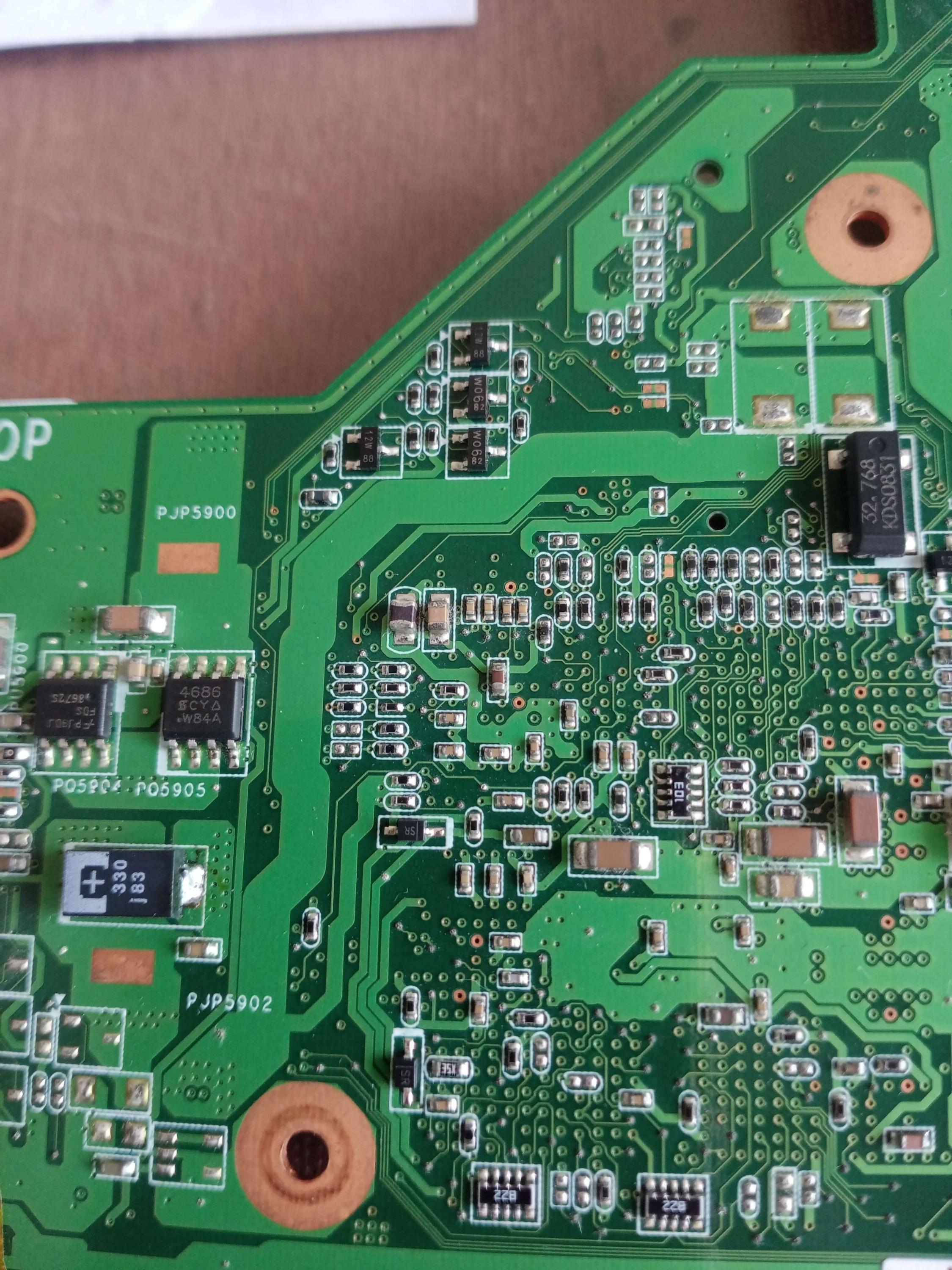

                Re: Dell laptop model PP24L won't start from ac adapter
                What is the resistance to GND on PL5900/PL5901? Resistance to GND on pin19/21 of PU5900? Measure voltage also on these pins and coils. Resistance should be measured without any power source connected.
                The resistance to GND on PL5900 (3.3UH Coil-marked as G3R3 on reverse side of board) is 89 ohm on the 200 ohm scale.
                While the resistance to GND on pin 19 of PU5900 (marked as TPS 51120 TI RBJ on my board) is 980k on the 2M scale; and on pin 21 the resistance is 398k on the 2M scale.
                Resistance was measured without any power source connected.
                Next test is I switched on power source and got these measurements on pins of PU5900 as below: (while black probe is on the nearest ground screw hole)
                pin 1 to Pin 8=0 vdc
                pin 9=0.17 vdc
                pin 10=0.17 vdc
                pin 11=0 vdc
                pin 12=3.5 vdc
                pin 13= 3.5 vdc
                pin 14= 3.5 vdc
                pin 15=3.5 vdc
                pin 16=0.09 vdc
                pin 17 & 18= 0 vdc
                pin 19=3.5 vdc
                pin 20 to pin 27= 0 vdc
                pin 28=3.5 vdc
                pin 29 to pin 31= 0 vdc
                pin 32= 2 vdc
                pin 33=0 vdc
                Either end of the coil (PL5900) measured 3.5 vdc while power is switched on.
                  Pin22 is VIN.Are you sure about your measurements? Is there 3V available on PL5900 and 5V on PL5901?
                  • mikey5791
                    • Dec 2014
                    • 504
                    • Malaysia
                    #29
                    Remeasured while power is switched on, from pin 22 i got 30.1vdc
                    Sorry is my bad. The pins on pu5900 are extremely tiny and so close to each other.
                    On PL5900 (3.3 uh coil) i got 3.48vdc
                    On PL5901( the other 3.3uh coil) i got 5.25vdc

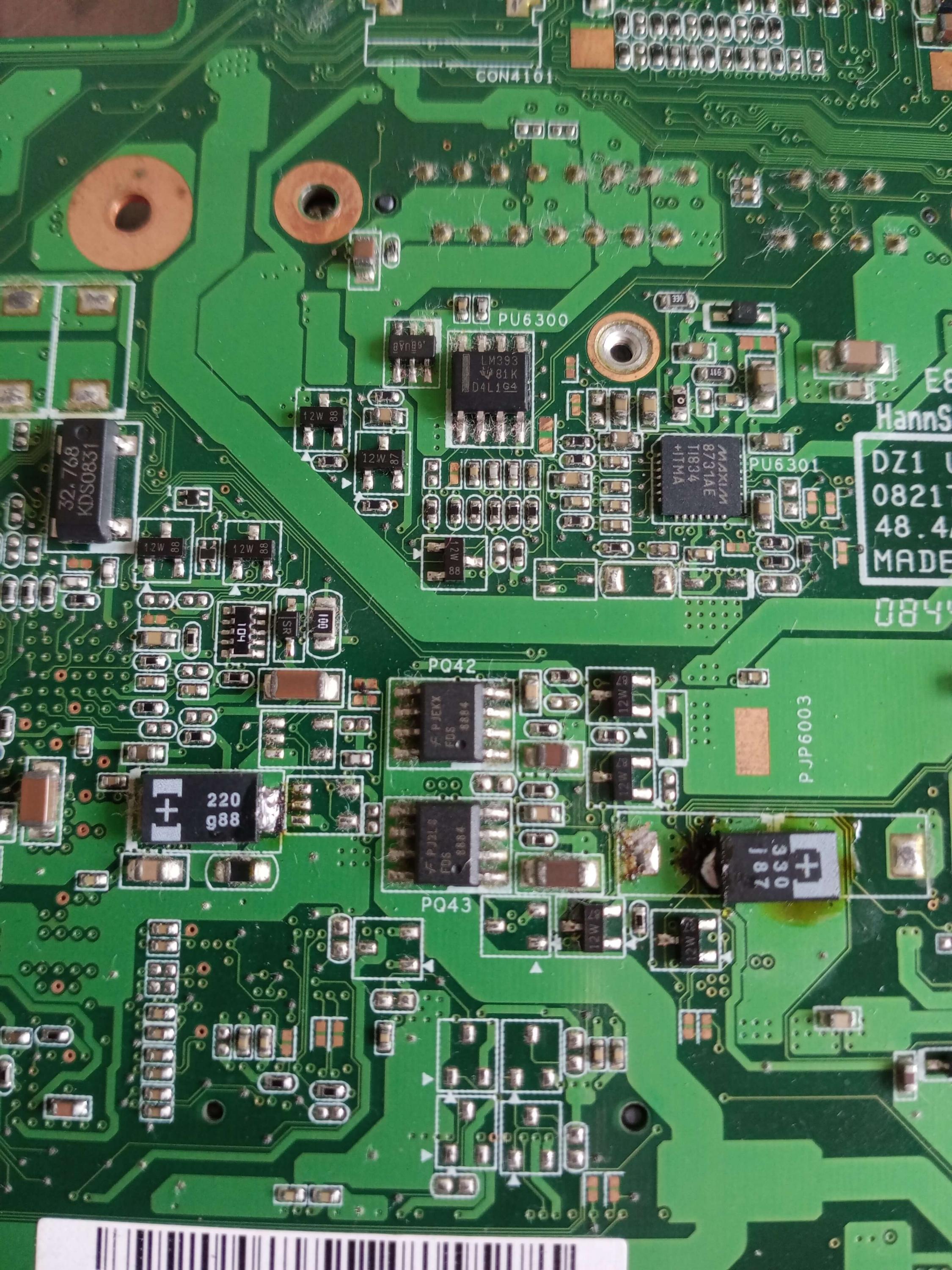

                        Your measurement at pin22 is still wrong,should be 19V. Since you are getting correct voltage at PL5900/5901, lets move on.
                        Check LIDSW# and on page52,check RUN_on/RUN_ENABLE/+5V RUN/+15VALW. Same for 3.3VRUN/1.8V RUN.
                        Sorry, i can't locate where is this LIDSW# on my board. Kindly point out the location.
                        On page 52 of schematic, RUN_ENABLE seems connected to pin 4 of PQ43. While power on, pin 4 of PQ43 has zero voltage.
                        RUN_ON is connected to pin 1 gate of PQ50(3 pin 2N7002) but i can't locate PQ50.
                        +5VRUN is connected to PC180(10uf/16v cap) but i can't locate PC180.
                        +15VALW is connected to PR180(100k ohm resistor marked 104) but i can't locate PR180.
                        3.3VRUN is connected to PC187(10yf/10v cap) but i can't locate PC187.
                        1.8VRUN is connected to R88(1k ohm) but i can't locate it.
                        Btw, are you requesting me to check the voltage while powering on? I am attaching 2 images of the board near PQ43 for reference.

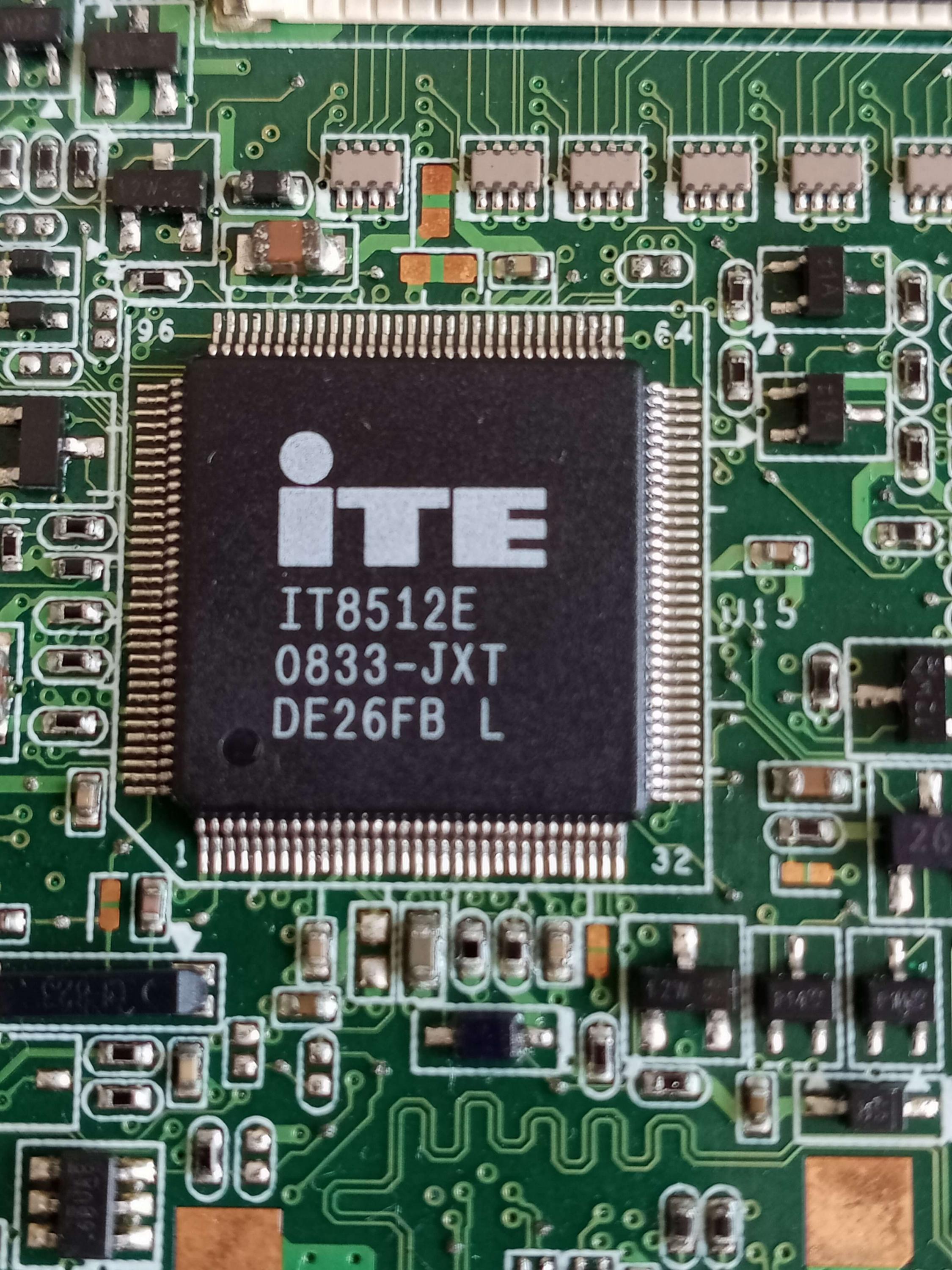

                          Since you cant locate the components, measure these pins on U15(SIO)
                          26/127/3/11/74/120/124/16/48/95/67/72/76/78/90/14
                          • mikey5791
                            • Dec 2014
                            • 504
                            • Malaysia
                            #33
                            On my board U15 is ITE8512E, my dc voltage on the pins below are as follows:
                            Pin 26=3.48
                            Pin 127=3.48
                            Pin3=3.36
                            Pin11=0
                            Pin 74=3.48
                            Pin 120=3.43
                            Pin 124=0
                            Pin 16=3.48
                            Pin 48=3.48
                            Pin 95=0
                            Pin 67=3.18
                            Pin 72=0
                            Pin 76=0
                            Pin 78=0
                            Pin 90=3.42
                            Pin 14=2.35
                            • mcplslg123
                              • Jun 2015
                              • 7262
                              • india
                              #34
                              Pin14 should be 3.3V. Another problem is pin95(RSMRST)-this too should be 3.3V. However, when pin14 is pulled low, pin95 cant have any voltage. So the main problem is pin14(WRST#) at 2.35V.

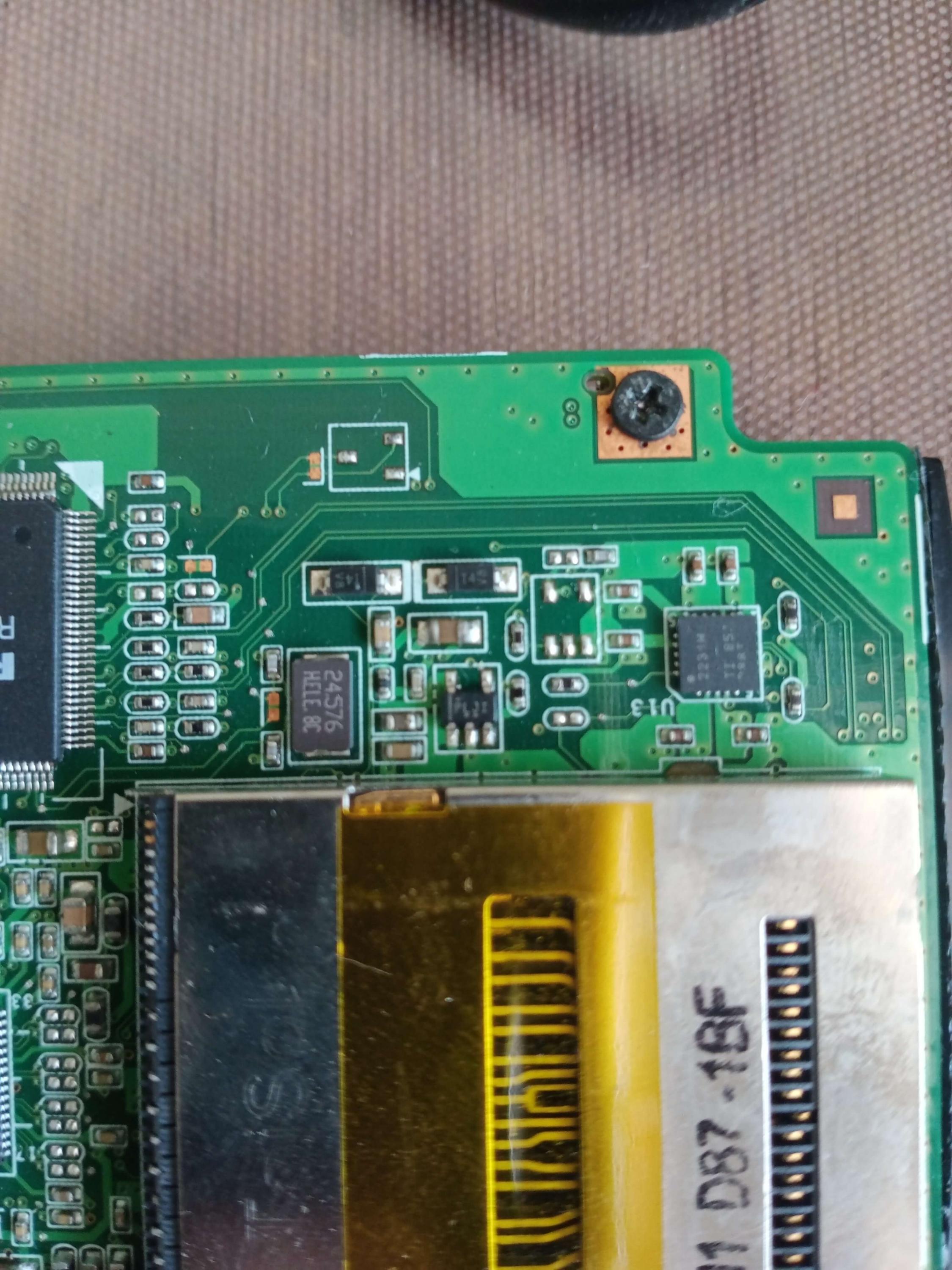

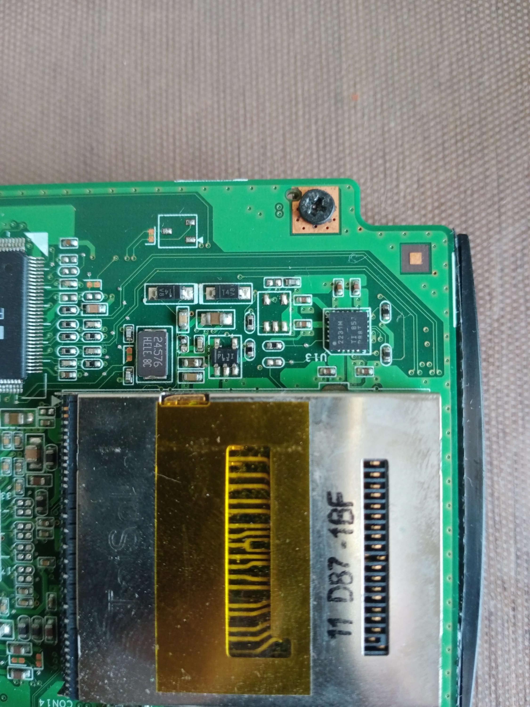

                                      #38
                                      @mon2 has already suggested. EC_RST@ is pulled up from 3.3V_RTC_LDO-so check as per his suggestions besides checking Q122/Q121
                                      Voltage to ground of +3.3v_rtc_ldo is still zero.
                                      As per U12(schematic page 41) it is a 5 pin Max1615 regulator, whereby pin 3 is connected to D10. D10 is not open or shorted.
                                      When power is removed, the resistance to ground of c369( your typo c639) is 9k on 200k ohm scale.
                                      Fyi, i had not removed D10 yet since it is not open or shorted. But i found one diode to the left side of the 5 pin regulator is shorted as my dmm measured full continuity on both side. So i solder and lifted one leg of the diode.(refer image)
                                      After power on, i got 3.48vdc on one diode nearest to the screw hole on top. But there is still no voltage on D10( diode on right side of the 5 pin regulator).
                                      I am attaching image of area around the 5 pin regulator before the diode was lifted one leg and next image is after one leg lifted.

                                        #39
                                        First, lets findout which one is D9 and which one is D10. Try continuity test between C369,pin1 to both diode pins-The one which buzzes is D10. Confirm whether D9 or D10 is shorted.Then remove the shorted diode and measure it outside the circuit-does it buzzes or its the pads on pcb which are shorted?
                                        • mcplslg123
                                          • Jun 2015
                                          • 7262
                                          • india
                                          #40
                                          Just on the side of 24 Mhz crystal, some component seems missing. Double check it.
