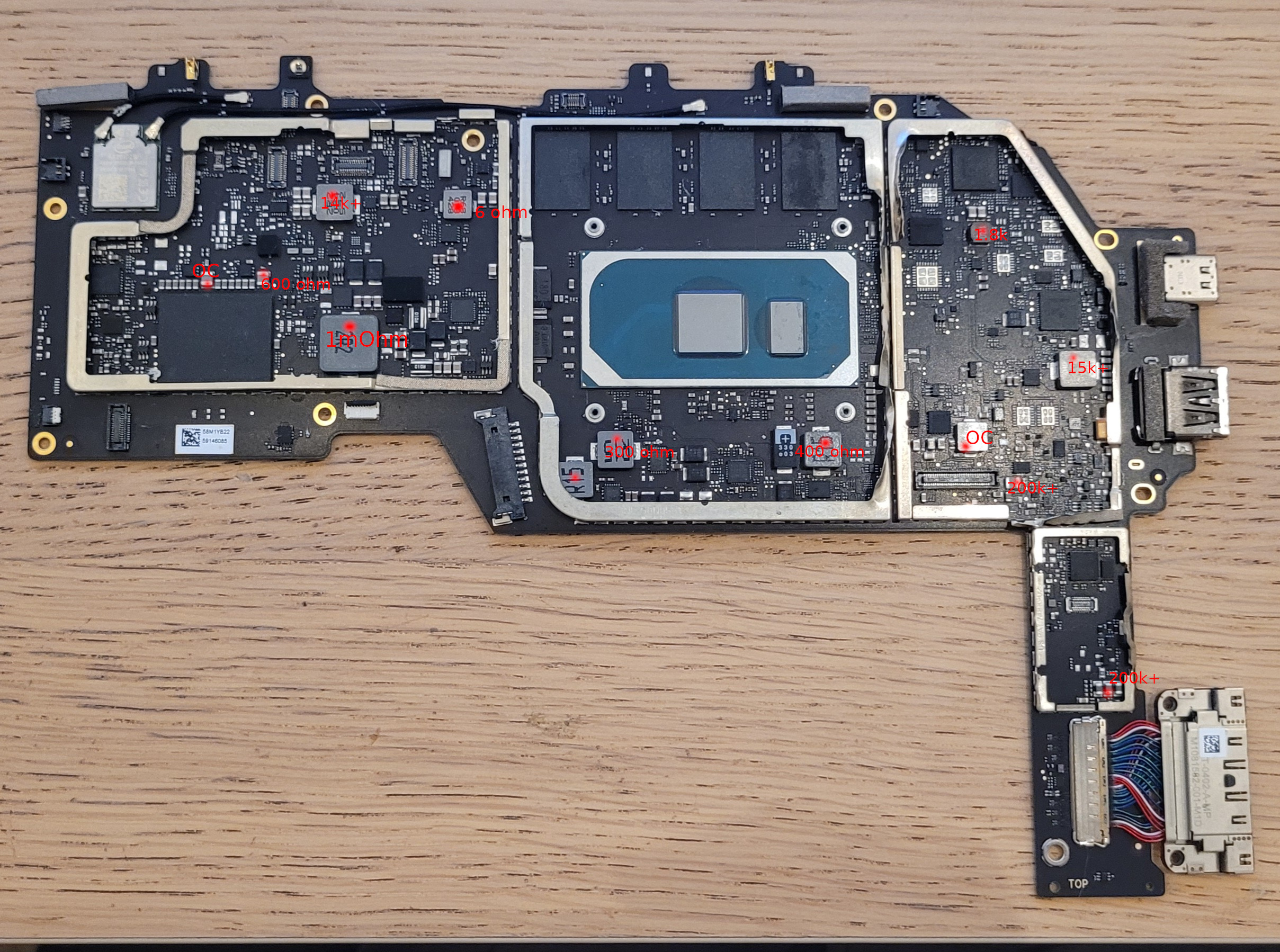

    can somebody, please, help me diagnosing and issue regarding SP7? This machine is killing me
    Once I plug it into the charger and press the button it turns on and immediately off due to the charger cutting off power.
    I measured all the voltages / signals and it seems to get through the power on sequence into an S0 state with all voltages and signals present (it even goes as far as to display the Microsoft logo and starts reading from the bios), however after around 100 ms the charger cuts off the power.
    I checked the charger and it seems fine.
    Is there anything that could cause this behaviour?
    Also, could a faulty bios cause this sort of issue (resetting the charger)?
    Thank you so much.

                      • Prott
                        • May 2022
                        • 154
                        • Czechia
                        Re: Surface Pro 7 - turning off briefly, then charger cutting off
                        Here it is That 6 ohm rail seems a bit out of place there, but I am not sure what is a typical resistance of ground on that phase (nor do I have any other LPDDR4 laptop to check it). What do you think please?
                        Would rather quadruplecheck before injecting any voltage
                        • Prott
                          • May 2022
                          • 154
                          • Czechia
                          UPDATE: I put the board through an ultrasonic cleaner - after that I am only getting 5V from the charger. That also appears to point to the fact that the TPS65987 is faulty.
                          Also, I made a wrong assumption before. If I understand it correctly now the TPS is not doing any voltage conversion. It just connects the 20 V into the EXT_DC_IN bus and the conversion itself is done by the charging chip and couple of mosfets.
                              Thank you! So it seems as if the TTPS65987 is having problems? I checked the adapter and it is working with other notebooks / tablets.
                              Also, I checked with a working board and the 5 ohm resistance on the 1 V memory rail is indeed a problem. It should be around 200-300 ohms. Let's see if I will be able to find the cause with a voltage injection... 5 ohms is still a bit high for that.
