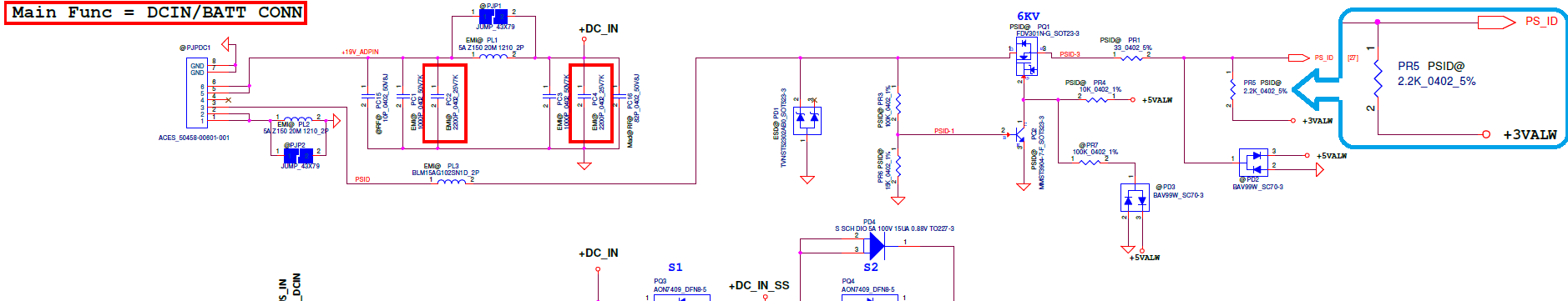

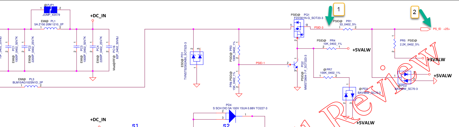

        Re: Dell Inspiron 15 LA-F121p Slow and wont charge
        See attached.

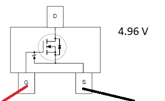

        Often, PQ1 gets damaged. This mosfet acts like a switch between the center pin of the power adapter and the logic board.
        When the mosfet is enabled, by default since the gate voltage is 5v, the communication can occur between the logic board and the power adapter using the 1-wire communication protocol.
        Using this protocol, the details of the adapter can be extracted.
        Meter in dc volts mode (20v is ok). Measure the voltage to ground of each pin on this mosfet.
        So red meter probe to pin #1, black meter probe to ground (shield is ok).
        Repeat for other pins on this device. Have the adapter plugged in and plugged into the wall socket.
        Post each measurement.
        Do you have soldering tools, flux and wire?
        From where will you buy the parts? Digikey?
        The RC639 that is damaged is not linked to this fault. It is available from Digikey. Do not order anything till we review the ps_id circuit.

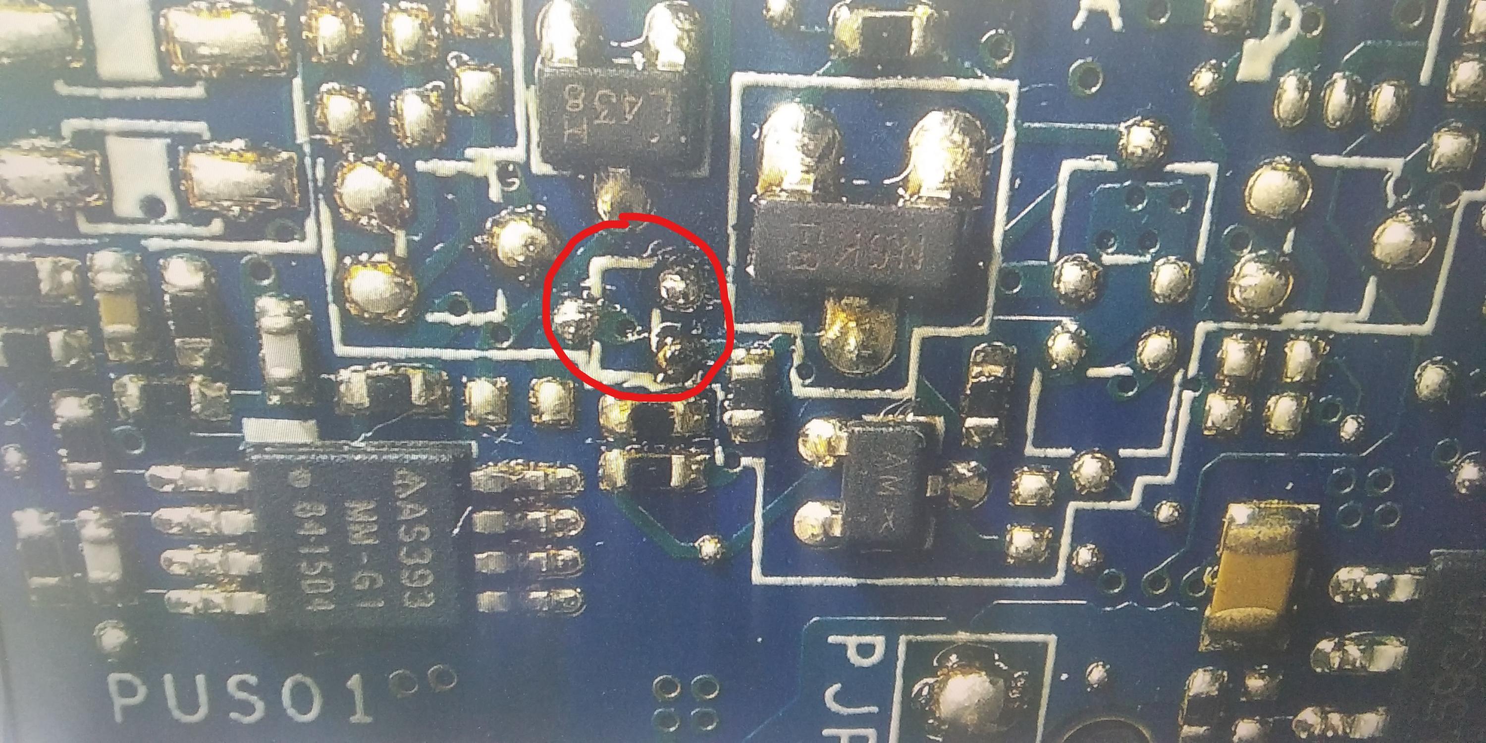

            I have Dell Inspiron 15 5575 Compal CAL51 LA-F121P Rev 1.00(A00).
            Burnt diode.The laptop only blink white light.No start-No screen.In foto i removed the diode. I cant find which part is. Can anybody recognize the diode? equivalent diode?

              Do you have any part markings from this part?
              • manol278
                • Nov 2017
                • 41
                • greece
                Re: Dell Inspiron 15 5570 Plugged in not charging
                I think CG5
                      PD1 is a dual line unidirectional TVS diode for 5 volts.
                      The part will be passive and remain out of circuit unless a transient event spikes the voltage higher than 5 volts. Then it will shunt the event to ground to protect the line from damage.
                      Datasheet is attached. It is a common part that can be replaced by many other vendors.
                        Thank you. I replaced it from donor motherboard and work fine.

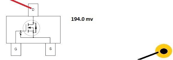

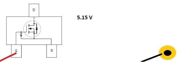

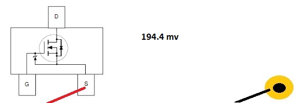

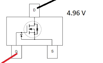

                          I got distracted from this one for a bit my apologies
                          I'm not sure which is Pin 1... I think pin 1 starts at the bottom left and counts counterclockwise if so...
                          Pin 1 5.15 V
                          Pin 2 194.4 mv
                          Pin 3 194.0 mv
                          IF not ...
                              @Eniaro, see attached.
                              The mosfet @ PQ1 appears to be ok but continue the checks.
                              Remove all power. Meter in resistance mode.
                              What is the resistance of the resistor @ PR1 ? It should be ~33 ohms. Confirm it. Meter probes across PR1.
                              Next, power up with the official adapter and measure the voltage to ground on each side of the same PR1 resistor.
                              Red meter probe on pin #1 (PR1). Black meter probe to ground. Voltage reading?
                              Red meter probe on pin #2 (PR1). Black meter probe to ground. Voltage reading?
                              Also interested in the voltage to ground readings of PR5 (~2k2 pull-up resistor).
                              Post all readings.
                                  Remove the diode at PD1 and measure again the voltage to ground of the PS_ID signal line.
