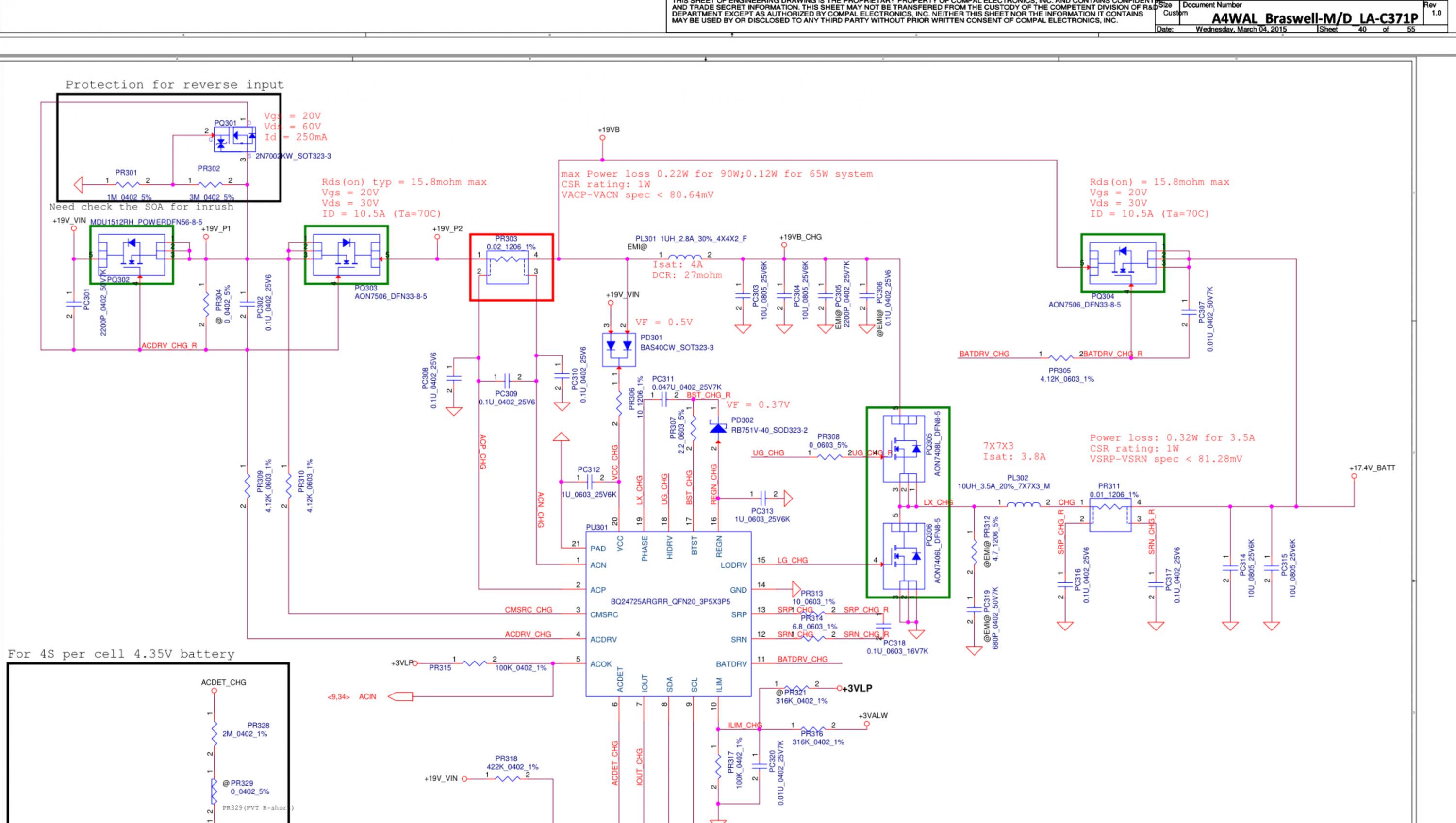

        When you say the board stays on, do you see the graphics and the board boots into your operating system (Windows, Linux, etc.) ?
        Attached a partial view of the LA-C371P logic board.
        Do you have the same charger IC onboard? This schematic is probably close to yours?

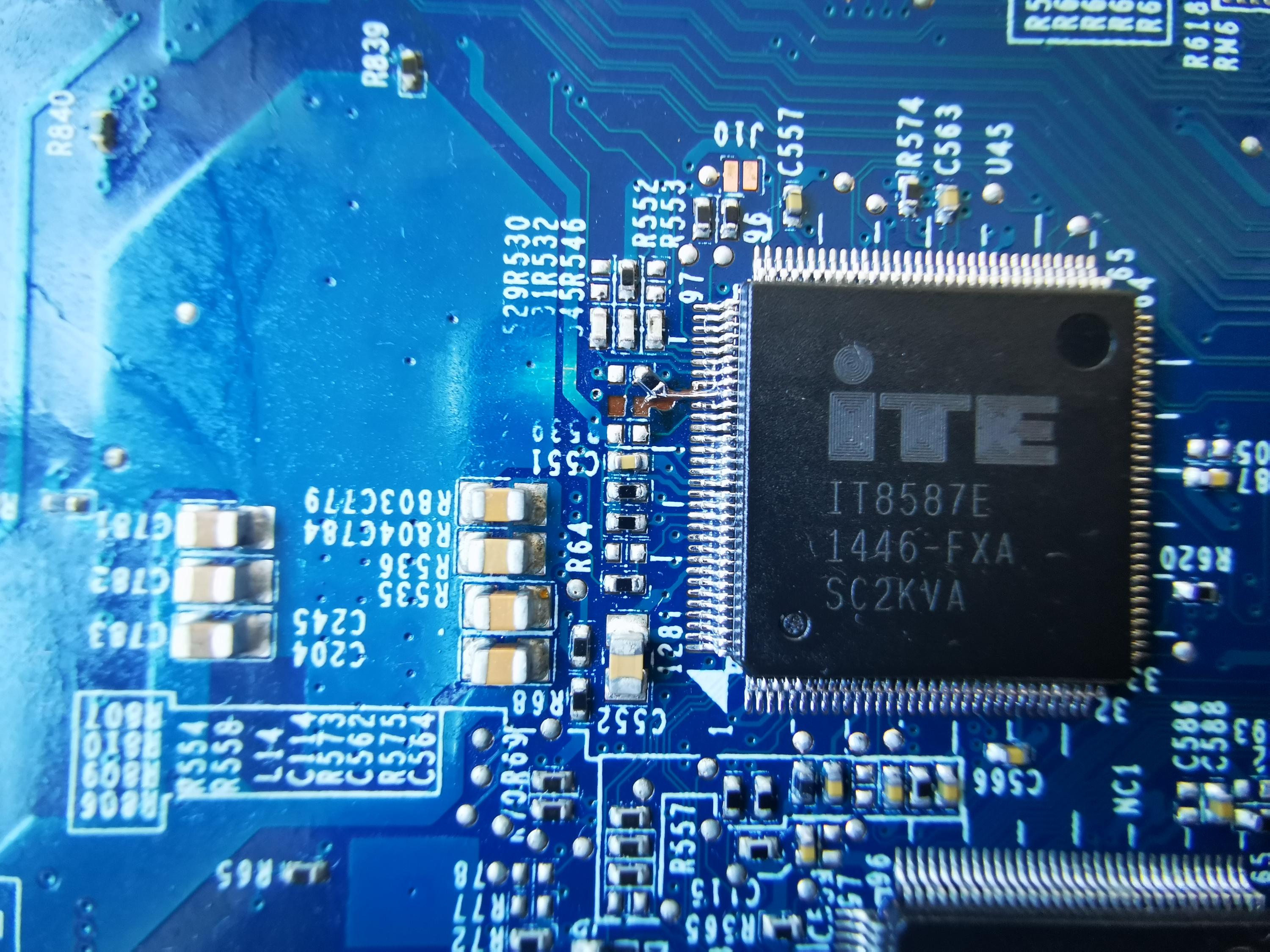

              Hi, I don't have board near me at the moment, I work from office every now and then.
              I attached example of my work I found in phone gallery so you know you're not talking with complete idiot haha.
              So far I changed EC, BQ24780S and 2 input mosfets. When I plug in charger I got only stable voltage (not completely stable, variating like 0.1V up and down) on dc jack, everything behind input mosfets tries to start and goes in protection and nothing seems to be shorted. I just injected 19V after those mosfets on R005 main power rail resistor and in that case I get stable voltages everywhere but laptop starts itself and cannot be powered off. Of course nothing draws any real current, laptop doesn't boot.
              I asked for opinion because I cannot find any logic, somebody with more experience could find it.

                Well, if a removed EC with ripped traces/components at Pin 105 is supposed to calm me down, then you failed completely with that.
                And still, your observations are somehow generalized and confusing. In one sentence you tell, "stable voltages everywhere" and a few lines later "nothing draws real current".
                There is always a logic and it is even pretty similar on each board of same generation. It is just, with this kind of given informations, this device will be troubleshooted till christmas or even longer. Besides the fact that it is very dangerous to inject 19V after the second mosfets when it is not clear with what you're dealing...
                We need a clear, detailed and constructed overview about what is going on on your board and what is not. Voltages and resistances. The more, the better.

                      If I understood correct, the picture of the work with the EC is "just a example about the "quality" of his work. It might be a completely other board.
                      Either way, this "proof" didn't turn out as expected...

                        Yeah it was just example, I received board like that with ripped trace and burned EC chip, also one resistor was ripped of the board too. After that "fix" board worked like a charm.
                        It was just example of soldering skills, nothing else, nothing intellectual, and yes, I believe all soldering joints are done properly, maybe you do it even better and my work is shite to you, I don't know

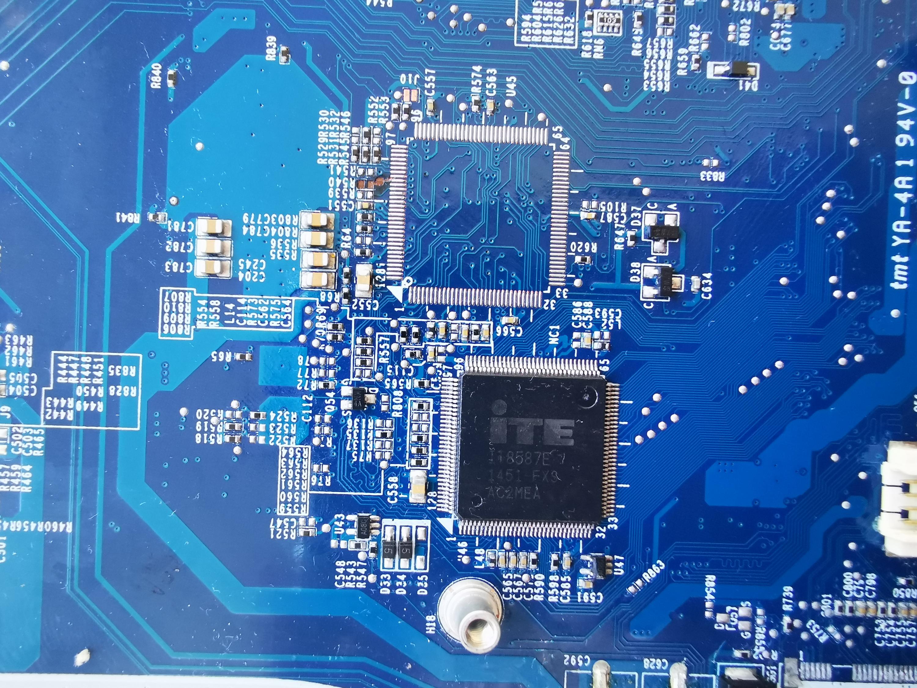

                            I took 5 Zbook 15 G3 to repair and they all had the same defect reported was exactly this: when plugging in the charger, the power button led blinks. I tested it with my 65W/90W HP font and it blinks whithout press power button.
                            so I got a 120W HewlettPackard power supply and it worked. turned on and charged the battery normally.
