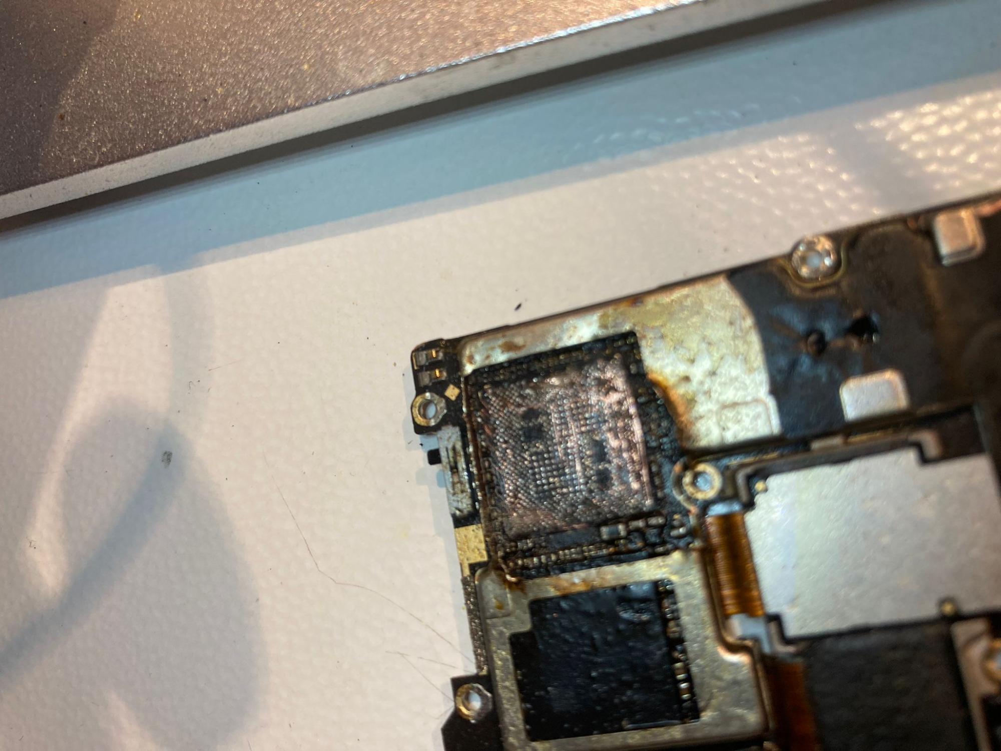

    My oneplus 6 just died without no reason. I was using it and suddenly it shutted down and cant turn on.
    Checking around i tried to reball with hot air station (no BGA station).
    Im stucked. Since im a newbie i was just trying and im afraid i used the hot air station too much.

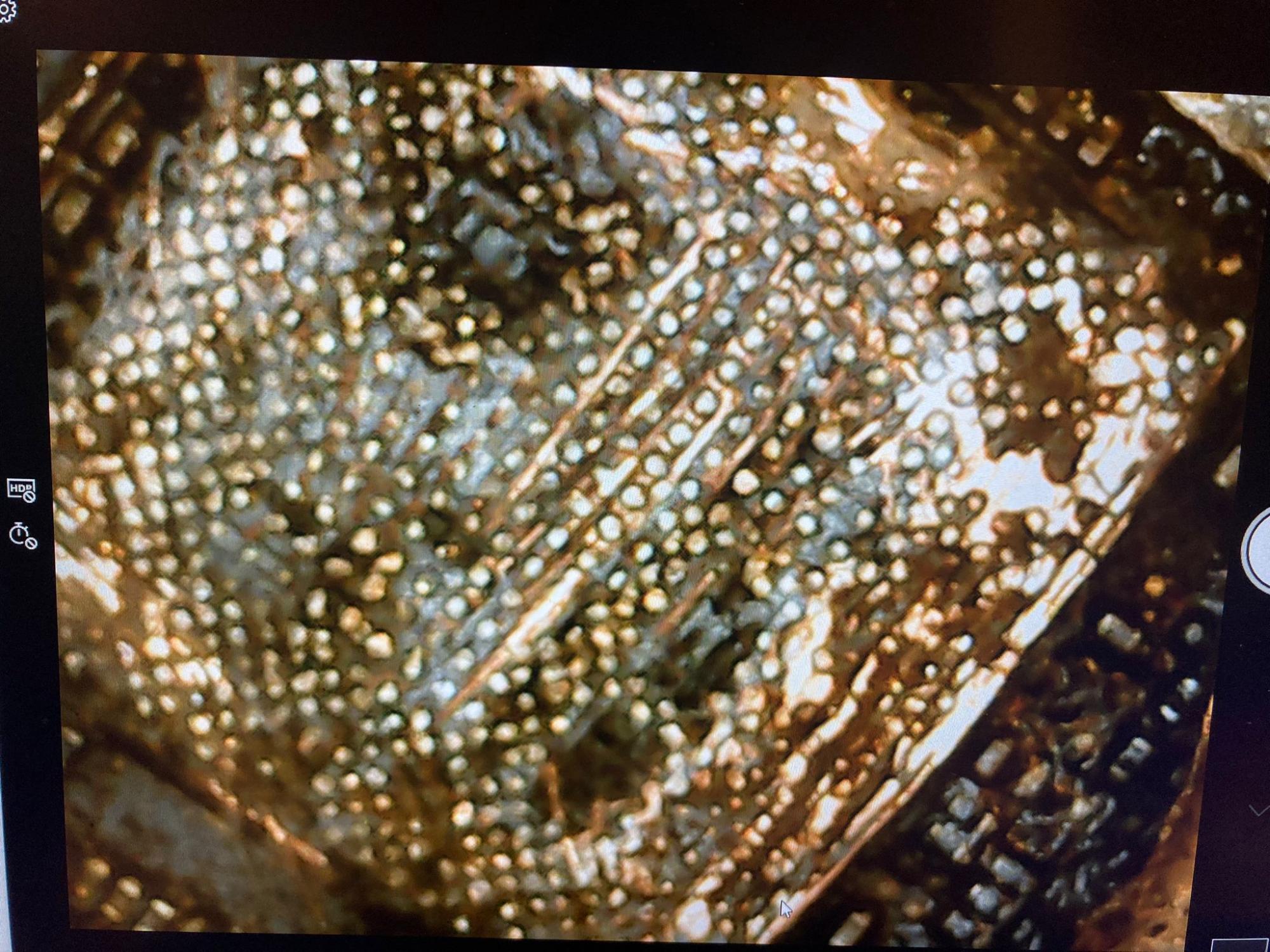

    The CPU was a mess, so i tried to scratch it to see again the pins.
    This is what i have now.
    Is there anything i can do to try to solve this ugly thing, or its just impossible and i have to throw the phone?
    Thank you!

    Flux
    soldering iron @ around 375-380 C°
    SNPB solder
    Solderwick
    Be very patient as it can be slow process

      Does this solve also the scratches i made between pins?
      Im afraid i removed also the plastic between pins, and i see like copper scratches
        Re: Android ONEPLUS 6 CPU Reballing
        Hard to tell. Clean off the flux and post photos.
