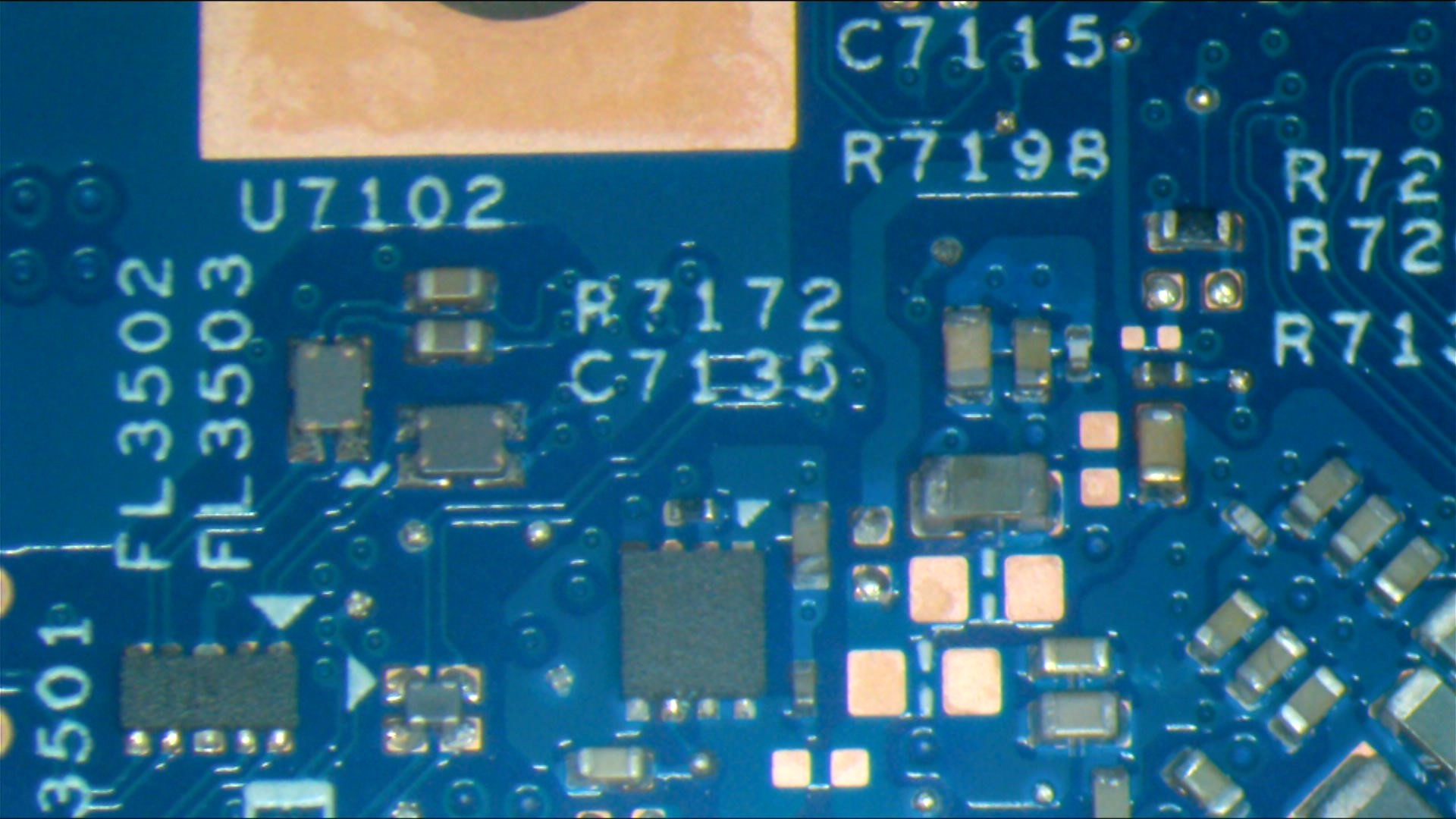

    I need help with identifying a damaged part and a missing part.
    Backstory

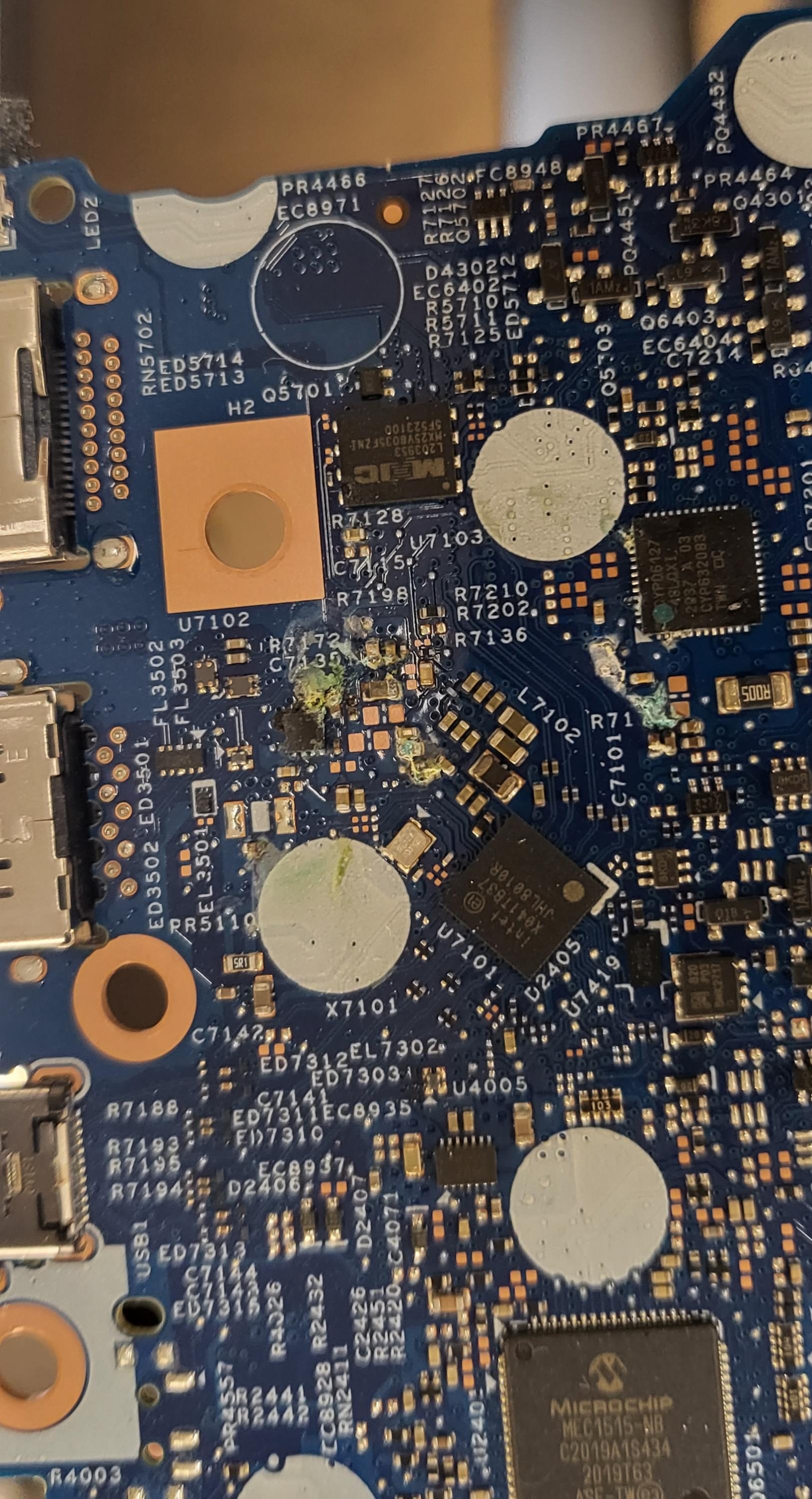

    PC won't turn on and flashes a light code which =Power rail failure
    I took it apart and saw this mess
    Cleaned it in an ultrasonic cleaner
    Current
    Still gives an error code (Power rail failure)

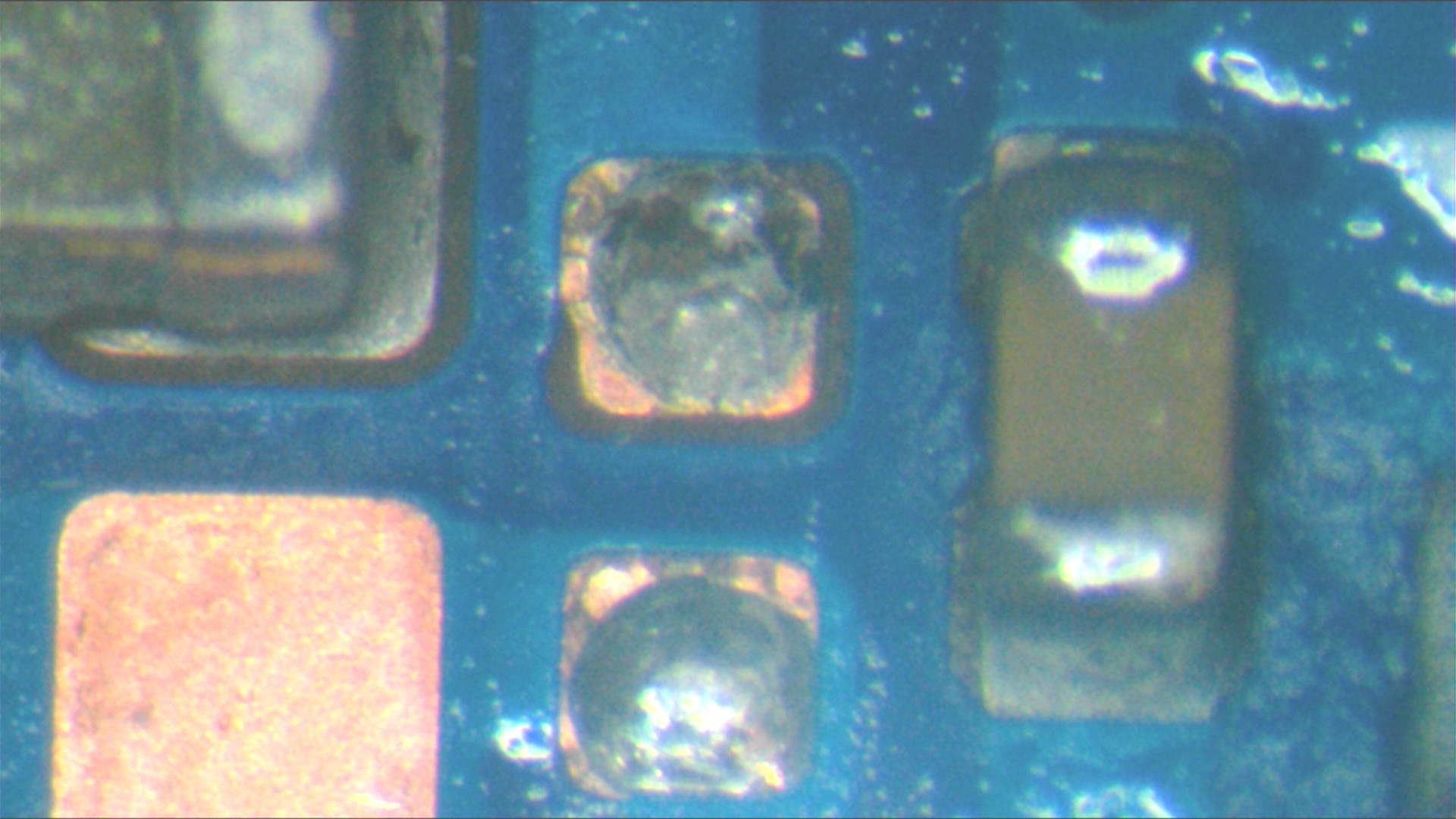

    Deeper dive into the same area found a damaged part and a missing part
    I can't find the board view for this board and I'm learning to read schematics (which was posted here)

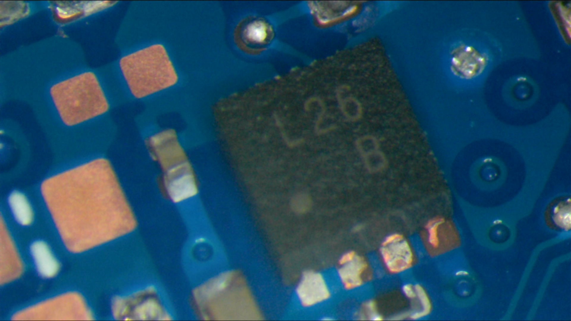

    I'm unsure of what this is.
    Markings on the chip is L26 B

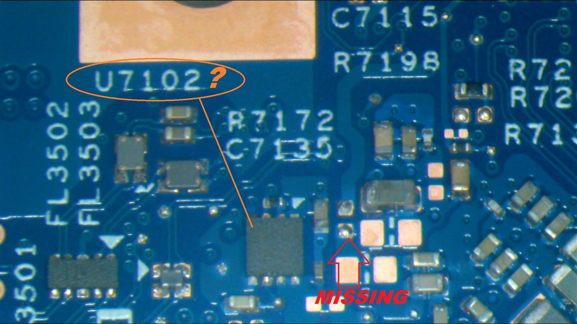

    Is it U7102?
    AND what went missing?

    I looked up a photo of the board, and it appears to be a missing resistor
    If this is correct L26 B is a Linear voltage regulator IC
    Can anyone confirm this is true?

      According to the board view and schematic, the missing part is reference designator R7172 (0R2J-2-GP). I couldn't find 0R2J-2-GP on mouser or anywhere, so I used Bing's AI to have an understanding of the value of the resistor

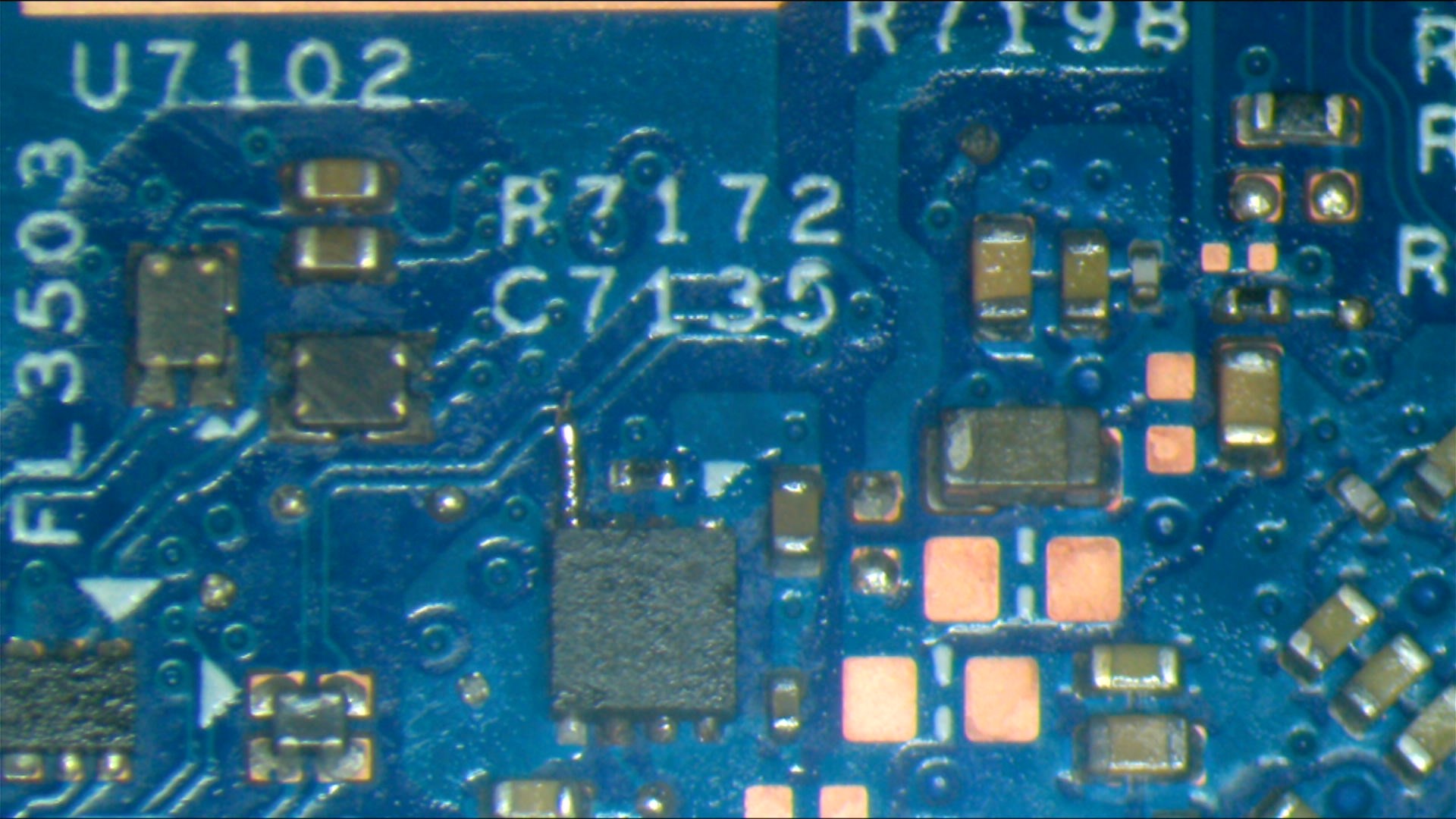

      The unknown damaged part is reference designator U7102 and can be purchased from Mouser yay.
      I was giving up on this board but decided to patch fix U7102 and hoped that R7172 was not necessary. (Pin 4 is connected to the via and not the trace. It's an overhang that needs to be trimmed )
      Plugged in and the light code changed from Power rail fail to 3 amber 5 white = "SMBIOS FLASH CORRUPTION"
      Thanks to @chenwei there might be hope for this board

        U7102 is a TPS22975, which is a load switch. The marking would be 13XH, however L26 is for an equivalent device APL3526. Same function, just different manufacturer. Testing this should be straightforward. Vin/Vout and an enable. Also check continuity with a meter to elsewhere in the circuit using the boardview. Corrosion can damage via's that isn't often visible.
        The resistor you mention based on the pads from the factory was no stuff. It's listed as DY, which is probably a different variant/model, and not stuffed.

          reformatt you are 100% correct about R7172. After reinspecting the board I realized, I assumed there was a missing part because of the solder formation of 1 pad. the other pad has a perfect shape therefore nothing could have been there like you said

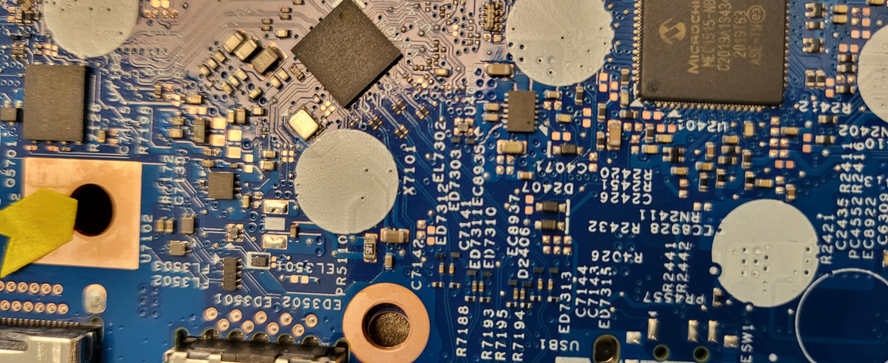

            So I got U7102 part in and while removing U7102 I blew away
            R7176 100KR1F-GP (I'm guessing this is a 100k 0402 Resistor?)
            C7137 SC220P50V2KX-3DLGP
            C7135 SC1U10V2KX-1DLGP
            Can someone help me decode what the values are and point me in the right direction for replacement parts
            How did this happen?

              R7176 - 100K
              C7137 - 1uF 10V
              C7135 - 220pf 50V
              Size, whatever fits, prob 0201 for R7176/C7135 and 0604 for 7137. Voltage ratings don't really matter all that much in this circuit.

                          On the datasheet for TPS22975, Ct sets the slew rate for switching. For 3.3V, it's 330us for 220pf, 105us for 0 (open circuit). So don't believe it will make that much of a difference if you leave it out. You can get the cap later if you think its creating an issue (or steal it from somewhere else on the board where it's being used for HF decoupling).
