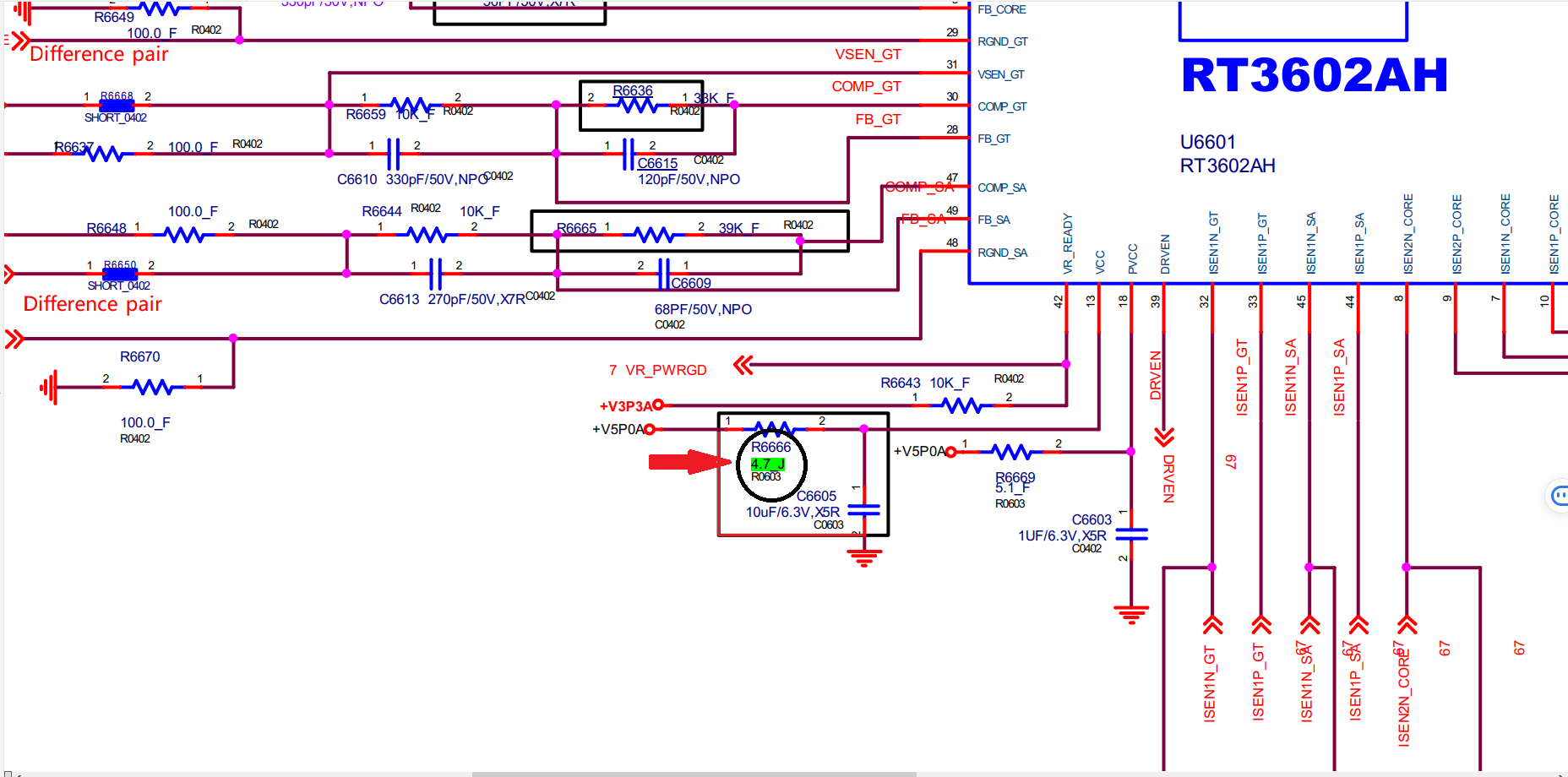

    Hi, everyone. I need help, please.
    It came to my shop with only power led on for 10 seconds and after a long work on this laptop, I found a faulty Resistor.
    I have the schematic, but it says 4.7_J.
    Can someone help me to figure out the value of this, so I can replace it?
    Just by removing it, the power LED light stays on, but no display.

      It is a 4R7 = 4.7 ohms 0603 SMD resistor. Any brand will be ok.

        Thank you very much.
