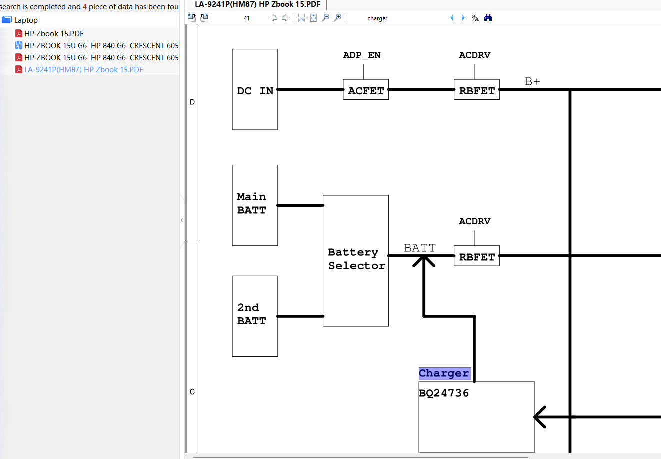

                  From the internet...the charger IC on this logic board is
                  pu8 = BQ24780s
                  Can you confirm this detail?

                    I don't think so.

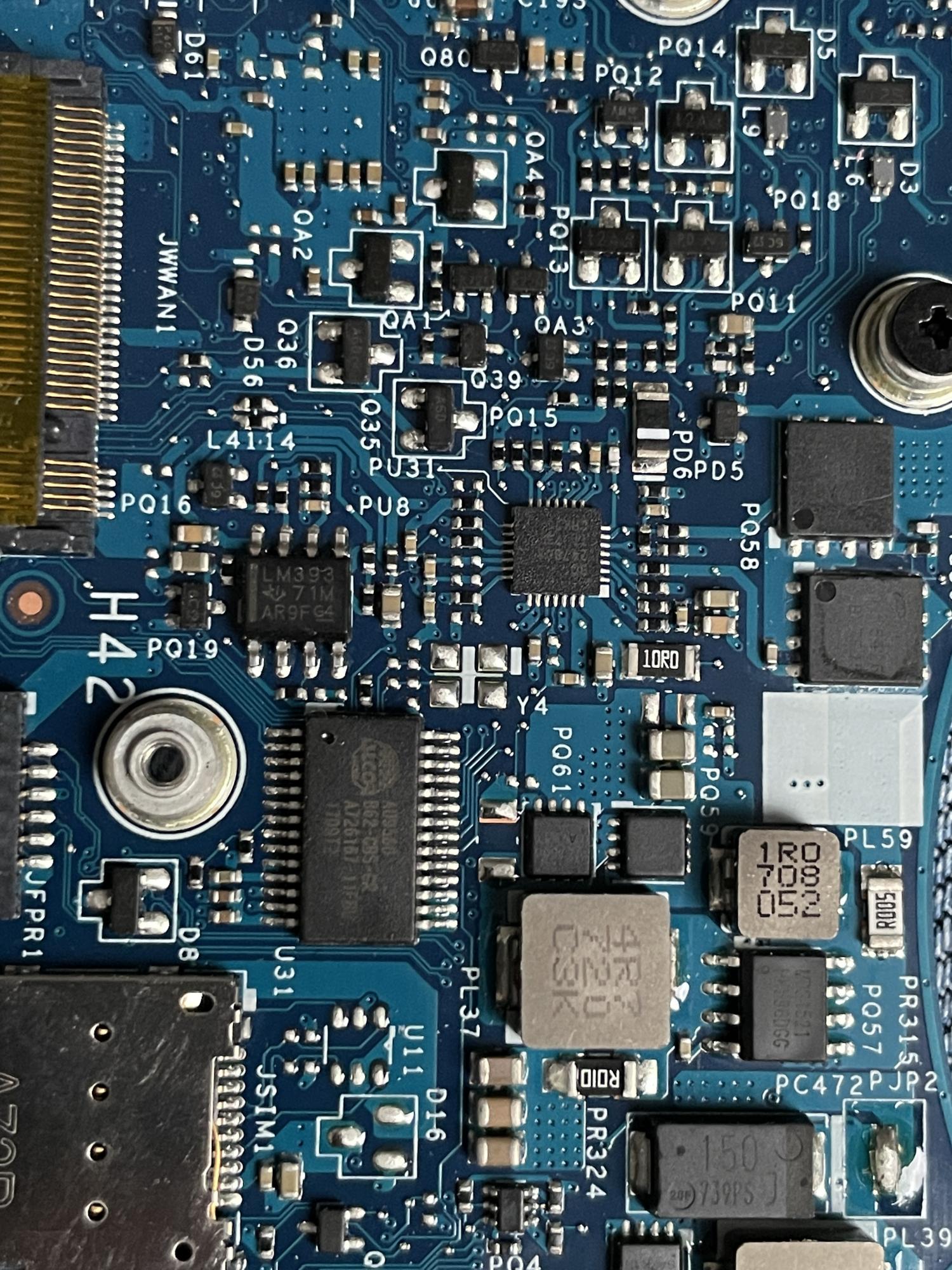

                      Can you post a better pic of this area? It is a very small image from this side.
                      Zbook 15 G6 has the TI charger IC - maybe your G3 does as well under a different part # ?

                        Re: HP ZBook 15 G3 won‘t turn off
                        Can you see it now?

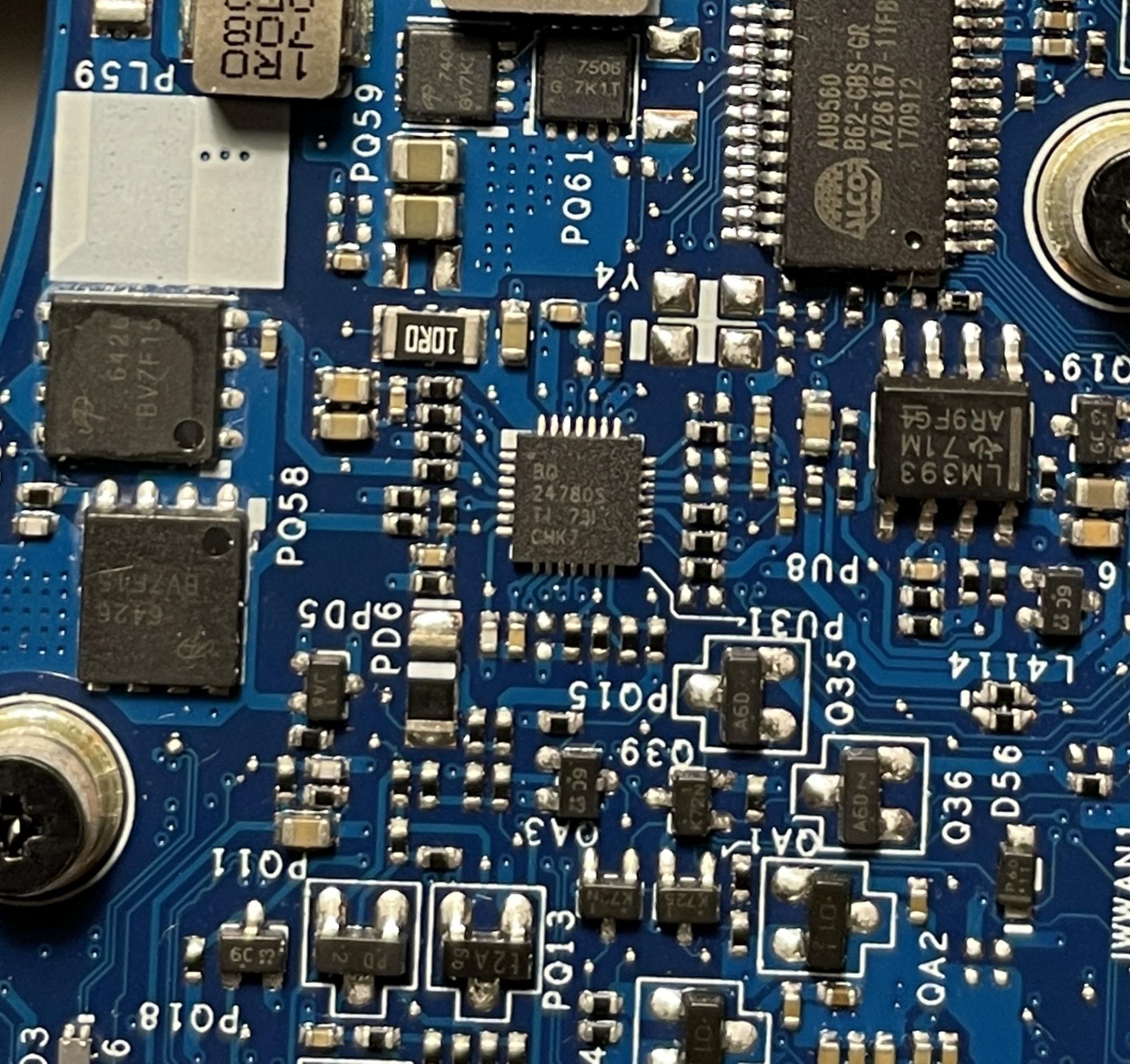

                          Yes. The (same as referenced earlier) charger chip can be seen to the right of the PU8 silk screen. It is the square IC with the 2478x markings on the second line. BQ on the top line.
                            And this one must be replaced?
                              OMG that is a good & clear picture Recently ordered a 4k microscope - ETA is next week sometime.
                              No, we do not want to replace this part but only want to check the voltages linked to this charger IC.
                              Now that we know the charger IC #, we can use reference designs / schematics or even the factory datasheet (if public) from Texas Instruments (TI). TI acquired the BenchmarQ group that designed this IC. That is why it has the 'BQ' marking.
