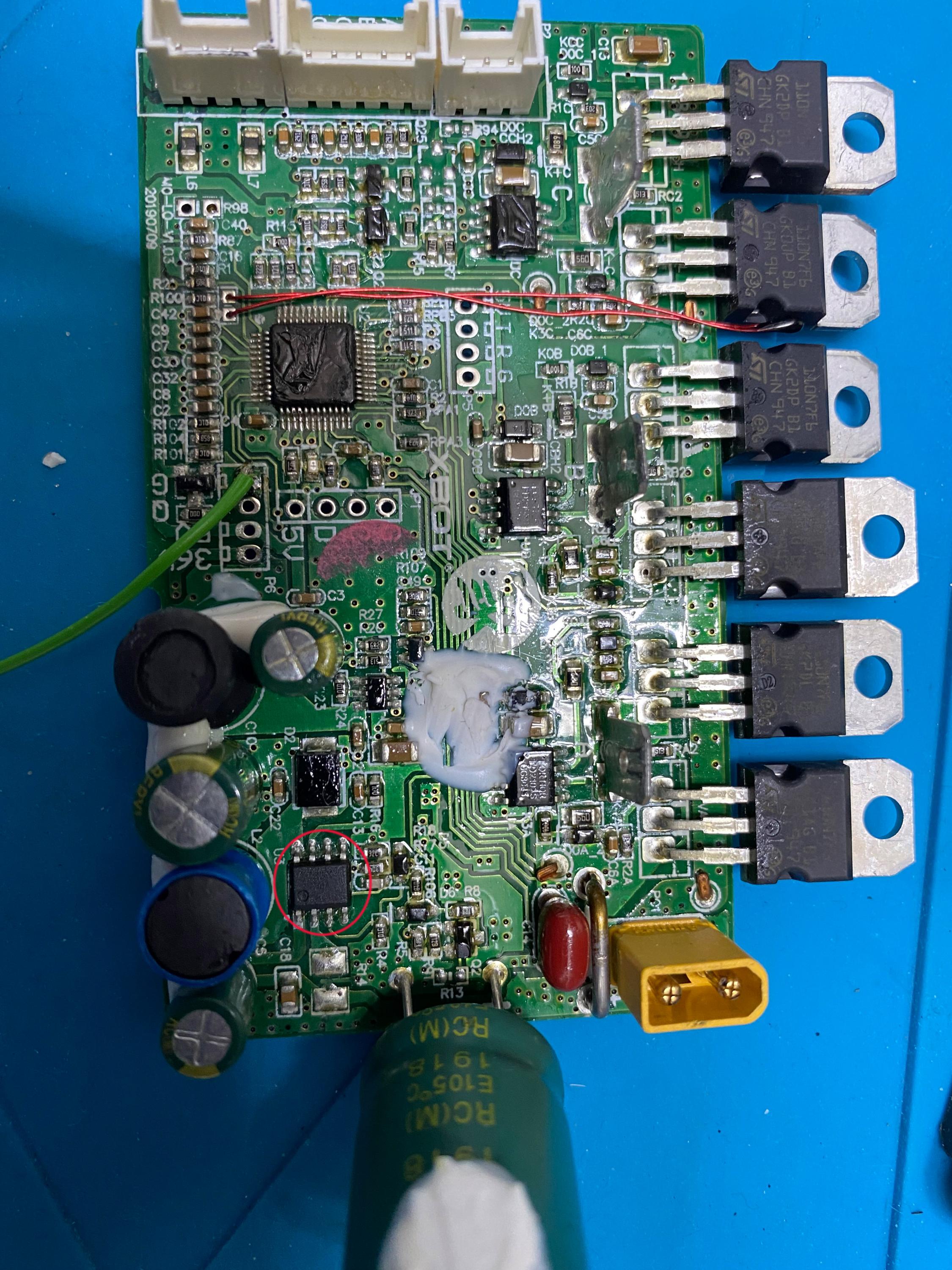

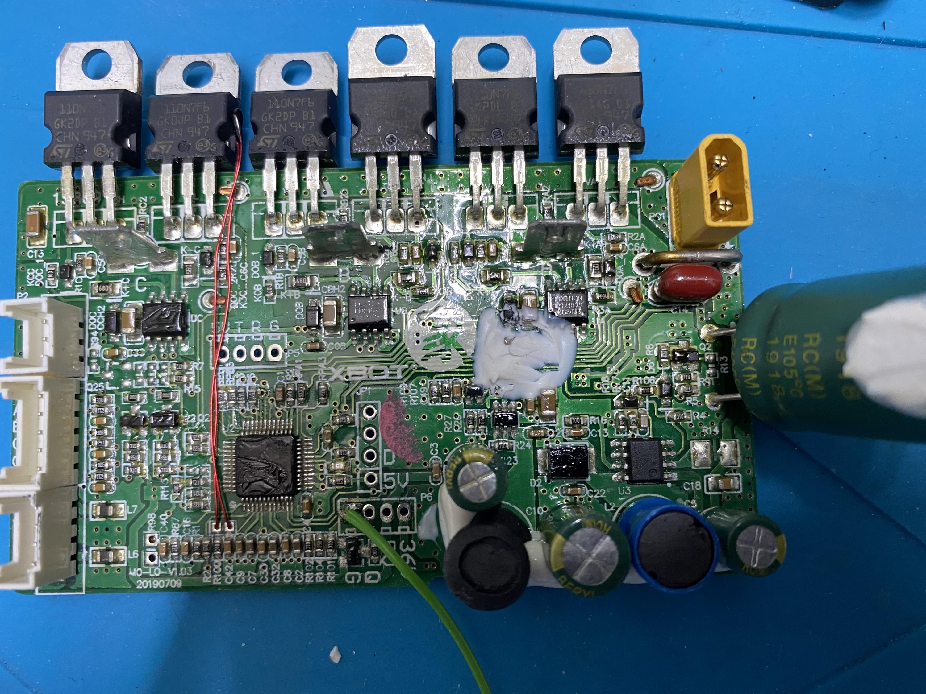

Water got on the board, the board only 36 volts from the battery, no other voltages, diodes and transistors are intact.

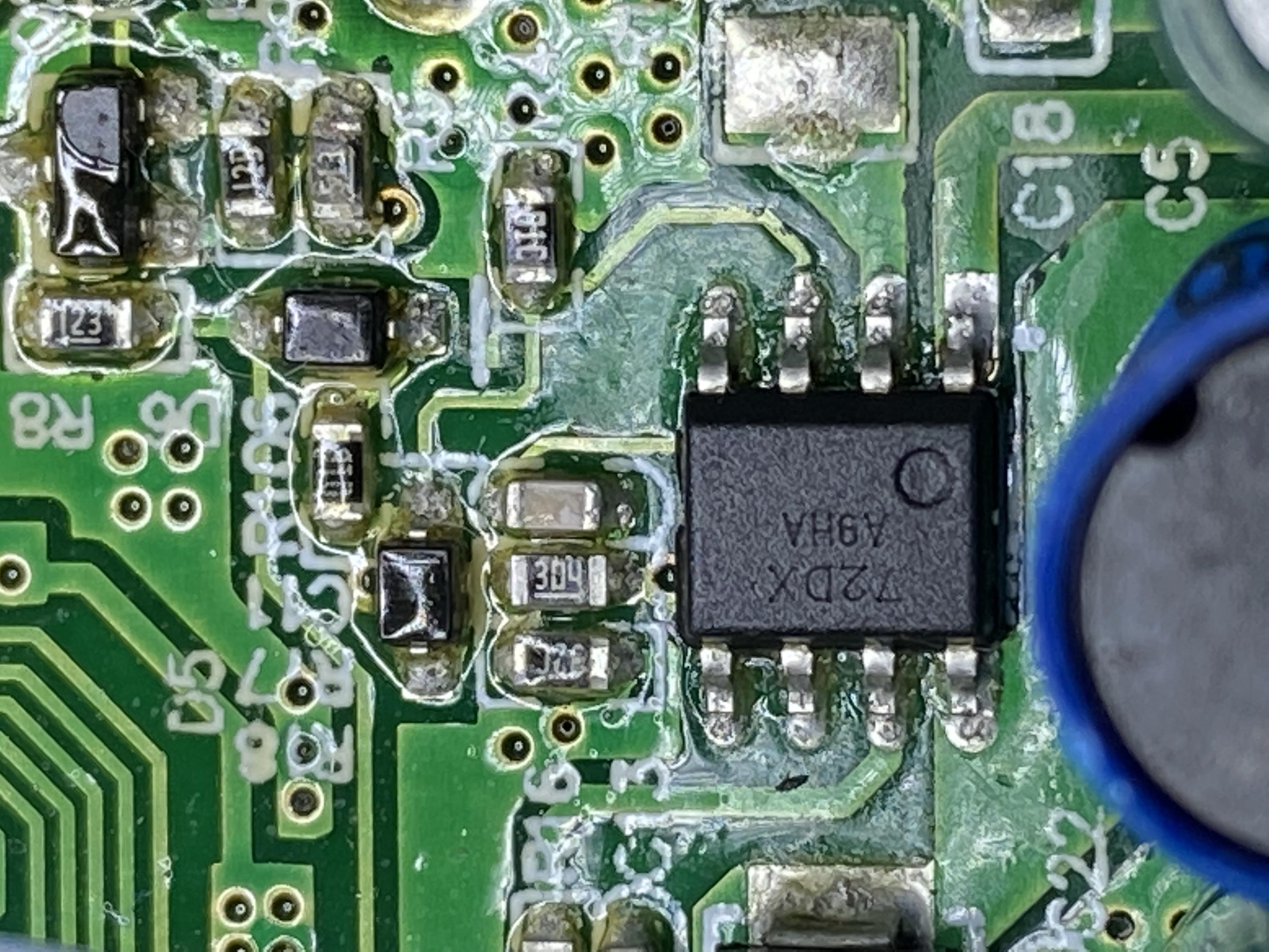

Please help me identify this chip

I understand this is a chip from China that no one knows about, maybe someone had problems with this controller?

Here

none of the circuits fit this microcircuit, pin 1 has 36v on pin 6 GND

The board is some Chinese copy.
That chip is some 12V regulator.

I ordered exactly the same controller on AliExpress, replaced the motor control chip, everything works.
