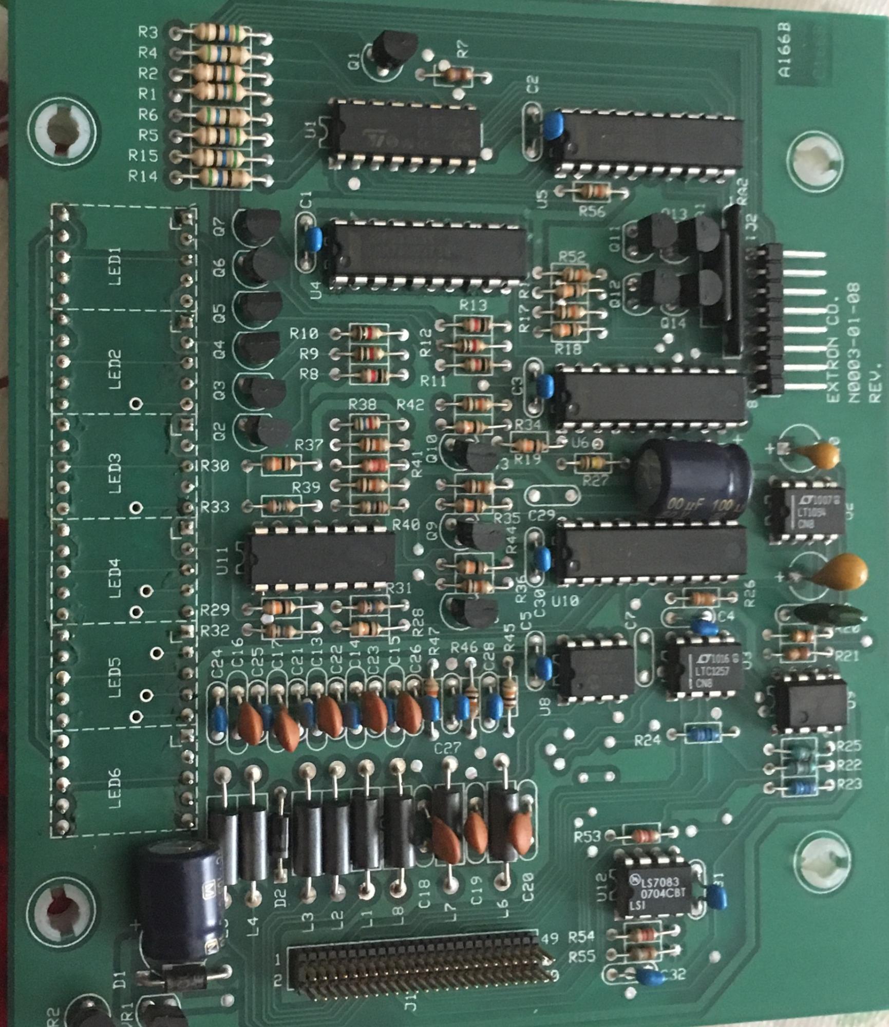

Repaired Shear Back Stop Key Pad Enter Key not working
    • Jul 2011
    • 6070
    This was a real fun repair that I wanted to pull my hair out not that I have much hair left
    We got this hand me down Shear from one of our other location—>
    When first turn on the Shear the digital display would keep flashing the digits one at a time and the desmail point would also flash on and off
    Took out the controller boards and recap them put them back in now the digits do not flash as much but now the enter key works when it felt like working
    Took the controller boards out again and replace the MM74HC373N five of them
    One LT1013CP and four of the 2N4401
    Now every thing works the way it should work
    • Jul 2011
    • 6070
    Re: Repaired Shear Back Stop Key Pad Enter Key not working
    Also the touch pad was replaced which did not change one thing about the way it was working
