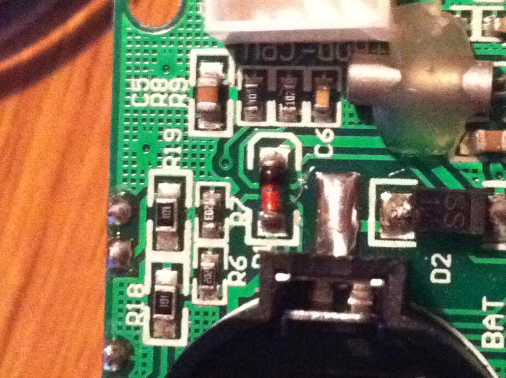

    Basically guys, I don't know what to consider this "problem" as It could be considered a monitor, but as its just a tiny 1.5" LED screen I stuck it in here :P
    Anywho, I recently built a new computer, and managed to salvage my brothers old case, which I really liked. The case has a small LED Screen on the front which would tell you the CPU Temps and the time / uptime etc. When I aquired this case I was told by my brother that the thing had never worked for him and so he wasnt sure if it had shorted or something. I fiddled with it and what would you know.. I got it working perfectly. At first I had a few small problems with the backlight going out but the data still being displayed, but it just somehow seemed to fix itself. Now out of nowhere the backlight has gone again and I just cant seem to get it going. The screen is still working but with no light.. If someone could litterally just point me at suspicious parts then I will try and see if I can figure out what the heck is wrong with it. I did a search for the Model of the thing but google came back with nothing at all, Plus I cant even find the original case on any websites. Thanks for looking anyways guys =]

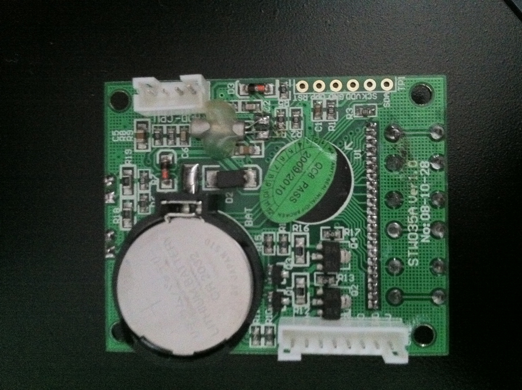

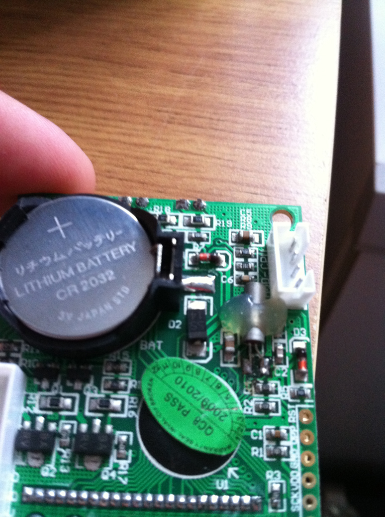

    Picture #3 makes me think it has two LEDs for backlights. Both of them failing seems unlikely. They are probably fed from +5V or +12V with a current limiting resistor. R18 and R19, maybe. The pictures are blurry and it's hard to tell what's going on there.
    Check the LEDs with the diode test on a meter, or a 5V voltage source with a 1K or 220 ohm resistor. Tracing the power for them backwards to a source might help. The solder on D2 looks nasty, maybe just lead-free.
    And it could be a software thing, where the microcontroller on that board is able to turn off the backlights. If that's the problem, cutting traces and wiring them direct to the power supply would be one way to keep them on.

      Thanks for the reply! Yeah, D2 did look like a bit of a terrible solder job so I re-did it just to be sure. I re-soldered any parts which looked to me like they could be a problem (also on the third picture you mentioned you think it has two LED's - this is the case, anywho one of the leads had no solder on it at all and was only just making a connection, so I soldered that properly as well. I will be honest with you, I havent actually used my multi-meter in quite some time so ive just removed the dust from it as we speak and im about to see what I can remember =] again, thank you so much for the help and I will reply with my results in a little while ^^

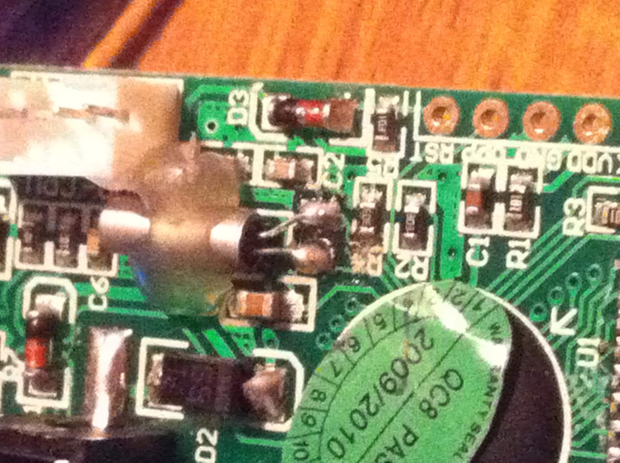

          A better picture of the R18/R19 area would help.
          First, check the LEDs. Disconnect the board from the computer and remove it. Put the meter on a "diode check" setting. Touch the probes to the leads of one of the LEDs, then reverse the probes and do it again. One way it should read nothing, the other it should show a voltage. The LED might light up dimly, depending on the type. Then check the other LED.
          If the LEDs are good, then I would switch the meter to continuity and trace back from the LEDS to the resistors and then where the resistors are getting their power.

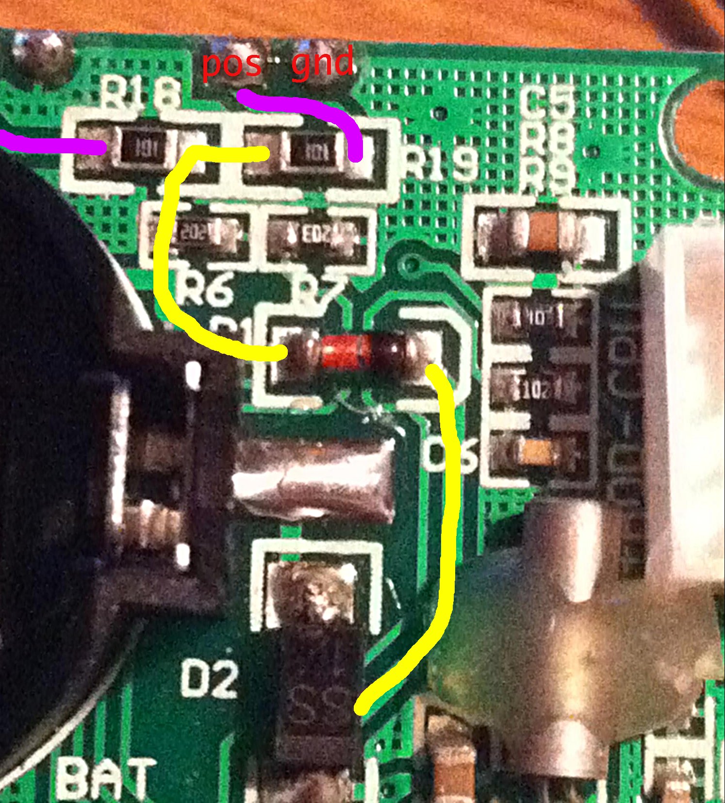

              Much better pictures! The blotchiness is due to low light, but they're good enough for now.
              Here's an enhanced marked version:
              Don't know why there are different resistor values to the two LEDs. Incoming power (yellow) comes from one side of D2, then goes through a zener diode. Then it splits through two resistors to the anode of each LED (purple). (Why are the resistors different values? Variable colors?)
              At this point, it might be easiest just to cut the leads to the LEDs close to the board, then solder wires to those leads, add a resistor and some heatshrink and wire it straight to the incoming power. There are open VCC and GND holes in that empty connector location on the board.

                    LEDs rarely wear out. They'll fail if they get too much current. The resistor limits the current. The value of the resistor depends on the supply voltage and the current the LED needs. Red LEDs are the most efficient (lowest current needed), blue and white are the least efficient. There are LED resistor calculators on the web.

                        Can't really tell what D2 is doing. It may just be to keep the battery from being charged by the power supply. Don't jumper stuff with wires--the designers were shooting for absolute lowest cost, and they still put a diode there.
                        The R18/R19 area should only warm up if the LEDs are on, and not an awful lot then. The LEDs on the other side should be the only relatively high-current thing there. And still shouldn't get hot, maybe just warm. Which seems to say the LEDs are on. There may be some failure mode where they've shorted internally, and the resistor keeps them from melting. A normal LED with no resistor gets very bright and then goes out when the internal connection melts. (And the plastic case usually goes BINK! and cracks. Uh... or so I've heard...)
                        If it were me, I'd separate the leads and test them with a separate power supply. Looks like they're molded into that block of plastic for the backlight. Depending on motivation, new LEDs could be taped/glued in place, or holes could be drilled. Results vary on that optical plastic and drilling into things next to fragile electronics.

                            The zener could be burnt out. Check the voltage between the GND hole in the missing connector and the orange side of the zener.

                                2.35V isn't enough to light a white LED. With power off, you can use the meter's continuity function to trace back from the black side of the zener to find out where the power is originating.
                                Me, I'd take 12V from a female drive Molex connector like used for addon fans, go through a 100 or 150 ohm 1/2 watt resistor and the two LEDs in series. Maybe use a potentiometer for brightness adjustment.

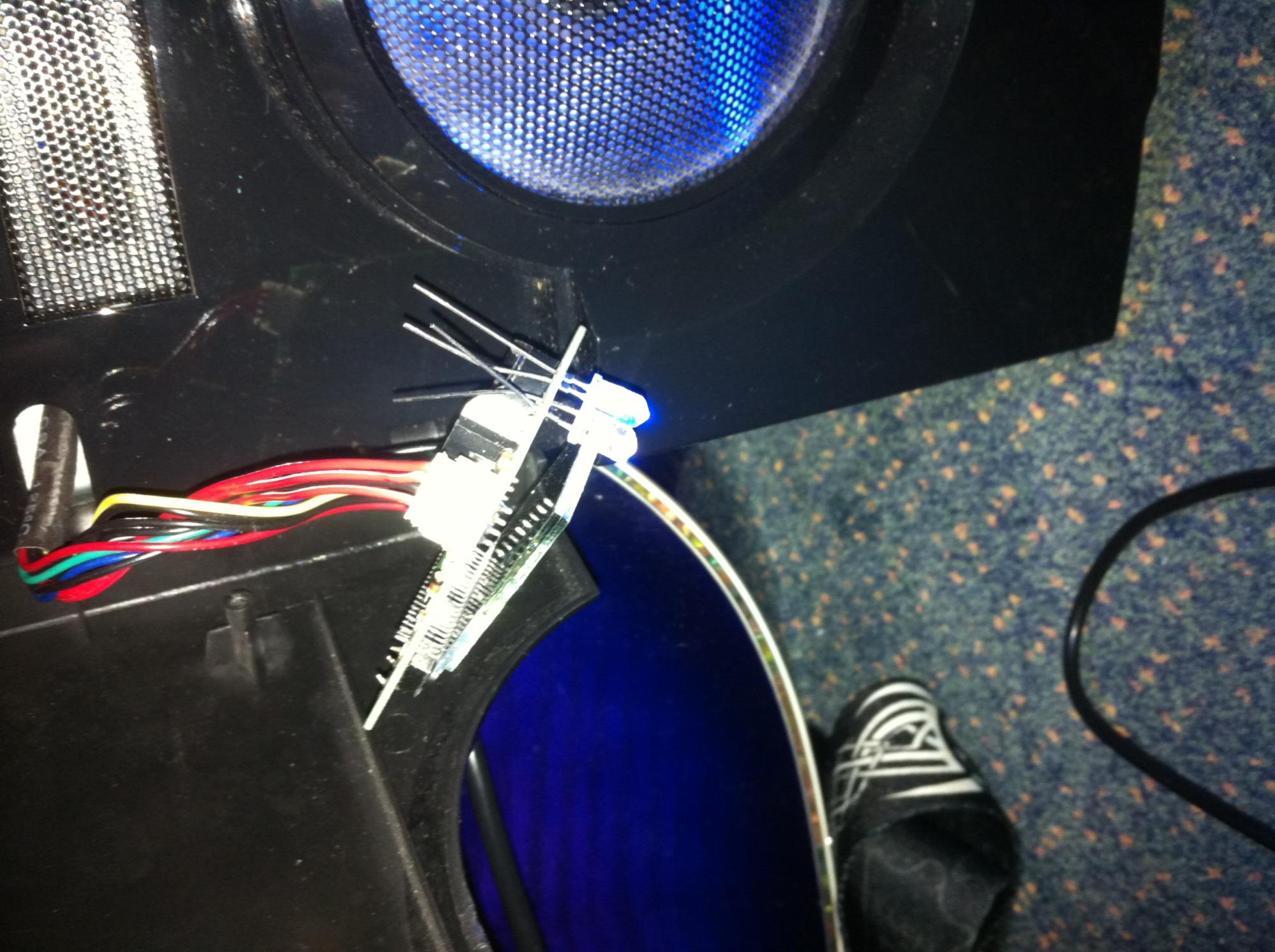

                                  Woop! Thank you so much for all your help, jsod =] I stuck some new LED's in from maplins (just two random ones) and the results can be seen here ^^ I think they were in series and one of them went D: all of this just for a shoddy LED! Thanks again ^^
                                  hmm I just realised I seem to have a final problem. The battery which is supposed to be only in use to save the time, seems to be powering the LED's a little when the power to the pc goes off =[ im thinking this may be because i replaced D2 with an equiv which had higher resistance o.O

                                    It's not coming from the battery. There's probably a little leakage current somewhere, high brightness LEDs will emit a small amount of light at ridiculously small currents.
                                    You can confirm it is not the battery by unplugging the power cord to the computer. In a few seconds the LEDs should fade away.

                                      I'm afraid it is the battery >_< I did unplug it from the computer, and then waited.. and after a short while i took the battery out and boom, the lights went out. I put the battery back and the LED's come back on lol
                                        Re: Not 100% sure where I should have posted this :P
                                        Leave it be. It's not like they'll drain the battery or anything.
