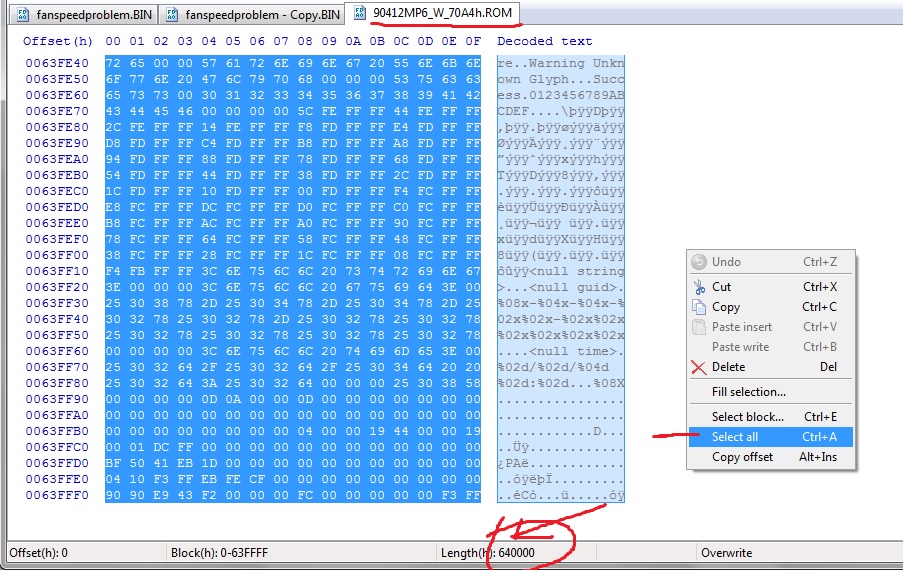

              • 21022
              Re: H310C-SF110 Mini pc bios
              Originally posted by bilen
              ok i understand but where do i cut from the original bios?
              There is an easy way to work it out.First of all make another copy of your original backup,so that the work is done to the copy,it makes it easier as well to copy any DMI or key from the original.
              If you open the update and choose "select all" you will see the file length is 640000 .

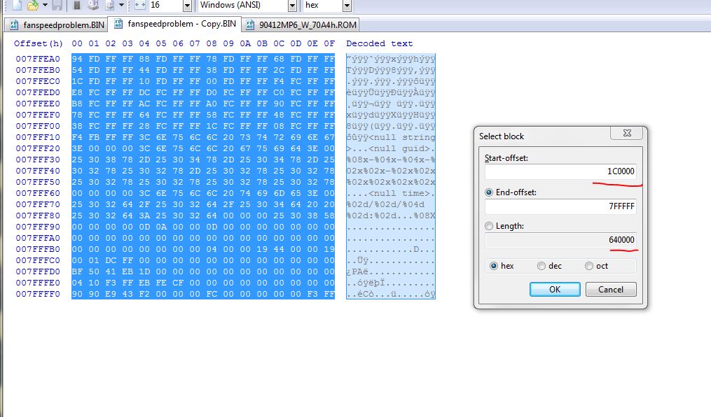

              Open your backup copy.If you selected the block length 0 - 640000 thats what length the file will be.

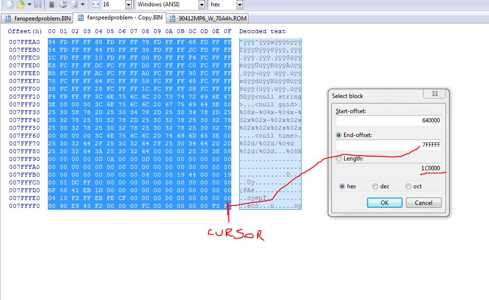

              Scroll all the way to the end of the file and put your cursor between the last two FF`s ,then right click and choose select block,that will set the end offset to 7FFFFF as that is where the cursor was.
              Enter 640000 as the start offset and look at the file length !!! its 1C0000
              Select the block again and enter 1C0000 as the start offset,and 7FFFFF as the end offset. Now look at the file length, its 640000

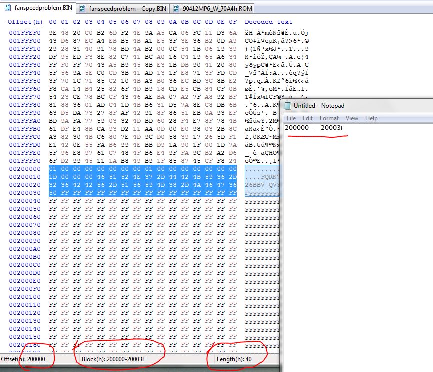

              Go back to the update,select all,copy and paste into the backup copy and save but keep the tab open
              Now there`s just the win key to copy across from the original backup to the backup copy (and ME firmware to clean)
